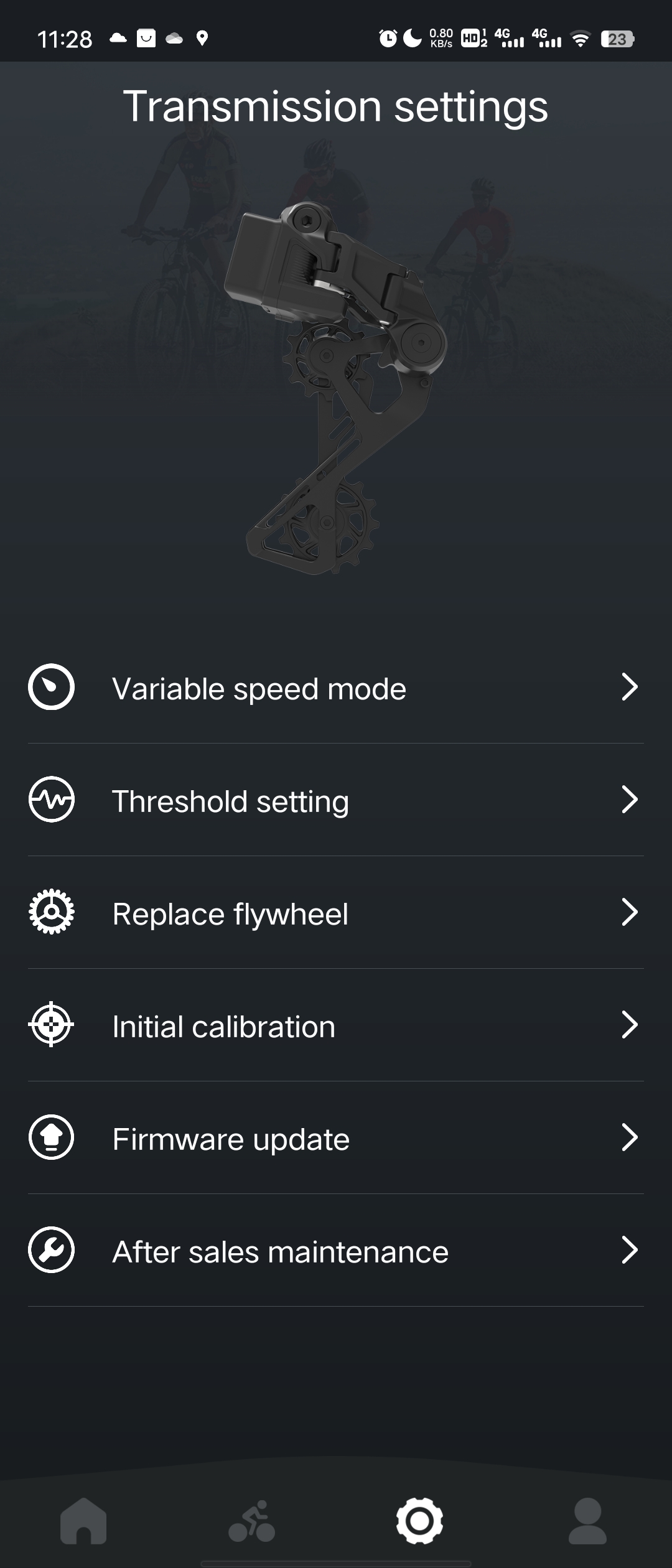

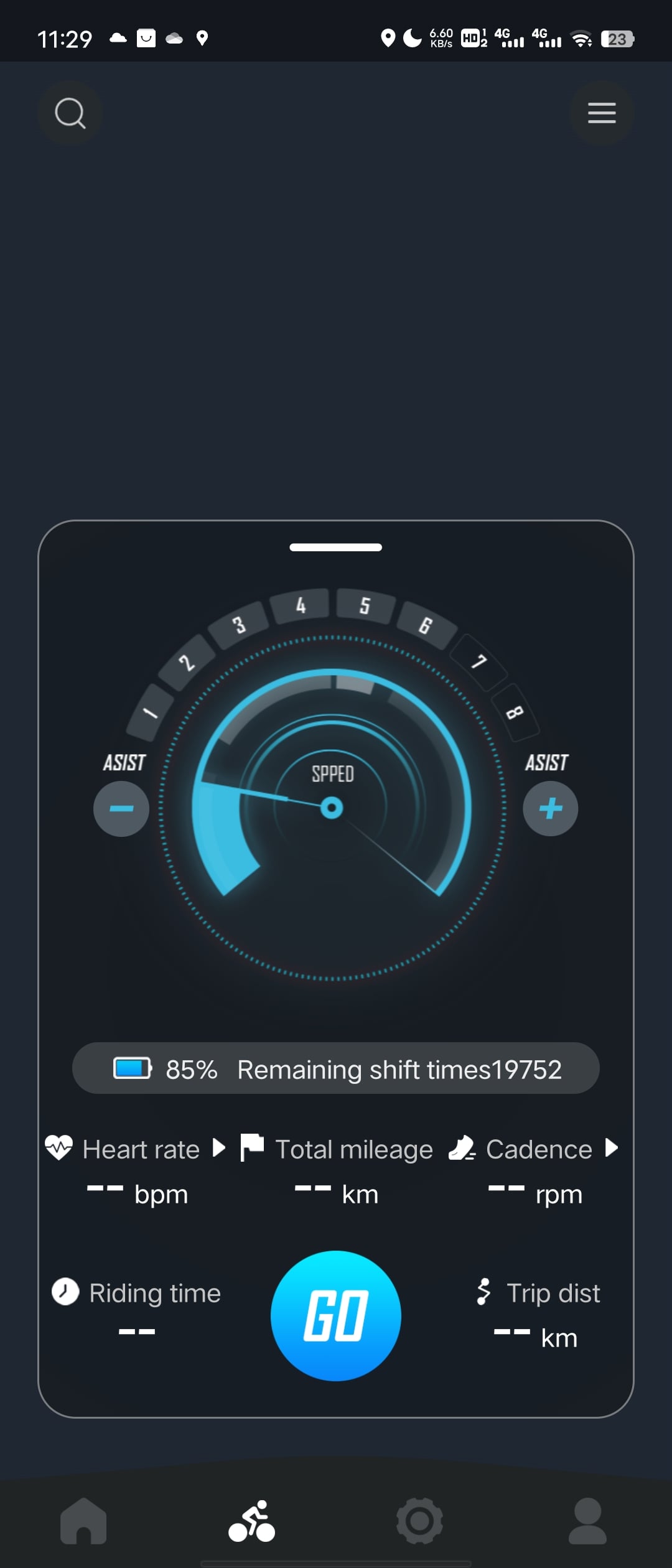

there are a few things that you need to be aware of:
- the manual is useless, the translation is poor, I had to help myself, and happy to share what I found ( eg: how to zero the initial speed with the rigger on the 1st install)

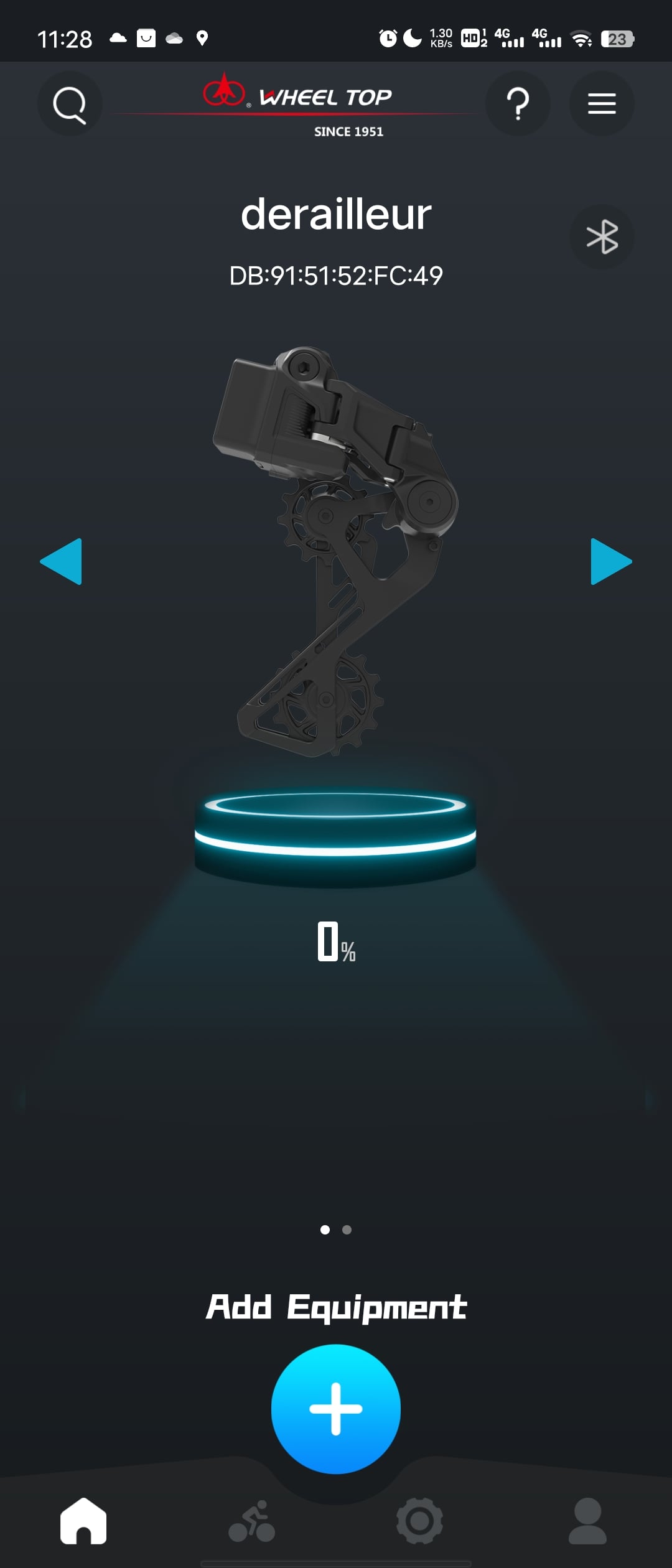

- the app is useful for adjustments. However, the translation is sometimes hazardous. you need to stay open-minded.
-@neeko, it is delivered with 2 batteries, I always have a pair in my backpack, and so far, I have never had to swap them while on a ride. I'm still with the one installed at my initial setup and it shows 68% on the app. for my kind of ride, I think I'm safe for the upcoming month with one, but I will update you later with more usage.
I really like the accuracy of shifting, no more rattling chain, the speed of shifting, and the manufacturing quality is great for the price.
do I recommend it? Yes, for the price it is absolutely worth it!
what you might struggle with a bit is setup and language issues, but I suppose that we are all her handy DIY bike builders, right? :)

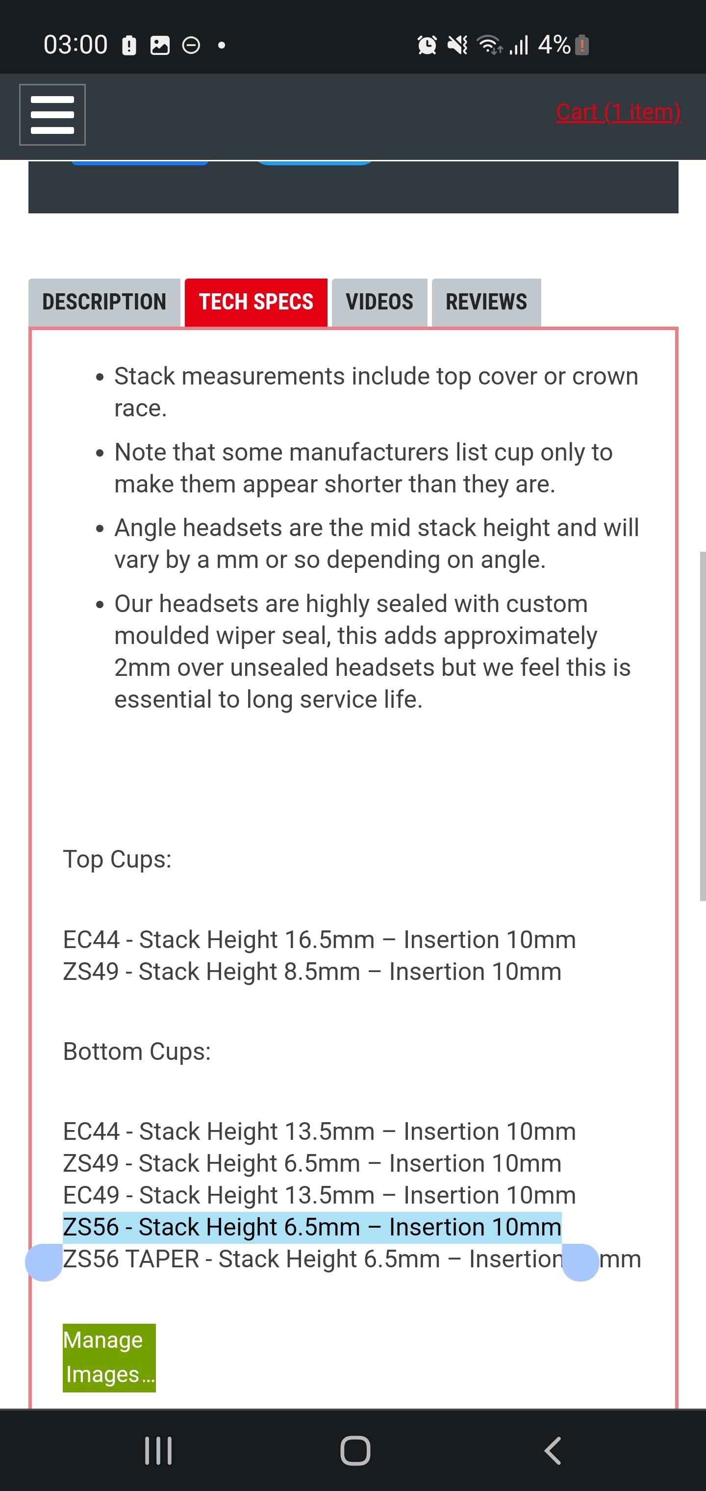

Can anybody confirm that the slacksizer headset is fitting ?
I am not sure because the works has a insertion deep of 11mm I think.
Today I tested with Standard lower cup and work upper cup. It has a little space at the rear of the under cup, I think its also not optimal but I have to say it goas smoothly round. But with jumps I think its not good for the head tube so I ended up to put the comeplete Standard headset in...

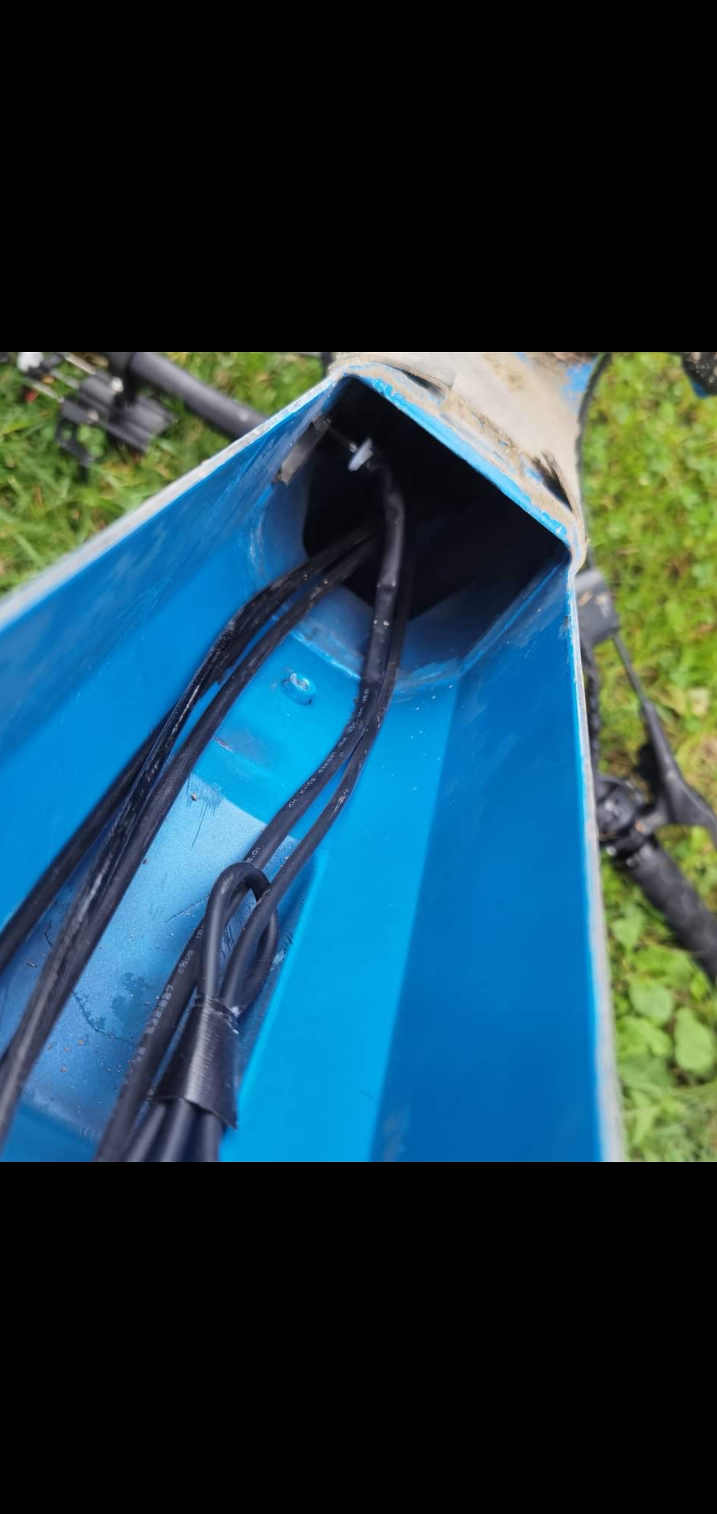

How did you guys manage the cables runing through the frame? I have not built the complete bike yet, just inserted all the cables (not sure how you say in english, bowdens maybe? (for rear derauiller) and brake hoses and when pulling the rear fork all the way up, both brake hose and derauiler cable move through the entire frame all the way up to the headtube. I can screw those holders behind the battery to hold the cables in place, but would this be ok in the long run?
bram.biesiekierski
Apr 18, 2022
424
258
Perth WA Australia
On mine, I put some cable ties around the cables where they exit above the motor. The motor is a tight fit and you will kinda need to pull the cables off to one side as the motor is inserted.

So when the motor will be mounted it will basically squeeze the cables, and the movement will probably be gone?
I also received the motor today, man what a heavy thing this is! The crankarms and the chainring are also very heavy, I believe here I could save almost half a kilo with some aftermarket parts - I have seen you talking about raceface aeffect crankarms and a spider adapter with custom chainring - has anyone at least tried to evaluate the weight gain when replacing these two parts (especially because new aeffects and spider are probably 150€)?

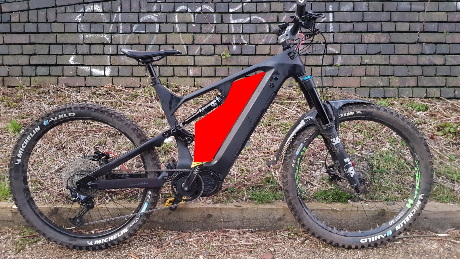

Hello everyone! I'm again reinterested in the dengfu e22 for an upcoming build, I originally looked at the e22 but decided that I likely couldn't fit a battery with the capacity I was looking for. Then I looked at the new e55 but with currently no large frame, the battery cover built into the battery box which would make building a custom battery without using the box (to fit something bigger) difficult. And I plain just like the looks of the e22 more. I plan to pair the m620 with a high power external controller which I assumed would increase my wh/mile drastically but now I don't really think that will be the case. My current ebike has a 832wh battery and a bbshd, I just got my hands on a Ludi v2 controller which increased my power by a lot but more surprisingly this didn't seem to affect my wh/mile at all under normal riding conditions (even while enjoying that extra power occasionally haha). But my second day with it I did a ride where I pretty much was hammering on the throttle the whole time and I did see my range about half for the voltage used. Suffice to say I think I over estimated my "need" of at least 1500wh but I would like more than what my current bike has. I would really like at least 20s4p but a 5~6p would be nice for better cell life among other things which I know isn't an easy task for the frame. Tdlr: I would like to build a custom 72v battery for the dengfu e22 if I did go with one, but I also don't want to commit to buying the frame without knowing if it will fit my needs, would be a lot of money to spend and not be happy. So I have a few questions I was hoping someone could answer for me.
My questions will relate to the large size frame. First if someone was to build a soft case battery how does the battery cover mount to the frame and does the leave any holes exposed allowing moisture to possibly get in?
What is the max length of the inner battery tube with the mounting stuff removed? (again in a situation where someone makes there own without the box). I was given a 3d file by Tomblarom which stated 500mm but I wanted to confirm this as I forgot to ask what size frame that was. And also I saw a few users mention opening up the frame more to get more space, now I know that this can comprise the frame but to be honest I'm not doing anything even close to serious enough that I would worry about this, anyone know what the max length would be if I did this?
And finally can someone get my the measurements for this area assuming that the rear shock doesn't have a piggyback? I would really appreciate this as my backup plan if I cannot fit enough cells is to make a second battery in the triangle. I don't need the measurements to be exact just close enough is fine so I can get a rough idea of how many cells I could it.
I really appreciate the help and thanks Neeko Devinchi as I used your photo haha

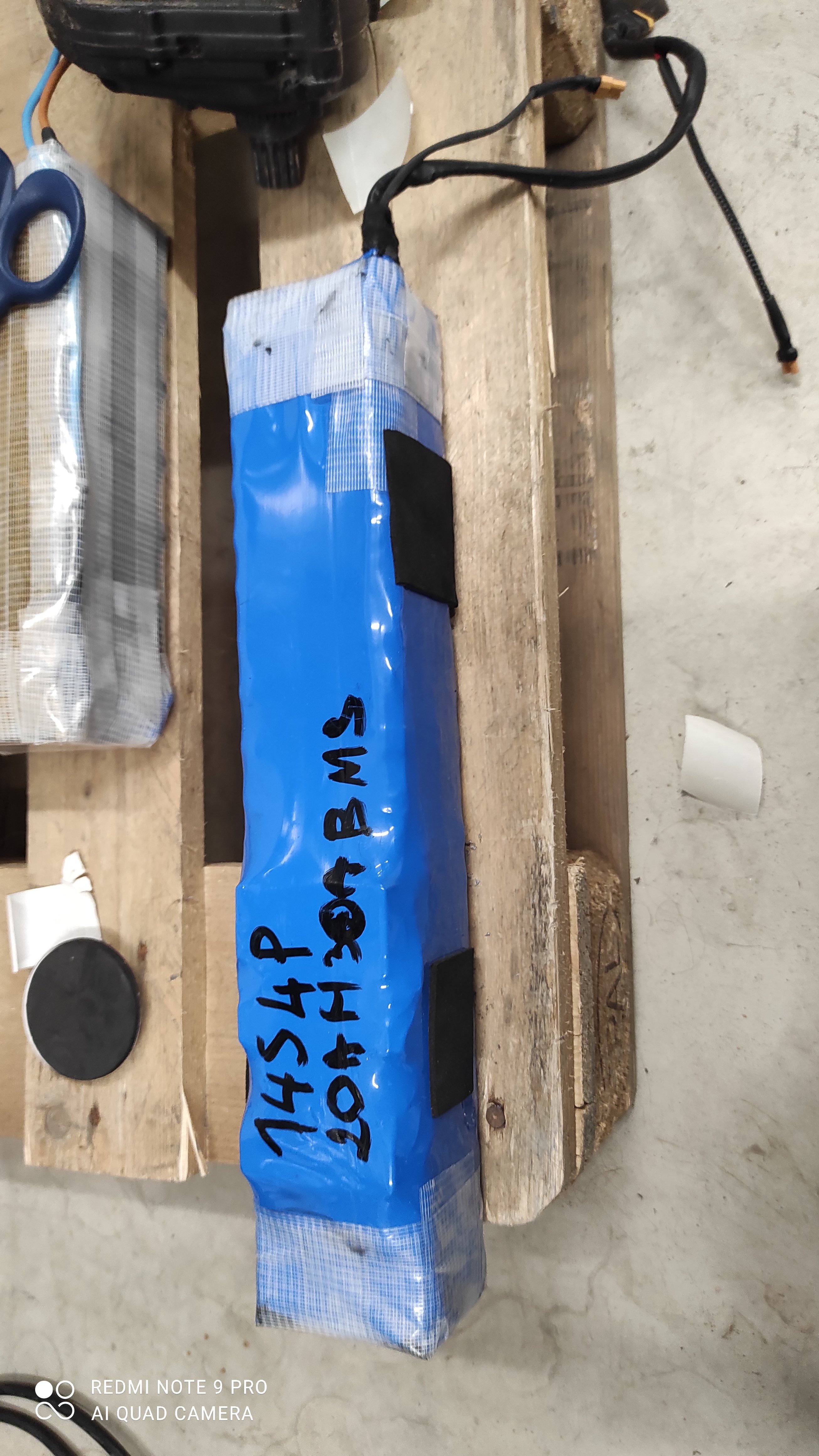

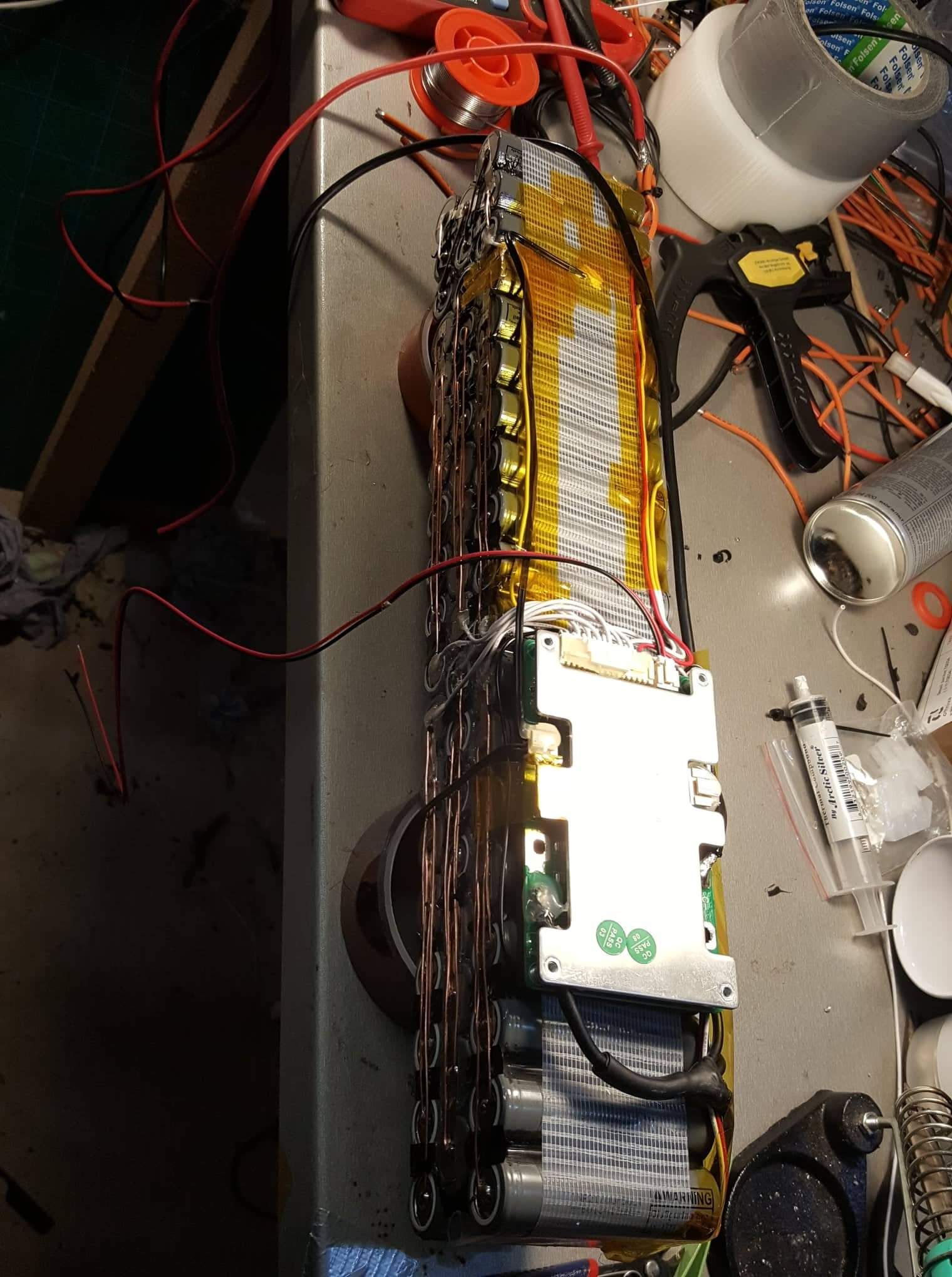

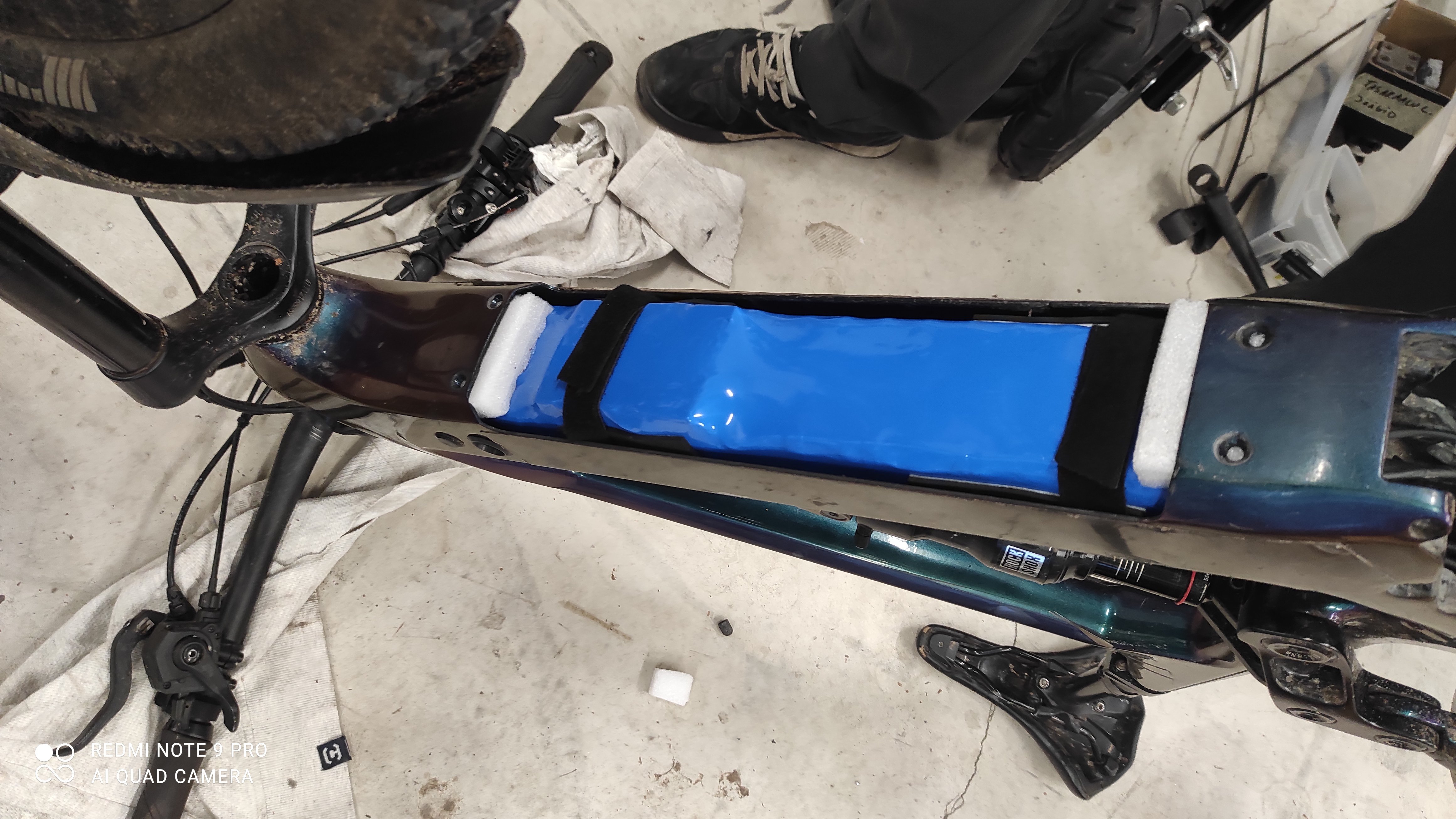

Two answer some of your questions:
I have built a soft case battery for dengfu E10 size Large which by the looks is identical to the one of e22. I am convinced that 14s4p is the absolute maximum you can fit there without cutting the frame. Even fitting that battery was not easy, I had to push it in millimeter by millimeter.. the available compartment length is under 44cm.
Also had to be careful with BMS height and choose 10mm tall instead of 15mm. I am attaching some photos to give you an idea.
As for the waterproofness of the frame, you will definitely need to work on that, mostly around the battery cover but also cable ports. I used some black silicon, but mostly relying on having the pack waterproof.
Now I also want to ask you why do you want to use an external controller and will it have pedal assist? The stock controller gives around 1700w peak which imo is plenty for an ebike. You might also want to check custom Innotrace controller.
received_5331994563579556.jpeg IMG_20221206_180038.jpg IMG_20221111_151348.jpg
View attachment 103631 View attachment 103632 View attachment 103633
