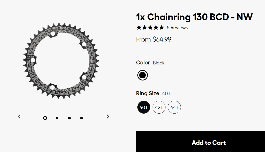

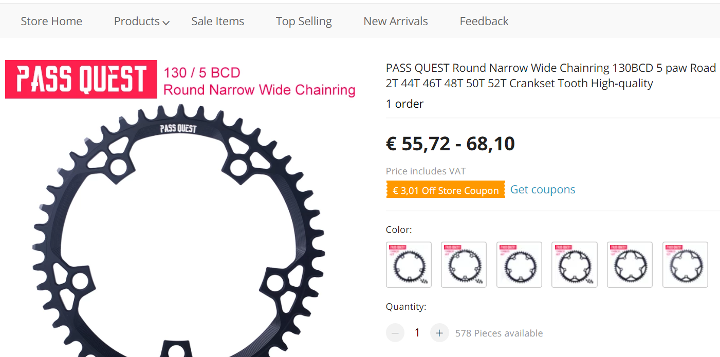

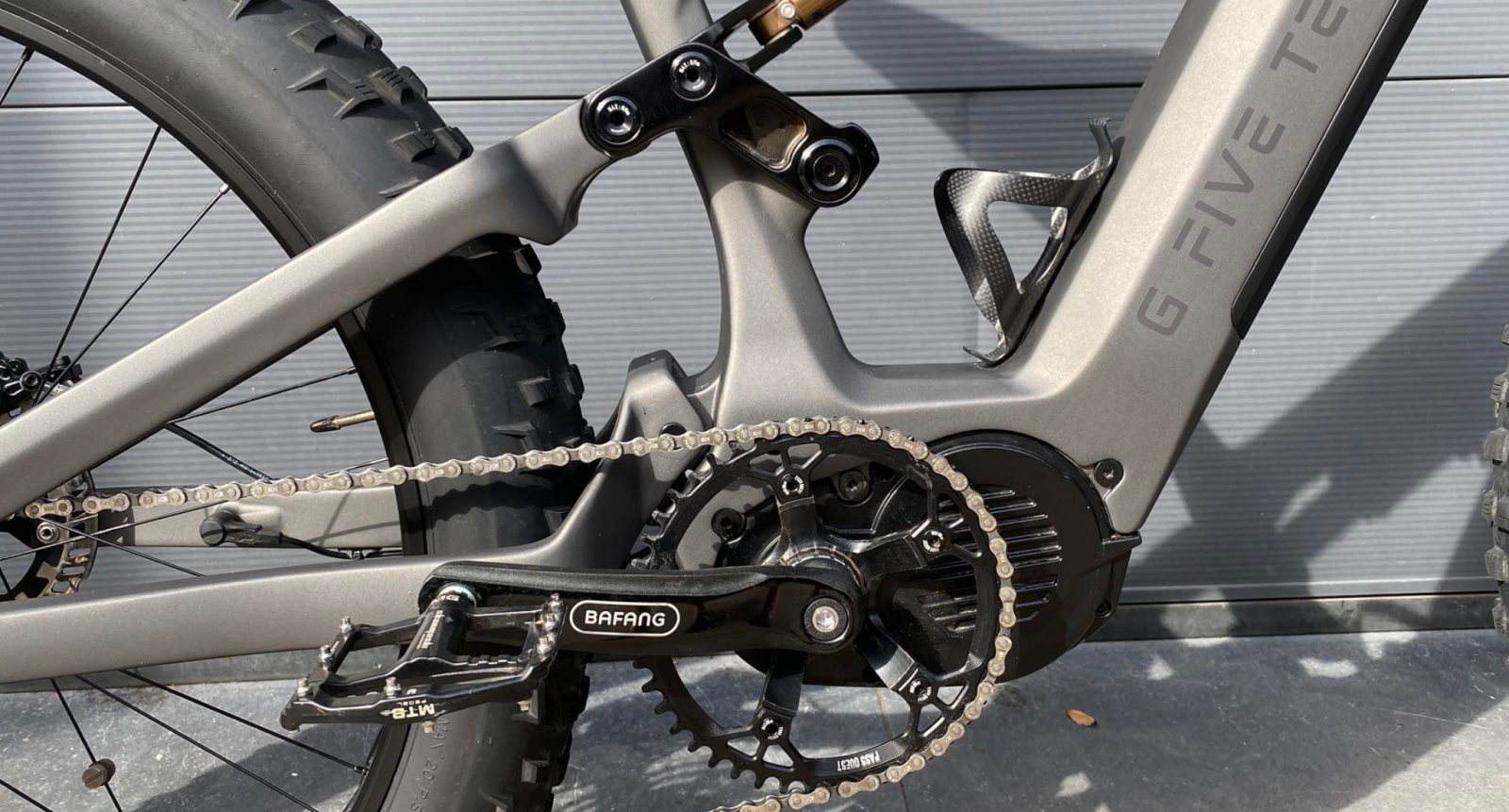

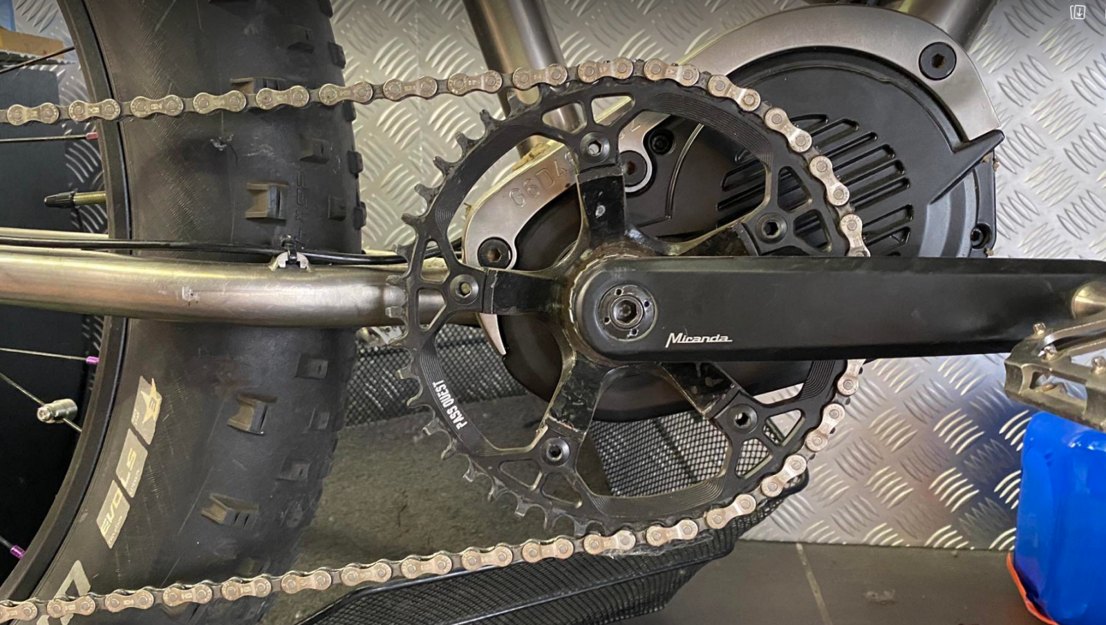

You can get a raceface 40T They are great!
I run 46T on all my +3000W Innotrace bikes.
With a 46T you have a lot less torque on the cassette side.
My cassettes last a lot longer.
With the Innotrace motor 8 Speed is more then enough.
Chains cassettes, deraillers and shifters are cheap in 8speed.!
The 46T I buy at Ali, available in 42T till 50T Not cheap but durable!
On a Std Bafang I usually go for a 42T-44T Raceface

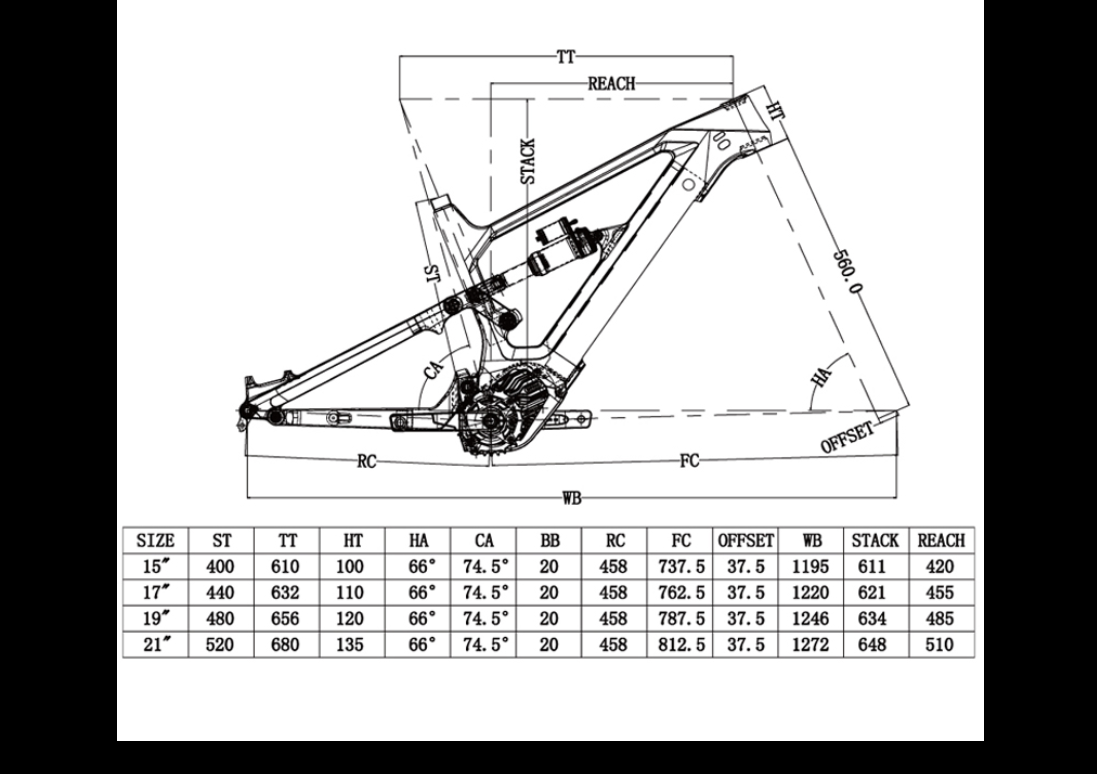

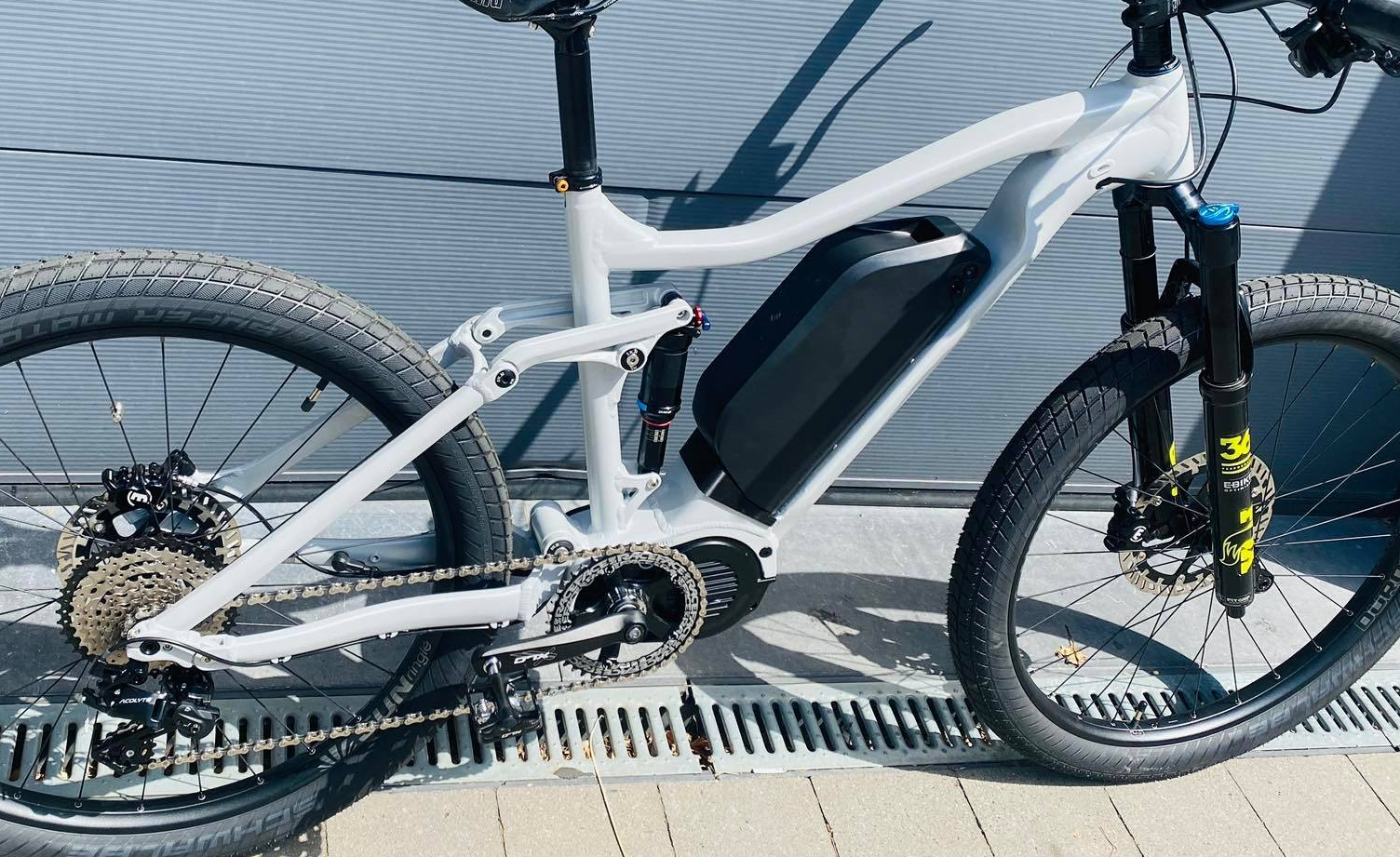

I have E10, it's different model mate :)
Yes. But very very very similar.
Both have 150mm travel.
Both have 66° head tube angle.
Both use the exact same rear triangle.
Both have the same battery mounting.
Both use the exact same linkage. (But orientated slightly differently, i will explain why.)
Both have very similar linkage driven Horst link suspension design.
Both have very similar overall wheel base lengths.
They both have very similar stack heights.
They both even have very similar aesthetics, similar lines, similar design styling.
Where they differ is the e22 has the crank axis posistion more forward in the frame. This is ofcoarse due to the different motors. The ultra is bigger, and therefore needs to be posistioned in such a way that it will actually fit, which results in the crank axis coming forward relative to the e10 - m500/m510/m600.
Because the crank axis is forward on the e22, it means the e22 has a slightly slacker effective seat tube angle. This more forward crank axis also means the e22 has a slightly longer effective chainstay length, (even though it uses the exact same rear triangle as the e10). It also means the e22 has a slightly shorter reach, again, because the crank axis is shifted forwards in the frame.
The bikes themselves are incredibly similar overall size, eg similar overall length / wheelbase, similar height, and otherwise similar geometry. All these "differences" can be simply traced back to the location of the crank axis. Which can be traced back to the size of the motor, and required packaging constraints.
The shock spec and shock location does also slightly differ on the 2 bikes. The e22 shock is connected to the top tube, and the e10 shock is connected to the down tube. But I would suggest the shock placement has been moved to the top tube on the e22 because again, the fact that the motors are different. The larger ultra motor forces the e22 downtube to be alot steeper. Because the motor is larger, the lower end of the down tube must begin much more forward relative to the bike. This possibly makes it less ideal position to connect the shock to, hence why it may be shifted to the top tube. They also would have to fit a water bottle mount, so this may have influenced the decision to alter the shock placement.
The e10 comes in 4 sizes (15", 17", 19", 21"), the e22 comes in 3 sizes (16", 18", 20"). This is most likely designed to optimise production costs. 1 Less bike size, means 1 less mould to make, which means less tooling costs, which increases return on investment. The e22 / ultra platform is also less popular than the e10 /m500/m510/m600 platform. So they would be expecting less overall sales, therefore less likely to want to invest in unnecessary frame moulds. I would suggest this is why the frame sizing numbers are like that. But if you extropolate the sizing out between the sizing jumps, you can easily see they are very much the same overall size. Only the e10 is spread across 4 sizes, and the e22 is spread across 3 sizes.
For all intensive purposes, they are the same bike, except with a different motor. And in order to fit the different motor, they would need to make the nessisary alterations to the frame.
I would bet my left testicle that dengfu took an e10, and played around with the frame in CAD until the ultra fitted. And then made that and called it an e22.

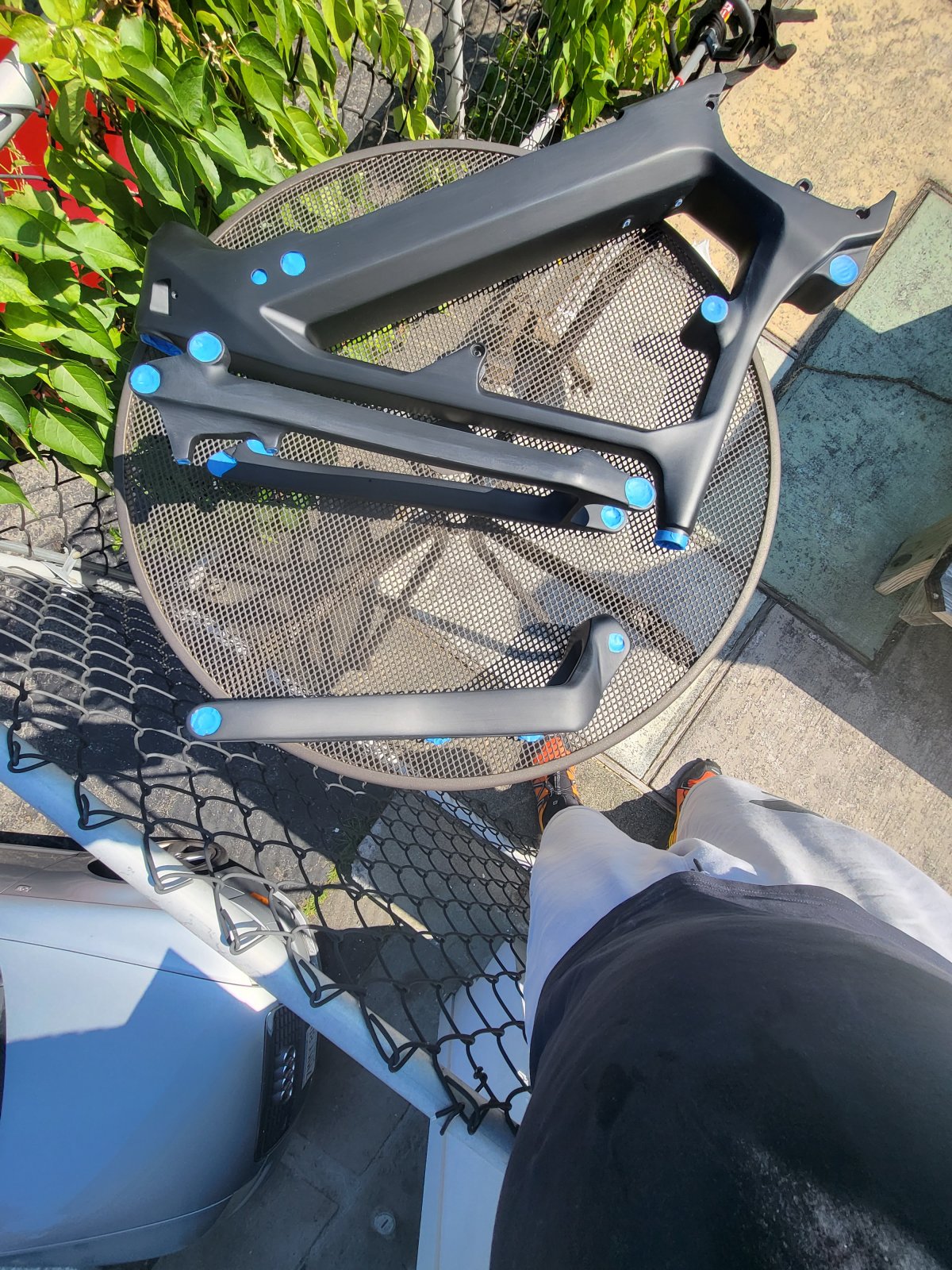

I just got an Email back from Dengfu, in which a salesrep says that combining an E10 frame with a E23 rear end "is not okay". So I am unsure if they would even sell me an E10 frame and a E23 rear.
I haven't written back to them about it, just wanted to give some feedback here in the forums.
I suspected Dengfu would say this.
Bare in mind, Dengfu and myself have mutually agreed that my warranty on my E10v1 due to me over-stroking it has been void.
Nevertheless, I too agree with Dengfu's decision NOT to mix and match the rear end of the E22/E10 with the E23.

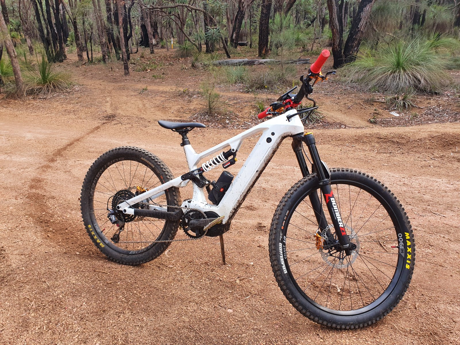

Got out for a ride on the weekend. Fun as always. But I did have a few issues with the chain coming off the chainring, happened about 4 times. This only seemed to happen when rolling over quite choppy terrain at speed. It happened when I was coasting without the motor or pedal assistance.
I think the jolty terrain is causing the chain to bounce off the top of the chainring. I am going to see about putting a chain guide on and see if that helps.
I did notice the box prime 9spd derailer has a super tight clutch mechanism. And also a quite tight spring aswell. But there is a sometimes a small amount of backlash from when the derailer clutch engages. And I believe this small backlash is enough to let the chain loosen when it's bouncing away.
