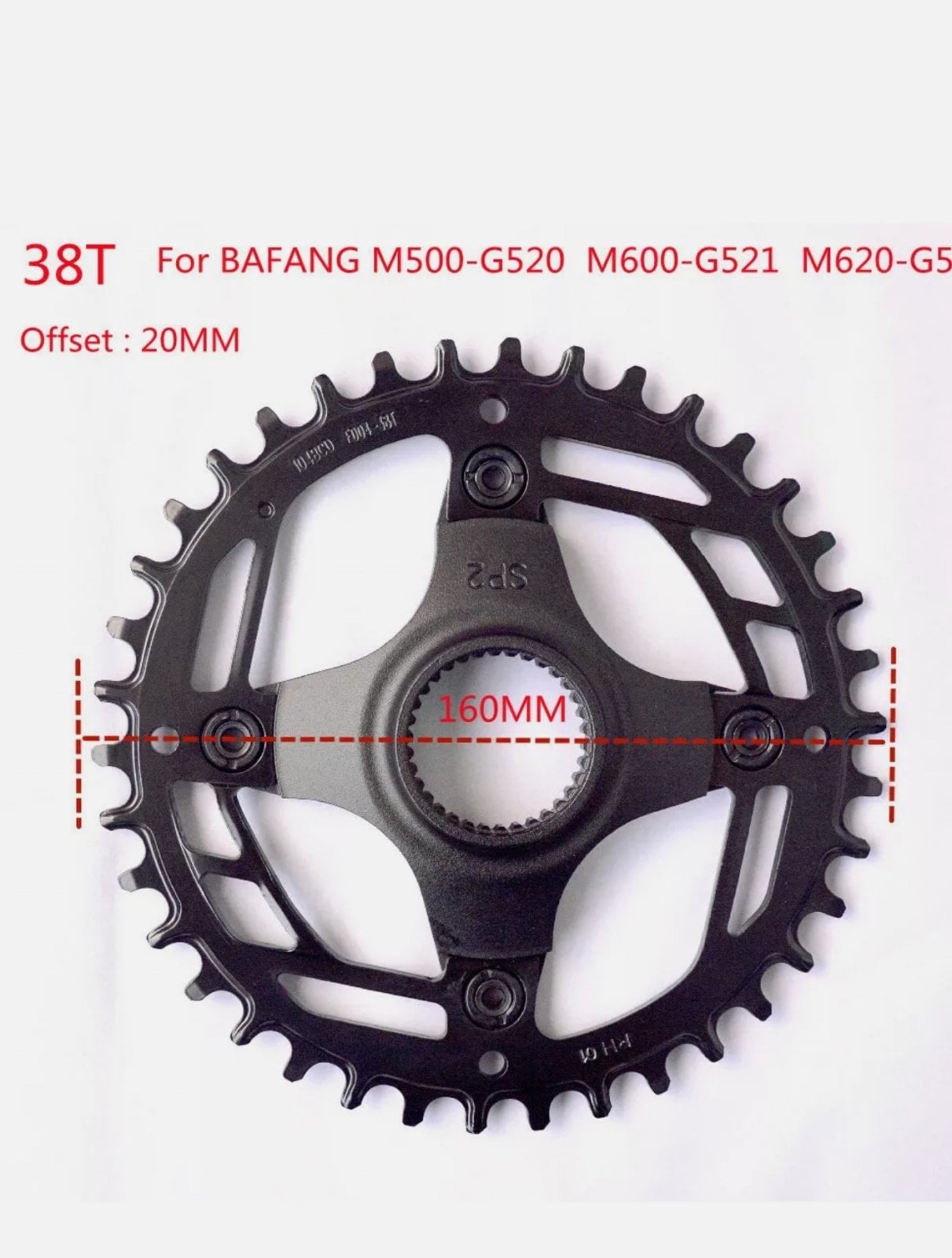

I'm trying to get hold of a a chainring but it's not easy and don't want (at this stage at least) to spend $100 for the ChristiniBicycles chainring adaptor.
Did you guys ever find the right one for an bafang M620 (ISIS type)?
What about the bolt/screw chainring dimensions, I've seen 6.5mm and 8.5mm ones.
This is what I've found until now:
21.69£ |SING YIU Bafang Ebike M500 M510 M600 M620 G510 G521 Bicycle Bafang Mid Motor Spider Chain Ring Adapter 104BCD bicycle crankset| | - AliExpress

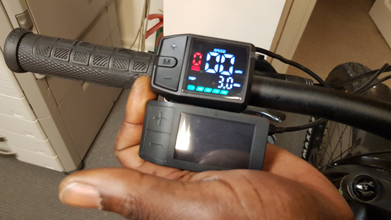

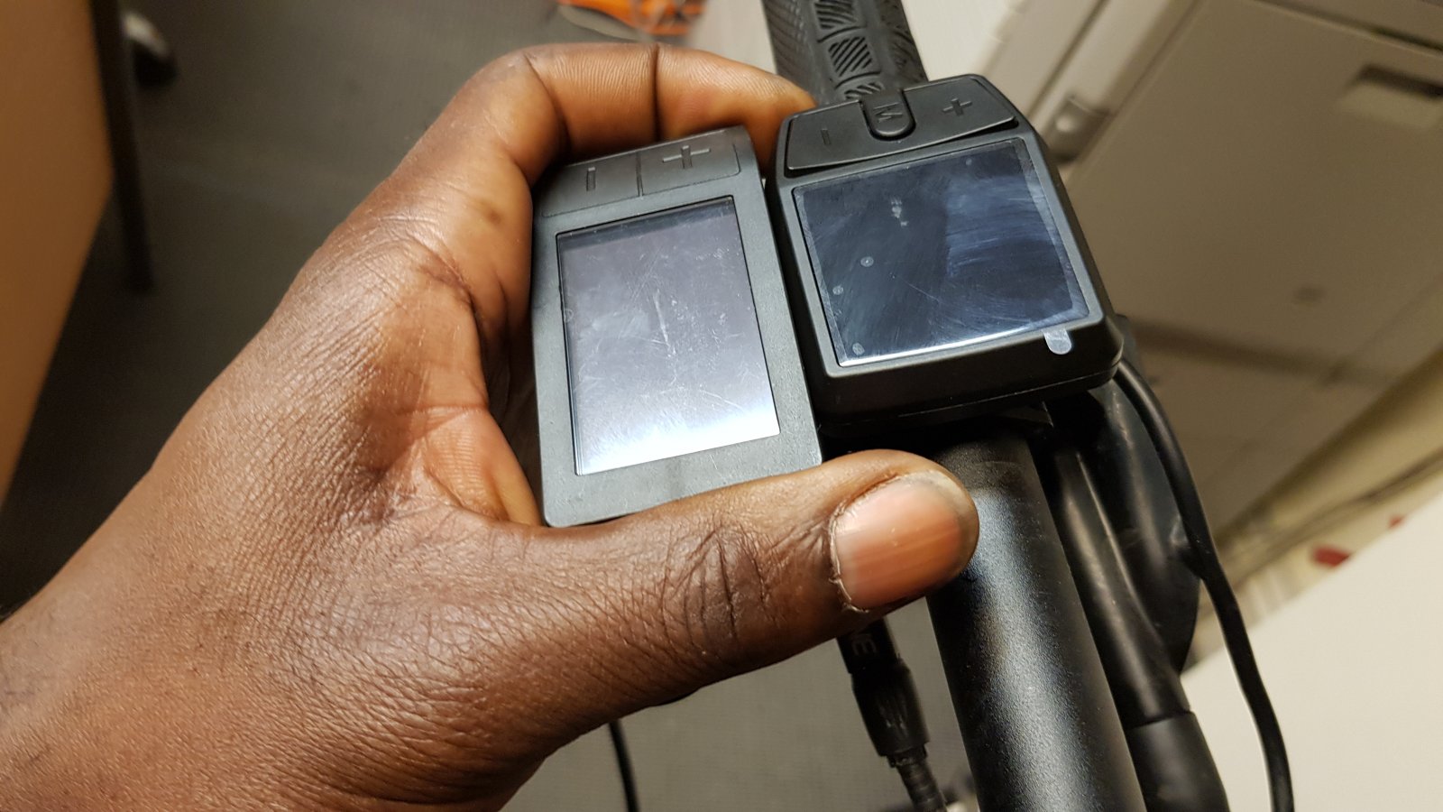

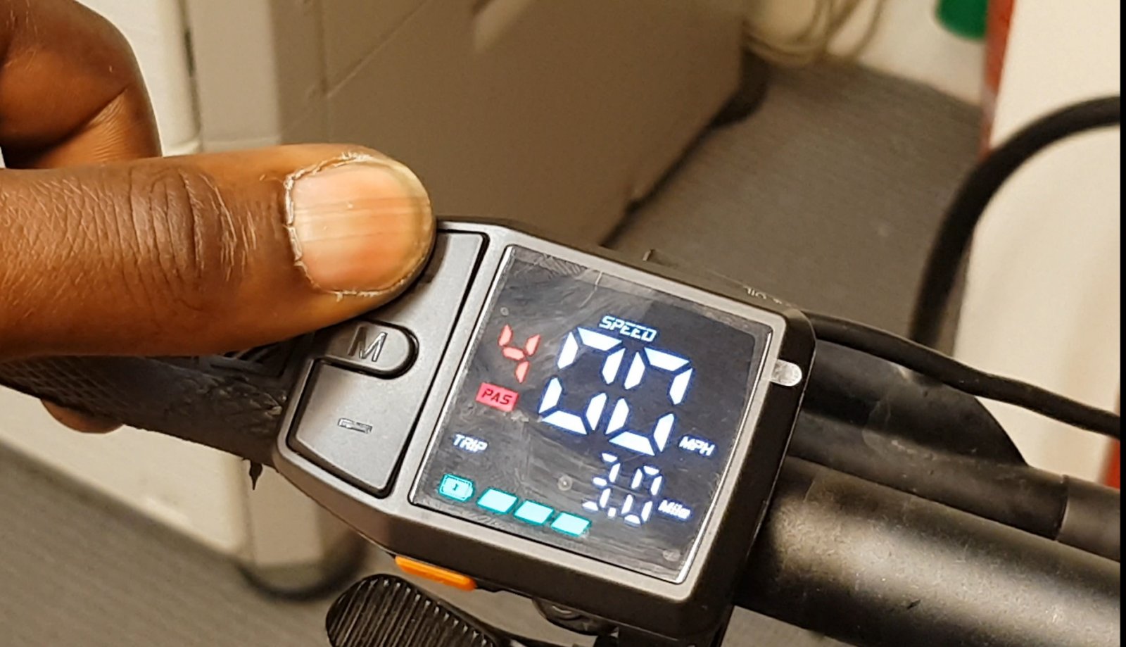

That looks pretty cool. Better than the 500C? I don't know. The minimal UI is nicer and it's certainly a shed-load cheaper...
Well, it's a smaller unit than the 500C display but with a bigger screen.
I'm just thankful I can finally run a display further outboard on my 820mm wide bars without issue.
Both displays seem to be equal in terms of protrusion.
And the DZ41 does seem more ergonomic 👍🏿

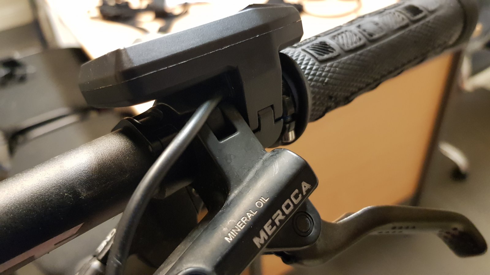

I don't know Neeko that pic illustrates to me that I would probably be hitting the mode button as well when fumbling around for the selectors? Especially when wearing gloves.
I use the 500c and the flat buttons weren't working well for me and I dribbled some super glue on them to make enough of a protrusion that I could feel it with my thumb, even with gloves on. I'll probably stick with the 500c but this one will make a good option if cheaper for those that are not satisfied with the DC18 display.

Hi,
It looks good.
You will tell us how it works if you decide to buy it.

Hi,

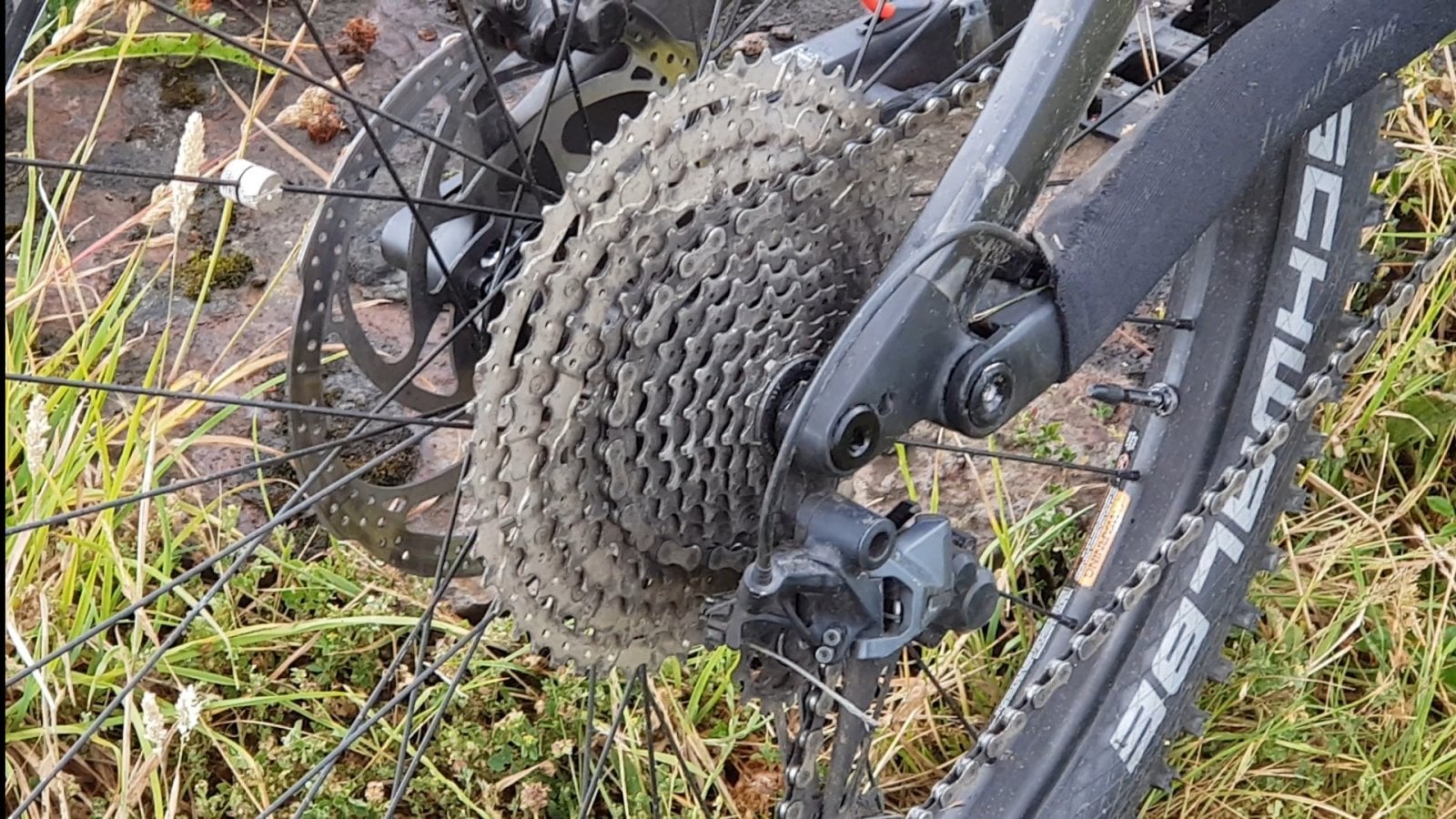

I ended up buying the expensive Christini one. I used it with a 36t chainring, and a mixed 12spd drivetrain. Using an e13 Helix cassette, and Sram GX mech.
It didn't go well. In less than 50km, the rear cassette was toast. The teeth were being rolled/worn over, and the chain hopping over the cassette teeth under load.
I think the high power motor, coupled with the smaller 36t chainring put way too much force through the drivetrain.
I have now put the standard bafang chainring on, and moved to a Box Prime 11-50t - 9spd drivetrain.
The standard 44t bafang chainring, and the Box Prime 11t highest gear gives me the exact same ratio as the 36t chainring and 9t - e13 highest gear.
I do lose gear range with this combo. But that fine, by using the standard bafang chainring, I lose all the range from the low end of the gear range.
The 9spd system is chunky. It seams tough. And it was super easy to setup. On a 12spd drivetrain, half a turn out on the barrel adjuster will cause havoc with gear indexing. On the 9spd, you don't even need a barrel adjuster. You can literally just adjust the cable at the deralier by eye, and the steps between gears are so large, you can't really muck it up.

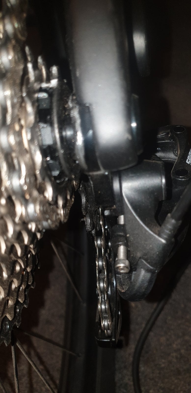

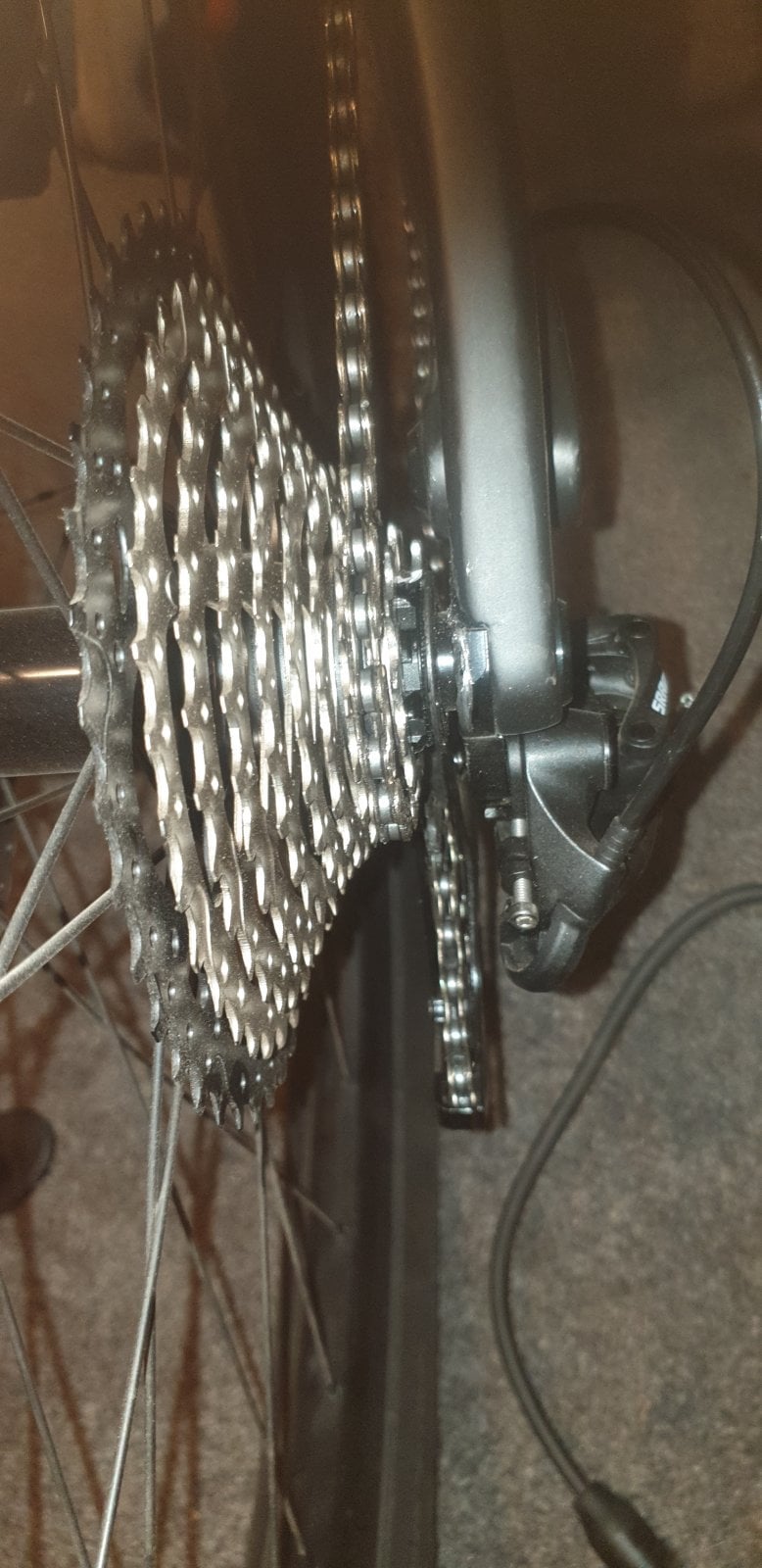

Had a wee run last night and split the cog on the cassette going to swap to a slx 11speed cassette and start greasing things !!!

It came with a 40t chainring and
Oh wow. That's hectic. You literally stripped half the teeth off the tallest gear.
What was your drivetrain setup? Chainring size / brand of cassette etc
It's got a 40t chainring, nx derailleur, and the cassette was a cheap knock off brand sunshine or sunburst or something,got a 11 50 slx so gonna try fit that!!! but yes drivetrain are an issue with this torque🙄
NX derailleurs (I'm assuming it came with NX in accordance with what Carbon Cycles advertised), might be the culprit behind the chain tension. If you can, I would look into swapping to GX derailleur only (no need to buy a shifter).
Ya I'd avoid any knock off cassette with these motors. I have a Bbhd fat bike that throws 150 NM + and has a scram 12 11-50gx no problems 2000 miles plus
