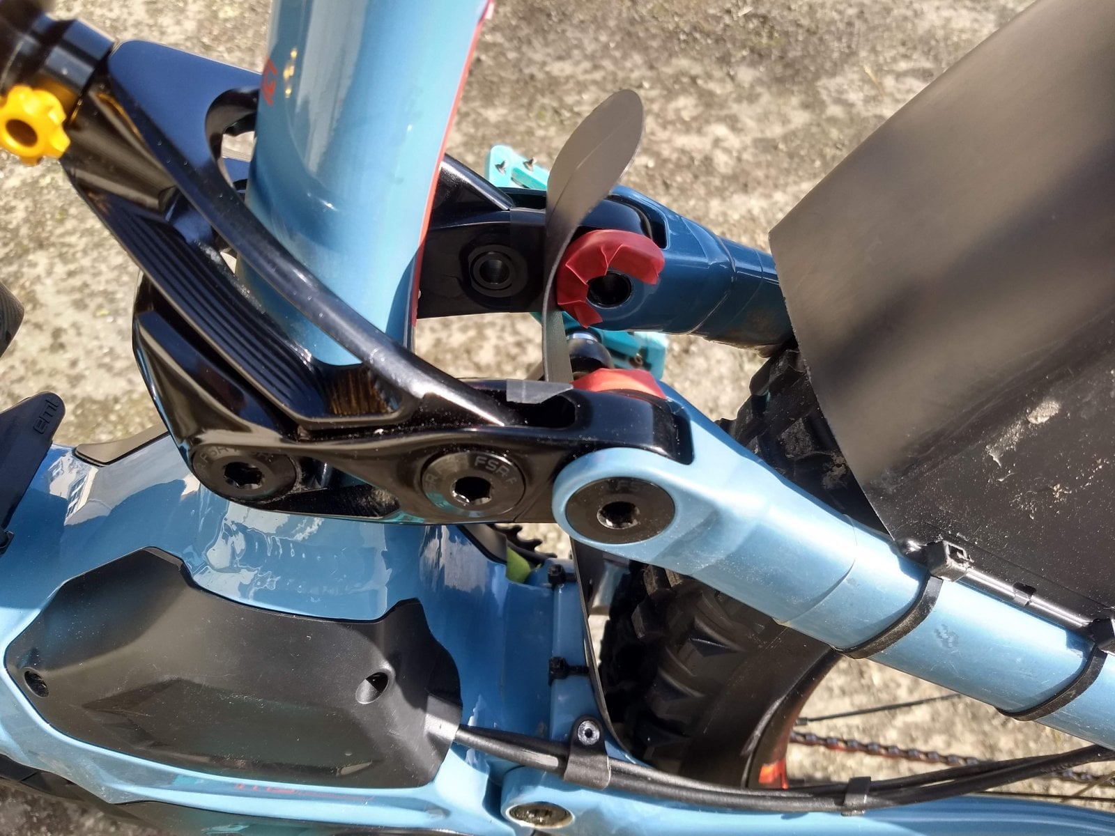

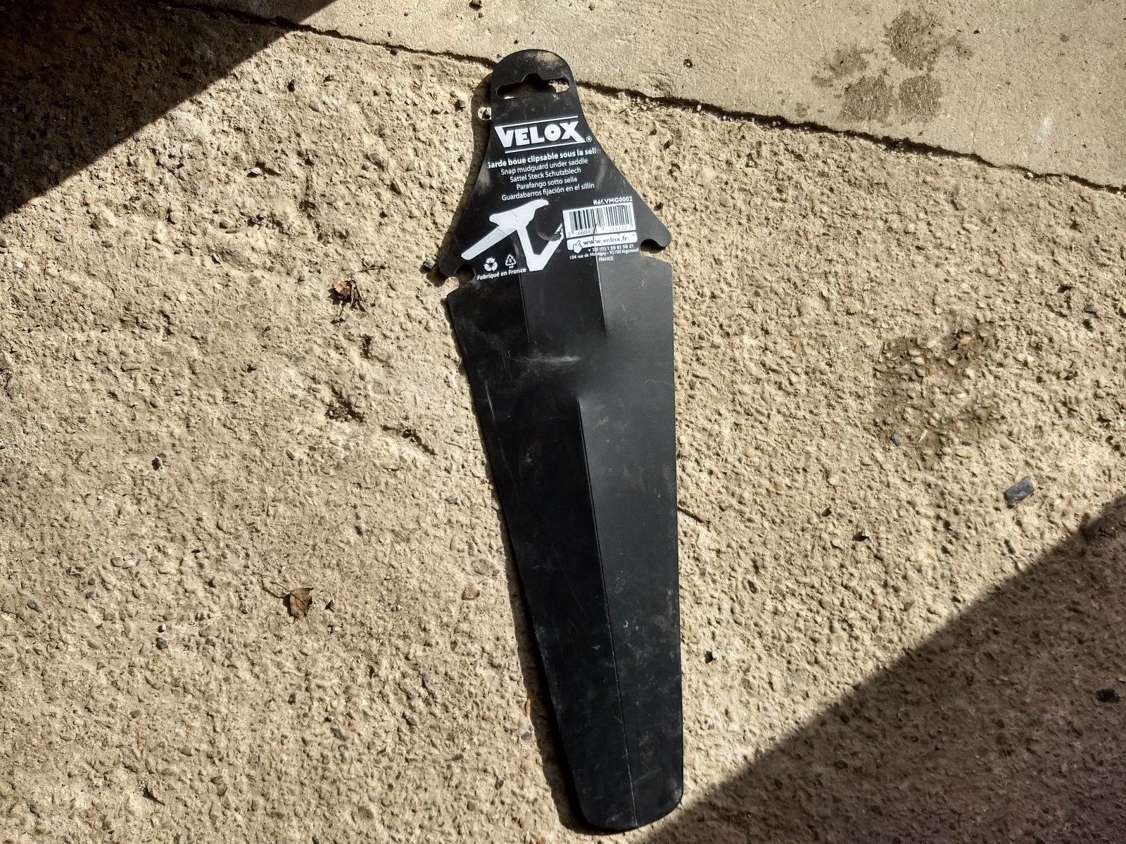

second point. It will be necessary to found an solution to avoid that a pebble gets stuck in the articulation of the oscillating arm, if this happens, something will break.

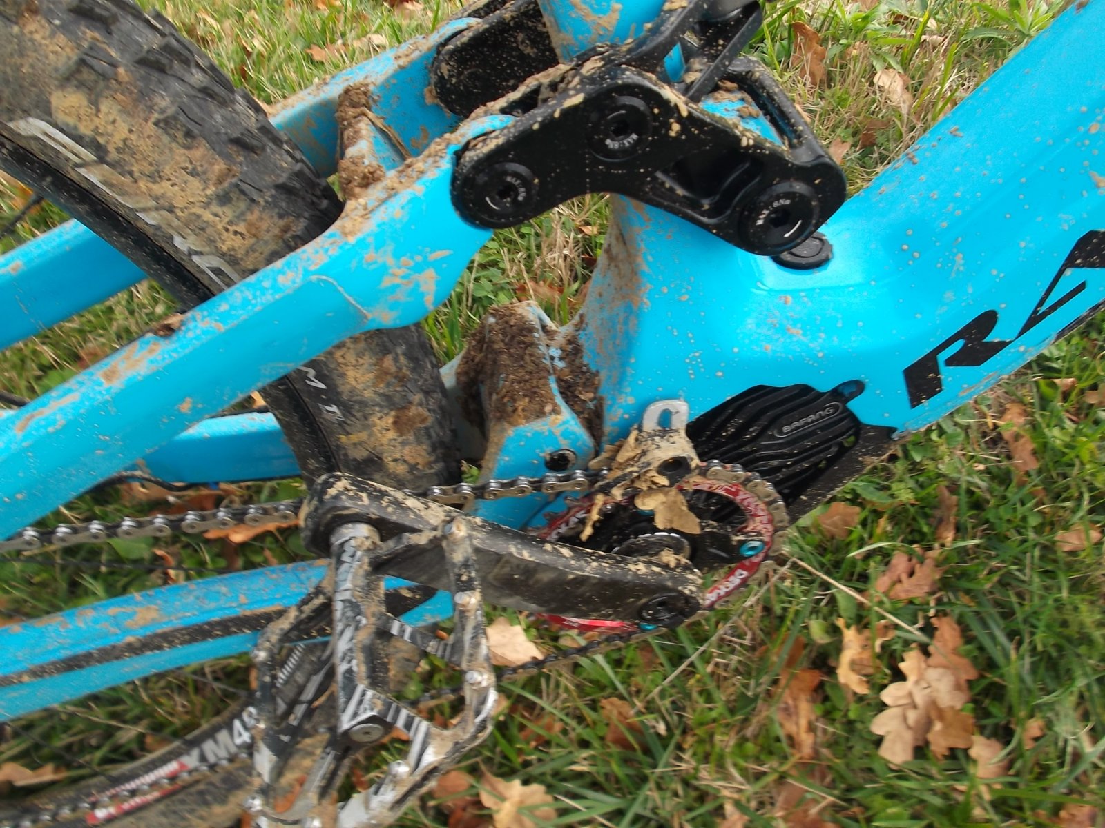

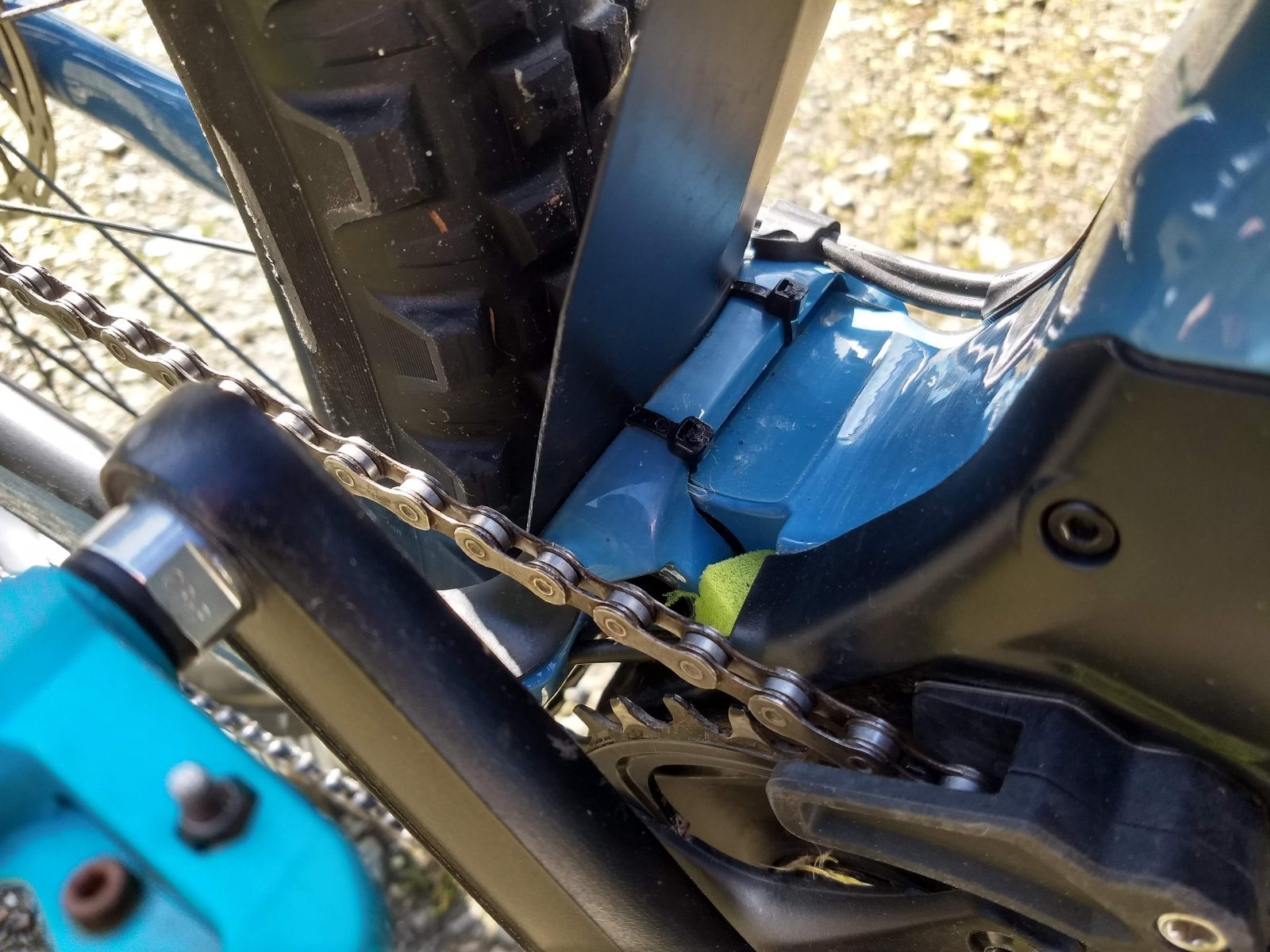

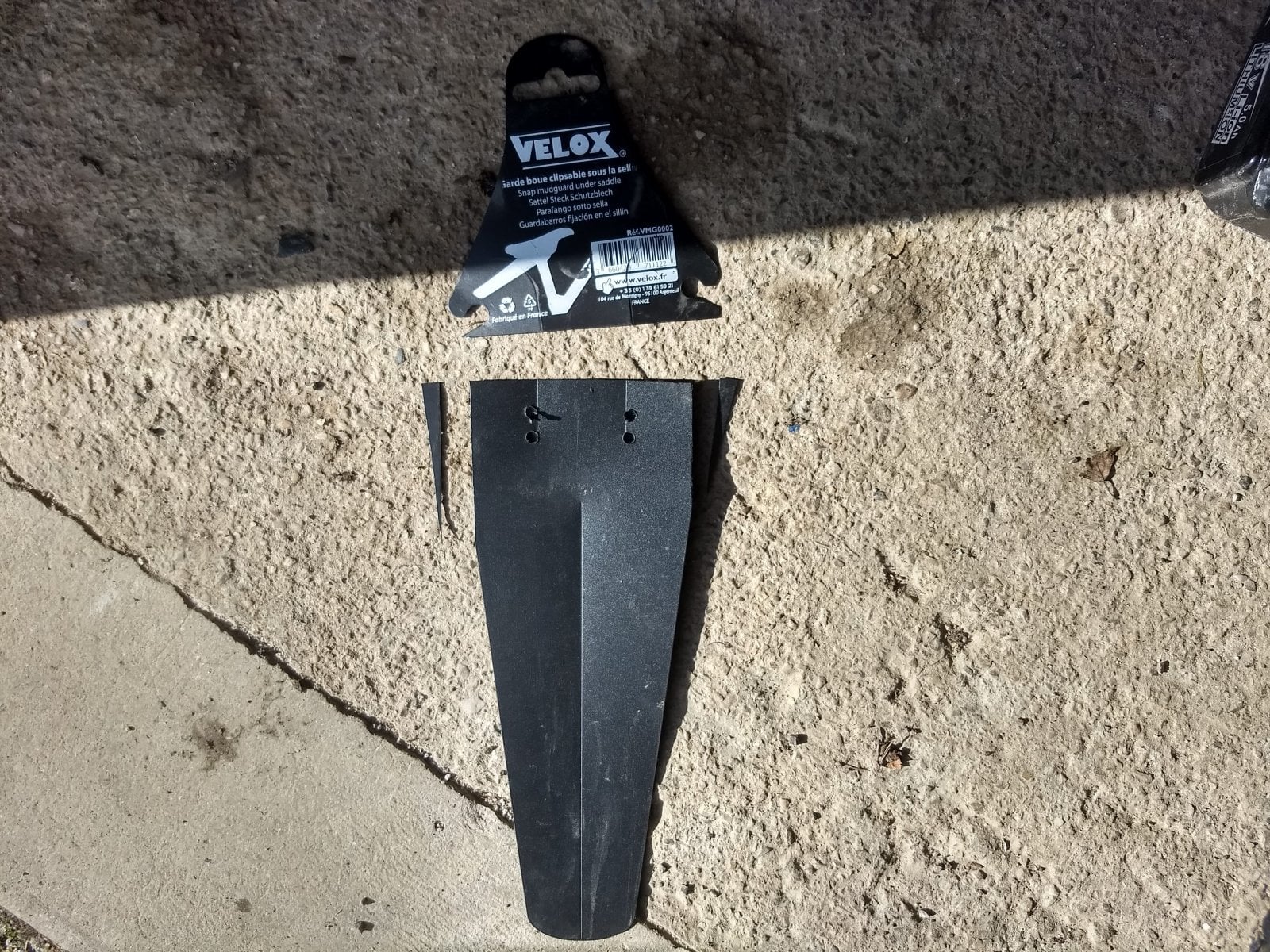

There are quite a few guards you can buy which will protect that area. Unfortunately, most of them somehow funnel debris round the outside and down. I made my own in the end from a cheap "clip to your saddle" mudguard :
I hardly ever get any dirt in the lower linkage :
Just trim it to the correct length and width. Make some holes for Zip ties.
Mount it....
Bend it so it doesn't rub the frame - but is near enough that it doesn't act as a dirt funnel !
