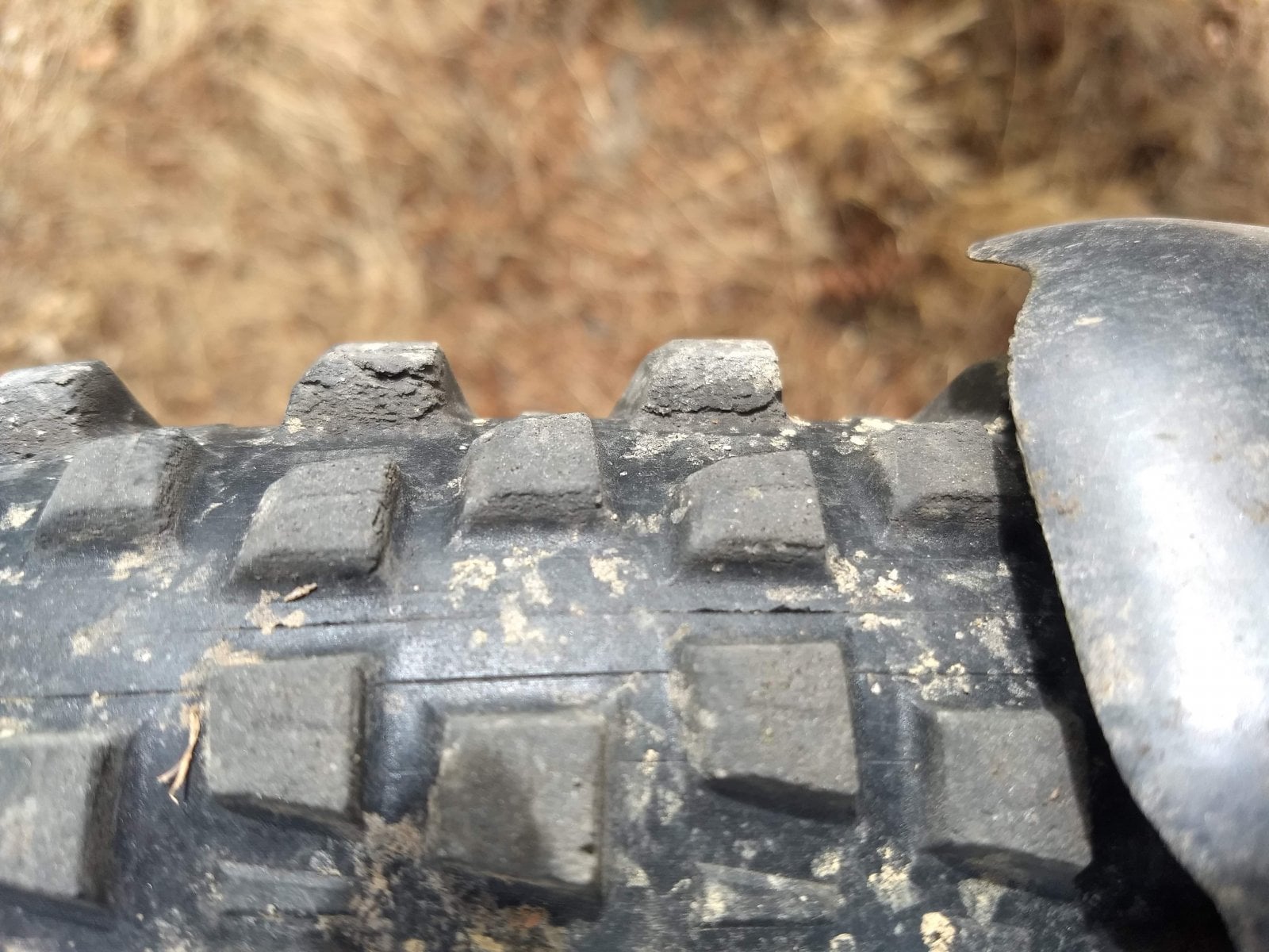

I’ve changed my mind on non ebike specific skinwall tyres. Can anyone comment on the best all rounder 27.5 2.6 Set up for all sorts of terrain, front and rear For the Stilus. I’m in a very hilly area with lots of trails, rocky tracks, muddy woodland trails, not bothered about skinwall either . Want to go for long rides and feel super stable as have a right foot disability and am a wee bit overweight :/ hoping to lose it in echo mode on the flat though! . Thanks ?

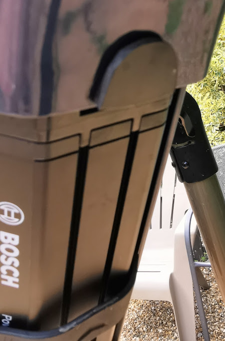

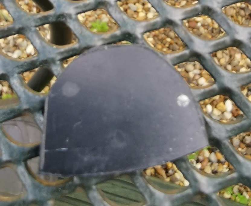

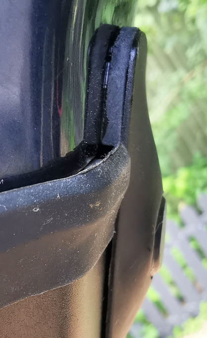

Someone posted a while ago about the gap in the catch for the battery cover. I had the same issue so have done this fix. I got some old scrap 3mm thick plastic and popped it in the gap. I then scribed round the profile and cut this out;
I then smoothed it out and superglued it into place on the frame.
Once that was done I dismantled the catch and cleaned and greased it to be sure it would move smoothly. I then reassembled everything and fitted the cover back. No more gap. Took about 20 minutes in all. My only concern is will the superglue hold but I can always try something different if it doesn't.
You could go for a DHR/DHF or DHR/DHR combination. I think Rob likes this setup. Magic Mary's will give you lots of grip and solidity. Eddy Currents also. Personally I like the E-wilds. Lots of grip and predictability in all conditions. Lower rolling resistance than the others mentioned and slightly quieter. Slightly less mud plugging ability with the smaller centre knobs, but they've only let me down once in thick mud. @PhilBaker has just put a pair of 2.6 on a Stilus, so can probably give you some Stilus related feed back. They also seem fairly good on longevity and not disintegrating with abuse ...
Thanks Zimmer appreciate

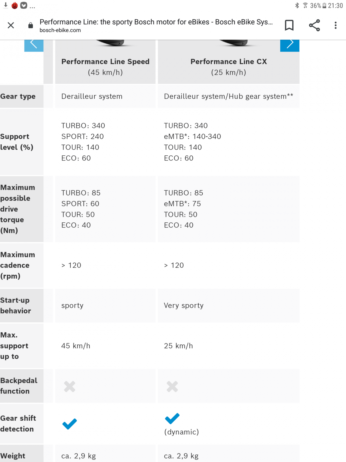

I can see what you are saying but if it was 85nm across the board then the different modes wouldn’t feel different. It makes sense to have the full 85nm available In turbo. If 85nm was available in every mode then eco won’t use less power than turbo. What I’m saying is that the software update has added increased torque in the other modes, eco was 40% support previously and now it’s 60%. I can’t remember what tour was but now it’s 140% support.
Good find on the stats.
TheBikePilot
🎥SHOOTER🎥
Oct 9, 2018
928
905
Clapham, London
In EMTB you have turbo available with the right amount of torque through the pedals. Where this update seems to excel is low cadence startup, and on the trail when you need a kick and over technical climbs. It also feels more natural. Don't know about Eco and Tour. It's super fun.
This is a very, very fun bike. Maybe as @Gary has said it suits me and Rob being that bit taller, the geo works for us. I think most bikes are made to an average height and somehow this has just hit the sweet spot for our proportions.
In any case, it's an absolute ripper. I can see it being very hard to get hold of now with over 100k views and all the positive feedback rather like the 2019 Levo..I hope they can ramp up production..
