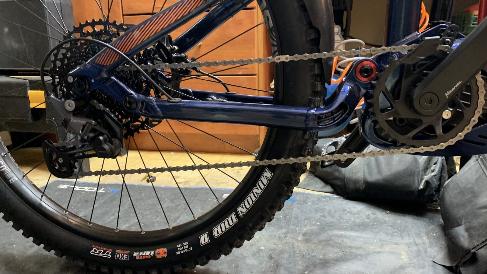

The SX clutch on my brand new V2 was non-existent - so opted for a Deore M6100. £15 cheaper, with a real, repairable clutch you can turn off. Will miss the cagelock, but hey.
Happy to report the shifting is even better. The pull ratio must be identical. Can't wait to get out there on it. Meanwhile, anyone want to buy a brand new SX noodle? :)

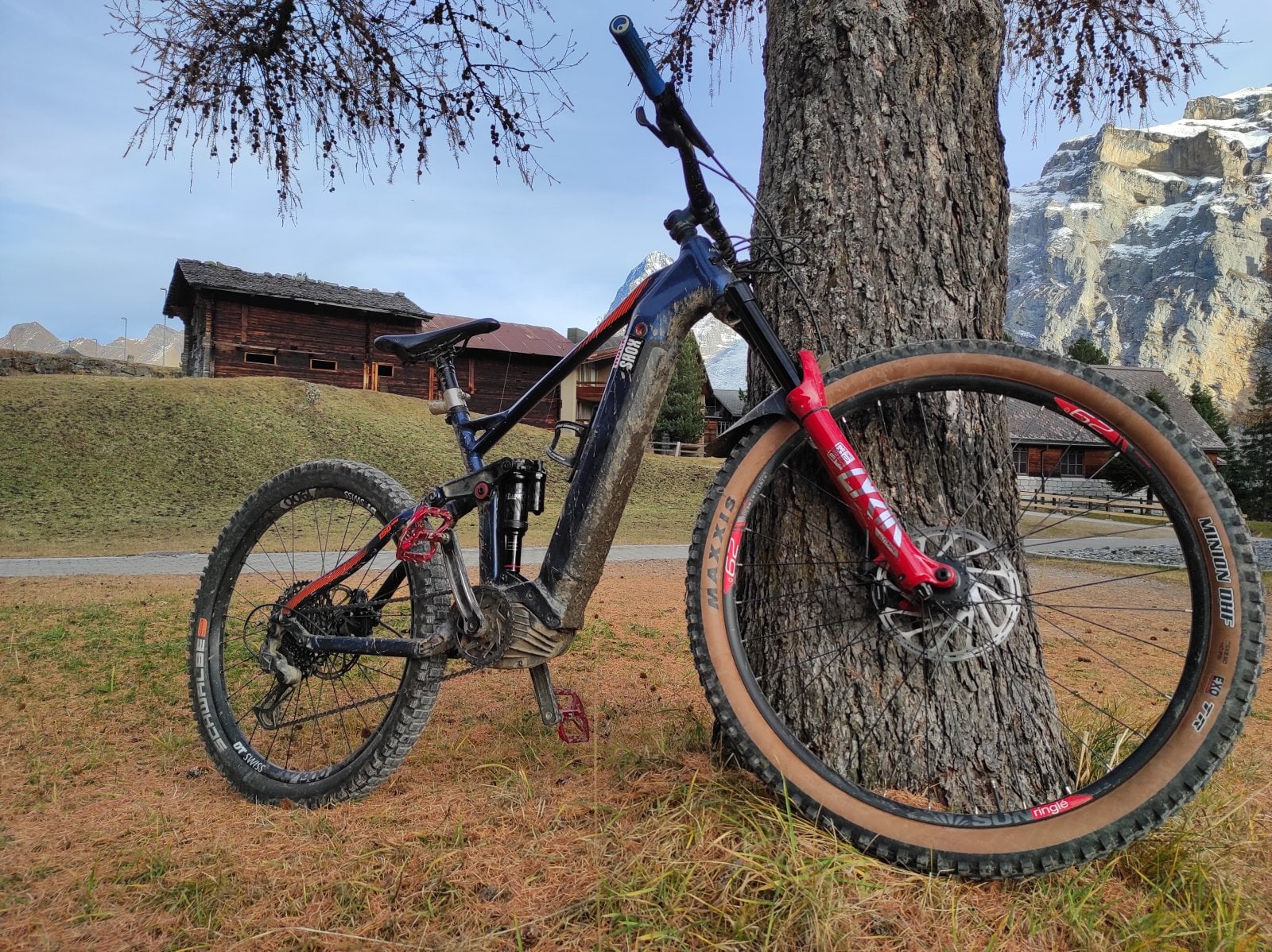

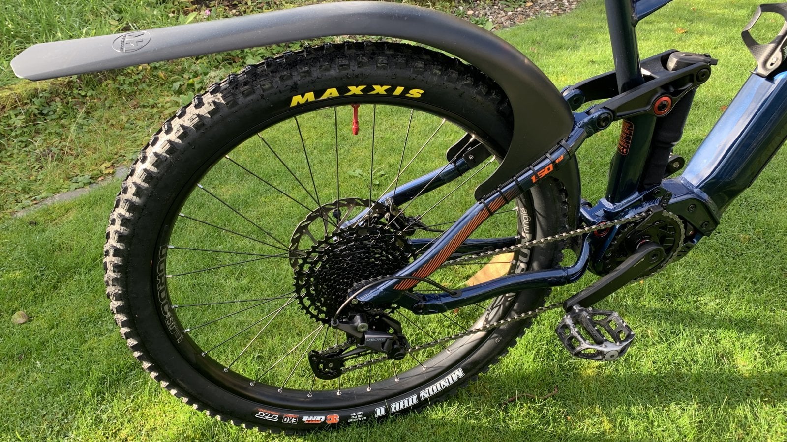

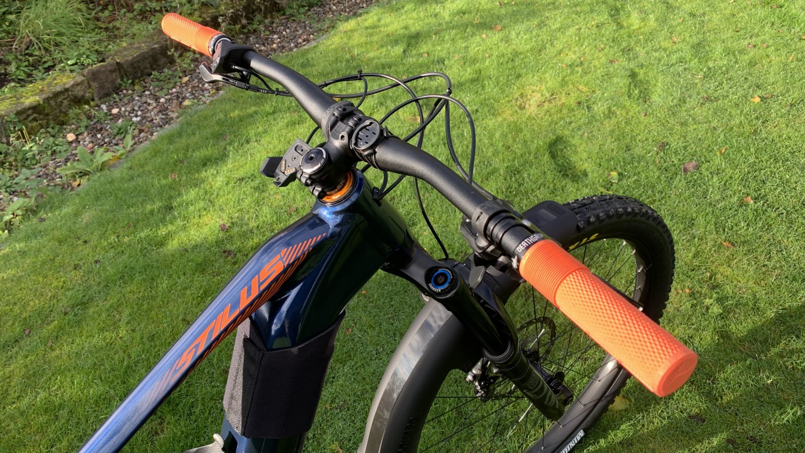

Finally the V2 is ready to go;
Deore 12s mech - matches the SRAM ebike shifter and has a clutch that works!

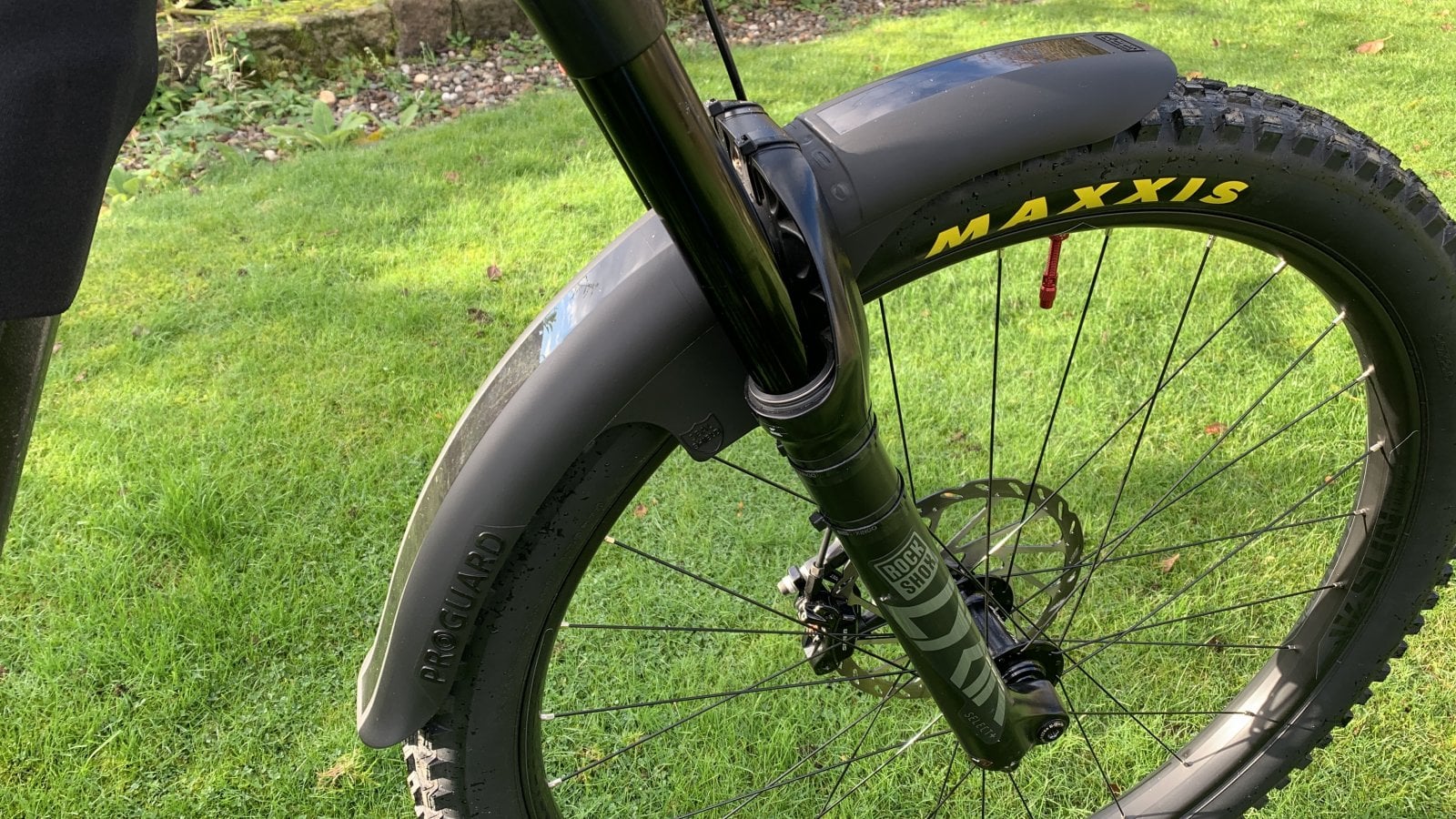

Mudhugger large
RRP Proguard Max
Lyrik Select+ 29” - Le Grande Mullet
Miranda 155mm cranks
Deathgrips
Kiox display on Cube Acid mount
Madison Flux saddle
Minion DH’s
Cut-down Fahrer neoprene bty cover to protect lock and latch (and the rest of it for below-zero insulation)
Lizardskins shock cover
…and most important, the £5 Hope top headset bearing cover :)

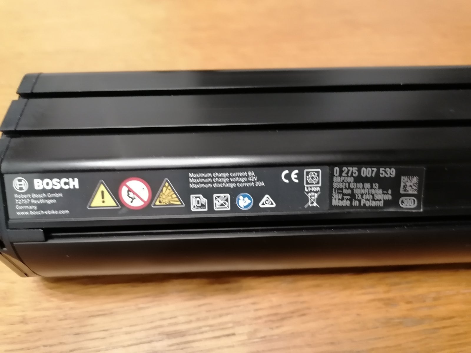

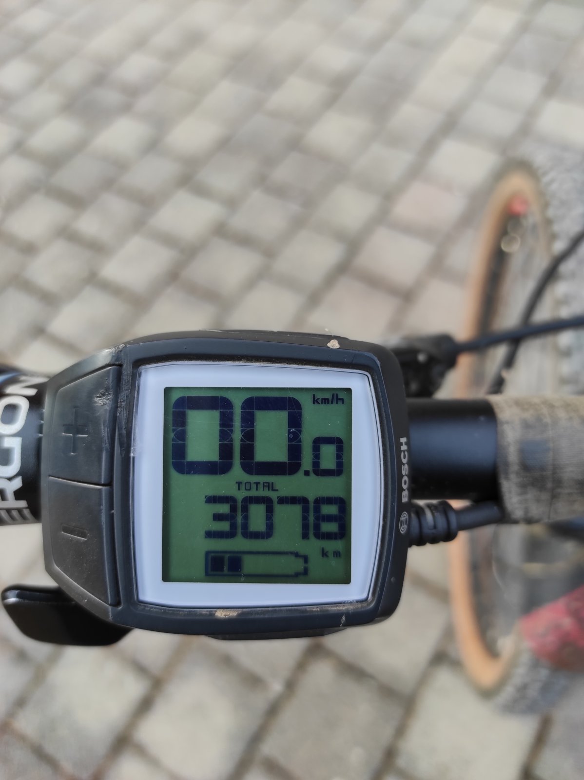

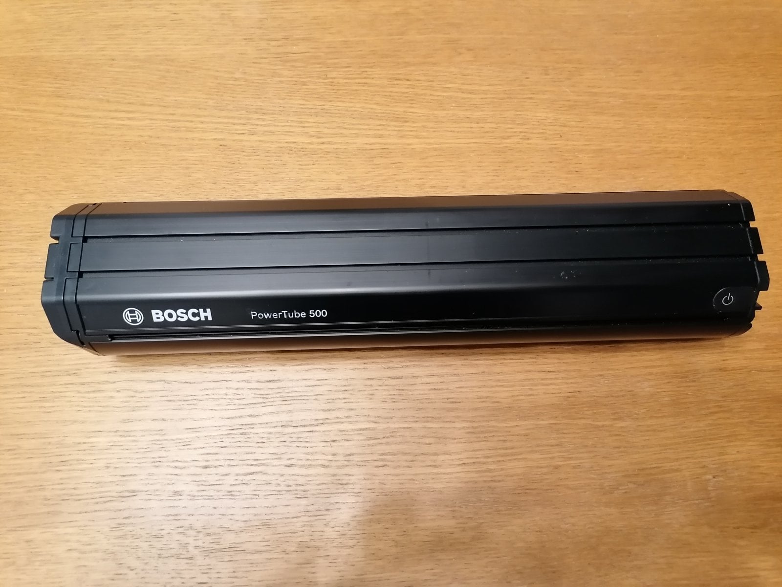

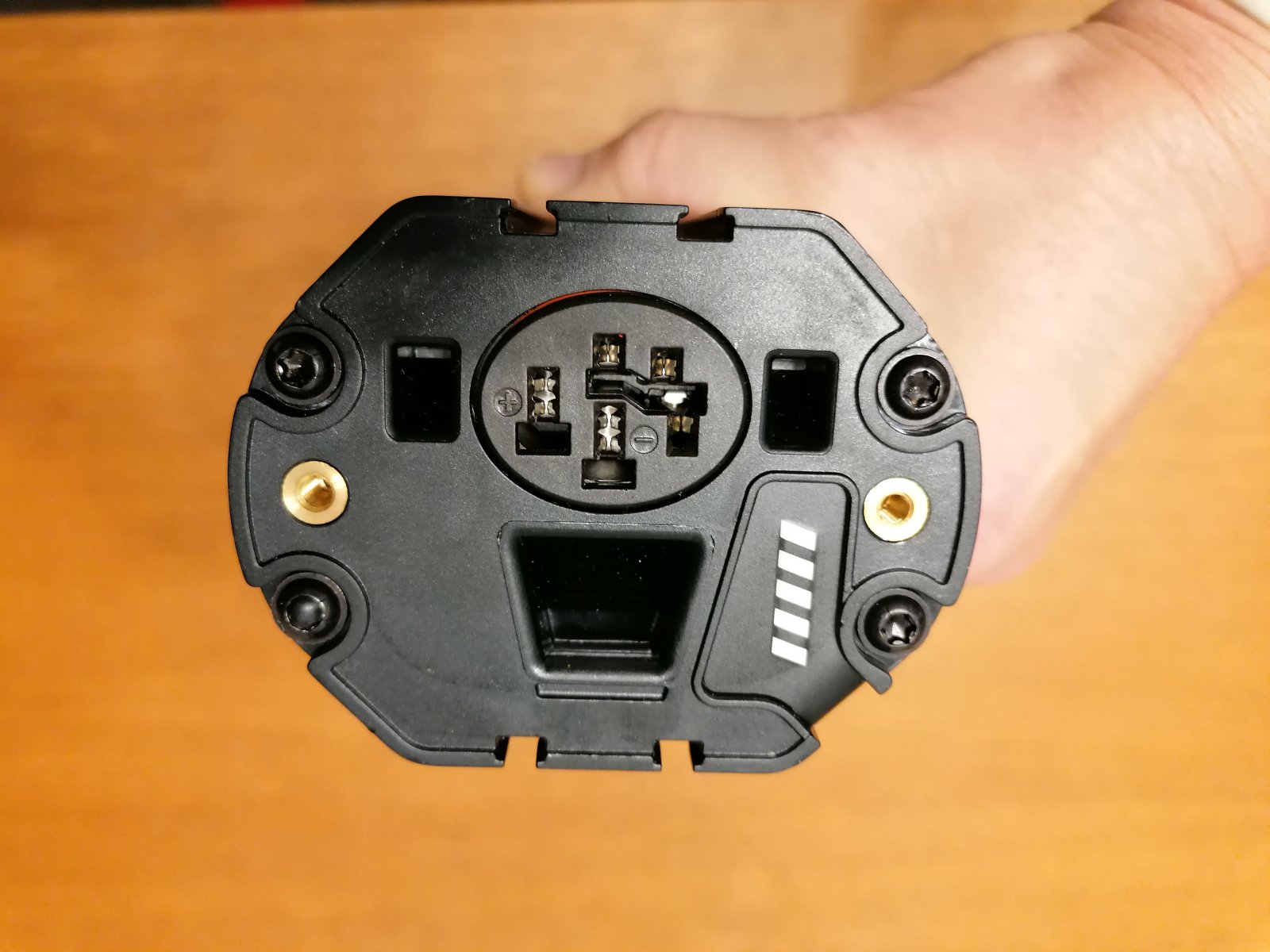

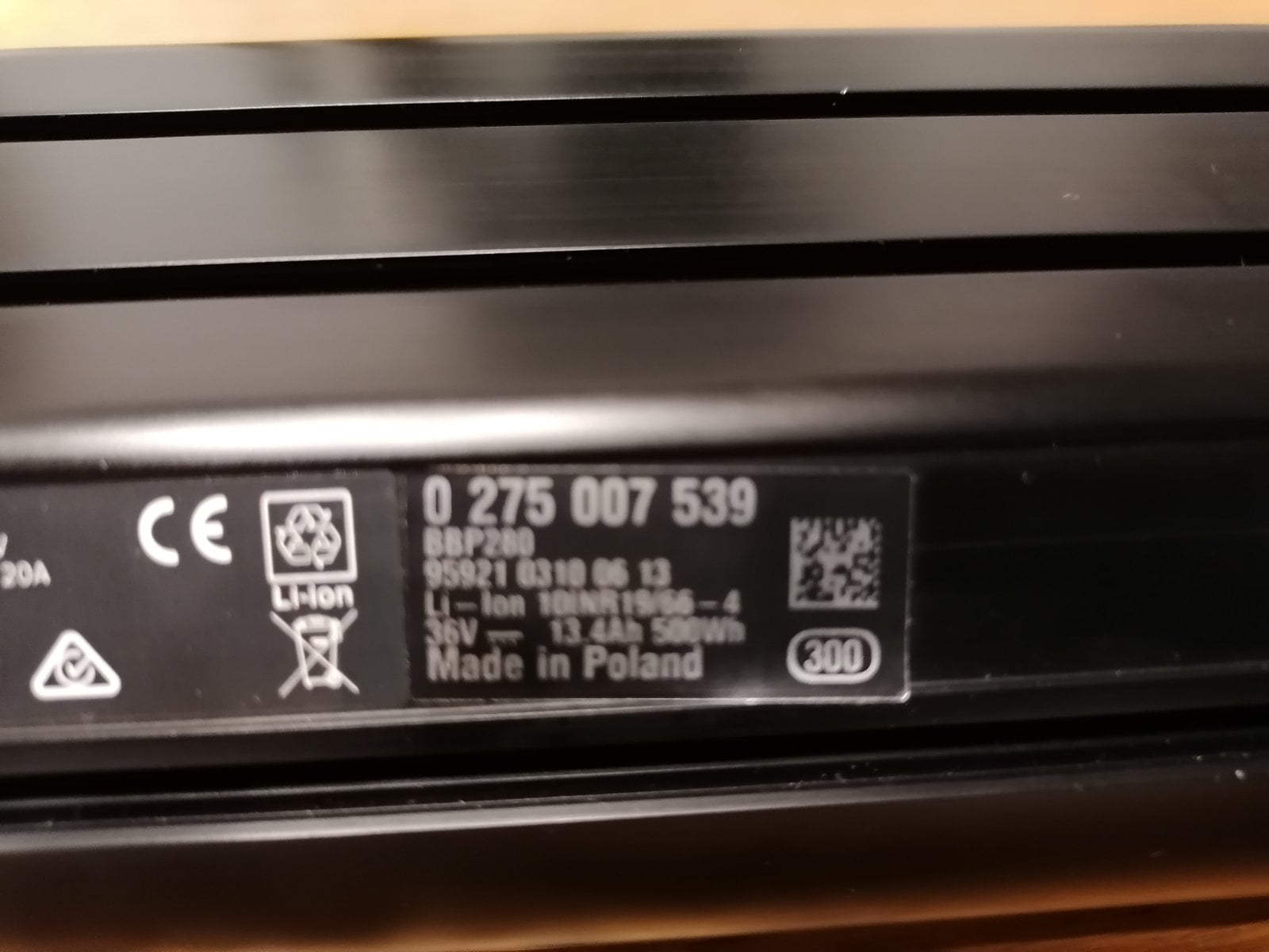

Just picked up a new 625w battery, so the 500w is now for sale.
Nearly 1600 mile on the clock. Kept indoors after every ride.
Bought Stilus mid July 2020 (if you look back at the early posts for the Stilus, you will see I am genuine and have not disc cut the thing out or someone's pride and joy) to use for cardiac arrest Rehab (really!).
I love the thing and have recovered enough to need a bigger battery.
So, £300 and will look into postage costs if needed (buyer pays), would prefer buyer to collect from South East Wales (Blackwood area).
Posted here first as I knkw you guys are like minded bikers.

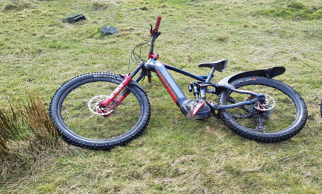

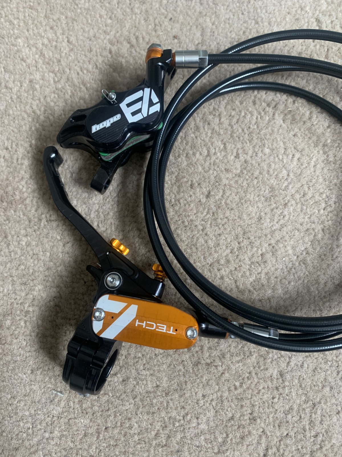

Think I have finished my stilus upgrade list now, with the exception of a 625 wh battery ( still doing ok on 500 for now)
1.Wheels
Front HOPE FORTUS 30 29
Rear HOPE FORTUS 35 27.5
2.Tyres Eddy currents 2.6 tubeless Foam tyre inserts front and back . 3 rd set
3.Bars Renthal fat bar 800 alloy.
4.Brakes Hope e4
5.Stem Hope 50mm
6.Pedals Hope
7.Cranks Hope E bike 165 mm
8.Seat Post Brand x 150 mm ( really good post for the money prefer it to my reverbs)
9.Forks Rockshox lyrics ultimate 29 170 51 off set.
10.Shock Fox Evol performance Elite.
11.Seat selle Italia Gel got it free from LBS
12.Shimano SLX mech and Changer.
13.Brand x rear axle
14.Brand x chain device
15.E thirteen chain ring( they do not last very long but cheap and available)
Done about 3500 miles on it now, replaced motor at 2700 miles on warranty , also got £400 refund back from Decathlon for original forks that defaced on stanchion very early on, they were garbage forks TBH.
I still find this bike to handles anything I throw at it, clangs a bit on landing big jumps and drops offs, that could be the mudguards though, current head angle is about 62% so very slack but still climbs well. in the mullet set up front is very easy to lift when manualling large holes or puddles.
Mudguards look terrible I know but need them currently.

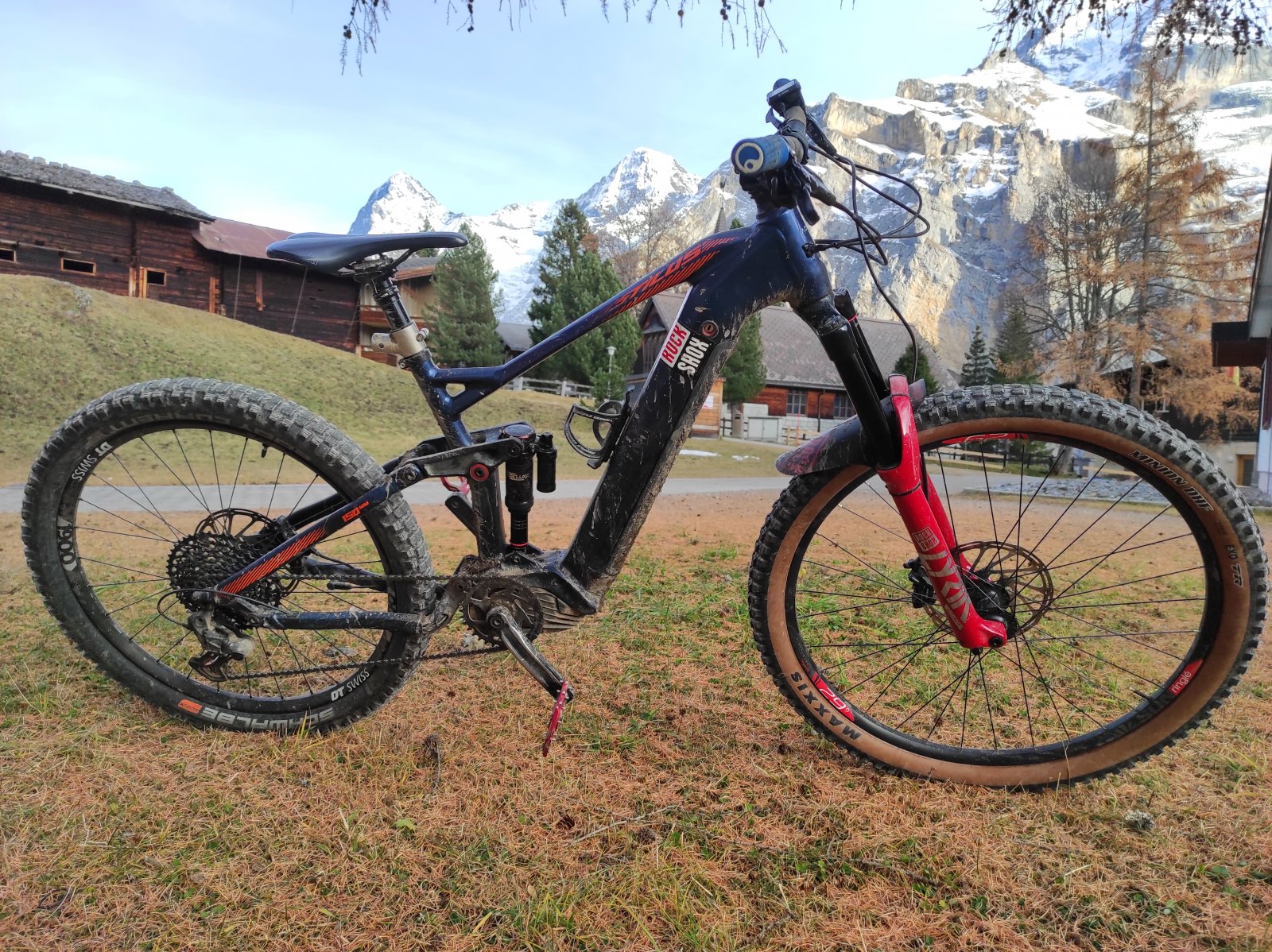

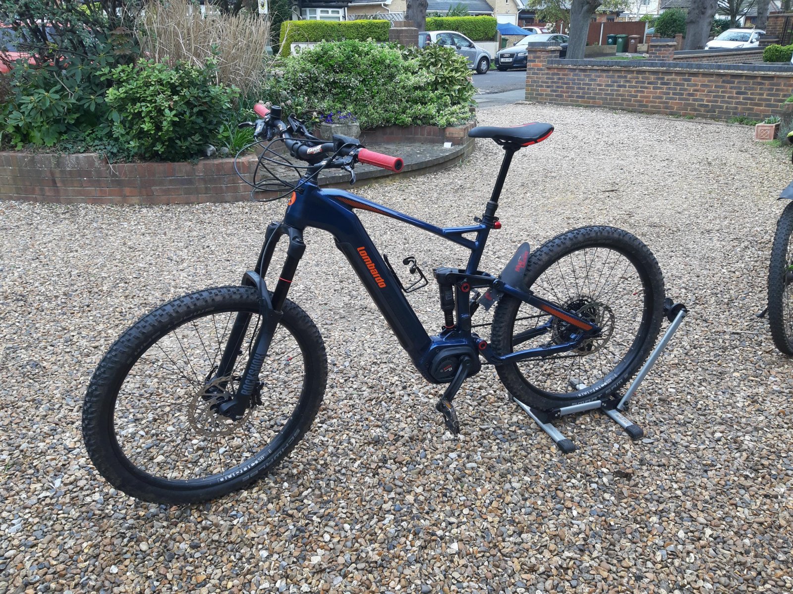

somewhat late on this topic but hey ho heres my Stilus its a 2021 model. V2
Upgrades, Pedals ( dont know which ), Bars ( renthal fat bars ), Grips ( race face ) Seat (decathlon comfort series )
OEM Logos next and only other upgrade would be Michellin E-wilds..!
Motounion
Jan 17, 2021
10
Shepperton
Glad you like them, design lifted from the official Lombardo ebike model Lombardo Sempione.
silly really I was somewhat put out by one of pals suggesting smugly from his elderley cube ebike that my bike was unbranded..!
