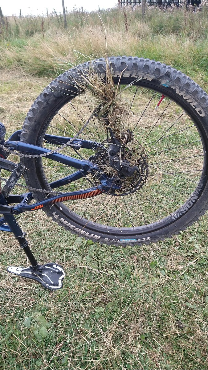

Another thing to check on these. I rode through a freshly mown field at the weekend & picked up a fair bit of... cargo. Stripped the cassette down to clean & clear the grass & generally check it over & found the mech hanger bolt loose. No loctite on mine either. That could spoil your whole day if it were to let go.
Yeah, it's a amazing how that little bolt gets forgotten in the check over by a lot of people.

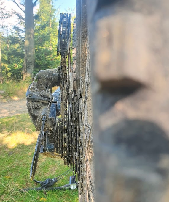

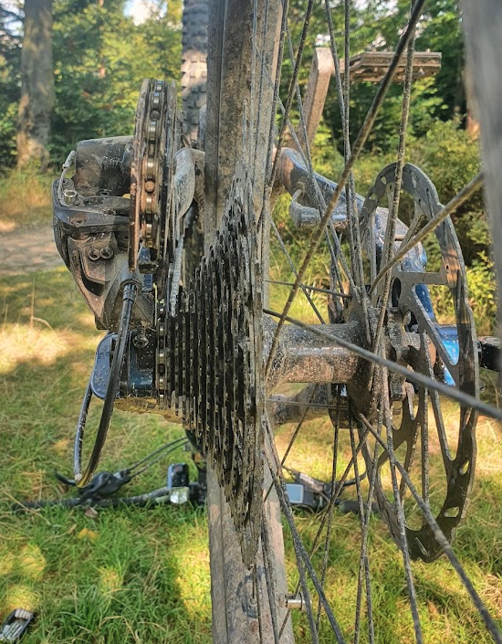

Has anyone had problems with their derailleur? Mine appears to be bent (no wonder I can't get cable tension right). No crashes, can it be just from shifting on steep ascends? Internet opinion on Sram Eagle SX seems to be pretty low.
Rear mechs do not last to long , my original eagle did not snap but was bent and just worn out so i replaced with shimano deore which i then snapped, currently on a SLX mech as it was all we had between us in back pack at time of damage..
Is it deffo bent? I was surprised at the really odd bends on my brand new SLX which I bought to replace the SX on my bike. So odd in fact I was convinced it had bent in transit but the packaging was mint and I found there was a clear note on the instructions (with pics) which confirmed it is actually designed to be like it in order to help indexing. I was super surprised, I had never seen anything like it before!
You're running an SLX mech on a SRAM drivetrain? Does it work ok?
As above, I fitted one to my Haibike and it shifts perfectly, although I did use an SLX shifter as well. Only because the SX shifter appeared to be made of pasta like the SX mech. I did read somewhere that the SX shifter was fine indexing the SLX mech though.
Well, I can't make it shift half-decent via cable tension. It just skips and jumps. Also, 11sp Sram NX on wife's bike looks straight at every gear. On the other hand, I've had no crashes so it must be bent just by chain torque which is never happened to me before.
