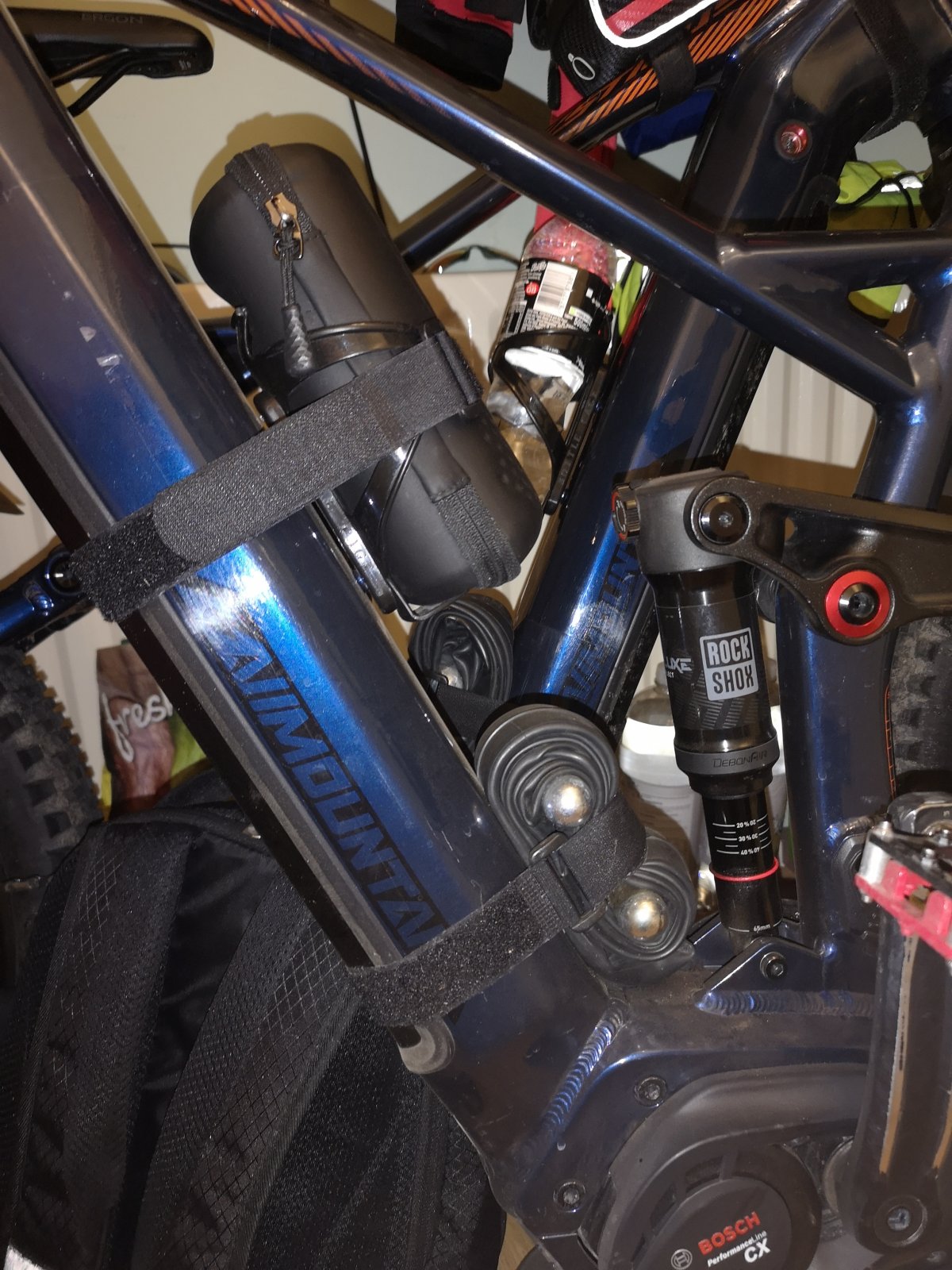

Finally got my replacement battery cover from Decathlon Bolton via Lombardo, £29 reduced price due to slow turn around and the fact they said it’s not a warranty part. Will be implementing some crap system to stop the slide mechanism getting stone bashed again.
taxidriver50005
Jun 17, 2020
211
137
Skelmersdale
Velcro strap doubles for extra security

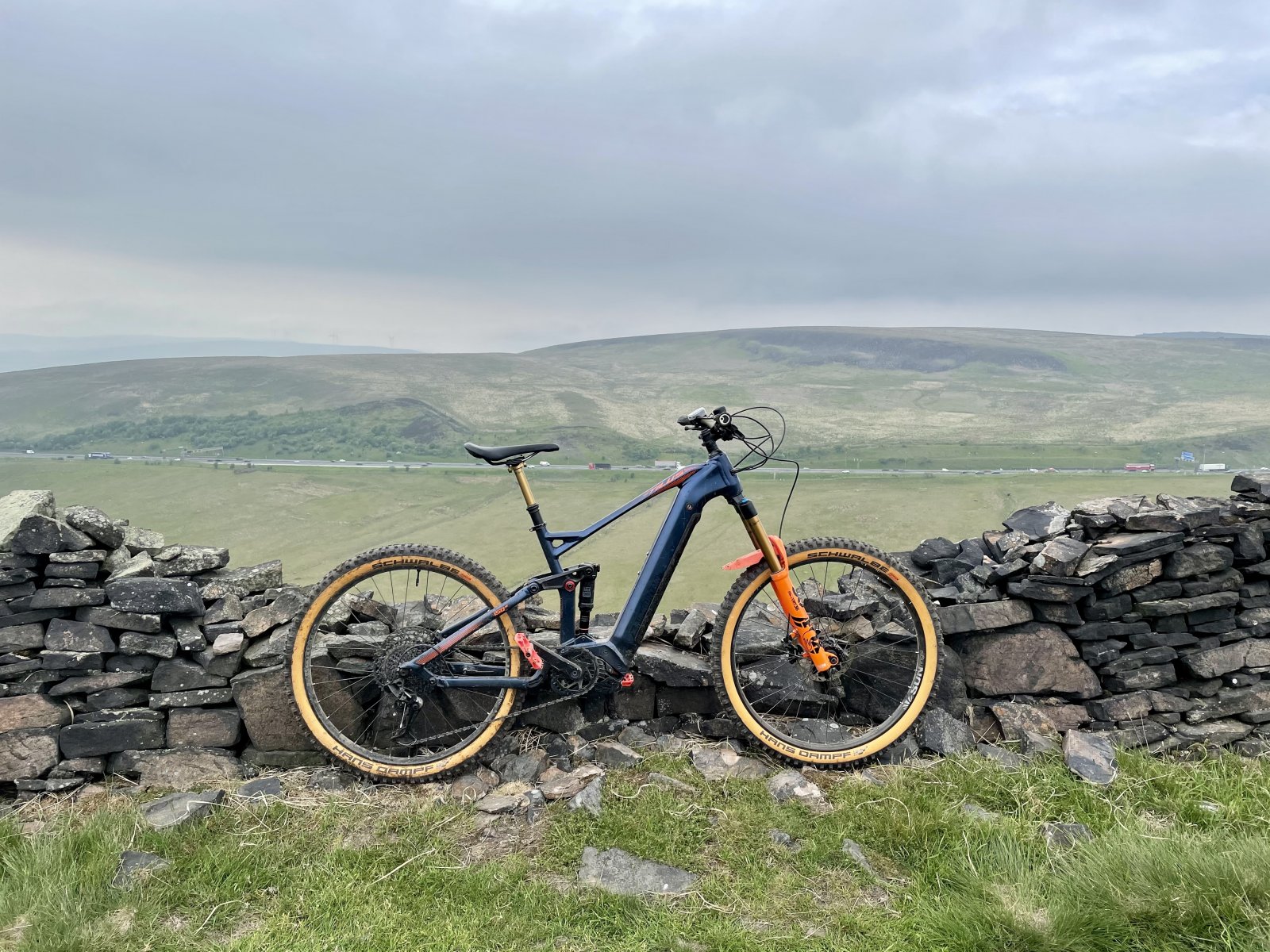

Was made an offer I couldn’t refuse on the Stilus so sold it. I have now settled into the Wild FS and loving it.
Looks lovely man, I don’t blame you . I’m over calderdale way.. might see you on the tops:) Will look out for an orbea and shout PIGIN !

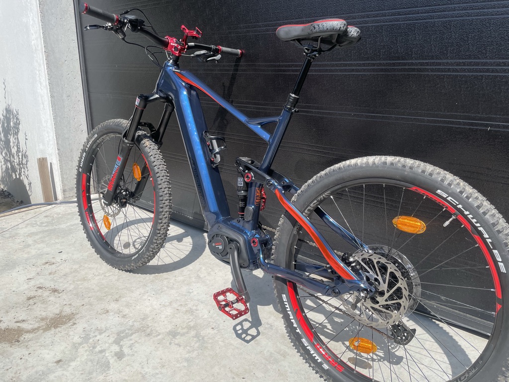

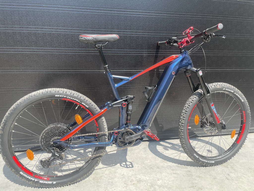

I'm interested in volspeed V3 , please report back how was installation and if there were any errors..
Installation is super easy, adjusting speedlimit is also pretty simple , made some miles with speed limit 45km/h to keep u with race bike buddies but I kept it on 35km/h most of the time to avoid 504. Did 100 km this weekend with average speed of 30km/h but not planning on using the bike for those kind of road trips.
There seem to be a speed difference of about 3km/h on the purion display compared to the race bikes. Stilus speed gives 35km/u while race bikes give 32-33 km/h.
Is this a setting in wheel size that can be changed?

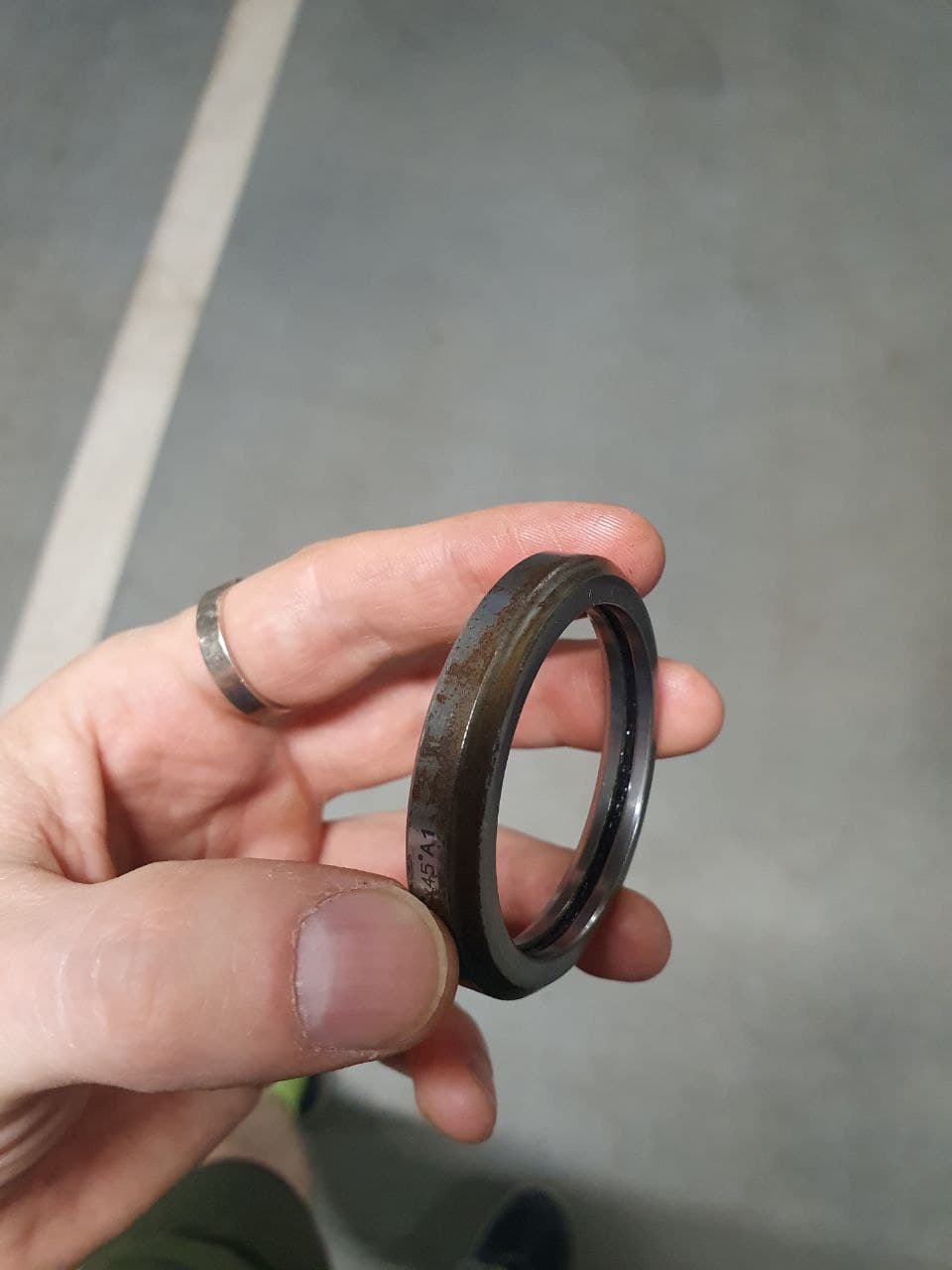

Was looking for a source of cracking sound. This is how a lower headset bearing looks on a 3 weeks old bike. No pressure washes, few rainy rides only. What strange is that everything else around is clean, no rust anywhere else. That makes me think that the bearing was like that when installed on the bike. ¯\_(ツ)_/¯
RustyMTB
Jul 22, 2020
2,952
7,107
On the subject of the lower headset bearing, mine's knackered too as many of you know. OEM fitment is an FSA bearing, so not a Decathlon corner cutting thing per se but anyway, looking into it, the bearing is fairly generic & fitted on loads of bikes- standards innit. If you wanted to replace, you need a 51.8mm 36/45 in either 7.5mm or 8mm depth, 40mm internal.
If you don't know already, 36/45 refers to the external angle of outer bearing I.e. it's 36 degrees then 45 degrees. Everywhere I look, they're about £16 & I guess fitting a shorty mud guard to the fork arch will go some way to protecting it from the worst of the dirt & water.
Rap Dance 9000
Jul 15, 2020
230
149
Yorkshire
Useful to know taking mine to bits in a couple of day ?
