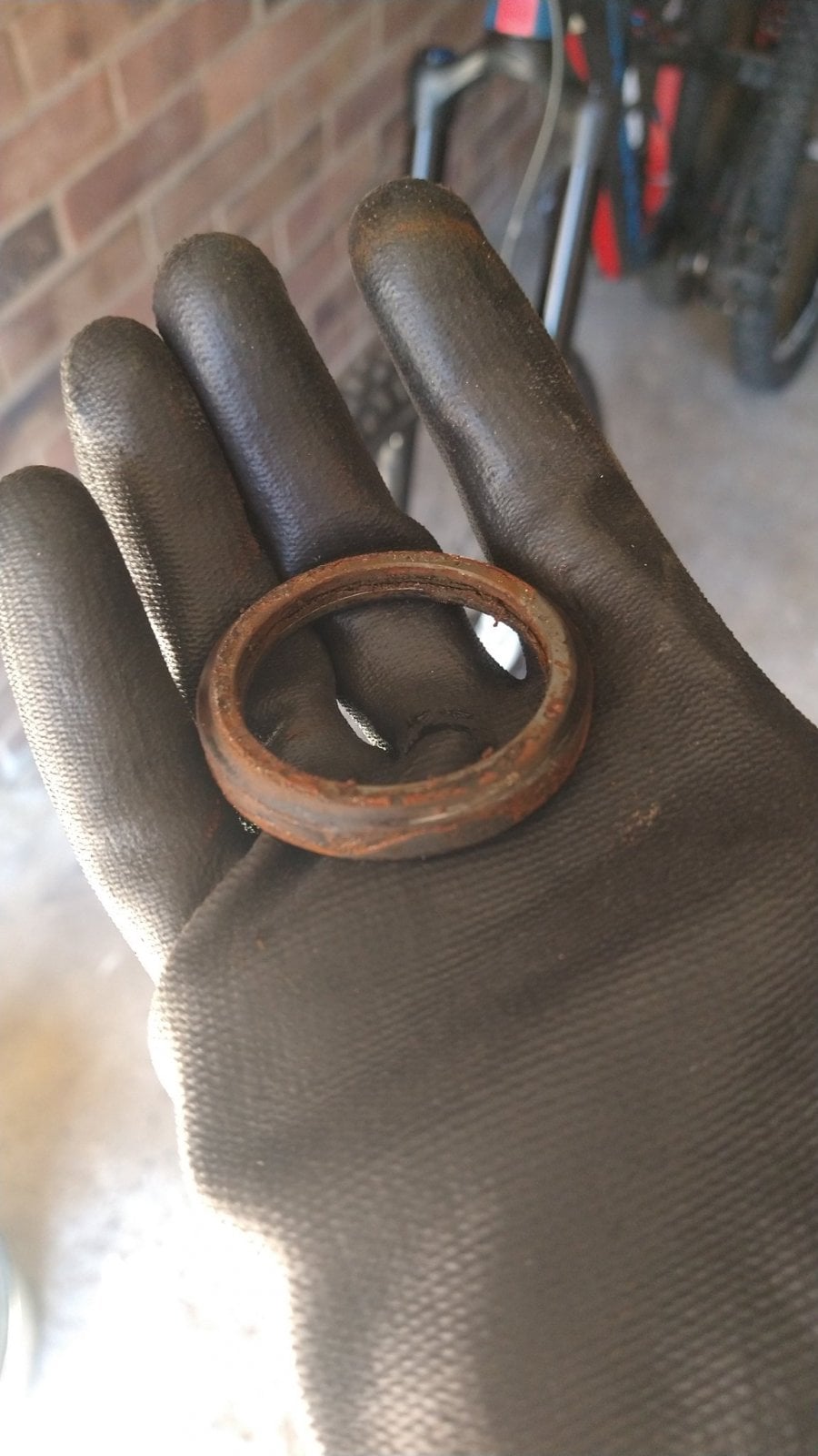

I had a big ride earlier so a day off tomorrow which I'll use to take the fork out & have a clean & grease everything up session. I'll let you know if that's it. (y)
RustyMTB
Jul 22, 2020
2,952
7,107
Did a strip down, clean up & re-grease of everything around the fork. I found the headset bearing to be fine. Although it's a cheap embedded race, it is covered quite well with two layers of protection. The fork crown race bearing however wasn't so impressive. It's a bit crunchy, even after cleaning & I'll replace it at the next service despite the fact it's only been on the bike since November. Seems to have done the trick though, based on a quick test ride.

@RustyMTB what types of bearings are used in the headset? Do you know diameters and angles of the lower and upper bearings? Mine also started to crackle, so I think it's time for replacement.
RustyMTB
Jul 22, 2020
2,952
7,107
I don't know tbh, didn't measure anything. What I can say is the headest bearing itself is a thrust bearing I.e. the individual ball bearings are embedded in a plastic ring that sits in a cup. The cup fits into the frame snugly & there is a plastic cover over the bearing to keep dirt out. Then you have a rubber covering that sits over the whole arrangement, beneath the headest itself.
It's therefore quite well shielded from dirt ingress and you can just disassemble, clean & re-grease it all. I'd reckon your clicking is more likely to be the crown race bearing at the base of the steerer tube. For that, it might be an idea to put the fork serial number into Rockshox trailhead & see if it tells you what bearing you need. Otherwise, you'll need to take the fork out & read ff the bearing specs which should be stamped onto the side of the bearing itself. That said, it may well be that these bearings are standardised sizes, I'm no expert on them but I believe there's a chap on here @Bearing Man ?? who knows about these things.

So I've taken my chance and disassembled my headset. It was indeed the lower bearing that caused the crackling sounds, it was very, very dirty, it was barely moving with fingers. However, unlike on the photo from @RustyMTB where it has been very rusty :) mine was only covered with black muck and grime (that mixture of dust and grease, with some sand). Thorough cleaning and re-greasing did the trick. By the way, if someone is interested, the lower bearing has the following symbol: "TH MR019 1.5 36°x45°L 9"
The upper bearing was perfectly clean, the upper seal did its job very well. But the lower ring did not want to get out from the headset cup, it was stuck and I could not find a way to pull it out, so I could not see the bearing symbol. But the upper ring came out after removing the bearing seal and exposed the balls embedded in that plastic ring. So I've cleaned it this way (just in case).
I did some googling and I think I've found the exact model number of that FSA headset used in Stilus, I think it this one, for me the exploded view / cross-section drawing in the documentation PDF matches with what I can see on my bike.
All sorted, thanks Rusty, exactly the same as yours. Lasted 2,000 miles though ;-)
I'd suggest people proactively clean this from time to time or you will get the dreaded creak too ;-)
Easy to do, you just need 3 pairs of hands!
