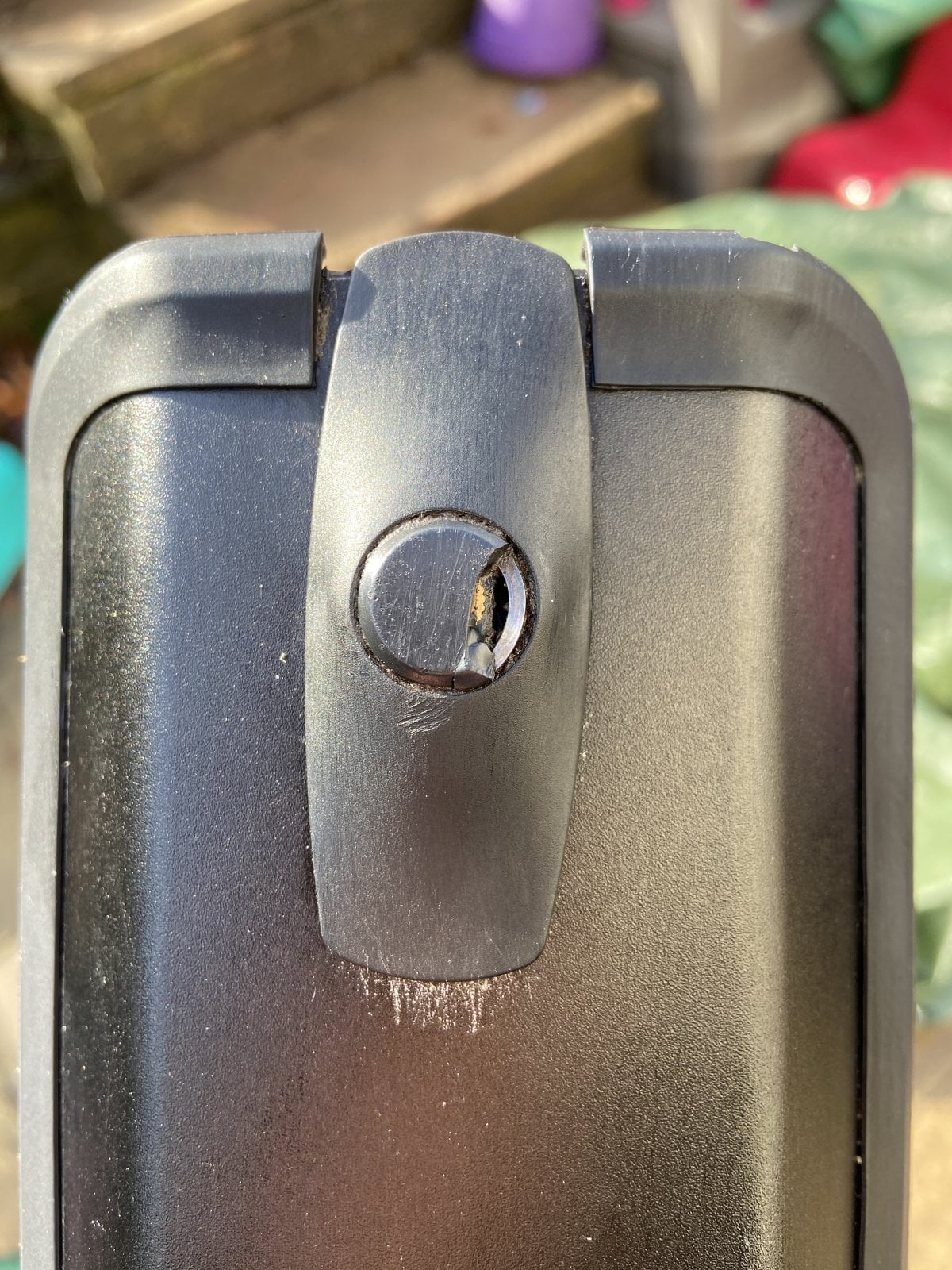

I’m about to have issues with this. Can anybody give me pointers to a replacement battery cover ? Wonder if decathlon would cover this under warranty? Ta

Those looking for spares, decathlon have managed to order me a replacement battery cover from Lombardo. It’s took forever due to covid and my local store being closed until today, but it is now there awaiting collection ??

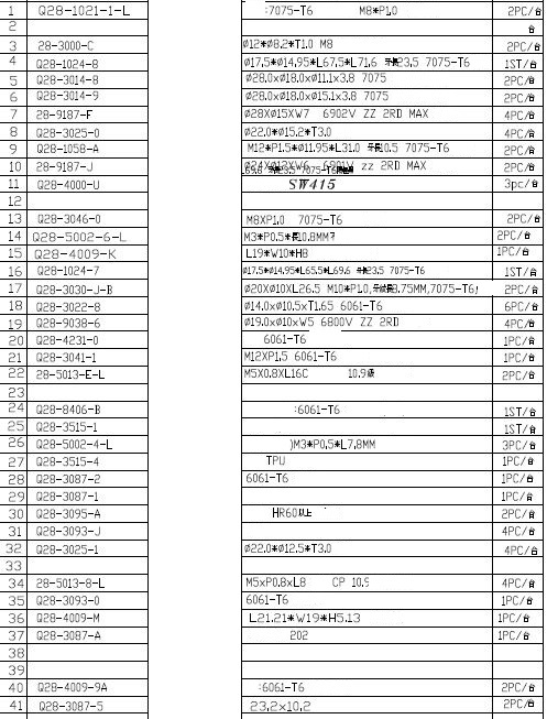

Here's the tech drawings and spec list for the Stilus frame bolts and bearings - Looks like there's:
2 x 6902 28x15x7 (main rocker and lower pivots)
2 x 6901 24x12x6 (top of the seatstay)
4 x 6800 19x10x5 (four at the end of the chainstay)
Also on here are the torque settings:
180kgf (17Nm) - every pivot apart from the shock bolts
120kgf (12Nm) - shock bolts
I fould both my main pivot bolts were loose - like, finger-tight loose!

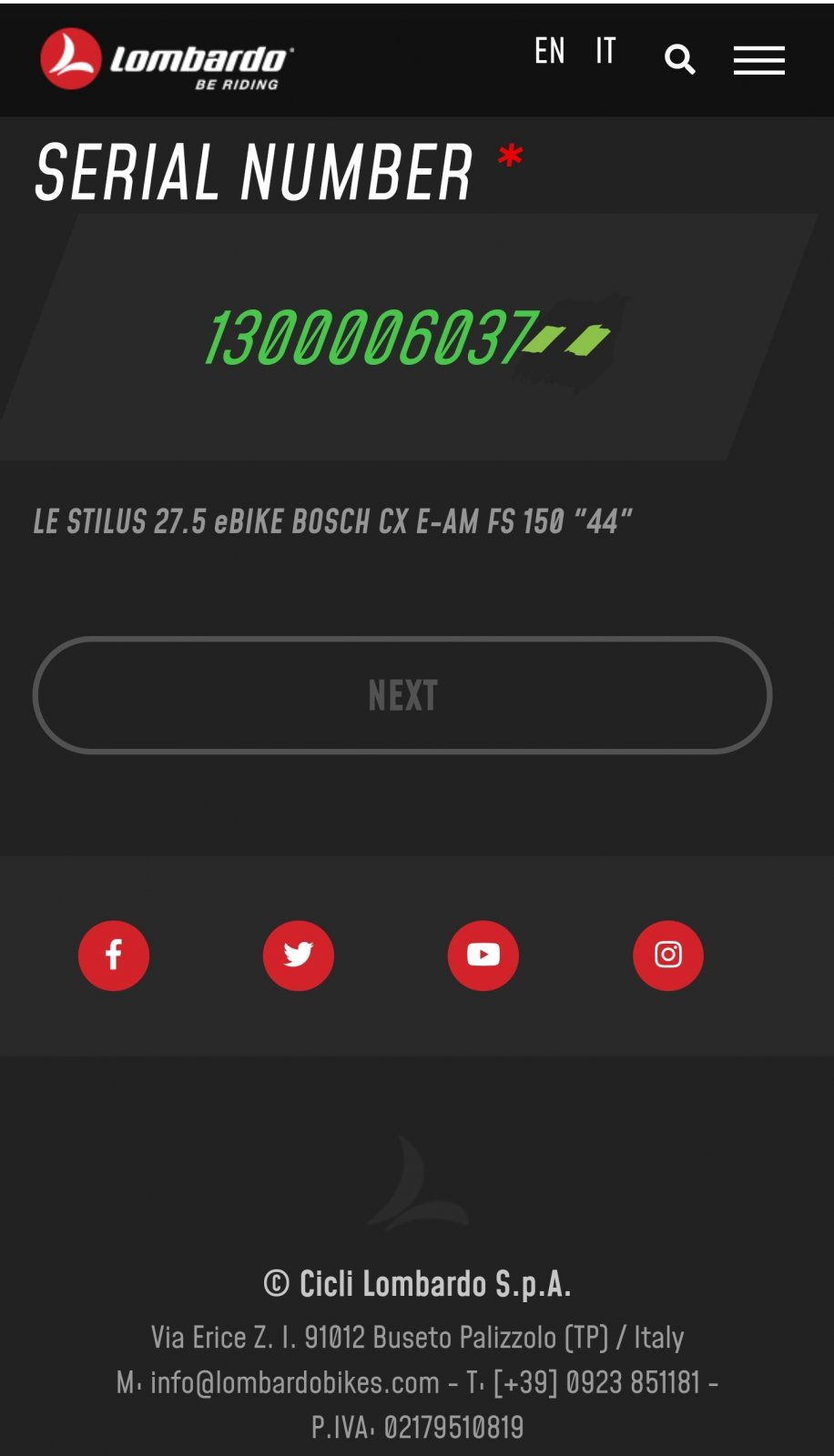

Hi great post im having trouble registering my warranty. when i try it comes up with the wrong type of bike. I must have the format
wrong i guess my serial starts KC0154***1 is this the wrong number possible not the serial number ?
Many thanks
