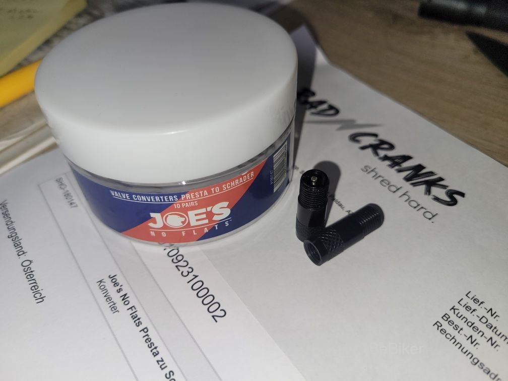

The other 40 wheels around here, from our cars, traktors, kids trailer, kids bikes, lawn mower,... all have normal Schrader valves, and I inflate them with a tyre inflator like you sometimes see at gas stations.
The Decathlon Rockrider E-st900 came with strange valves named Presta, so I drilled the wheels to accept Schrader too.
The Cube also came with those road bike Presta valves, but drilling the wheels made me hesitate a bit, because they are narrower, and the surface is a bit more pointed.
I always used a hand pump or these small adapters, which have to be removed first to open the presta valve, then put on again, inflate, take off, close the Presta, put on, cap on.

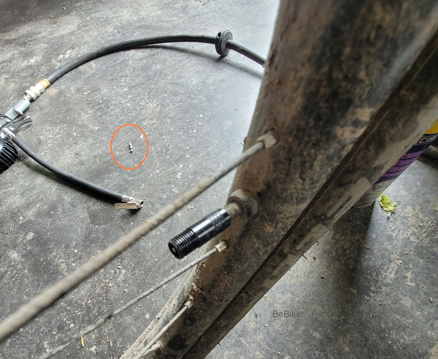

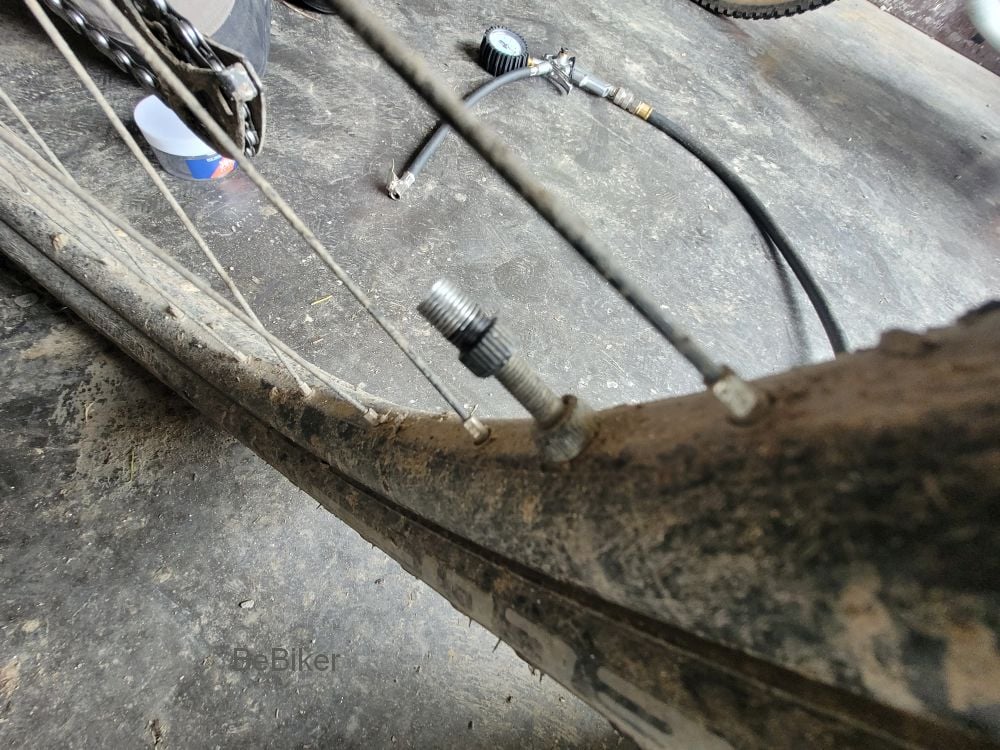

But now I bought this:
The trick here is that the ennoying Presta valve is removed permanently, and the adapter itself has a
Schrader valve.
It's simply bolt on and self-sealing, so nothing to drill, modify or seal.
The inner valve is removable like all Schrader valves, for filling up tubeless fluid.

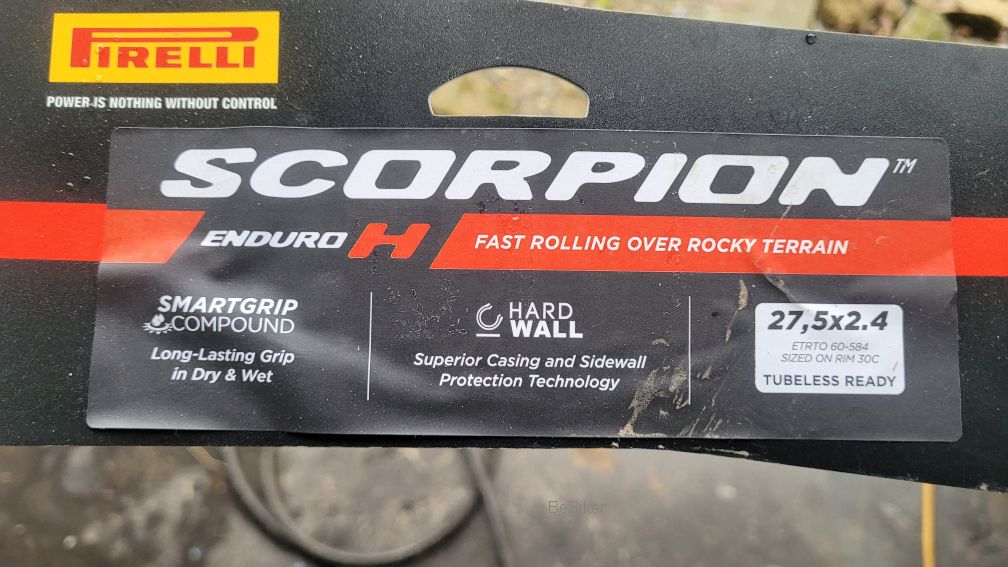

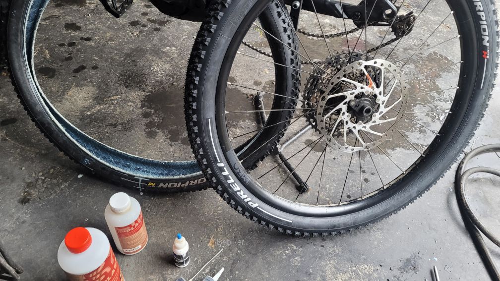

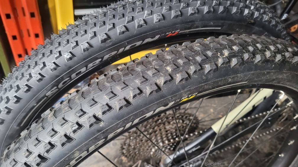

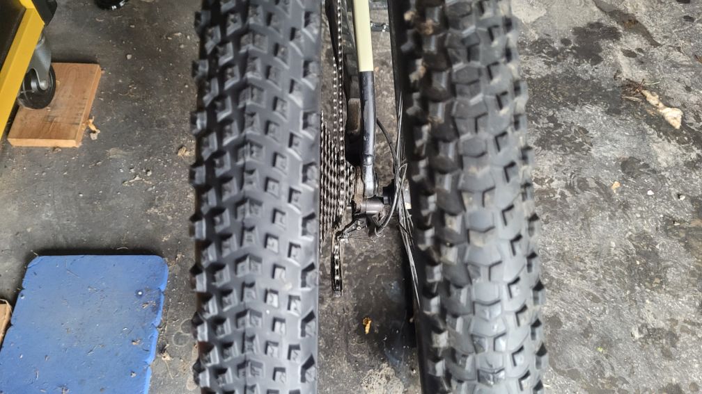

The Pirelli M back tyre is worn out.
In the compromise between mud, asphalt, traction, rolling resistance,... it suited me better than the Pirelli R.
At the front I keep the S with the big knobs.
And at the back, trying the Pirelli Scorpion H now.
There was only 10mL of the +-60mL tubeless milk remaining.

Pirelli Scorpio M vs H
The M looks like the Maxxis Ikon,
the H looks like the Maxxis Rekon-Race.
Looking at the pattern, it will be better on asphalt, and similar in mud.

I'm running the maxxis shorties front and rear in this shite weather bloody marvelous in the mud gòe grip don't know how long the wiĺ last on other surfaces
I do +-30% asphalt, with that profile my teeth fall out of my mouth :)
60ml?! I use 140😂

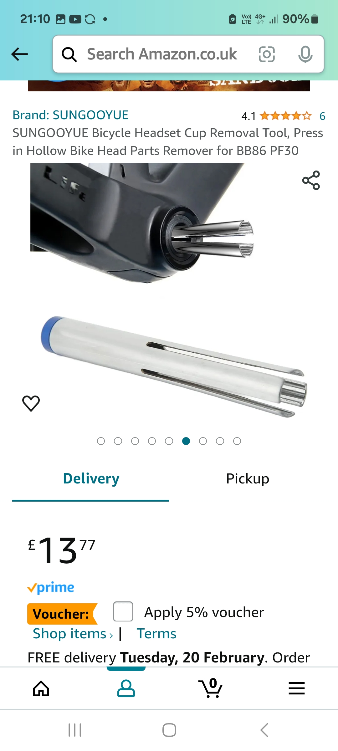

You've got the internal ròuting headset so can't suggest anything all I know is the tools I used to swap the headset out were these two tools didn't buy into park tools for these cos not really used that much

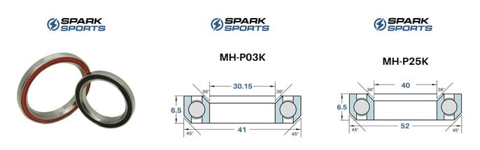

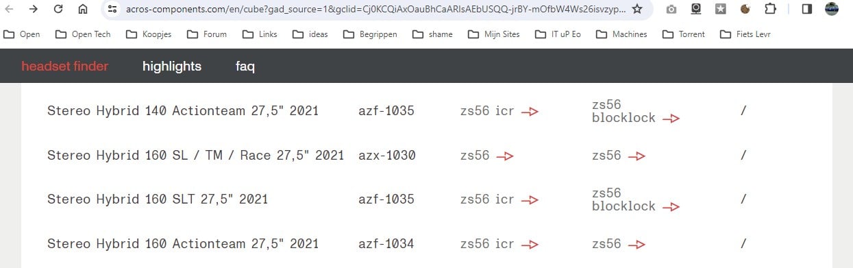

It seems my bike has the: ACROS AZF-1035 headset.
This is the zs56 icr at the top, and the zs56 blocklock at the bottom.
This shop on Ebay sells the bearings separate, but unfortunately no stock.
For all bikes using the ACROS AZF-1035 Headset Bearing Kit
Upper Bearing - MH-P03K
Lower Bearing - MH-P25K
BeBiker
Aug 26, 2020
702
424
Belgium
52mm/40mm/6.5mm/36gr/45gr
41mm/30.15mm/36gr/45gr/7mm
41mm/30.20mm/36gr/45gr/6.5mm
Which one is the best fit?

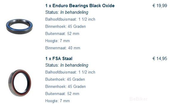

So I measured the bearing, 52mm/40mm/7mm is the one at the bottom of the ACROS headset.
Ordered Sunday evening 21h, delivered Monday 10h30. Incredible.
Besides these, I ordered multiple others, to be sure to have one that fits.
With some precision mindset, it was easy to replace.

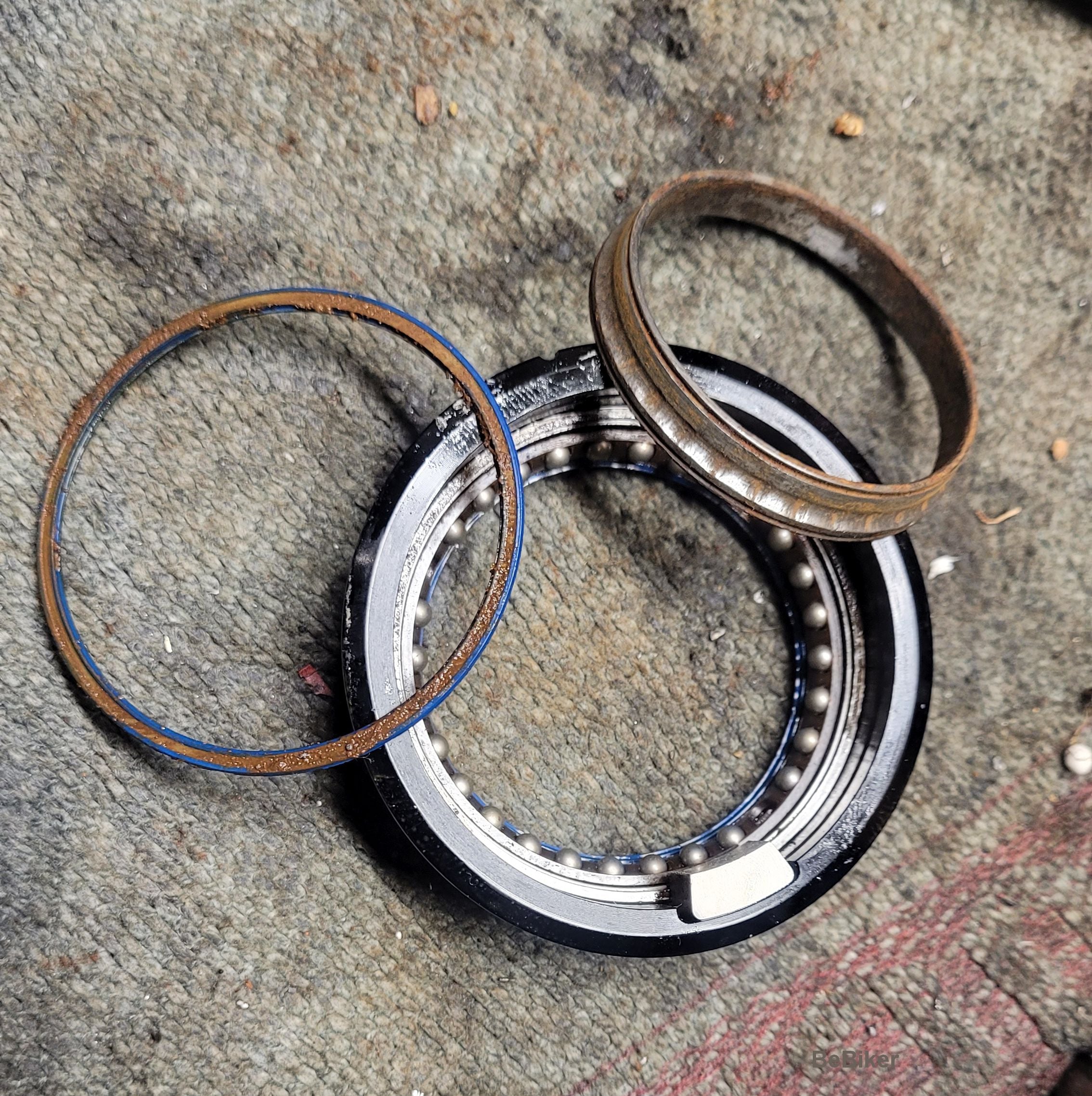

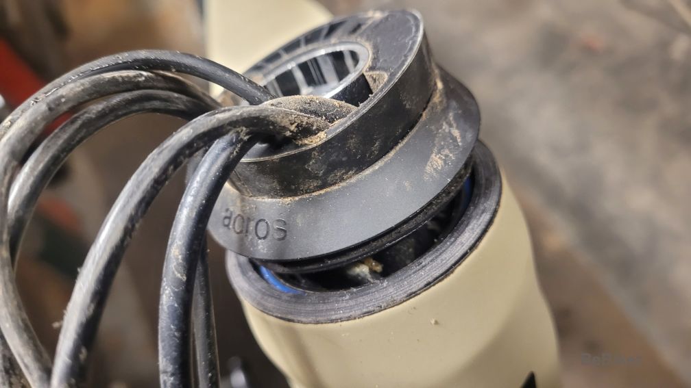

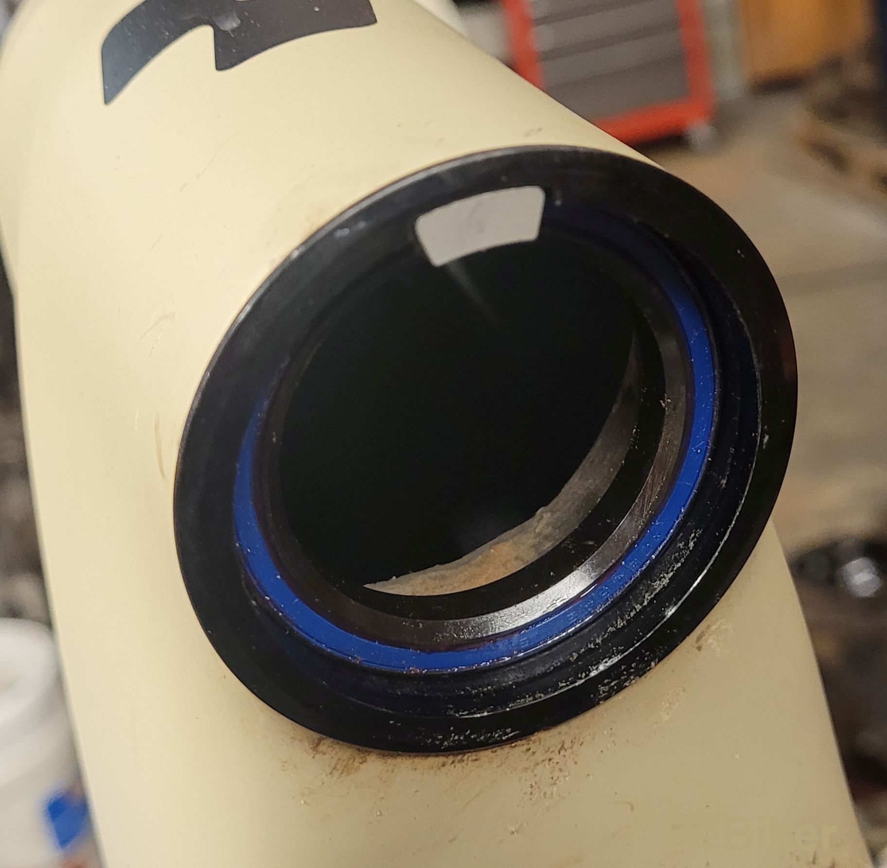

This is how the old bearing looks, after cleaning.
My guess is that some water got above this lower bearing, and slowly entered through the upper sealing to the inside.
The ICR Internal Cable Routing is a bit messy, but with some patience it's ok.
The new bearing inside:
