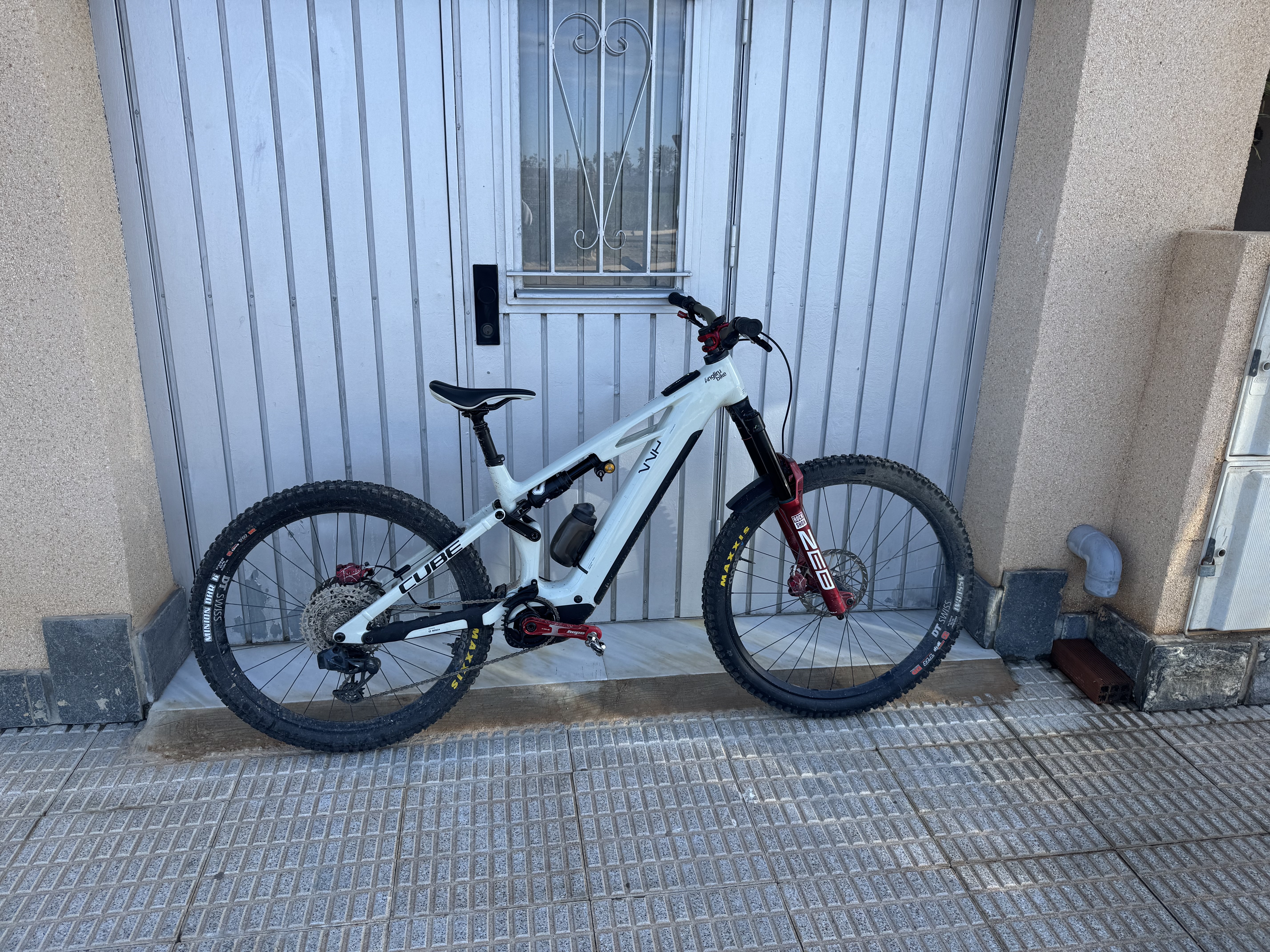

After first ride... very very nice...
- 177 SLX L size frame
- Ohlins TTX2
- Sram Maven Ultimate 203 discs
- Sram GX AXS (never more T-Type, but this is other question)
- Renthal fatbar 800 40mm rise
- Hope 155m cranks
- DT H1900 (too soft, soon same hubs, with FR541 rims)
- Cube 170mm seatpost with Hope lever
- Assegai 2.5 DD MG and DHR2 2.5 DD MT with Tannus
Next week I will install a Fast SC5 cartridge (I have already a Vorsprung Luftkappe) on the Zeb (190mm) and the definitive stem, RF turbine or Hope in red colour (probably 40mm)
345mm BB Height with less slack fork position and other changes, but it seems like a lot more clearance than my last 2023 E-Reign with 340mm BBH, don't know why...

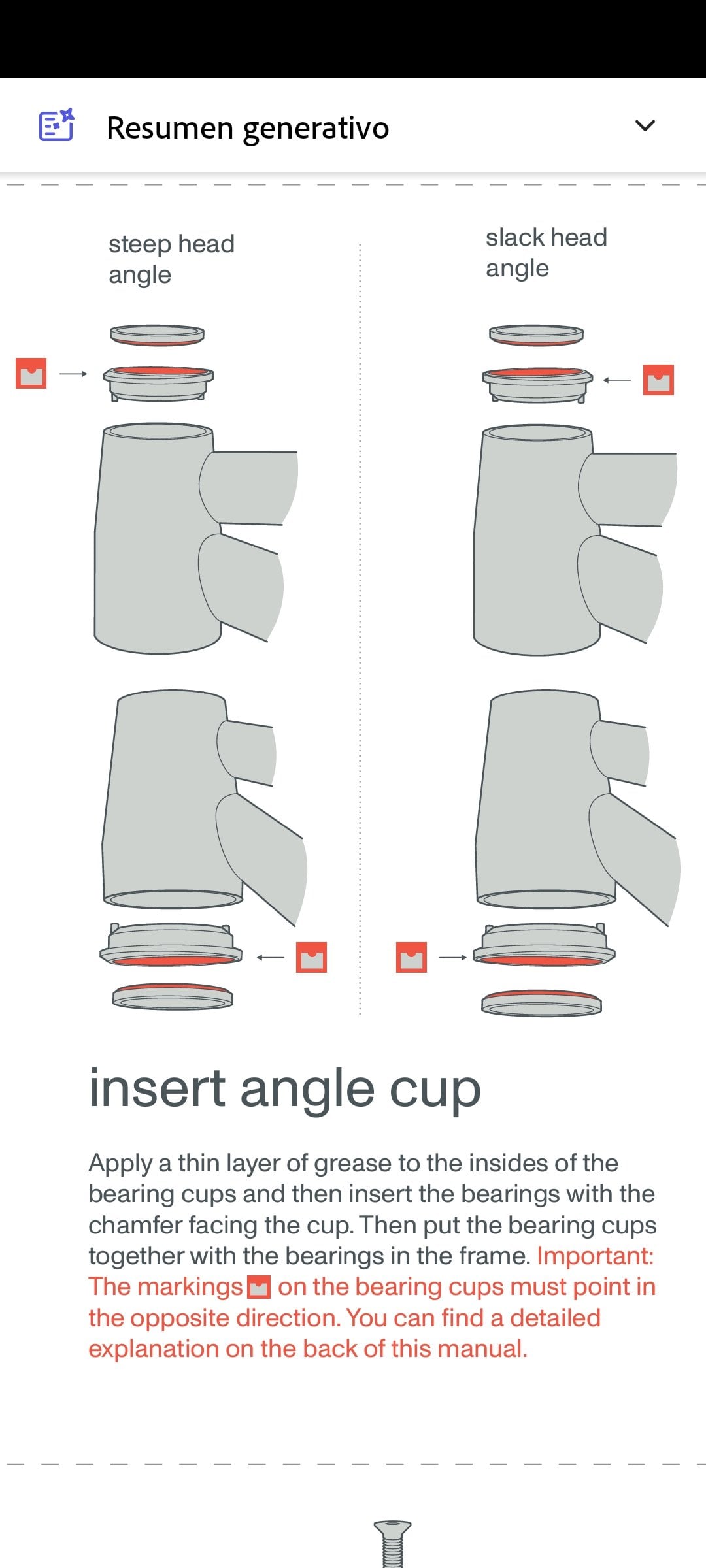

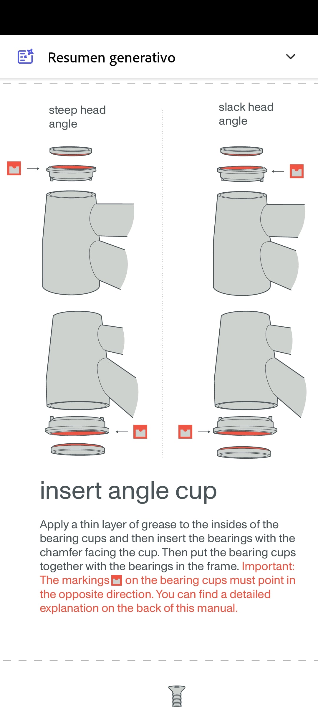

I've disassembled the bike's headset, but now I don't know if the two cups are properly seated or if they're offset from each other. How do I know if the two cups are aligned for 63.8 or 64.4?
JVC
Jun 27, 2022
15
7
Spain
Acros responded to me:
if your bike is equipped with internal cable routing, the angle cups must be installed with the notches facing in the opposite direction. Only if your bike is equipped without integrated cable routing they must be installed with the markings in the same direction.

Careful with notches, this imagen is from the manual of acros

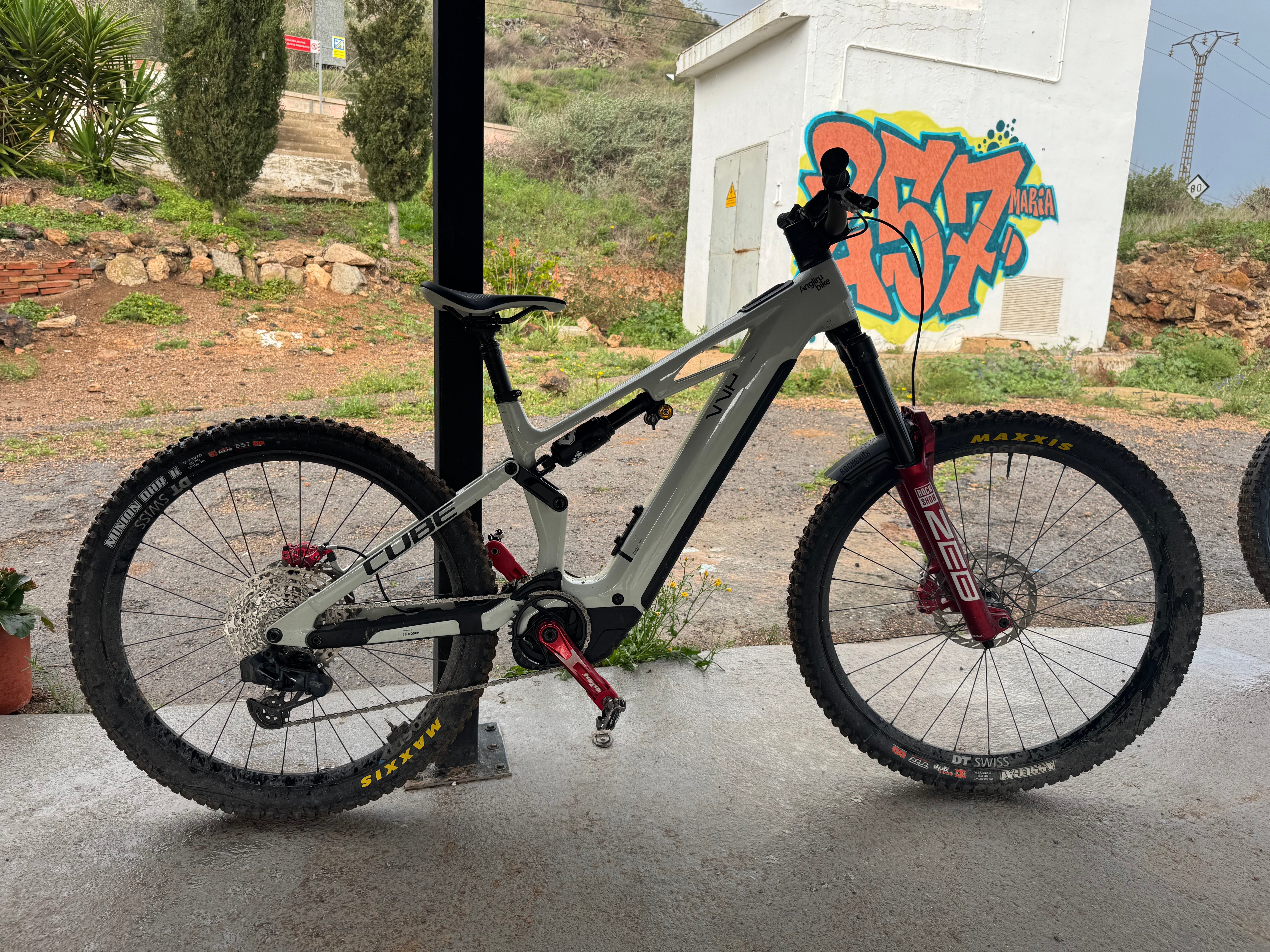

After 5 rides I can say that the bike is amazing, it feels very light, more than its weight, it is very reactive, the geometry after moving the fork to 190mm and the geometry in the less slack position is perfect. Love it.
What I liked least is that the lower engine cover is of very poor quality and is held in place very precariously. I think we'll break and replace many of them.
Today I will install the Fast cartridge, and then a carbon rim set wheels.
