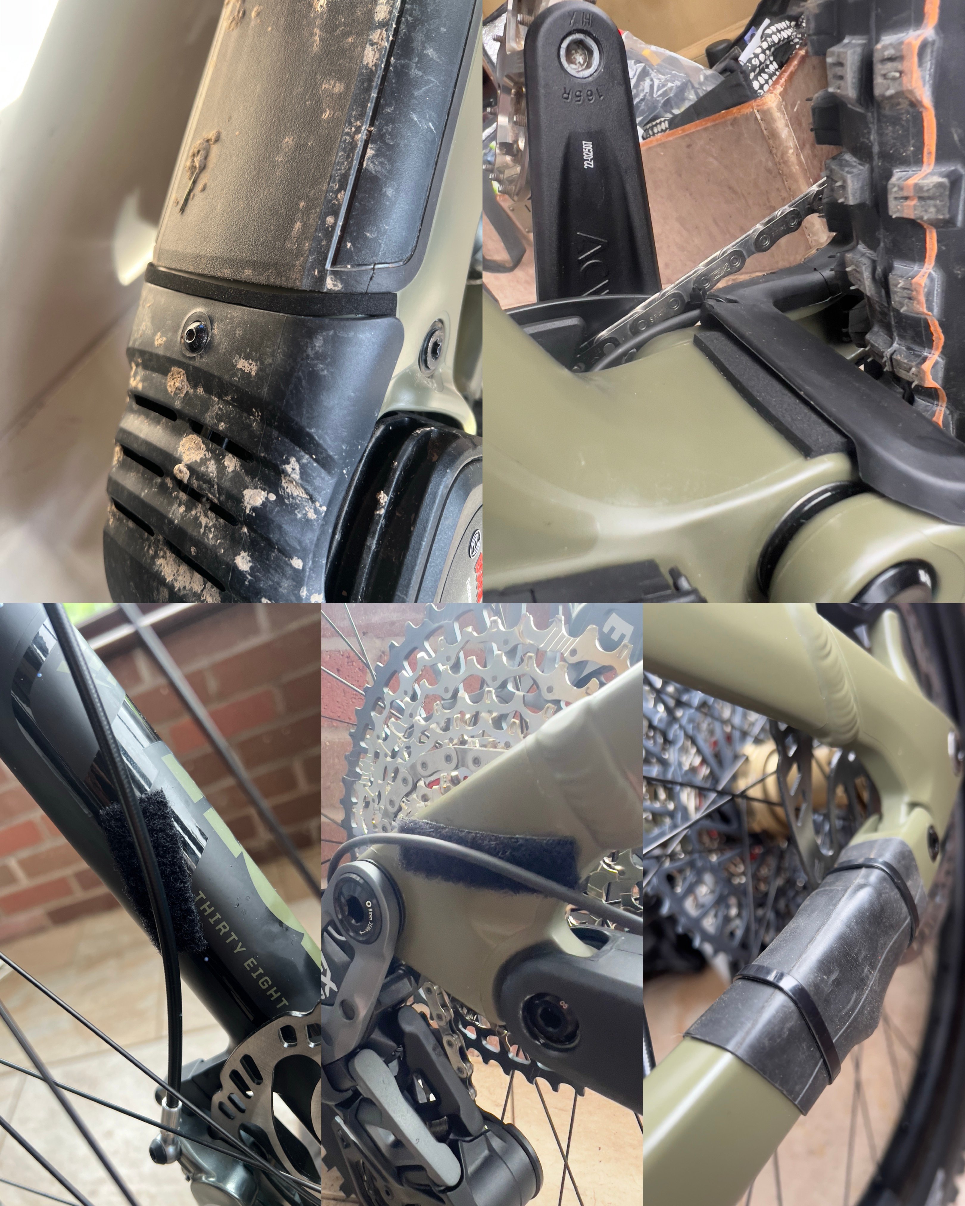

Very silent bike..loving mine and with 155 cranks it’s not so much an issue,I’d say the only thing that took me a while to get a happy result has been the stock suspension,volume spacers galore and all sorted..though the rebound is so fast for me I’m like one click off full on the front forks @85psi and 87kg with 20% sag..the wheel still leaves the ground on a squish push down test but only just😂btw a super soft tacky chan on the front and stick on rear is an insane combo for speed and railing..it’s almost a struggle to to get the bike straight again after crazy lean angle 😂 IMG_3542.jpeg

Great video buddy 🙏regards the battery cover you can wind the top mounting screw in to get a good seal,the bottom white clip you can just push it in once you’ve fitted the cover(it’s on a ratchet)

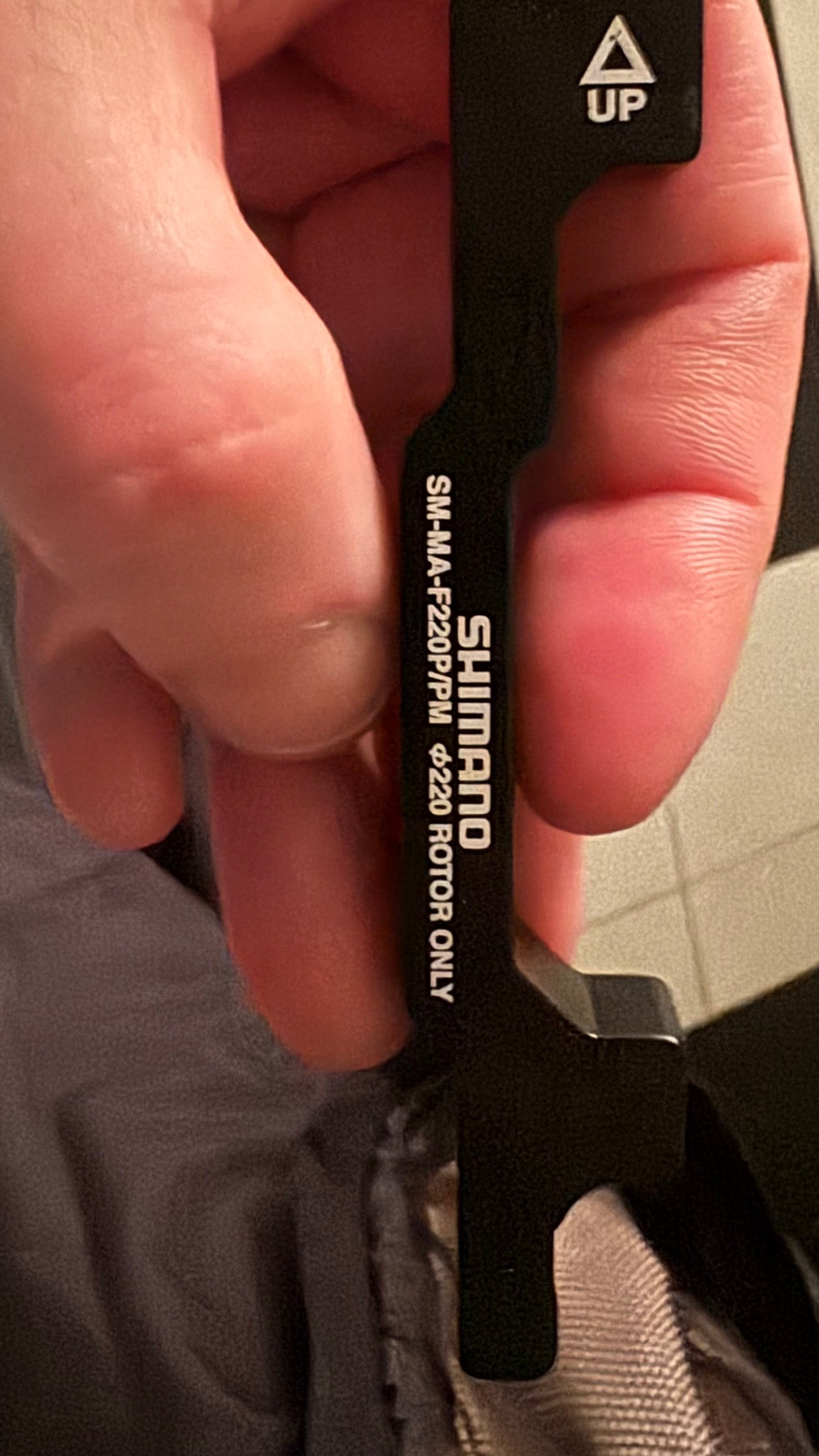

As @Trickz said, I ran the stock fork pretty much fastest rebound and found it to track great, but it topped out (i.e. clanking sensation when bunny hopping). I added a few clicks of rebound to try to balance the top out with the feel. Fast rebound will help with low BB also.
I put 220mm rotors because I had that on my wheels, but I just love the Shimano levers compared to my codes and maguras that I never enjoyed the feel of.
I think the pads are probably also quite rubbish, I have galfer ebike specific ones waiting to be put in once it stops raining every weekend (they wear out fast but can stop a barge)
Is there a specific fork adapter mount you need for the 220 conversion?just looking now😂
