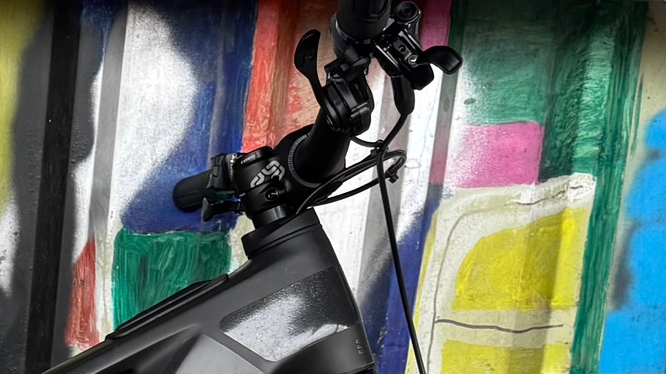

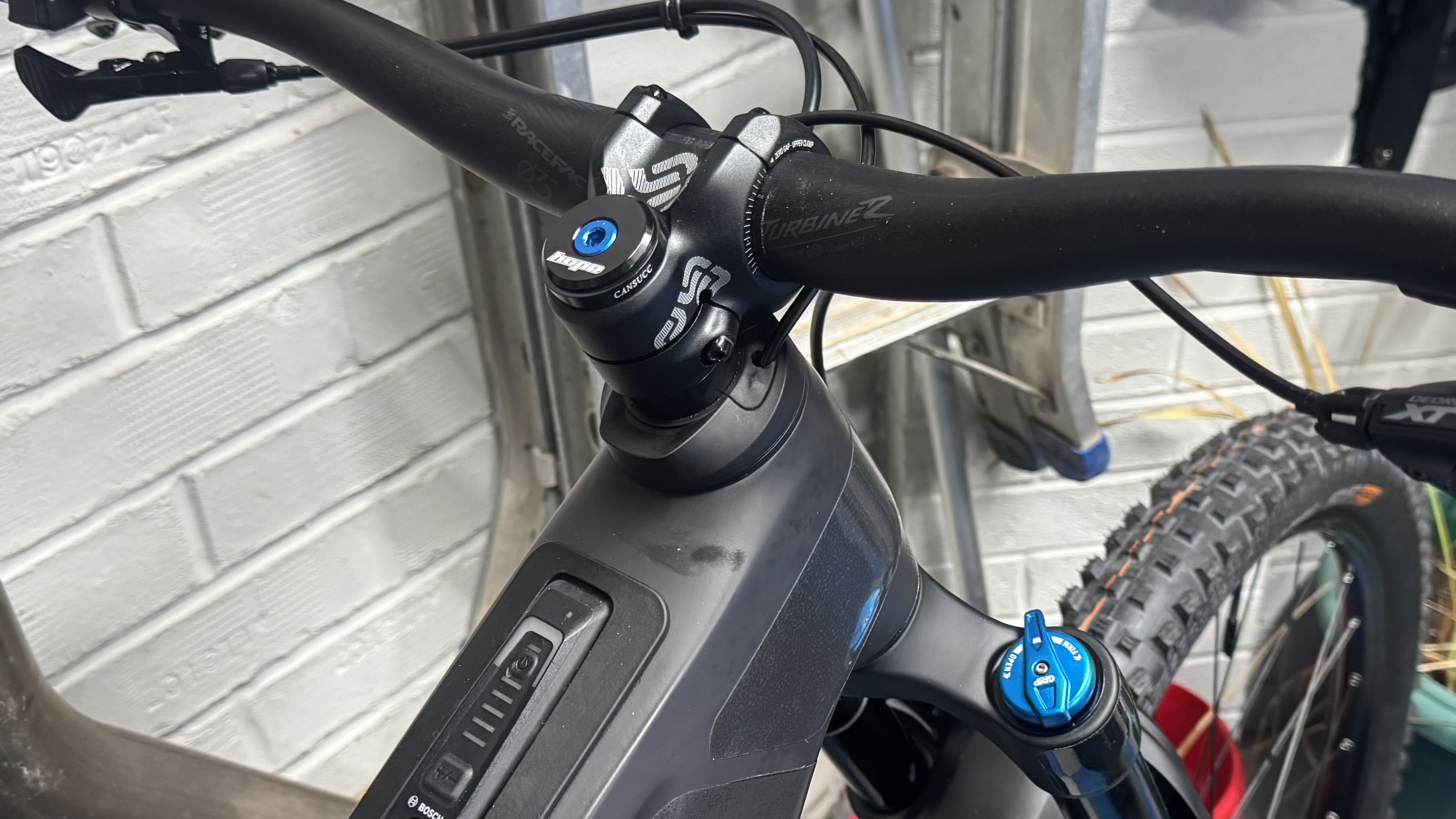

FYI I changed my fork over the weekend, the headset isn't that hard to work with.
Just be careful the lower bearing will fall out on the crown race, and there is some kind of loose red seal that sites on top. The crown race is a tight one, it got a bit scuffed up taking it off with a small screwdriver. The top of the headset all held together during the operation and only one cable was in the way when inserting the new fork.
The only slightly frustrating part was the angleset cups also popping out. Gave me a right fright when I thought it was the actual press fit headset cups! 3 hands wouldn't have gone amiss to press everthing down together at the end, but it's literally just an extra 2-5 minutes of faffing. Good news is that I then decided to try the bike in the steeper setting, only took 5 minutes to do the full head angle adjust the next day.
Yep Ianother hand is needed as I wasn’t sure about the adjustable cups were right,now I’ve done it it’s easier,but even holding the stem straight is awkward because the cable/pipes want to lift it up😂
Do what i did,wrap gaffer tape around the top of the headset,spacers etc,keeps it all together,and stops it popping out all over the place.

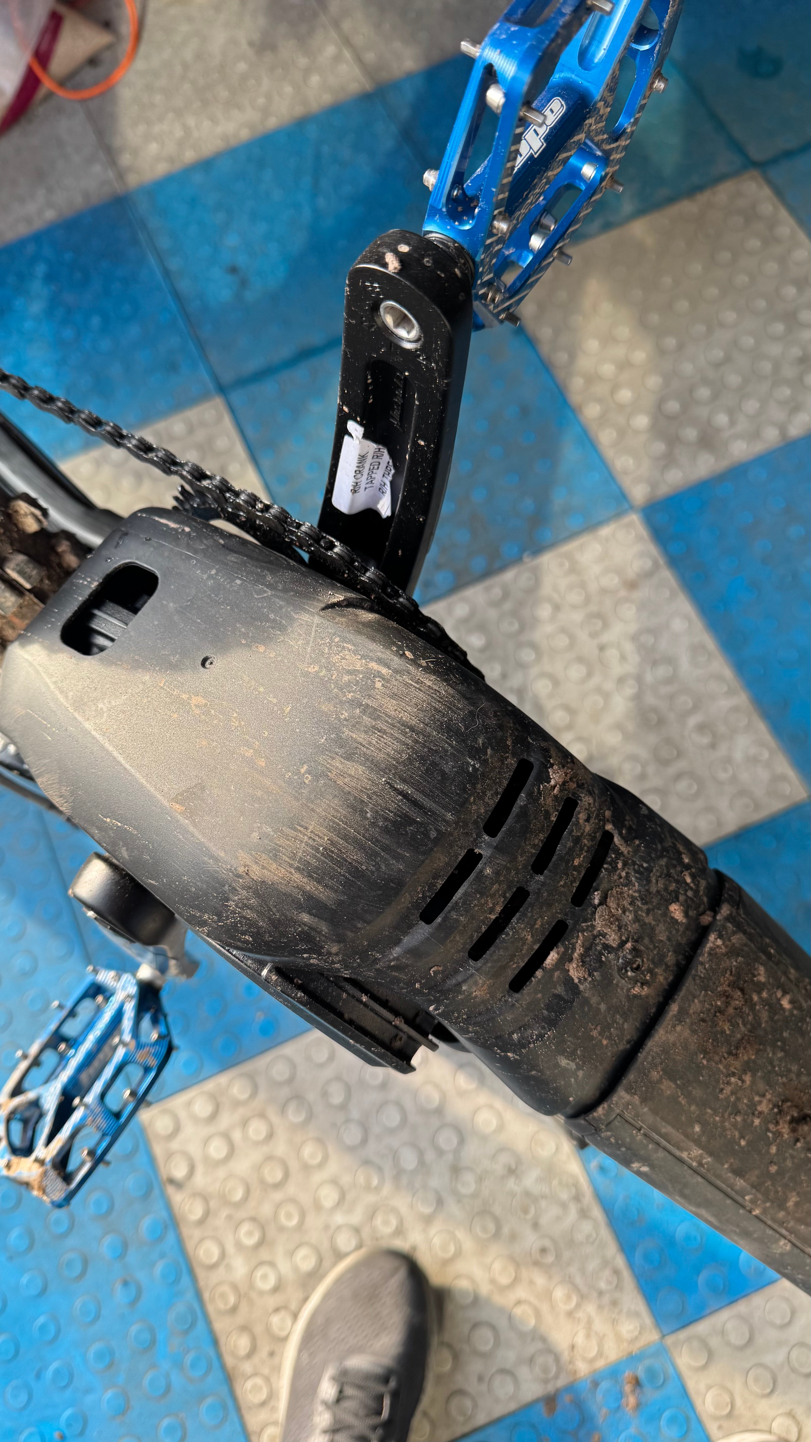

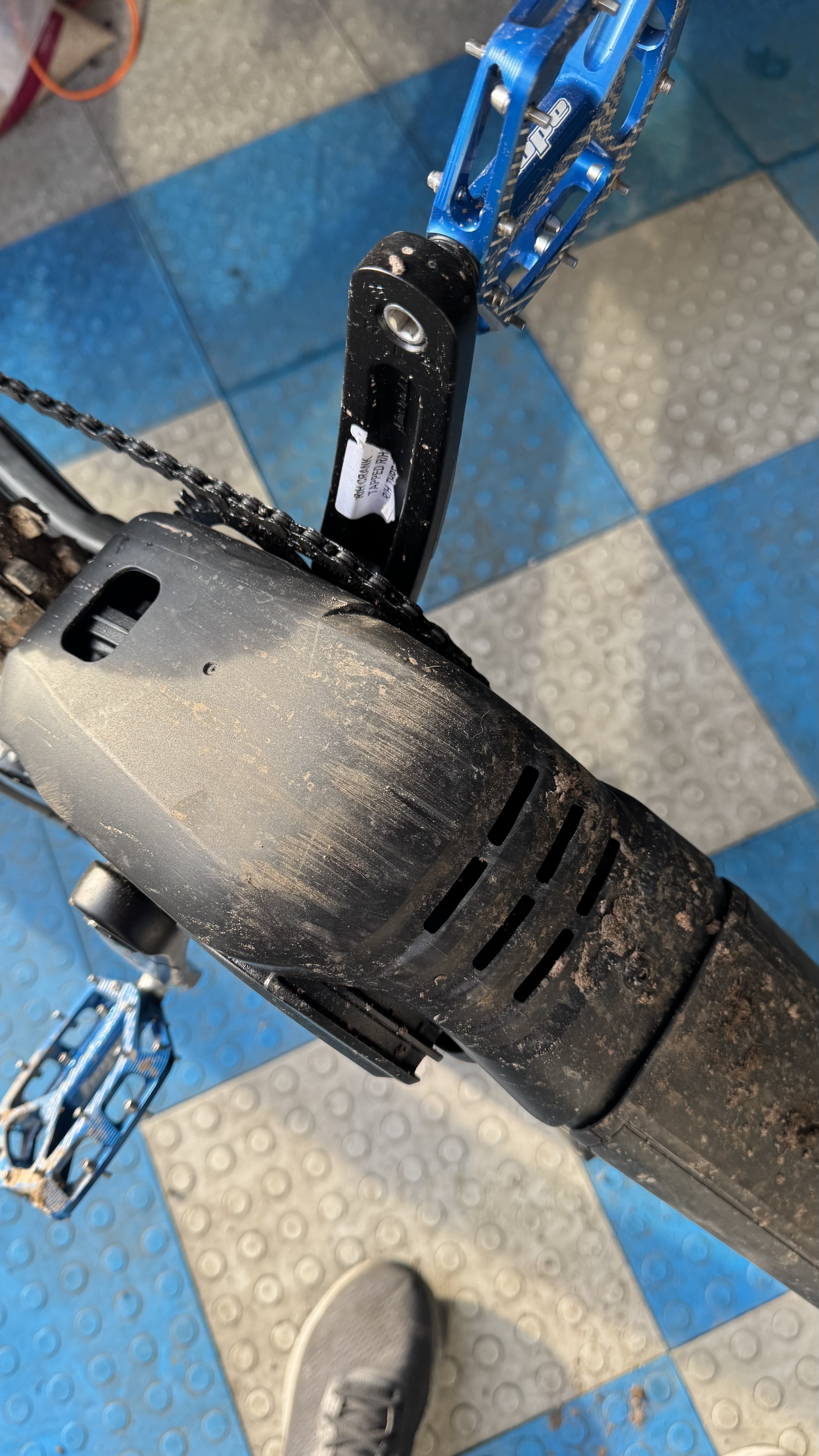

She’s a low one..heard a few scrapes today🥴
Yeah bike is lower than expected for me too, it is the only regret I have with the bike, I truly hate this trend of low BBs. Also the fact that by my numbers the BB is about 6mm lower than the geo chart proclaims.

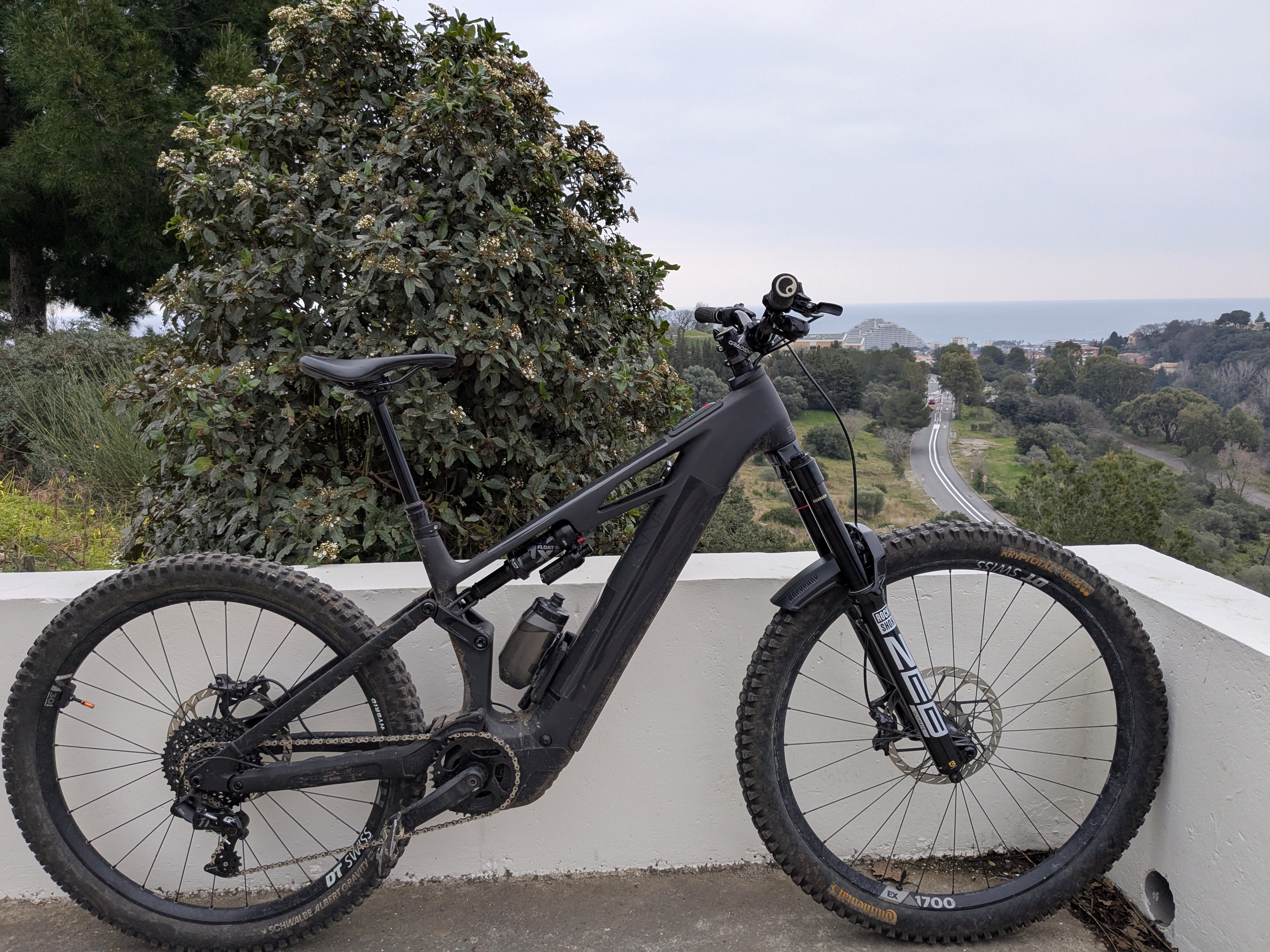

I wasn't sure whether I'd post this but here goes, on my size L one77 SLX:
Out of the Box: BB height 334mm
2.6 tyres front and back: BB 337mm
+ Headset cup in steep mode: BB 339mm
Theoretical numbers as it will void your warranty, not validated in real life:
+ 190mm fork: BB 345mm (head angle 64degrees with steep cups)
Offset bushing "the wrong way": +4mm at the BB but might cause issues with the yoke contacting the seattube and could rotate making the bike lower than stock. <- last resort...
So frustrating when the best reviewed bike out there, the Orbea Wild, has 358mm BB height!
If anyone knows a company that make custom yokes, or whether Cube have a compatible yoke from another model that happens to be about 3mm longer I would buy it in a heartbeat.

They are permanently closed. But does the ONE77 not have a bashguard?
Damm,i didnt know that,glad i got one made for my stereo hybrid !
they have a standard motor guard which is plastic,its well worth getting a tailoured bash guard to the bike as plastic in the cold gets brittle,my carbon rockguard has a few dinks in it,which would have smashed the plastic motor guard

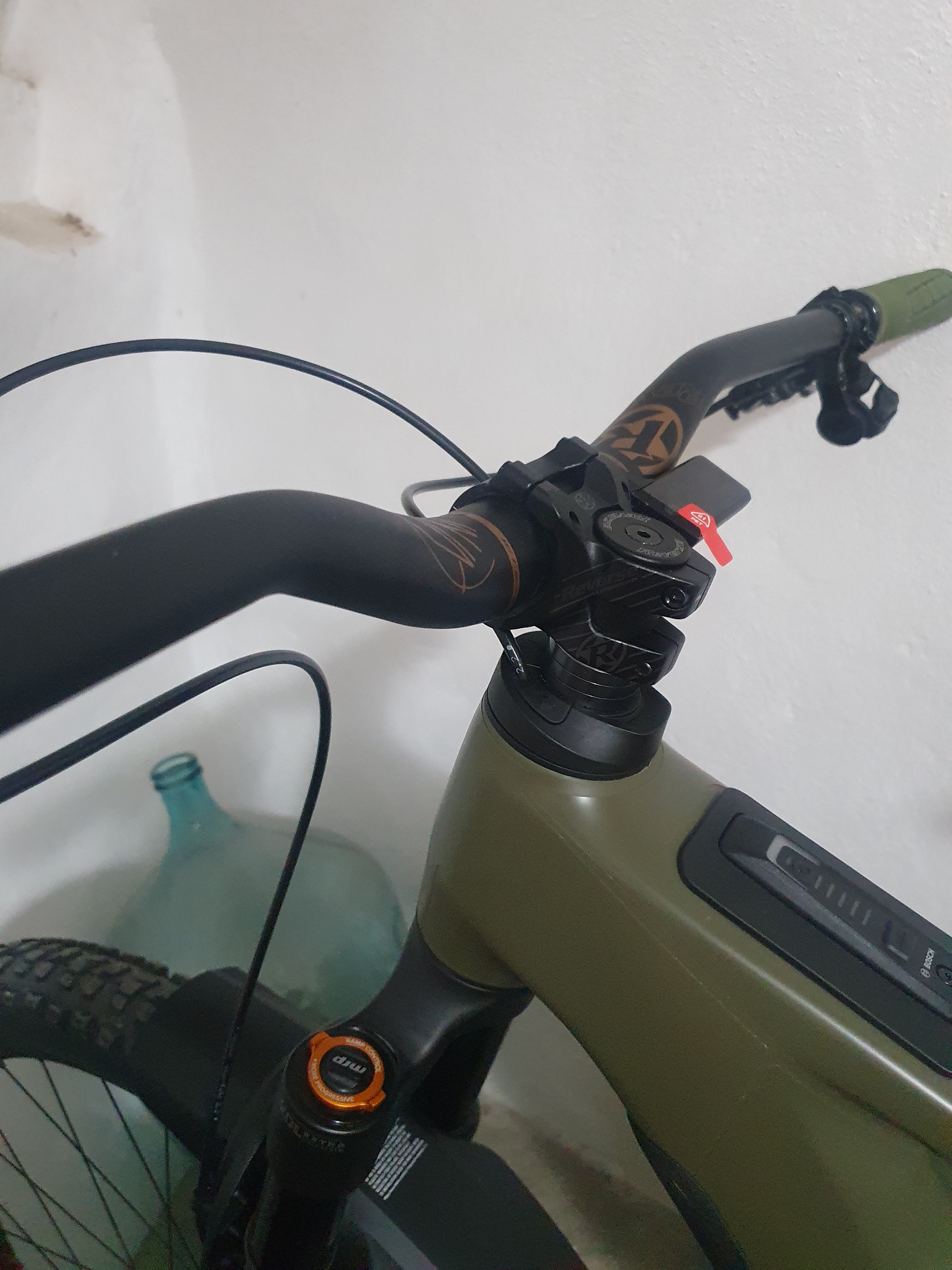

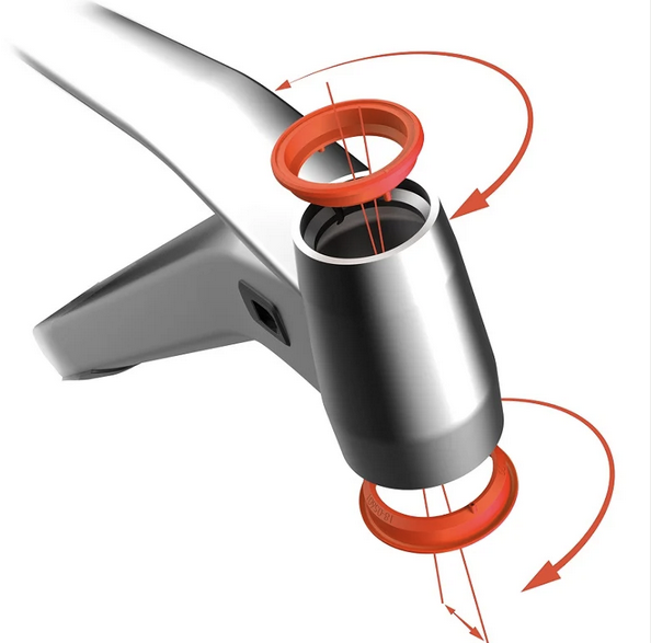

Hi everyone, I would have 2 questions for you :
- is it risky to have a carbon frame in rock gardens? I didn't think of it before buying but now I'm scared lol. If someone has experience with it 😊
- I want to change the angle of the headset but I don't know what it looks like and what part is supposed to be inverted. Same, if someone have experience and/or pictures of it I'll take it. Else I will do even without ahah

The headset is a variation of this one: mod56/56 - angle headset 1°
You can see the top and bottom cup here:
I would say:
1) use an angle measurer (on phone) to make sure the cups are correctly set, most likely it is in the slack setting around 63.8.
2) take out stem and spacers. When I did it, I actually left the stem on about 4cm higher (partially off the steerer tube) loosely tightened to avoid the fork from dropping out of the frame.
3) push fork out of frame slightly, no need to fully remove, everything should loosen up. The cups have almost no friction, just rotate the top and bottom one by 180, notice the little guide dimples that ensure they are centered.
4) get everything back into the frame and tighten
5) measure angle to ensure it is the desired one, if going towards steep it should be 64.4

Thanks a lot for the quick and detailled reply!
I can't have a precise measure right now but it looks like the bike is already at 63.8 so maybe I won't change it. I think I want it to be in the flattest angle. But I'll surely test the other angle some day 😁

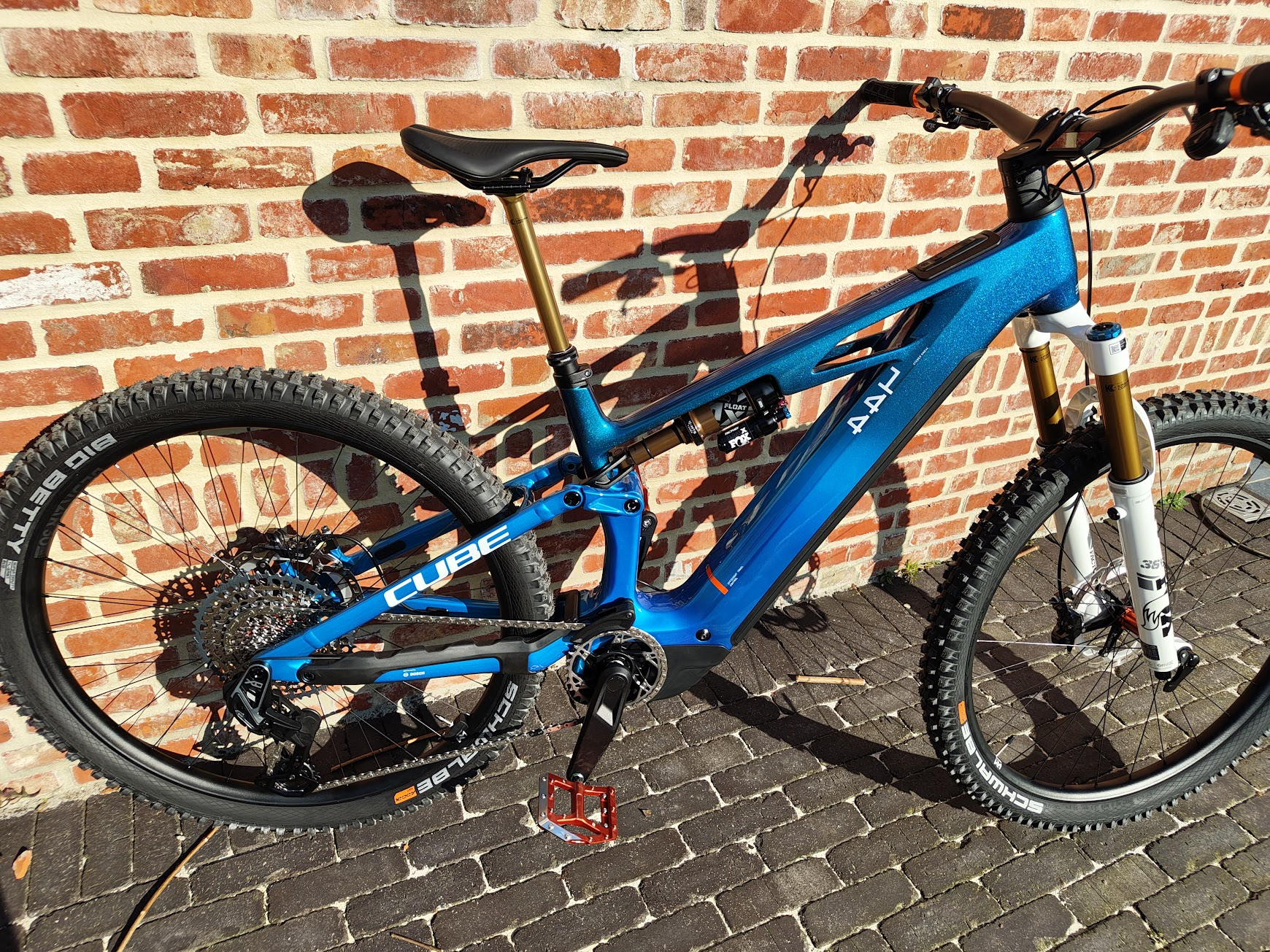

yeah, it's nice, the color is alive too in the sun...
tomorrow i'll be converting to tubeless and add orange valves too :)
Oh nice. Take some pictures afterwards!
That blue color is very nice! My One44 TM should be coming next week. Also a nice color, but that blue might me the nicest color in the lineup.
