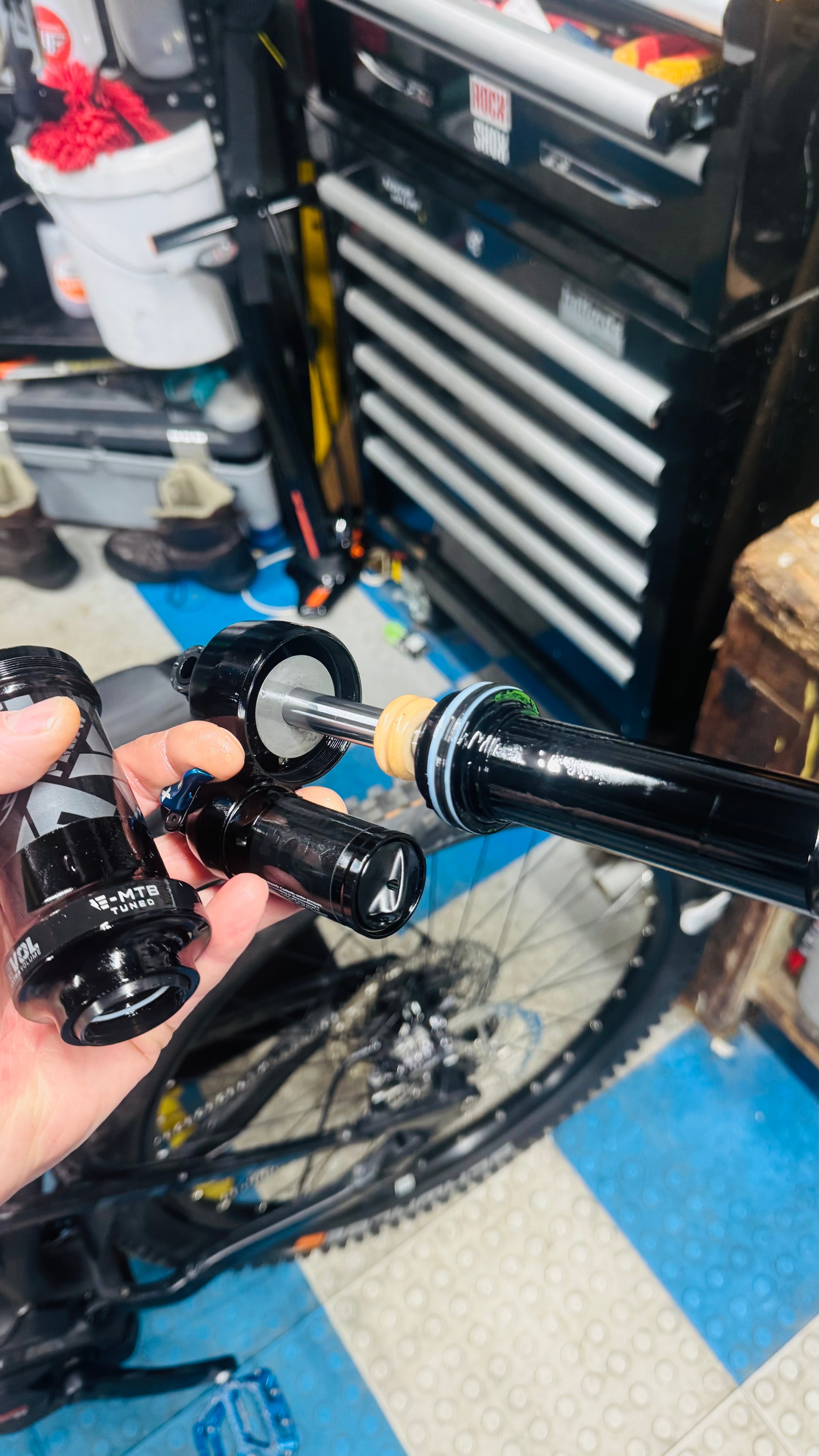

so opened the rear shock up yesterday and for me anyway there was no air volume tokens fitted from oe,as I’ve been bottoming out more than I’d liked I fitted first the 0.6” token but then after a ride out swapped to the 0.4”,with 30% sag for me riding weight 88kg its was super plush but even after the drop off I was bottoming out on I still had around 10% of travel left and the landing felt loads better,also have 4 tokens now in the rhythm fork now but running 23% ish sag and its made it a lot plusher on the top but with good middle support.
Mister cube
Dec 28, 2024
97
65
Isle of wight
Get a coil shock,its the way to go 🤙

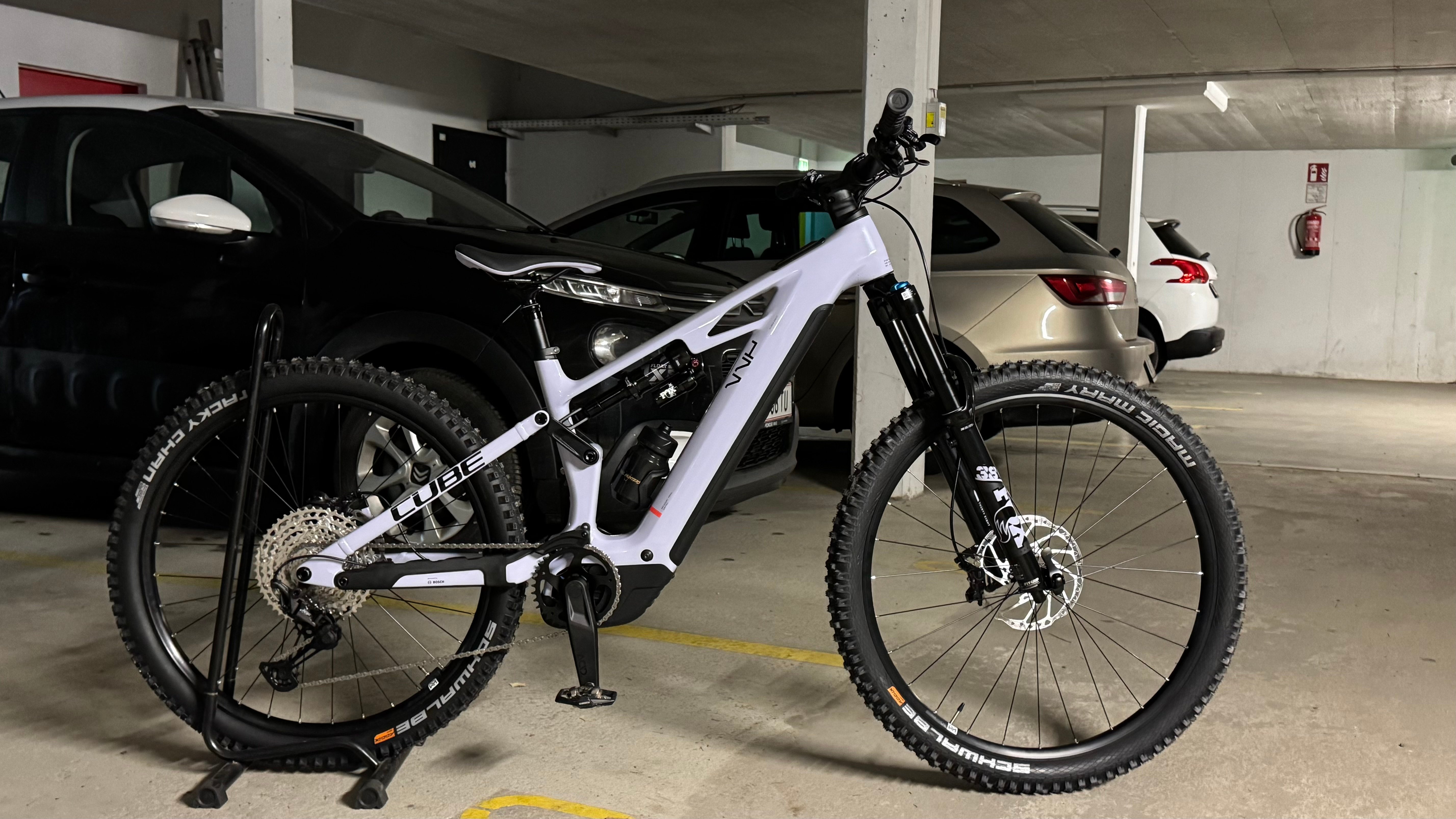

Just picked up my one77 👍
First impression: quite ok 👍 wheels aren’t convincing, probably the first upgrade, and the brake discs. 150mm dropper is also a little short, that’s has to go as well. Maybe I’ll replace it with 180mm oneup dropper.
But let’s see how it rides once the rain stops and trails dry a bit.

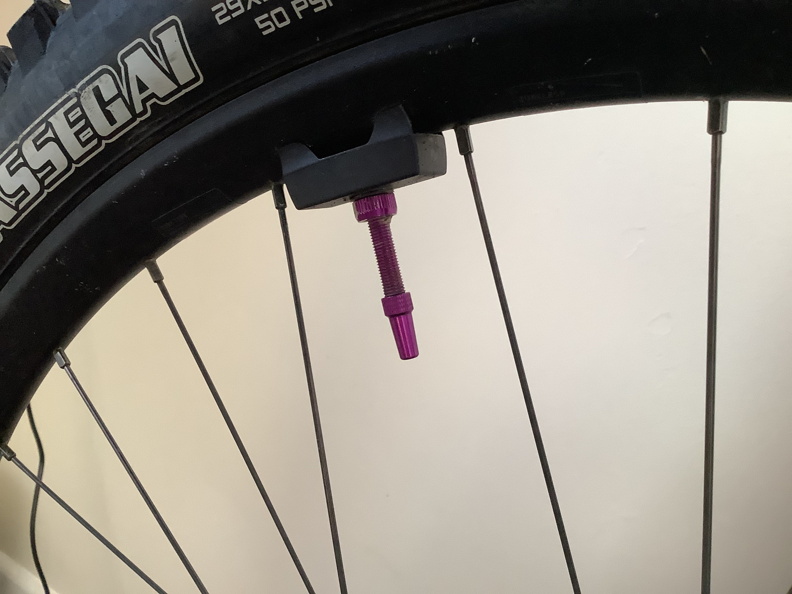

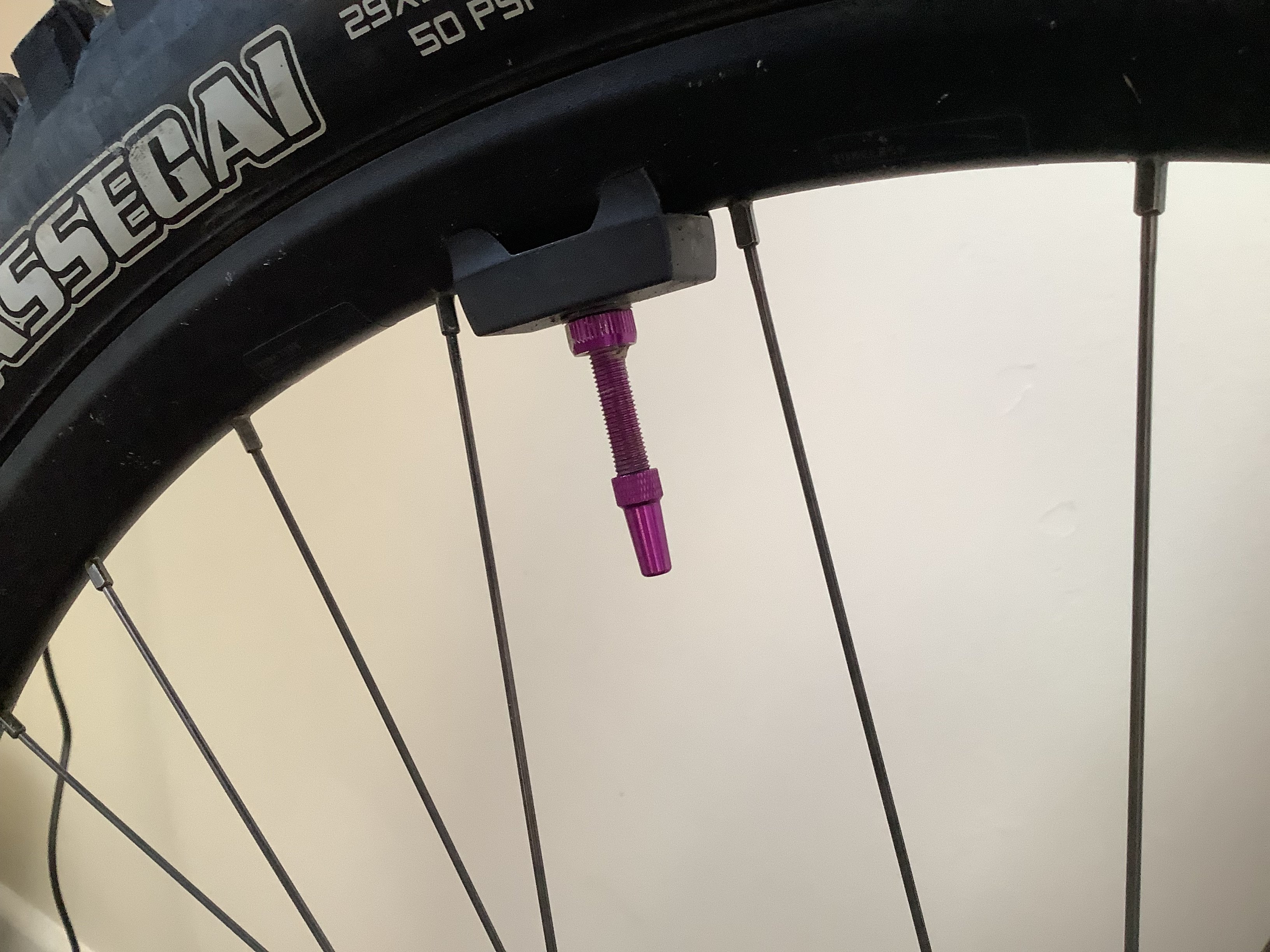

Hi everyone, does someone know how you can replace the big magnet on the rear wheel? I'd like to remove it if possible, but I don't know how I can replace it. It is a bit too big to be fully compatible with my tubeless valve. Will mounting a magnet on a spoke work?
Mister cube
Dec 28, 2024
97
65
Isle of wight
Get a longer valve,its on the valve for a reason.
The problem is more the fact that the nut that is supposed to go against the wheel is quite big, the magnet cannot rest over the wheel, its bases are too short. I quickly looked for a new valve and they all look to have that big nut. So I wondered what solutions people use to solve this
Can you not put the valve nut on top of the rim magnet?
I had to buy ugly and expensive 60mm valves, and now have some very expensive reserve fillmores sitting on my garage shelf, not terribly happy about this.
Surely a spoke magnet could work, but it might need a specific shape to get closer to the rim and would block the spoke nipple.
