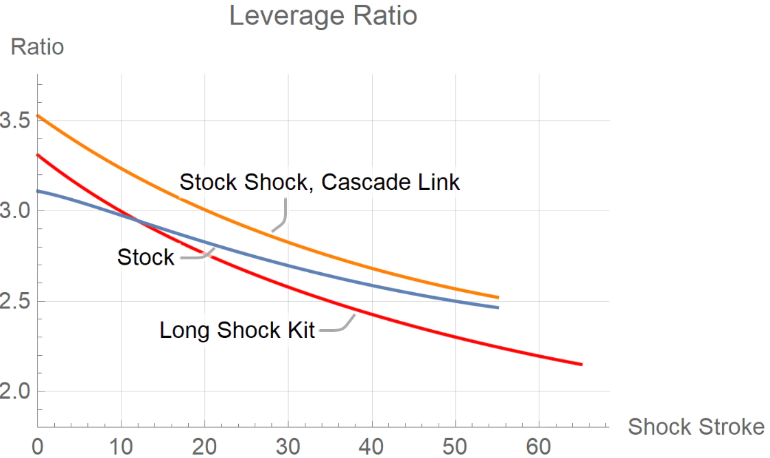

1 turn of preload on my spring, just to eliminate free play.
And yes, long link needs way lower spring rate.
I would say 25% is pretty small SAG, not much small bump sensitivity.
Did you have your TTX22m.2 changed to 230x65 or you are getting a new shock?
Tried same setup as you today and got same 15mm sag with 548 spring, but interestley bike rode fine with that little sag.
Have you tried it with 19mm sag?
I would be surprised if you got different SAG with same shock, same spring rate and same rider weight.
15 mm of SAG [23%] is maybe good for XC but all: Specialized, Cascade Components and Öhlins recommend 28-30% SAG.
With 23% there is just not enough droop travel for such bike to ride well - there is no excuse to make pogo stick out of Levo.
I still have not tried my bike with 29% SAG as the weather is not cooperating :)

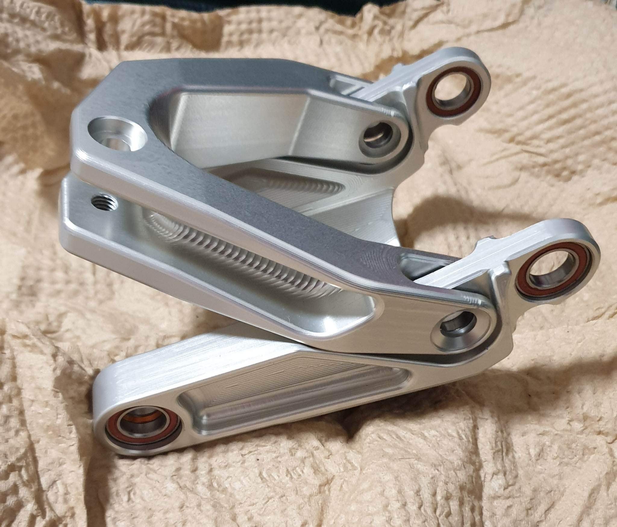

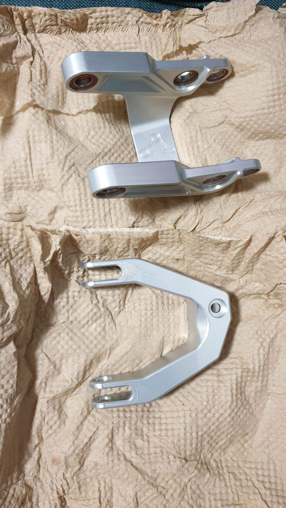

Very well made ….. certainly seems like it will add a bit of weight .
Shame I can’t afford a rear shock to try it just now 😂😂

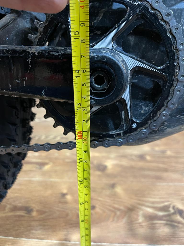

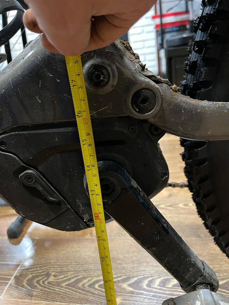

BB height comparison - static, suspension not compressed. My Levo Expert S4 sits 5-6 mm higher with Cascade long kit. I'm good with it as I was bashing my cranks and pedals quite a lot.
Left: OEM / Right: Cascade long kit

Standard shock and standard link BB is 342mm unladen and 305mm @30% shock stroke.
Long link kit with 65mm stroke shock BB is approx 355mm unladen and @30% sag approx 318mm (might explain the reduced pedal strokes).
Both in neutral and low. Figures aren’t 100% accurate but for the purpose of this argument they are close enough with a tape measure and a calibrated eyeball.

Below is the measurements I took on fully stock 2022 Levo Expert S4 with 160 mm Fox 38 vs. long kit.
Left: OEM [349 mm] / Right: Cascade long kit [355 mm] - 6 mm difference
Below official numbers from Specialized website: BB height 350 mm - 1 mm off from my measurement due to static SAG.

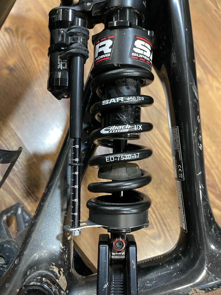

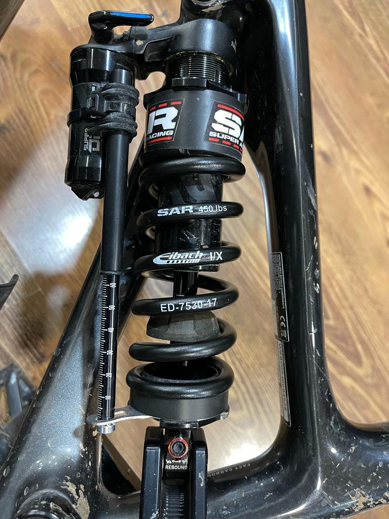

So I finally had a chance to ride my bike with long link and Öhlins TTX22 M.2 with 502 lbs/in spring which gives me 29% of SAG.
Since some riders reported problems with bottoming out the coil shock when set at around 30% SAG, first I took the bike to the city and hucked it to flat. My Fox 38 completely gave up bottoming out hard while the Öhlins TTX22 M.2 was smooth all the way. You cannot tell if and when the travel ends. I was simply blown away, just like my fork.
Next, I went for a ride on the known trail in the woods: jumps, berms, and downhill sections with big roots. UNBELIEVABLE! I forgot how compliant coil shocks can be. The rear feels much more planted, it tracks the terrain like crazy. I can only compare it to my 190mm travel analog bike with CCDB coil shock. Smooth and plush.
There is one problem however. Now my fork (Fox 38) feels like crap compared to the rear suspension. I think Smashpot should fix this and make front and rear suspension feel more alike. For reference, in my analog bike I have Marzocchi 55 RC3 Evo V2 Ti + Avalanche Cartridge. It's the definition of how the fork should perform. Hopefully, I can emulate this feeling by converting Fox 38 to coil.
What do you weight?

What do you weight?
85kg [187 lbs]
More details about my setup and spring rates here:
