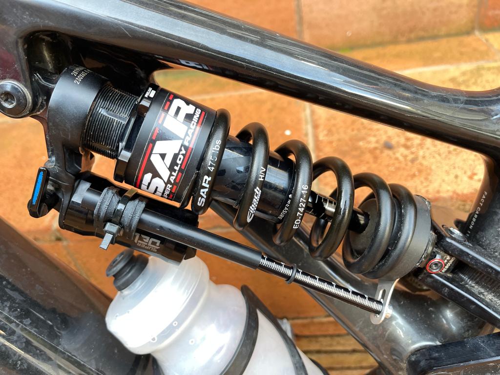

For those with long kit and coil shock.
Could you please share your coil shock model, spring rate and rider weight?
Did you change the fork travel to 170 mm or left it at 160 mm?
I'm considering Cascade long kit and Öhlins TTX22 M.2 230x65 for my 2022 Turbo Levo Expert [S4].
I currently run the bike full stock with Fox 38 160 mm and Fox Float X2 210x55.
I'm 190 lbs [85 kg] and wonder what spring rate to go for.
Thank you in front for any tips and suggestions.

Get a Sprindex spring so you'll have a 40 or 50lb adj range. I have been using those 2 for about 2 yrs. Not the lightest but worth it to dial in your shock.

I'm not new to biking and suspension that's why I'm bit skeptical with general recommendations posted on various websites. According to Cascade Components info, I should use use 550 lbs/in spring for my 85kg [190 lbs].
Based on the info in this thread I collected data for comparison:
- Lasse - 500 lbs/in spring @82 kg [180 lbs] with Marzocchi Bomber CR / fork: ZEB Ultimate 170 mm
- maramouse - 525 lbs/in spring @82 kg [180 lbs] with Öhlins TTX22 M.2 / fork: Fox 38 170 mm
- cañonaco - 475 lbs/in spring @85 kg [190 lbs] with Rock Shox Super Deluxe
- goodaa - ??? lbs/in spring @85 kg [190 lbs] with Öhlins TTX22 M.2 / fork: Fox 38 170 mm

I put the long shock kit back on as I at last received my Avalanche tuned Bomber and at my 90kg weight it was recommended I use a 500lb spring. I too was skeptical of this rate given the variety of recommendations listed above but I went ahead and bought one. The recommended sag figure with the kit is a constant with both Avy and Cascade so is a good target.... (19mm)..in saying that, with the 500 spring I'm only getting around 16mm of sag.
Also consider that if you use a smaller shaft shock like the Ohlins you will generally need to go up 25-50lbs in your spring rate to be comparable to the larger shaft shocks (area/fluid displacement etc).
The amount the BB has been raised with this kit changes the handling quite a bit. Previously with the HA in neutral and running a 29 rear wheel in low the bike felt super well balanced but as soon as I put the kit on the bike felt badly off and didn't initiate a turn well. Returning to a mullet rear helped as it dropped the rear again but more experimentation is needed to get it dialed.
I'm actually wondering if this bike is better with an air shock with the kit. Has anyone gone back and forth with coil and air and can share their thoughts?

I asked Cascade for advice about the spring rate and was assured the 550 lbs/in is the correct coil for my weight (85 kg). Now seeing his photo I'm even more confused.
What shock are you using? If it's an Ohlins TTX then the 550 will be close (maybe a little oversprung). If it's a Push/EXT/SD/Marzocchi then a 475/500 will be better.
I've been testing the Avy Bomber on a 500 spring (90kg)and I'm now running almost zero preload and the spring rate seems good. I'm using more compression damping than what was recommended and less rebound but overall I've got it working very well in the long chainstays and neutral HA, 170 travel front with 27.5 rear. Going to try the 29 rear again, the first time with the link the BB felt too high but I'm hoping it felt off because the shock wasn't set up. Fingers crossed.

If you sag a coil to 30% and you are even mildly aggressive you will bottom out hard. I'm having to run 600lb 25% sag with a similar setup on a long shock kenevo and still using all travel.
I'm 87kg

Agree that Ohlins tend to have more damping than Rockshox or Fox dampers. The spring rate difference is due to the Ohlins running a smaller diameter main shaft and having less rod force vs the 1/2" shaft of Push/EXT etc so in general spring rates are about 25lb heavier to compensate.

How shaft diameter would affect the SAG?
