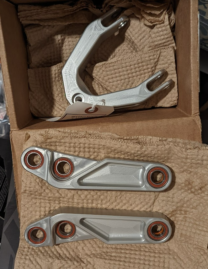

I just picked up a gen 3 a couple days ago. Got the comp carbon and put my parts on it. Got the long travel link today and have the E stroia EXT on order. 38 at 170mm, ran that shock on my 2020 levo and it was rad. I thin kit is prob the most durable coil for the yolk style bikes.

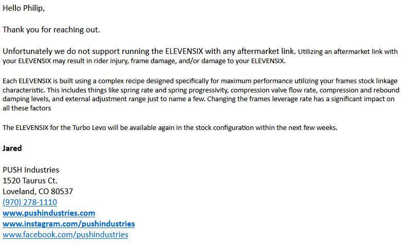

I recently asked PUSH regarding CC Long Shock kit with the 2022 Turbo Levo. This is the response I got
Effectively Pushed a potential customer away. Also regarding the CC Long Stroke Kit, I'm currently waiting response from EXT.

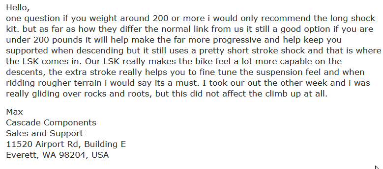

Regarding the CC long stroke, I asked the guys at Cascade the following
This is the response I got,

I too got the same lame response from Push when I asked them to re-tool my 11-6 to work with the Levo and the Cascade Long Shock Link. They also refused to tune the shock to work with Cascade on my Enduro. I'm no expert but I think they just don't want to deal with all the possible permutations from Cascade. Their excuses of catastrophic failure and impossibly high spring rates don't really make sense considering the reports from the field of people doing exactly what we are asking.
I also got the SAME amazing reply from EXT. They have tons of experience with Cascade on the Levo and highly recommend the E-Storia which is really a whole new model of shock not just an 'E" version. They answered the phone when I called and were super helpful.

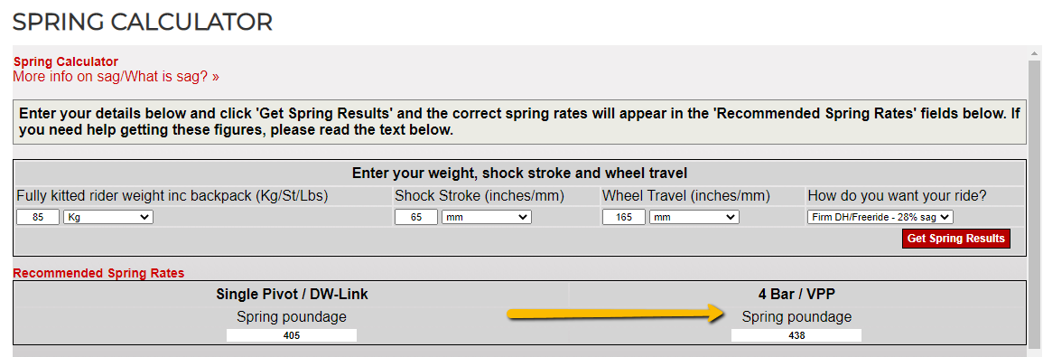

Best tool around, great for starting out
the calculator itself indicates that the extra weight of the e-bike must be added, as well as clothing and equipment.
Real travel it’s near 170
