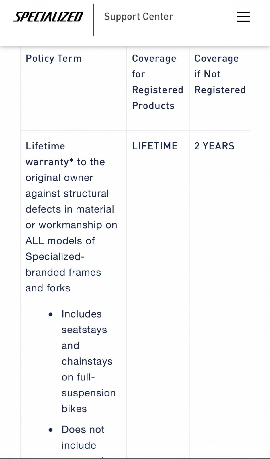

iIn Europes conditions everything is covered:
Lifetime warranty* to the original owner against structural defects in material or workmanship on ALL models of Specialized-branded frames and forks
  • Includes seatstays and chainstays on full-suspension bikes
Best regards,
Chris
Makes sense, might be a USA only warranty stipulation. Sounds like a good deal for those that get the coverage.

Under Global Warranty Policy (USA/Canada file has the same verbiage)
Link

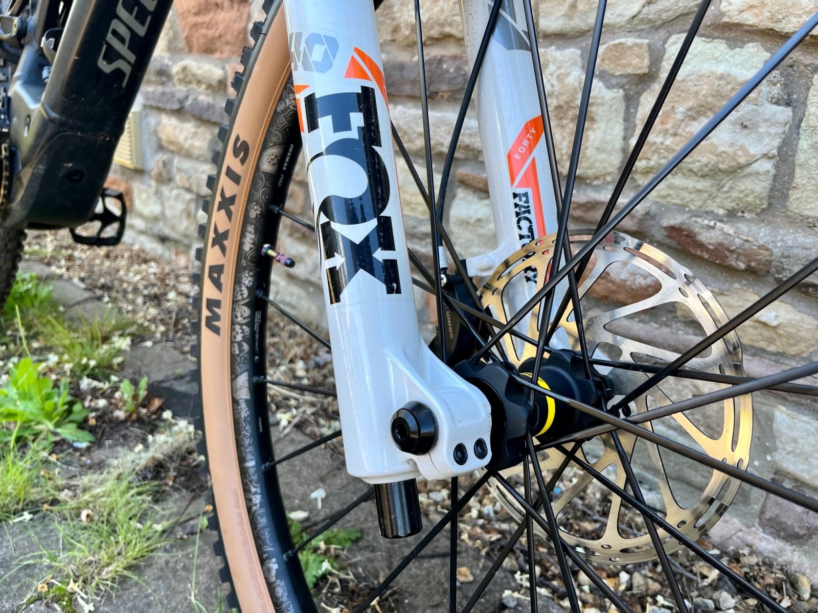

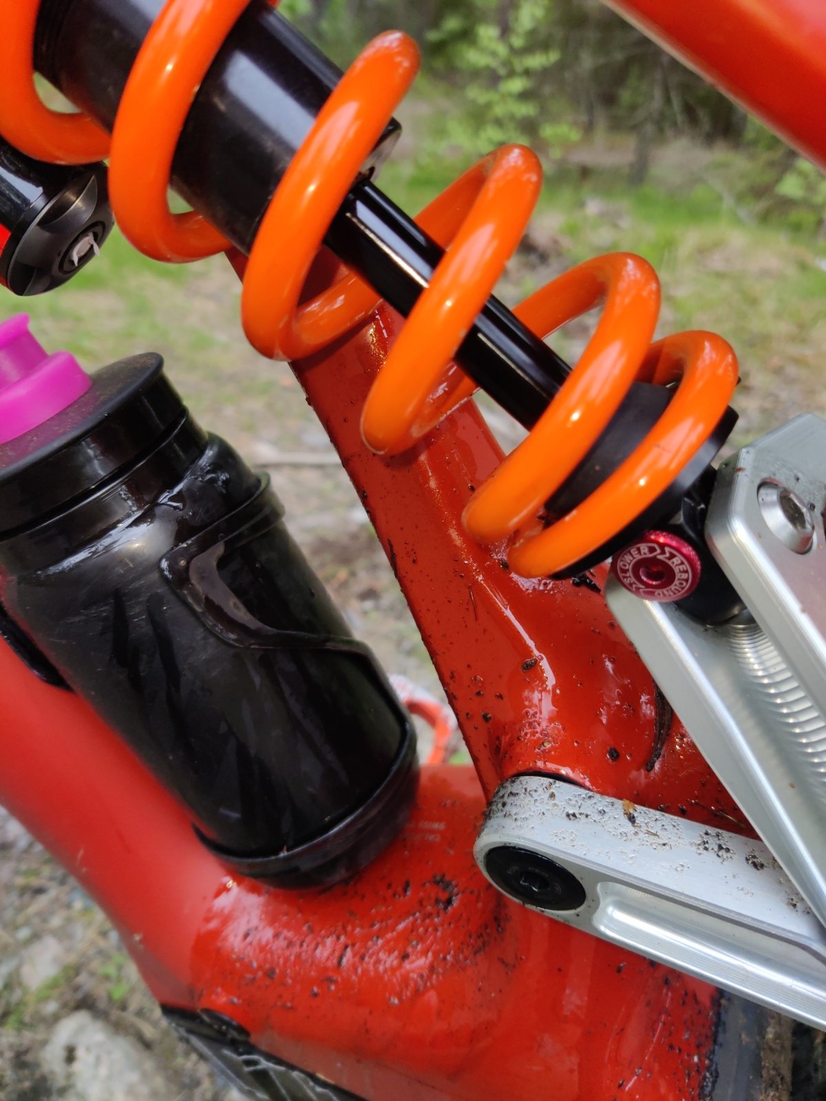

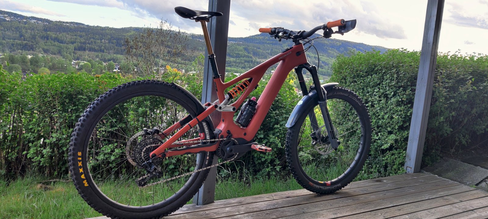

Hi @Lasse, excuse me, if I can ask, 2 questions, first one I have a fox 38 set at 170 mm and I have a head tube angle of 63 degrees, with a "low and slack" set, you who use the zeb 180 what hta do you have?
second question, I am 82/83 kg with clothing, helmet and backpack and body protectors, I have a dhx2 factory 2021 and I use a 525 lbs spring as cascade table and I am fine, but I do not do high jumps, I ask you that spring you use and how much you weigh, thanks.
Lasse
May 22, 2020
34
30
Norway
Hi @maramouse .
I used a 29" rear wheel combined with low setting, no changes to head cup.
My weight is 80-82kg, and used a 500lbs fox SLS spring, and was happy with that.
However, the MARZOCCHI Bomber CR is not up to the task. My friend had the same setup, and we both have blown the shock oil out. Are now looking for a replacement shock

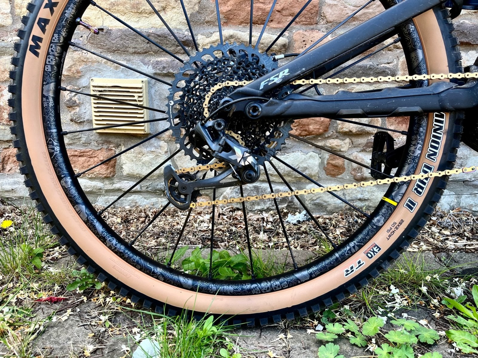

Hi @maramouse .
How did you fit a 29er wheel? I tried and it didn’t even come close to fitting. I had a 2.6 tire. Are u running a 2.3 or 2.4?
also, why did you choose to go with a 29er instead of mullet?
Lasse
May 22, 2020
34
30
Norway

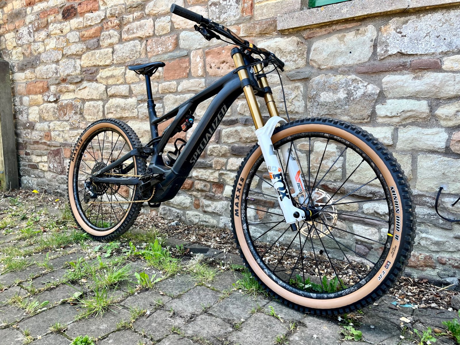

Maxxis Assegai 2.5" fits if you have rear link i "long" setting. Some mud guards might have clearance issues..I have a pair of SC reserve 29", and love those. Actually haven't tried the mullet setup yet, will do that👍🙄

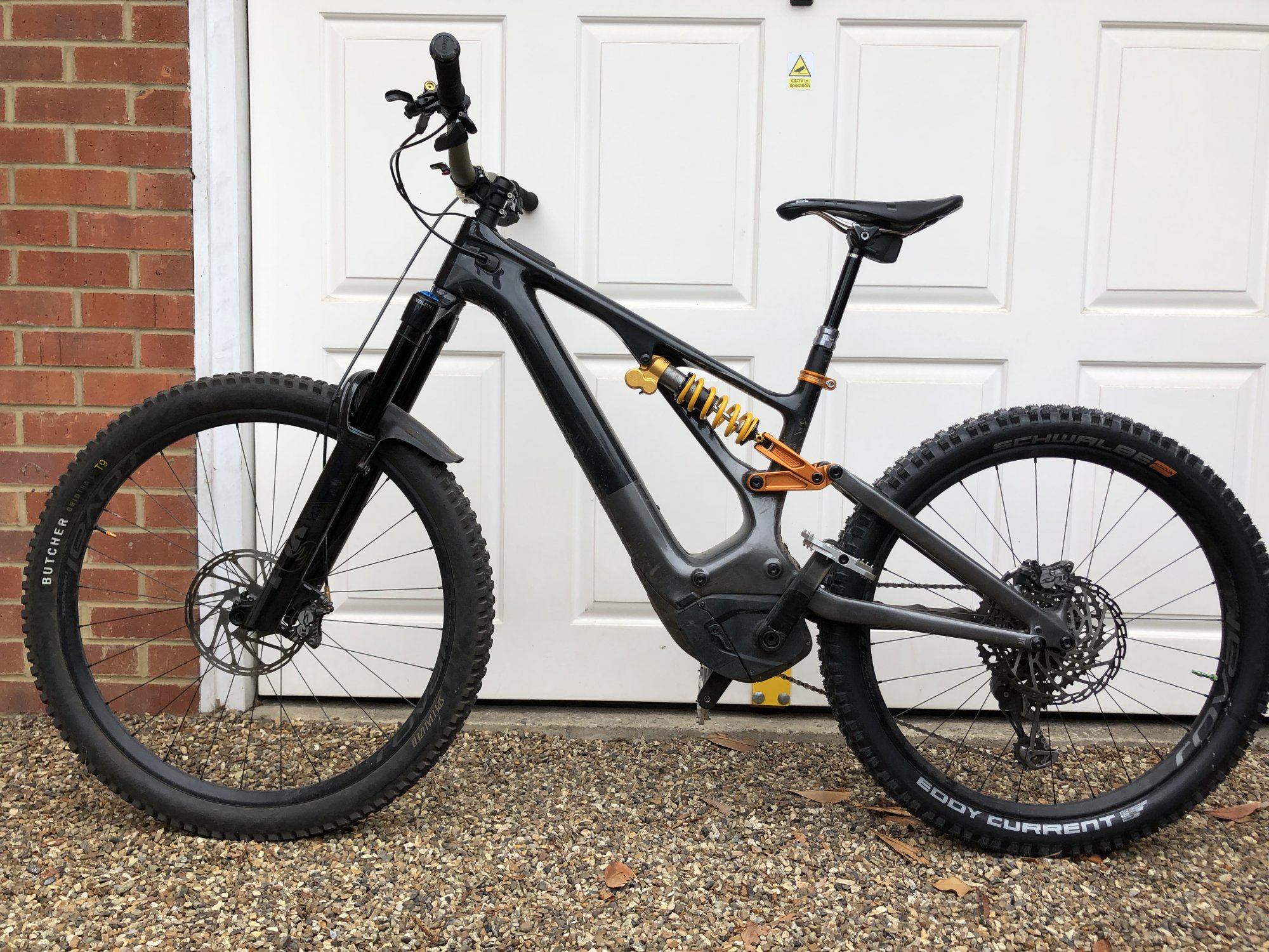

I’ve been riding the cascade long link with a Ohlins TTX22 230x65 with the Fox 38 extended to 170mm for the last few months. I’ve ridden BPW and more local trails and I’m very happy with it, slack at the front with high setting on the rear. Back end melts away out of mind now.
I’m on an S3 at 85kg.
we are heading to Morzine this weekend for week. I don’t do massive jumps, but doclear tables and do good size drops.
The bike feels really good, probably lost a bit of fund simply because it is so much more capable now - but that’s what I wanted to be able to soak up big landings.

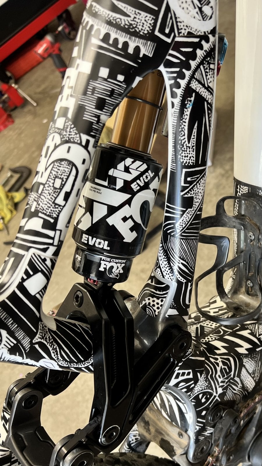

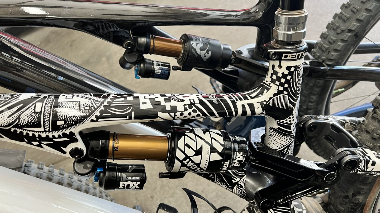

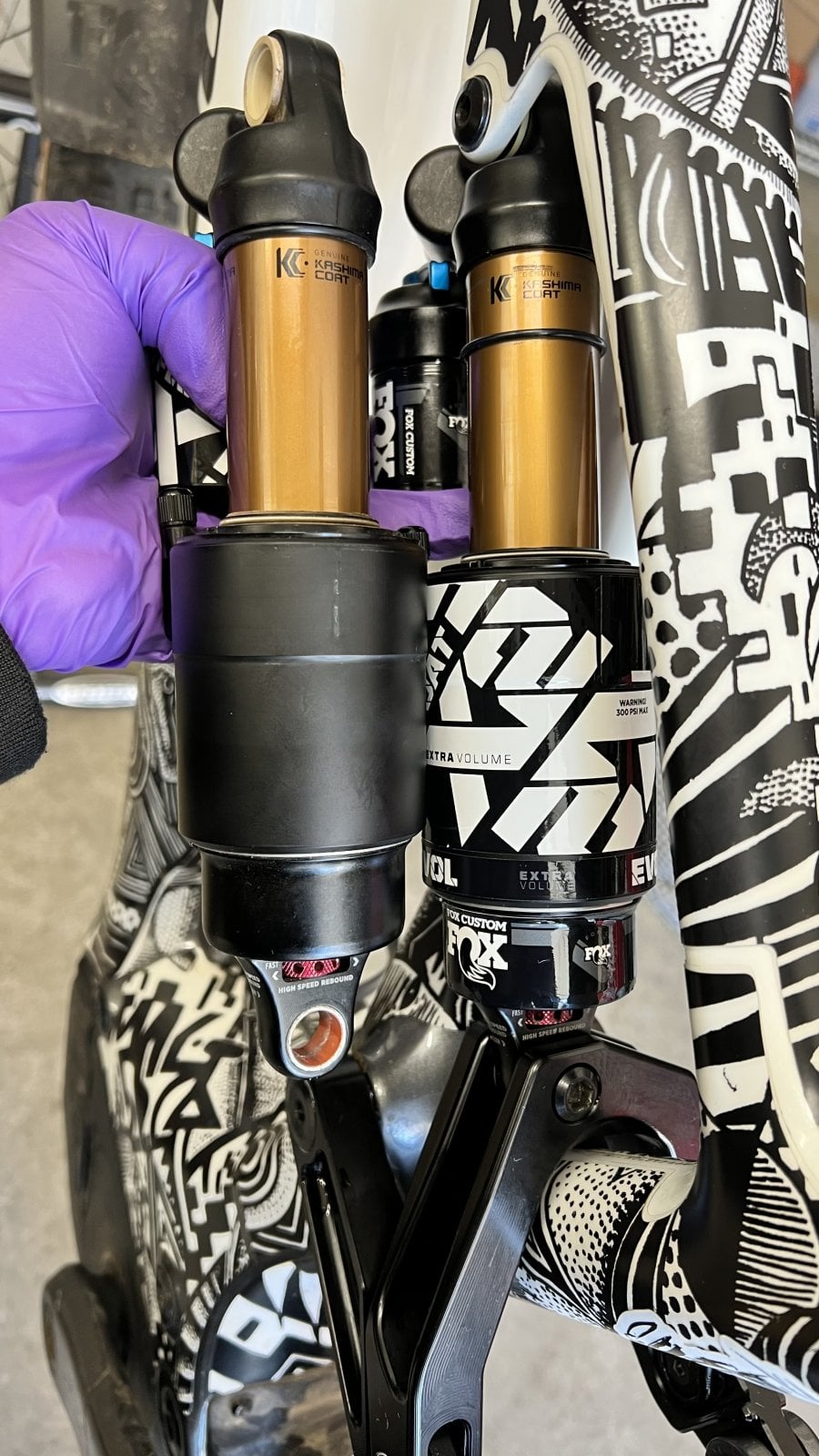

Just finished install. Excited to go for a ride and finish set up.
Stock 210x55 upgraded to 230x65
Will convert stock 150mm travel to 165mm
No more high pressures. Easy bottoming out gone
No clearance issues View attachment 83400
side by side with a stock gen3 Levo
170mm travel up front. 165mm rear!
Will post the 210x55 for sale soon
** you can see the DU bushing on replaced shock (hole near HSR) View attachment 83403
*Took the 230x65 X2 from my Kenevo and serviced by Fox. Fitted the stock rockshox coil back on.
**i was lucky to already have a DU bushing for the shock. Saved me from dropping what i was doing and making a run to the bike shop. You can use the old bushing from the old shock if you have the tools. But I recommend having a new DU bushing. (Don’t know if this was mentioned on CL site as i did not read any of the instructions lol)
