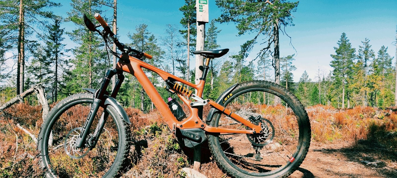

Levo Gen3 (Z4) with cascade long link, Marzochi Bomber CR 230x65, FOX SLS spring (500lbs/in). ZEB Ultimate 170mm.
Low/long setting. 29" front/rear
>Next will be 180mm up front.
Rider weight 81.
Previously with stock link, I ran a Rockshox super deluxe 210x55 w/ progressiv MRP coil (450+), which was very nice.
The new setup is more "bomb-proof" in rough sections.
After 1st ride, reduced LSC to one click from fully open, and spring load adjuster to minimum (1 full turn after initial contact)
