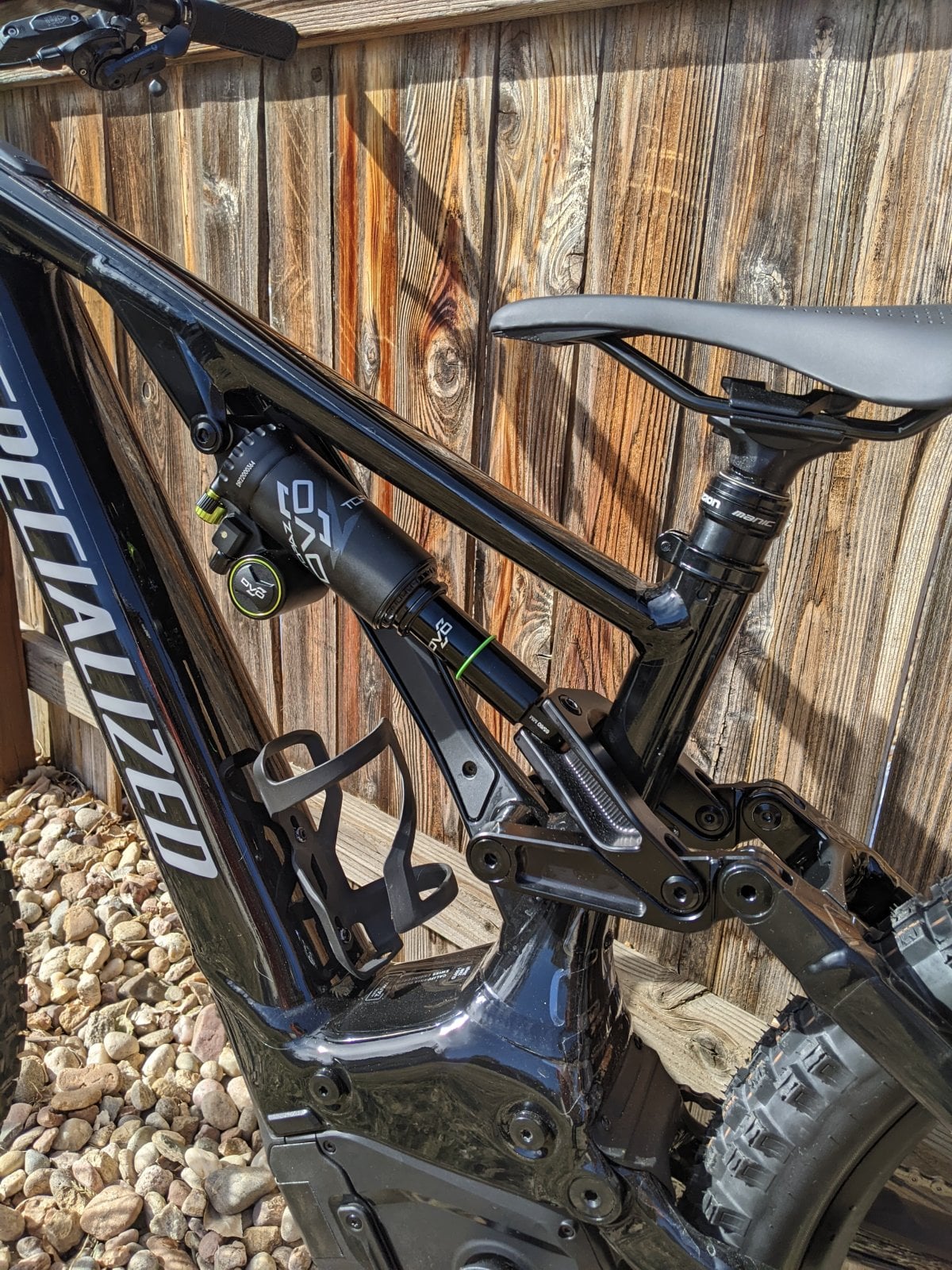

For those looking for an advice regarding spring rate - don't take anything for granted and don't trust anyone ;)
Recommended spring rates are way off even on Cascade Components website!
According to their info, I should use use 550 lbs/in spring for my 85kg [187 lbs].
Based on the info in this thread I collected data for comparison:
-@ Lasse - 500 lbs/in spring @82 kg [180 lbs] with Marzocchi Bomber CR / fork: ZEB Ultimate 170 mm
- @maramouse - 525 lbs/in spring @82 kg [180 lbs] with Öhlins TTX22 M.2 / fork: Fox 38 170 mm
- @cañonaco - 475 lbs/in spring @85 kg [190 lbs] with Rock Shox Super Deluxe
-@ goodaa - ??? lbs/in spring @85 kg [190 lbs] with Öhlins TTX22 M.2 / fork: Fox 38 170 mm
I got confused by the big difference in spring rates used by different bikers (475-525 lbs/in) and that recommended by Cascade (550 lbs/in). So I contacted Cascade Components directly and even showed them the data I collected [above]. They confirmed the recommendation twice: "It should still be nice and supple, the 550 is the correct coil for your weight."
So based on their recommendation I ordered 548 lbs/in spring for my Öhlins TTX22m.2.
Guess what, I got the SAG 23% [15 mm]. The spring was extremely firm!
So I ordered another spring, this time 502 lbs/in and I got SAG 29% [19 mm].
I have no way to test the bike as it's snowing like crazy lately but I have a feeling that the Cascade linkage is more suited for air shocks and their progressive characteristics than for linear coil shocks. If my field tests will confirm this to be true, I will experiment with progressive spring, e.g. Cane Creek VALT.
Nevertheless, lesson learned [money lost]. Honestly, I am really disappointed in Cascade's recommendations, database/knowledge and their support. I understand that you cannot give 100% correct spring rate recommendation but I hoped for little more knowledge from the producer about their own product and base settings for the specific bike and specific rider. 23% SAG I got by using spring they recommended was not even close to expected 28-30% SAG (that they also recommend on their website).
There, learn from my mistakes and experimentation.
I will keep you updated after I get some time on the bike.
Below some photos of the shock, springs weight comparison and linkages:

And yes, long link needs way lower spring rate.
I would say 25% is pretty small SAG, not much small bump sensitivity.
Did you have your TTX22m.2 changed to 230x65 or you are getting a new shock?
javier161
Jan 28, 2022
14
miami
1 turn of preload on my spring, just to eliminate free play.
New shock. I should get more than 25%bsag with Long link and 550 spring.
javier161
Jan 28, 2022
14
miami
I’ve been riding the cascade long link with a Ohlins TTX22 230x65 with the Fox 38 extended to 170mm for the last few months. I’ve ridden BPW and more local trails and I’m very happy with it, slack at the front with high setting on the rear. Back end melts away out of mind now.
I’m on an S3 at 85kg.
we are heading to Morzine this weekend for week. I don’t do massive jumps, but doclear tables and do good size drops.
The bike feels really good, probably lost a bit of fund simply because it is so much more capable now - but that’s what I wanted to be able to soak up big landings.
What is your spring rate on the ohlins?
555K
