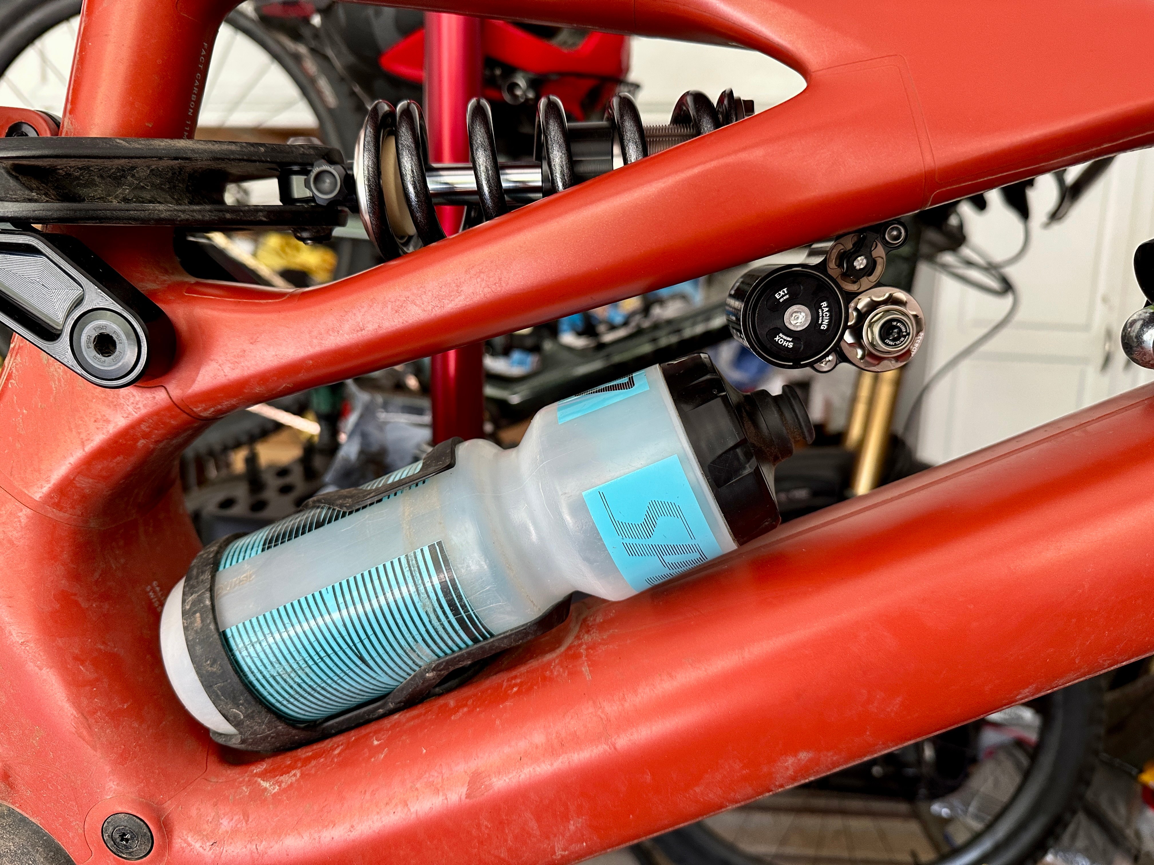

So I finally had a chance to ride my bike with long link and Öhlins TTX22 M.2 with 502 lbs/in spring which gives me 29% of SAG.
Since some riders reported problems with bottoming out the coil shock when set at around 30% SAG, first I took the bike to the city and hucked it to flat. My Fox 38 completely gave up bottoming out hard while the Öhlins TTX22 M.2 was smooth all the way. You cannot tell if and when the travel ends. I was simply blown away, just like my fork.
Next, I went for a ride on the known trail in the woods: jumps, berms, and downhill sections with big roots. UNBELIEVABLE! I forgot how compliant coil shocks can be. The rear feels much more planted, it tracks the terrain like crazy. I can only compare it to my 190mm travel analog bike with CCDB coil shock. Smooth and plush.
There is one problem however. Now my fork (Fox 38) feels like crap compared to the rear suspension. I think Smashpot should fix this and make front and rear suspension feel more alike. For reference, in my analog bike I have Marzocchi 55 RC3 Evo V2 Ti + Avalanche Cartridge. It's the definition of how the fork should perform. Hopefully, I can emulate this feeling by converting Fox 38 to coil.
Do i see right your TTX has a golden shaft ? I have Seen only chrome Silver shafts also in the m.2 Version and the Plastic spring protection sleeve is also shorter. Looks nice 👌 Is This a special Version ?
Best regards,
Chris
Good eye sir - there is a golden shaft in my TTX. The shock was built from scratch with a custom valving for Levo, my weight and riding style. It is a mix of parts from previous version and M.2. Golden shafts are usually reserved for World Cup racers but somehow this particular Öhlins partner got hold of them and presented them as having lower friction, great coating durability, etc. To be honest, I found it a marketing bullcrap (just like Kashima coating) but at the end went for it due to cool factor and the looks :ROFLMAO:
There is also updated one-piece black bottom out bumper that is a bit longer than standard one. I find this more performance relevant (than the golden shaft) as I am really not able to bottom out the shock. I use the full travel very often but there is no harsh feeling at the end of the stroke compared to other shocks I have ridden in the past. Plush all the way!

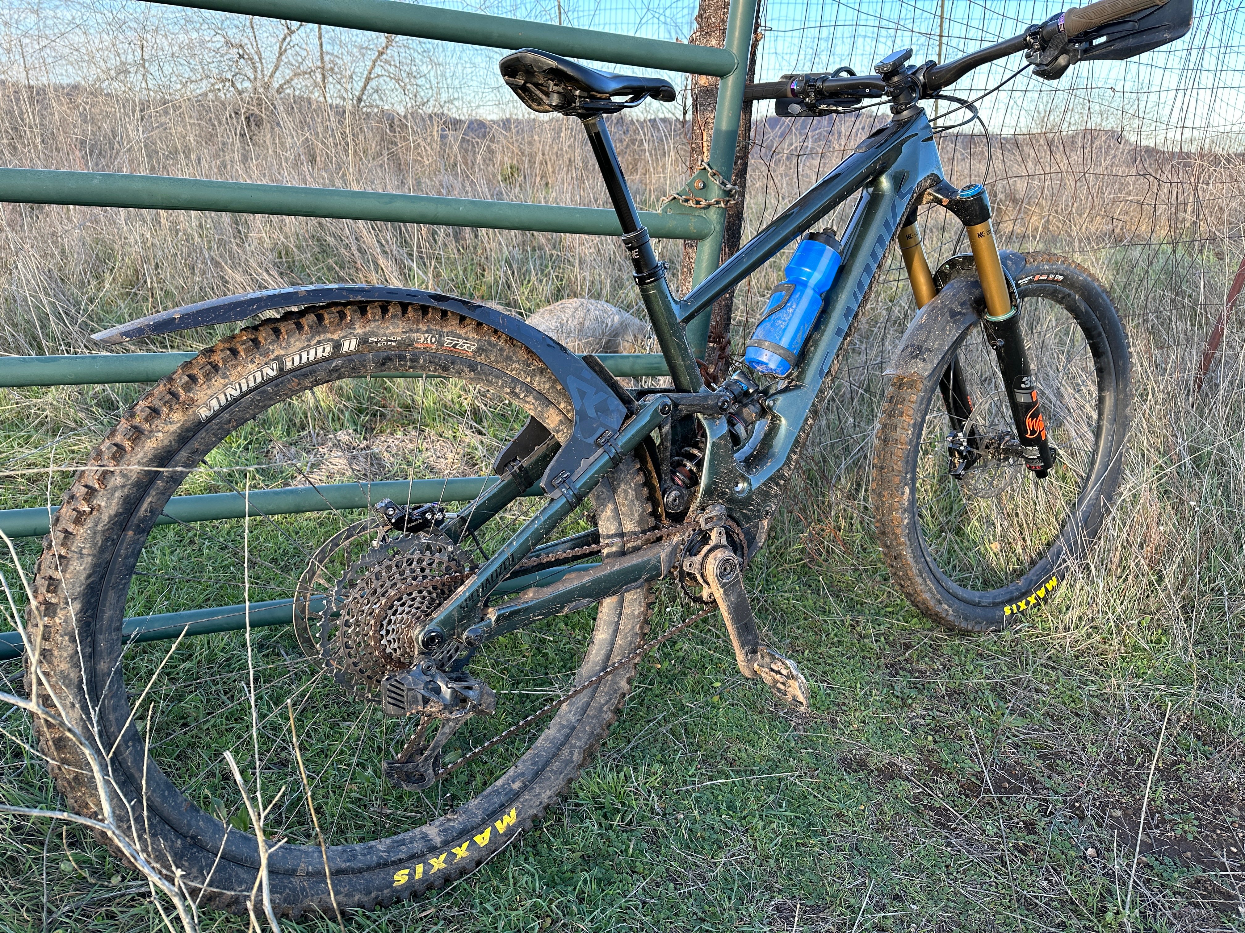

Just to add more data to the pool - I just installed a regular link (not the long shock one), and BB height was identical before and after. 343mm on my bike set at middle/high with a 2.5 Assegai and 2.4 DHR II.

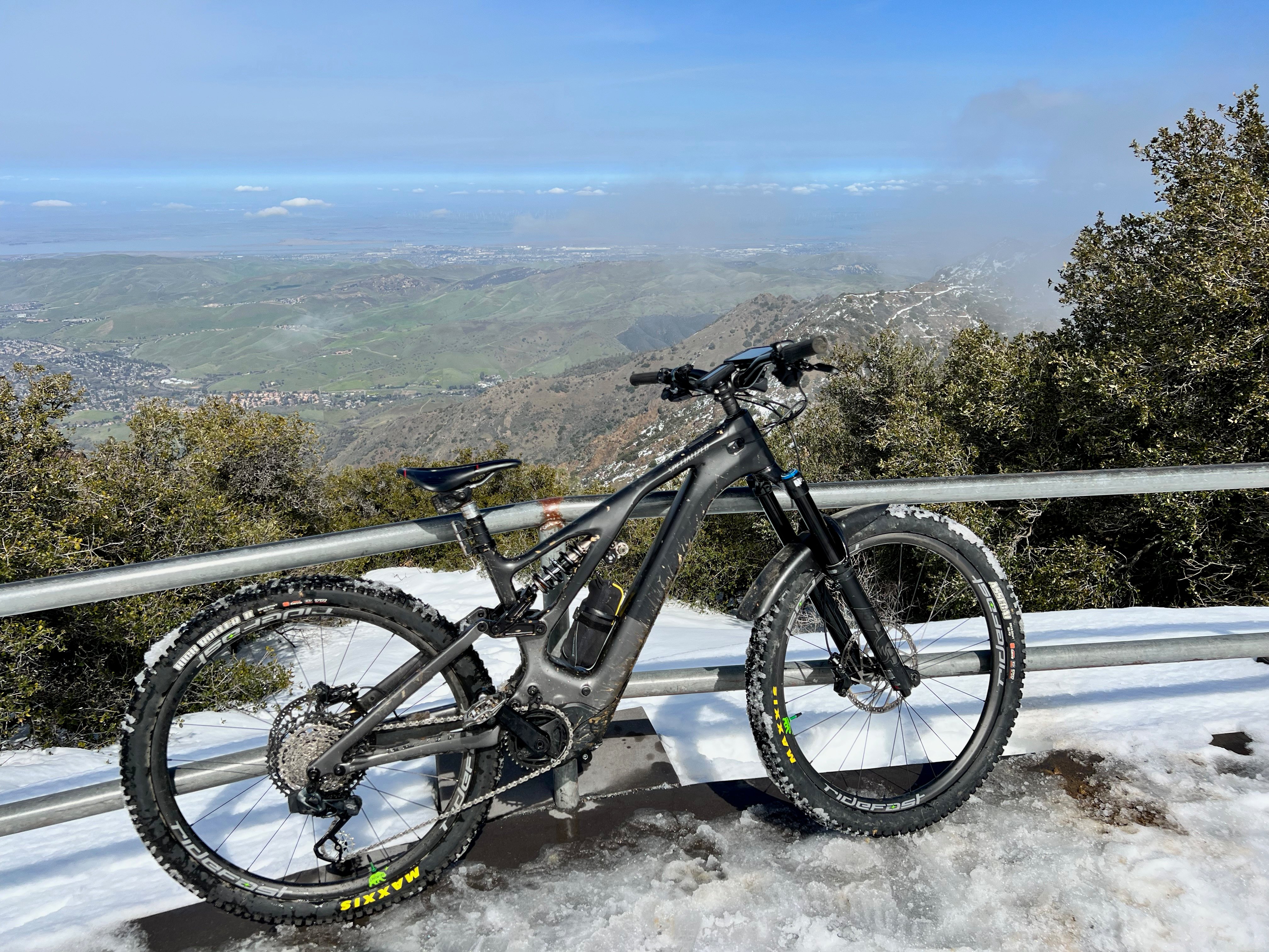

How’s it ride with the EXT/LT link combo?
Not sure... EXT shock just showed up today and my trails are all waterlogged from the battering of rain the whole Bay Area has gotten over the past several weeks, so I haven't had the chance to test it out yet.
Just from the driveway impressions though, I'm pretty impressed they got my spring rate spot on and rebound only 1 click off, to be balanced with my fork (although I did write a 1,084 word mini essay describing my setup, riding style, and terrain, to go along with the order form).
I weigh 150 lbs and was previously running 230psi and no volume spacers in the X2 with stock linkage. I always set suspension purely based on feel, not sag, but the sag ended up right in the ballpark 15.5mm. With the CC link (standard 210x55, not the long shock link) the 475lb/in spring they included gives me the same perceived stiffness as the original setup and feels balanced with the front end.
All that being said, I have a Vorsprung Smashpot with a 45 lb/in spring showing up for my 38 next week, and I also just got a Sprindex on order, so I can get the rear end perfectly balanced with the front, since the fork springs come in 5 lb/in increments.

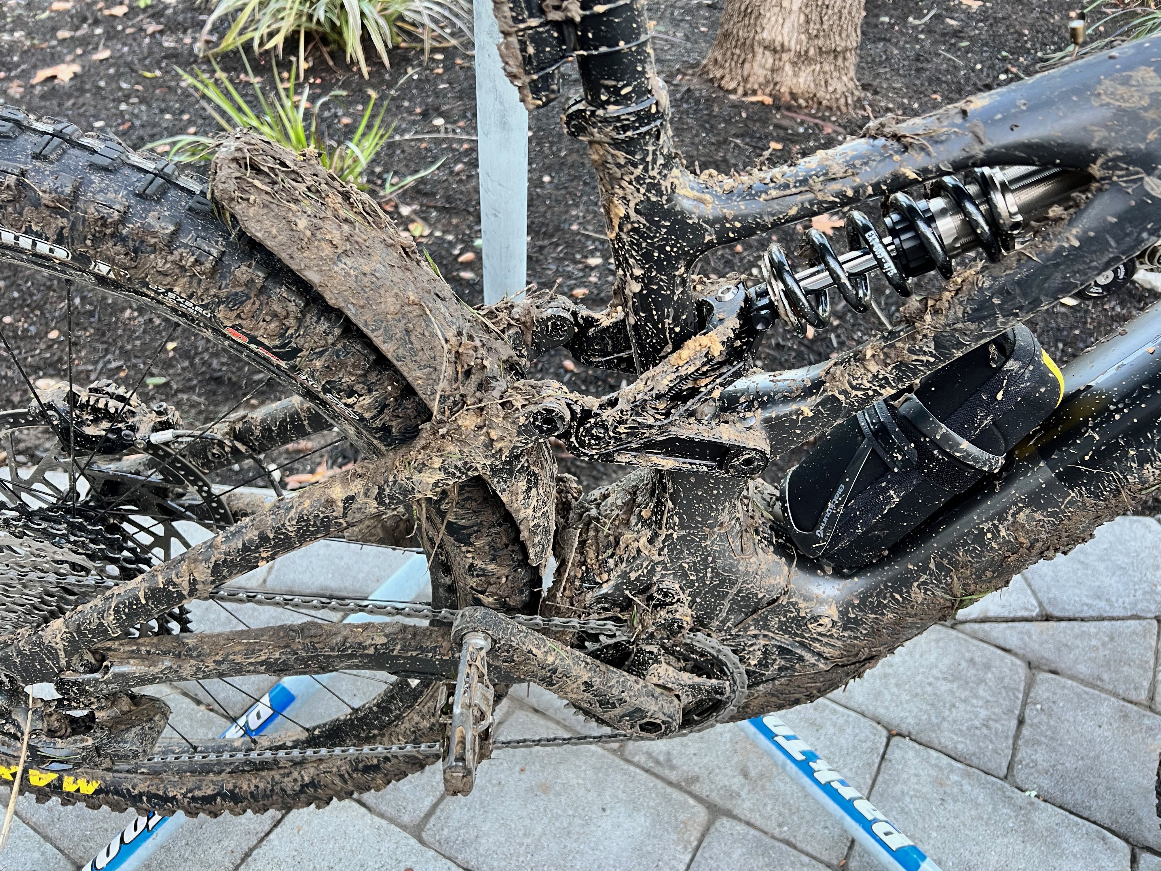

Check out the SKS Mudrocker. It attaches to the top of the seat stays, rather than inside, and the section that fits in front of the tire inside the triangle can be removed, so it has no impact at all on tire clearance.
The mudguard I used was mainly to keep mud off the back of the frame/pivot/motor. The SKS one looks like it would work well for keeping water and splatter off your backside though not so much the frame…..?
It does a great job at keeping dirt off the linkage and dropper. My KSL is a good example of that, with the linkage and shock being so exposed:
Also, more on topic with this thread - I was able to get my first ride in on the new regular CC link and E-Storia, and I'm absolutely blown away with the shock.
Between my KSL and Enduro, I've put about 5,000 miles on DHX2's and have gotten them as dialed in as you possibly can. I never believed the hype with EXT's, thinking it couldn't really get any better than the current DHX2, having independent adjustments for high/low speed rebound and compression, but the E-Storia on my Levo has the rear end feeling better than my KSL or Enduro have ever felt. The best way I can describe it is it just keeps the rear end very composed and keeps the rear wheel in constant contact with the ground.
I even changed some settings in the driveway to get it feeling balanced with the fork, but once I got out on trail, I did some more fiddling and actually ended up right back at their original settings for rebound and compression, only dialing in the HBO a bit more. I sent them a riding video and went into great detail on my setup preferences, riding style, and terrain, so it's super cool to see they actually listened, interpreted it all correctly, and set it up properly. This shock is so good, the front end now feels bad (as someone else mentioned above with their Ohlins), so hopefully, the Smashpot showing up next week brings the two ends closer inline. Without a doubt, this is the only coil shock I'll ever buy from now on.
