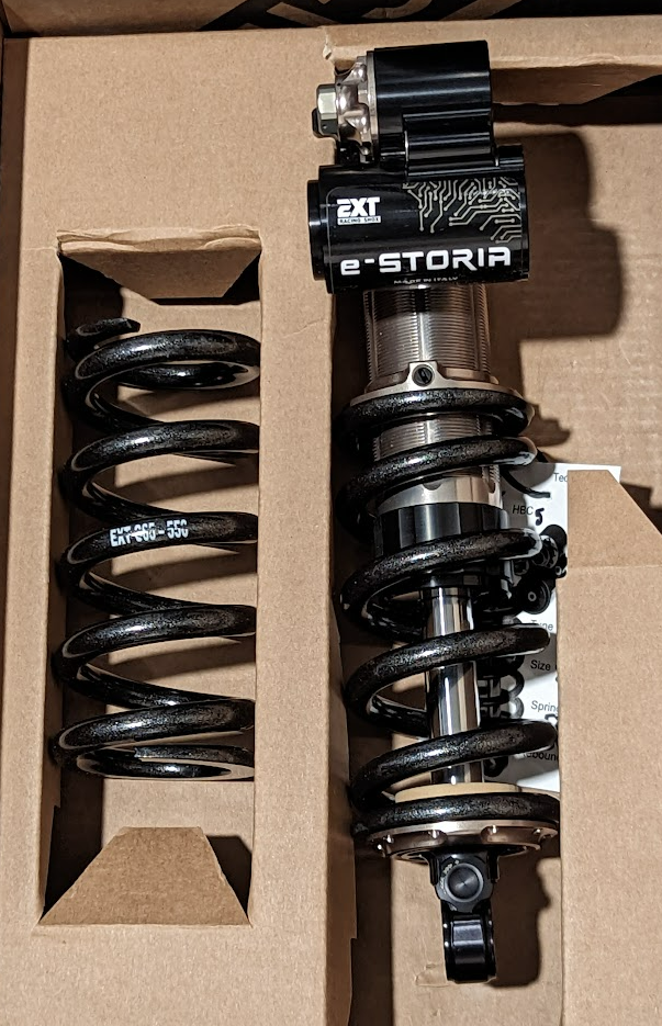

I know I'm ordering the Cascade long shock kit, I may go with the EXT E-Storia shock because getting it through Cascade will give me a deal and I can work directly with them to make sure it's setup for the link and my style/weight etc. Still deciding on a specific shock though which is why I haven't ordered the link yet.
If I go with the EXT I need to order it at the same time as the link to get the discount.
For my fork, I'll leave on the Fox 38 but upgrade the internals, I've never used any of the Avalanche products but pretty sure I'll do their cartridge as you suggested, I keep hearing amazing things about it!
However, I'm on the fence for smashpot coil conversion vs avalanche hybrid coil. I'm so ready to order everything... once I decide which route haha

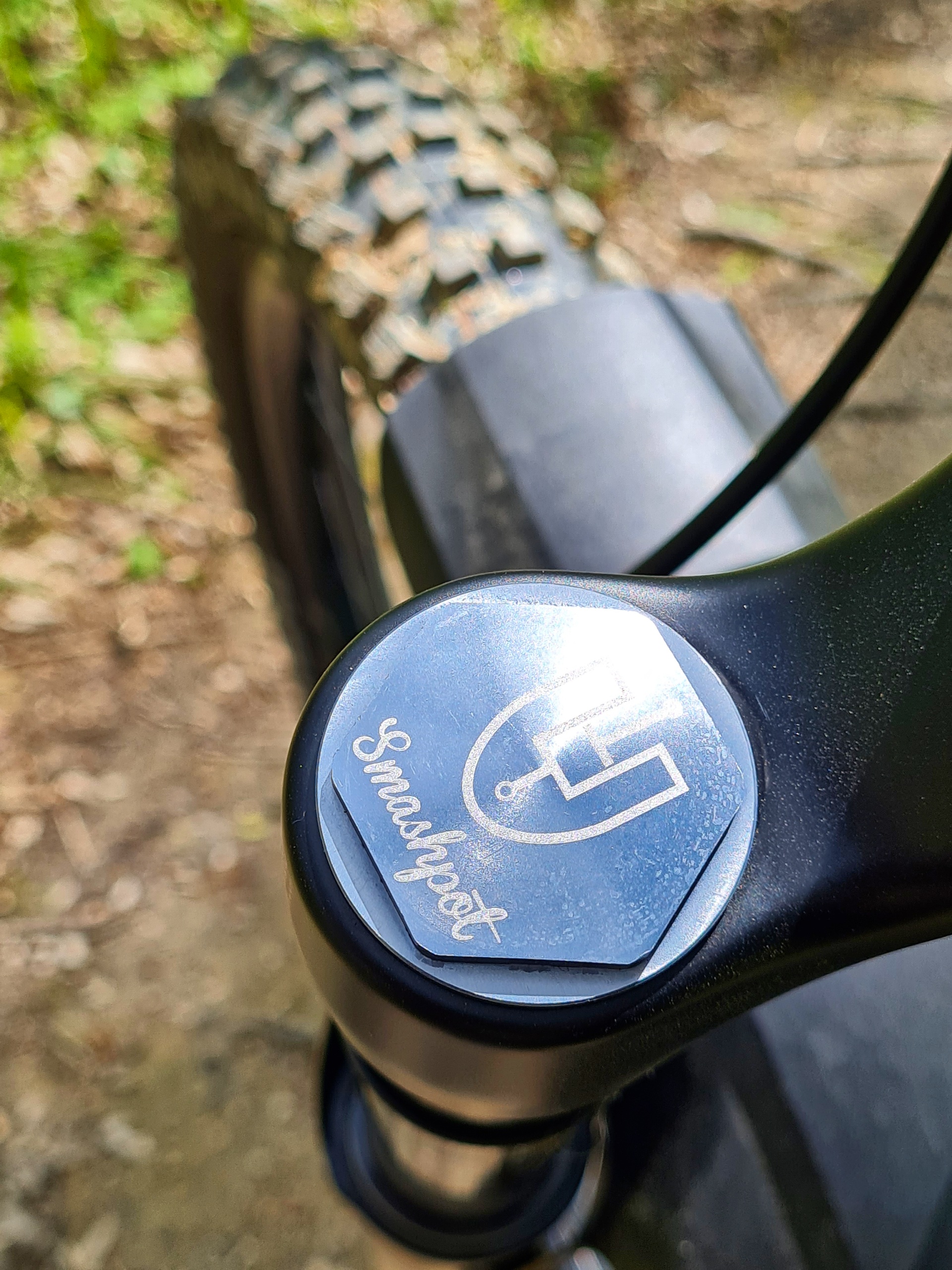

I was running fork at stock 160mm but recently upped the travel to 170mm while installing Smashpot. Don't see much difference between both travel options.

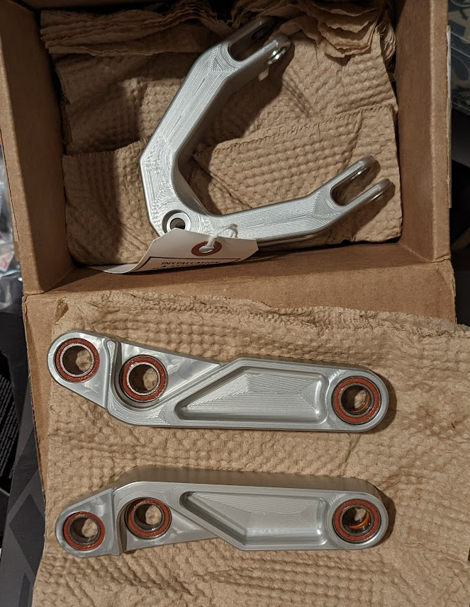

No experience yet but my link was delivered yesterday and the longer shock (EXT E-Storia) should be delivered Monday or Tuesday.
I also ordered a new air shaft to up the fox 38 to 170mm.
So I’ll let you know next week how it feels haha

I ordered the smashpot kit, I’m going to set it up at 170mm since that seems to be what everyone seems to say is the best. I’ll probably run it in slack/high and see how it does.

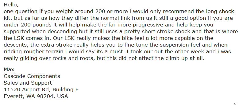

Regarding the CC long stroke, I asked the guys at Cascade the following
This is the response I got,

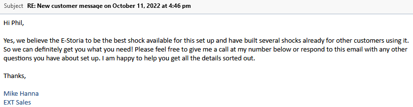

I also asked the guys at EXT regarding the E-Storia installed on the Gen3 Turbo Levo with the CC Long Stroke. This is the response I got
I'm a huge fan of Cascade links pared with EXT shocks. My daily has been a Dreadnought with Cascade B1 link with EXT Storia Lok v3, set up as mullet. I haven't ridden anything that comes close to how well the rear wheel tracks the ground. I just demo the Ibis Oso and the new DW rear linkage kinematics can't touch my Dreadnought set up.
