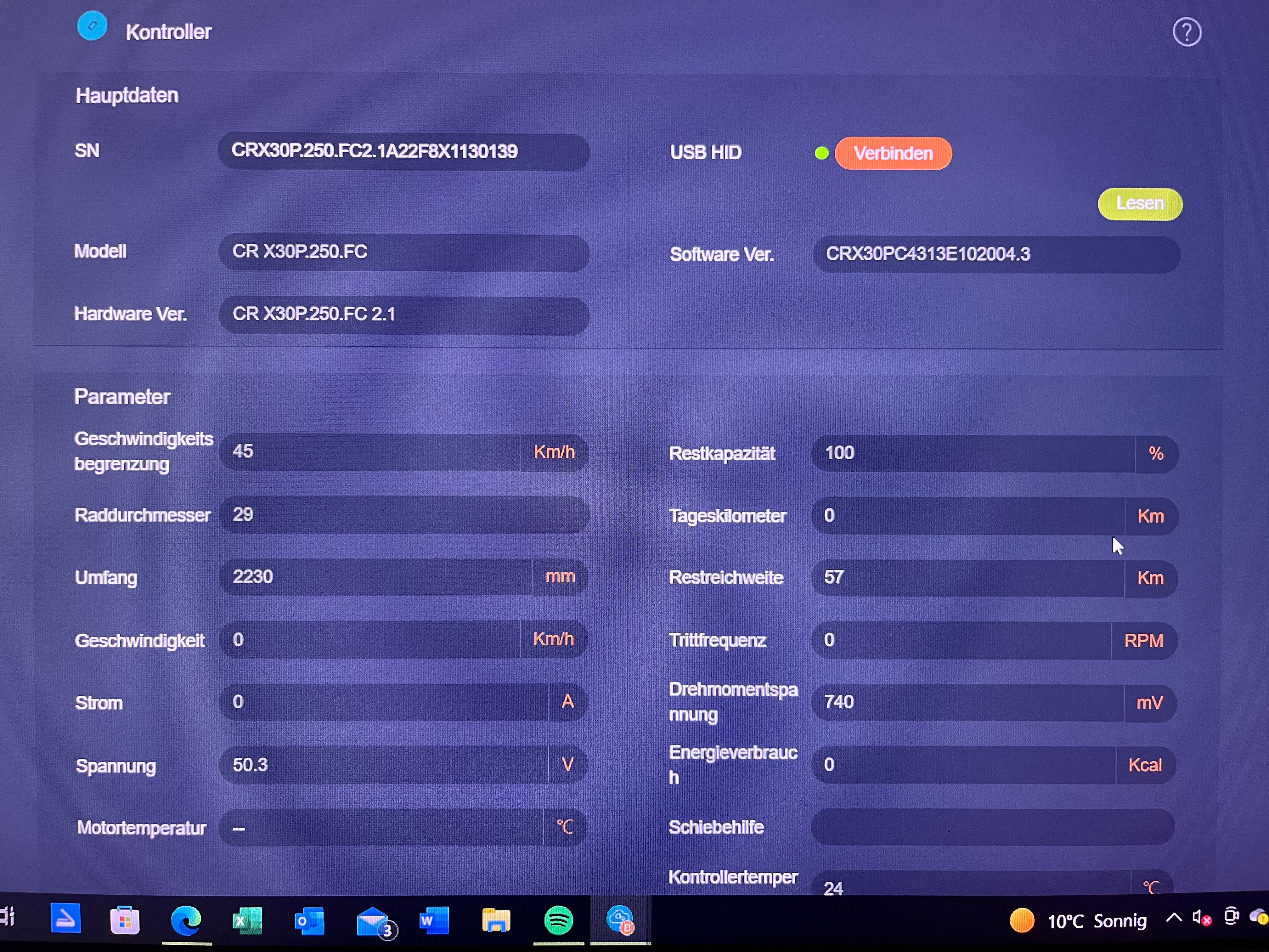

There are two separate versions of the m820 36v and 43v.
The Besst can be used on the m820.

great news to see that it's fully compatible with BESST!

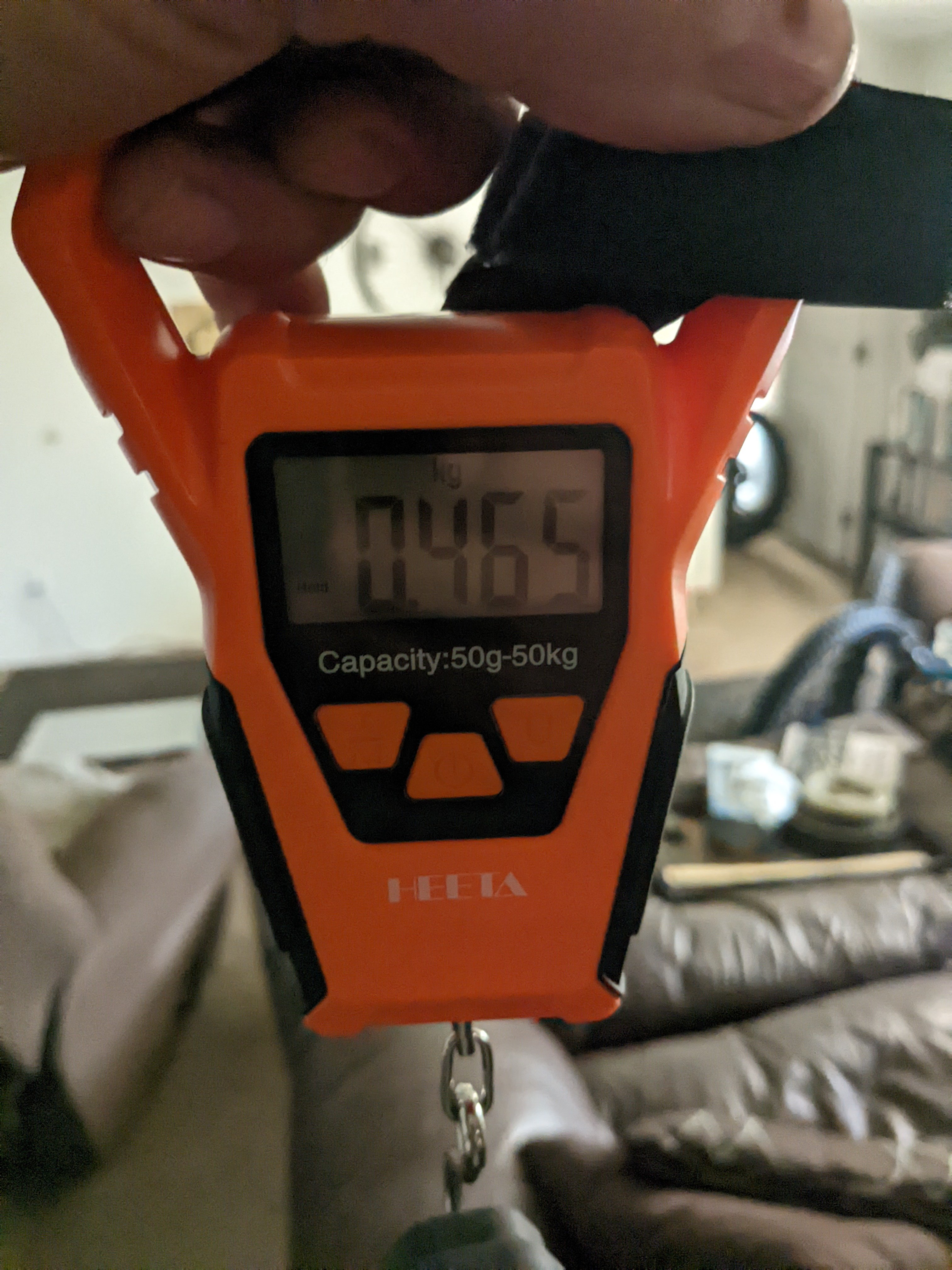

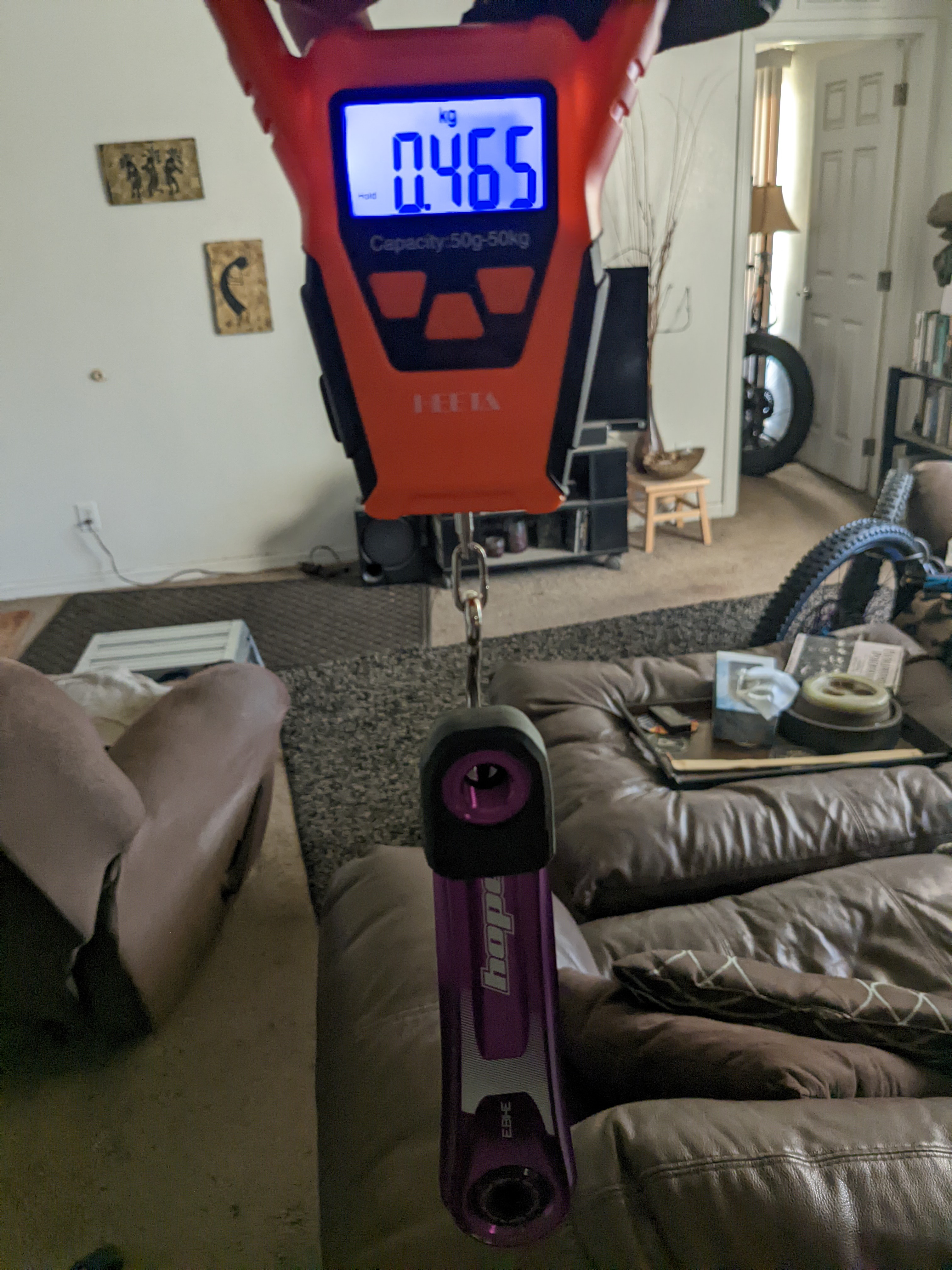

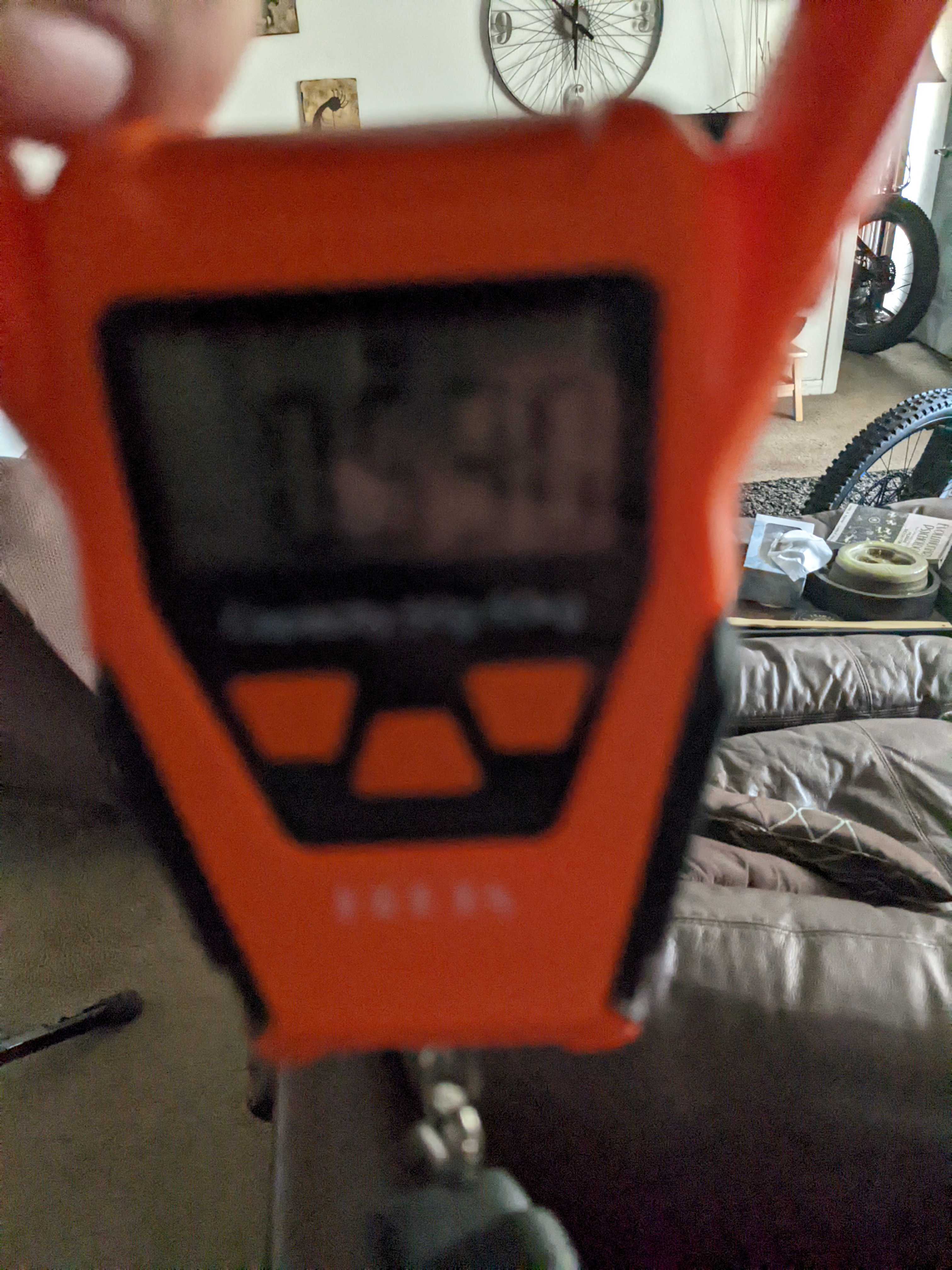

Here's my E-Hope 155 mm cranks at 465 g. Not superlight but very strong, as I predict I will have to pedal more out of the saddle with the 820 like when I rode the TQ50/Fazua60/Shimano RS lower torque motors.

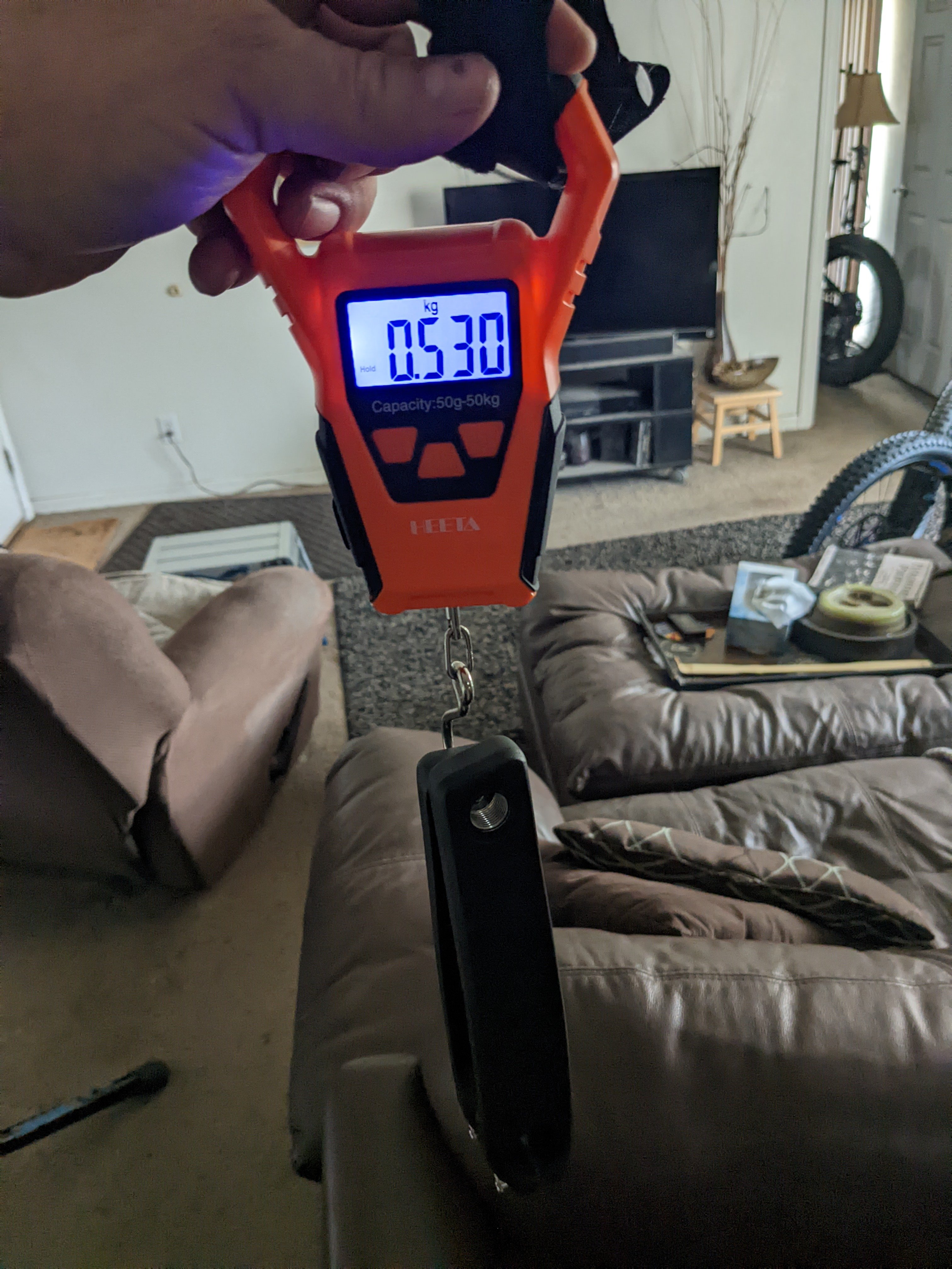

Here's my stock Bafang M600 I70 mm (without heavy steel crank bolts 15-20 g) in comparison. 530-465 = 65 g
I'll likely shave off 100g going aftermarket alloy and shorter. Not a lot much higher but much stiffer crank arms and bonus; some bling looks.!

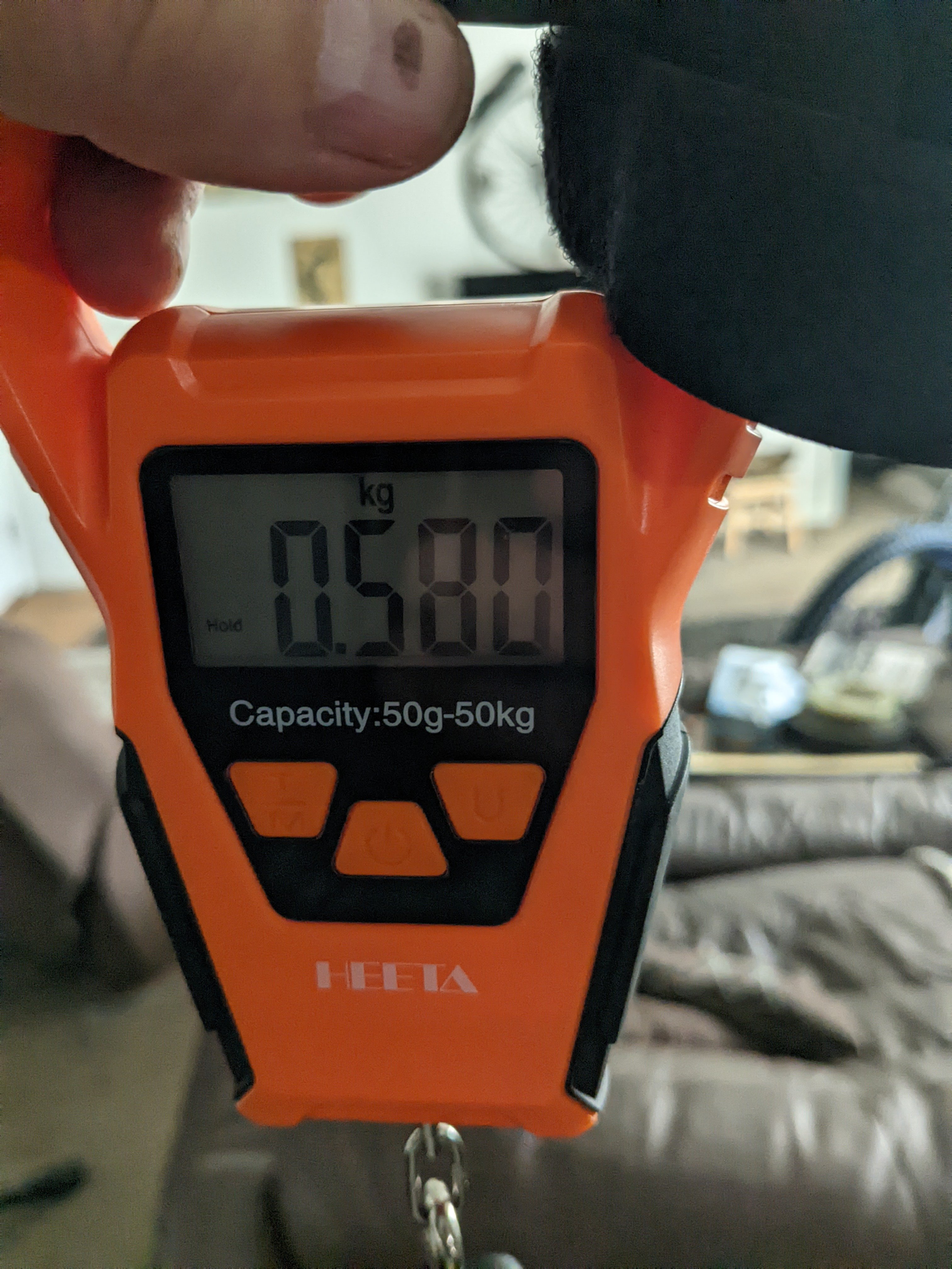

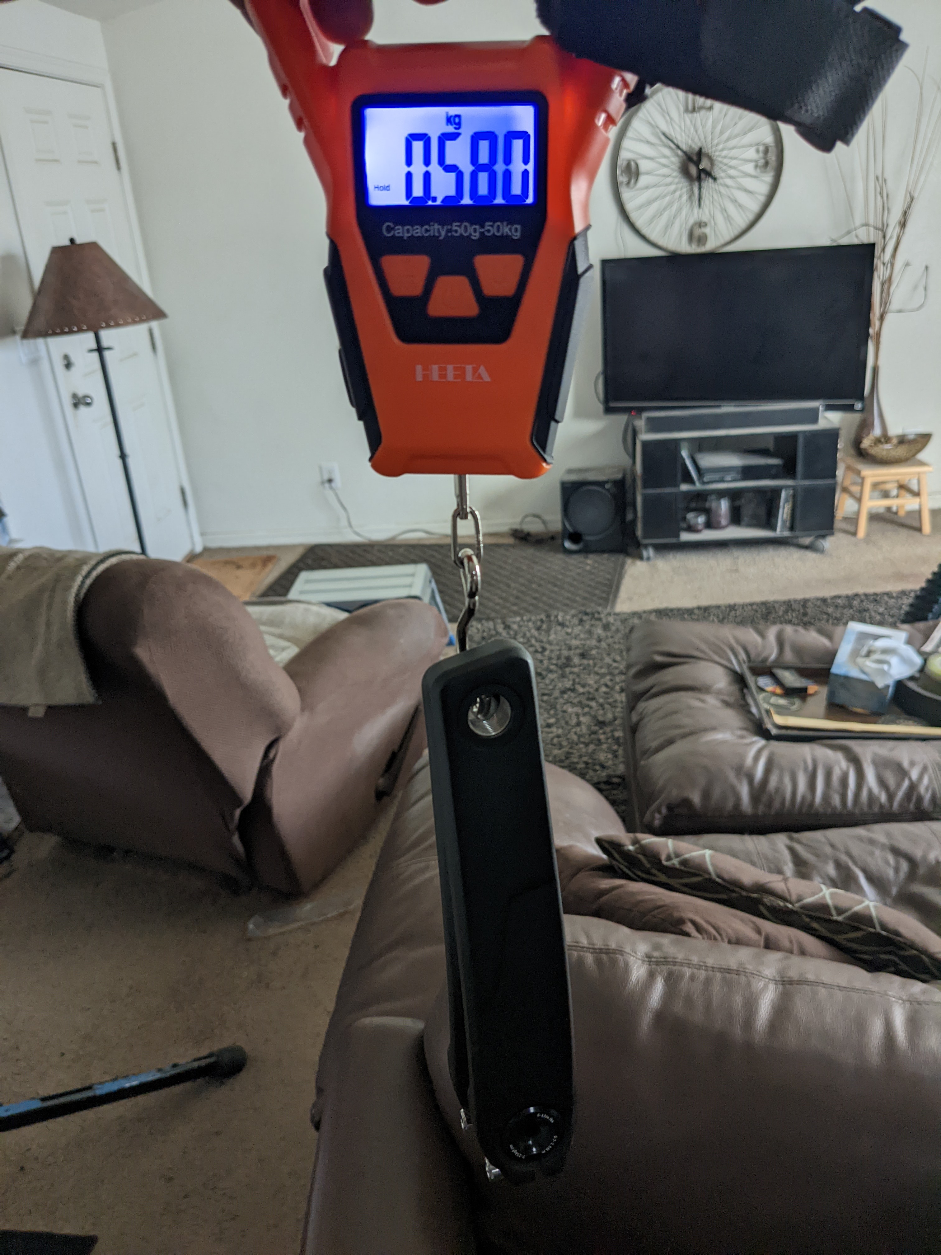

I found alloy crank bolts and included them in. 580 g. So 580-465 = 115 g saved! A little better. (Damn alloy cranks bolts were heavier than I thought.😜)
So new Bafang 170 arms.
