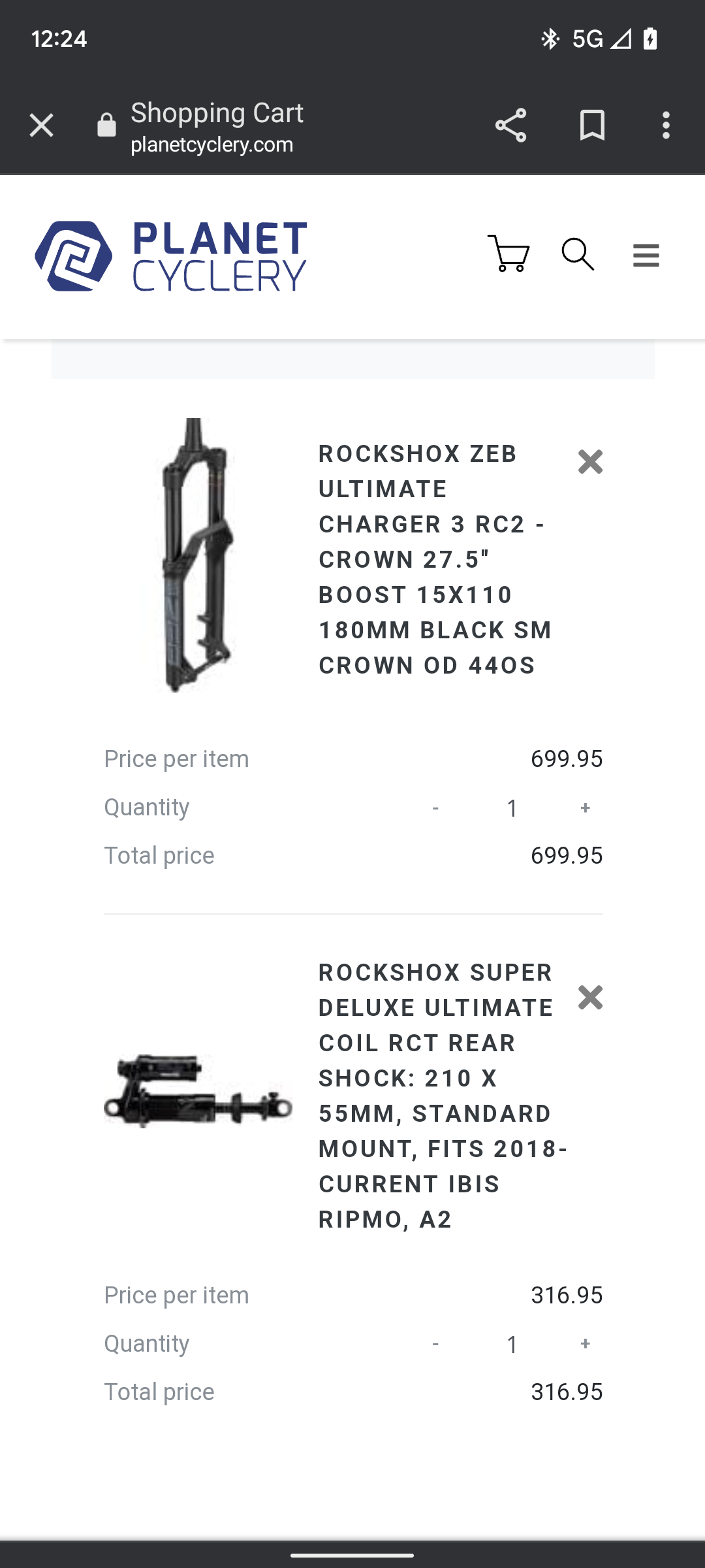

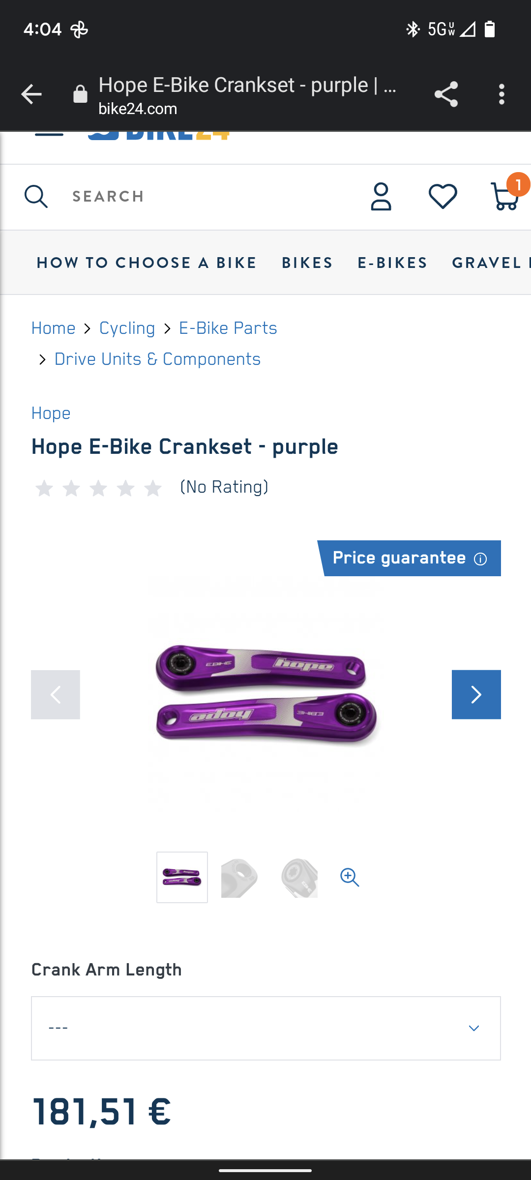

I notice that you go over the recommended sizes, which are 170mm for fork, and 210x50mm for rear shock. Bigger front fork is okay but different size rear shock may potentially damage the frame?
Also, why you need to order a new crank arm set? If it really makes the difference, the price seems quite dear for 2 pieces of metal? Can we just order from AliExpress or Alibaba?
TCFlowClyde
Feb 26, 2022
1,396
916
Mesa, AZ
Pragmatically, I put on higher-end componentry for higher performance and for overall (small) weight reduction 600-1200 g. Plus, most of us luv to bling out and customize our builds... it's fun and high-performance driven.🤙
I don't race, but I do small jumps and drops, so lightweight quality has performance and durability, and thus, utility. But it can be costly! I look for discounts and wait for sales (sometimes months) in order to save money on a tight budget.💸💰
On suspension travel, I'll gain some weight back with the bigger travel upgrades, but it's a softer, more plush ride for harsh trail/Enduro riding in my rocky desert terrain.
Some things I do order from AliExpress like my Shimano XT brakes system and SRAM chains, brake pads, brake rotors and
GX cassette... they're often cheaper here or Amazon, or EBay. But most items on Aliexpress are often heavier and lower quality and sometimes not all that cheaper...😜🍻

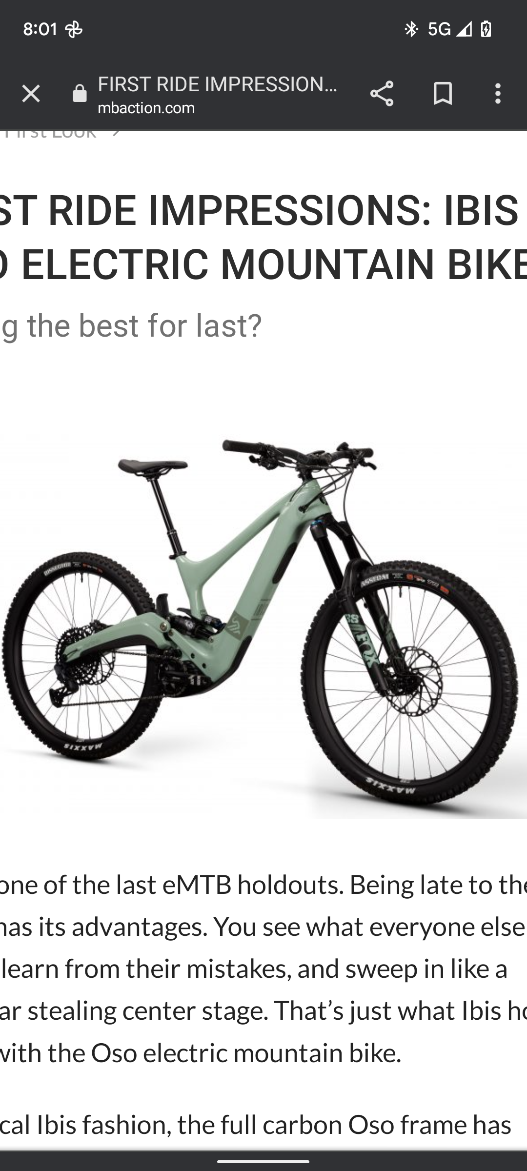

In contrast, the new, beefier, full-powered Ibis Oso, has a similar mid-high level pivot, four-bar monoswing that that reviewers say it's perfect traction and very laterally compliant as well. The swingarm is integrated with the lower motor point and front triangle seemlessly (IMHO) and looks awesome.🤙
If I had the money 💸💸💸 to burn on my next full-powered purchase, I would spend it here to the Oso--just not the green hue.😜

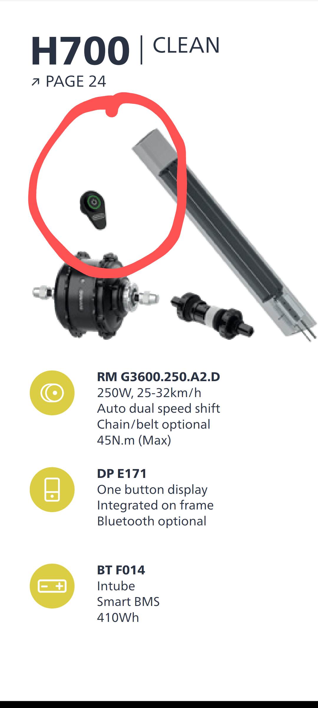

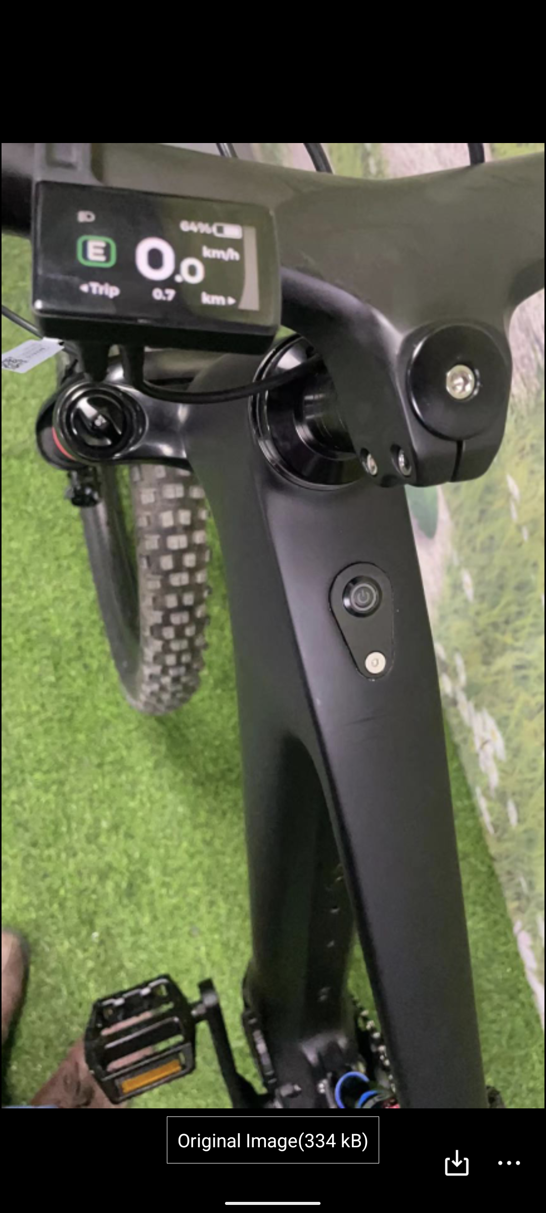

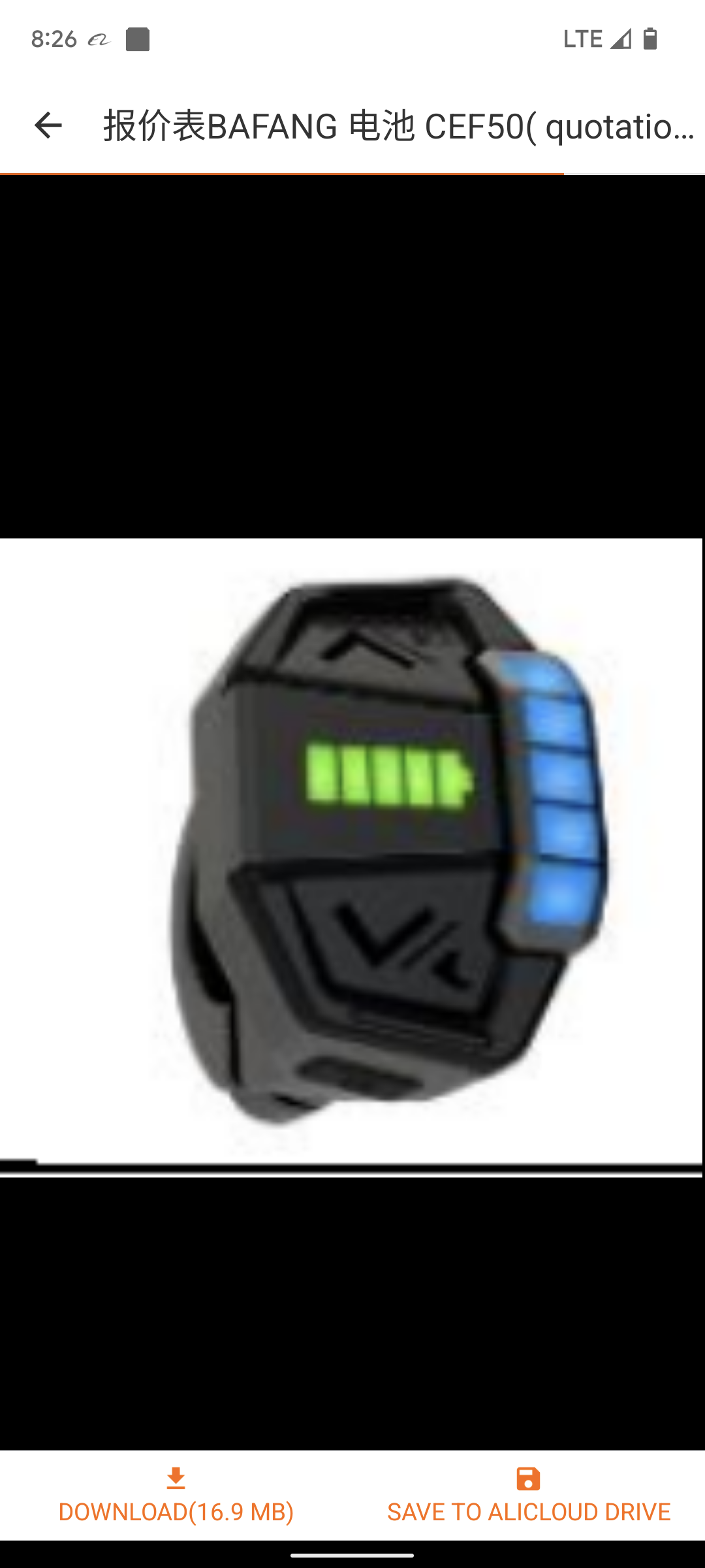

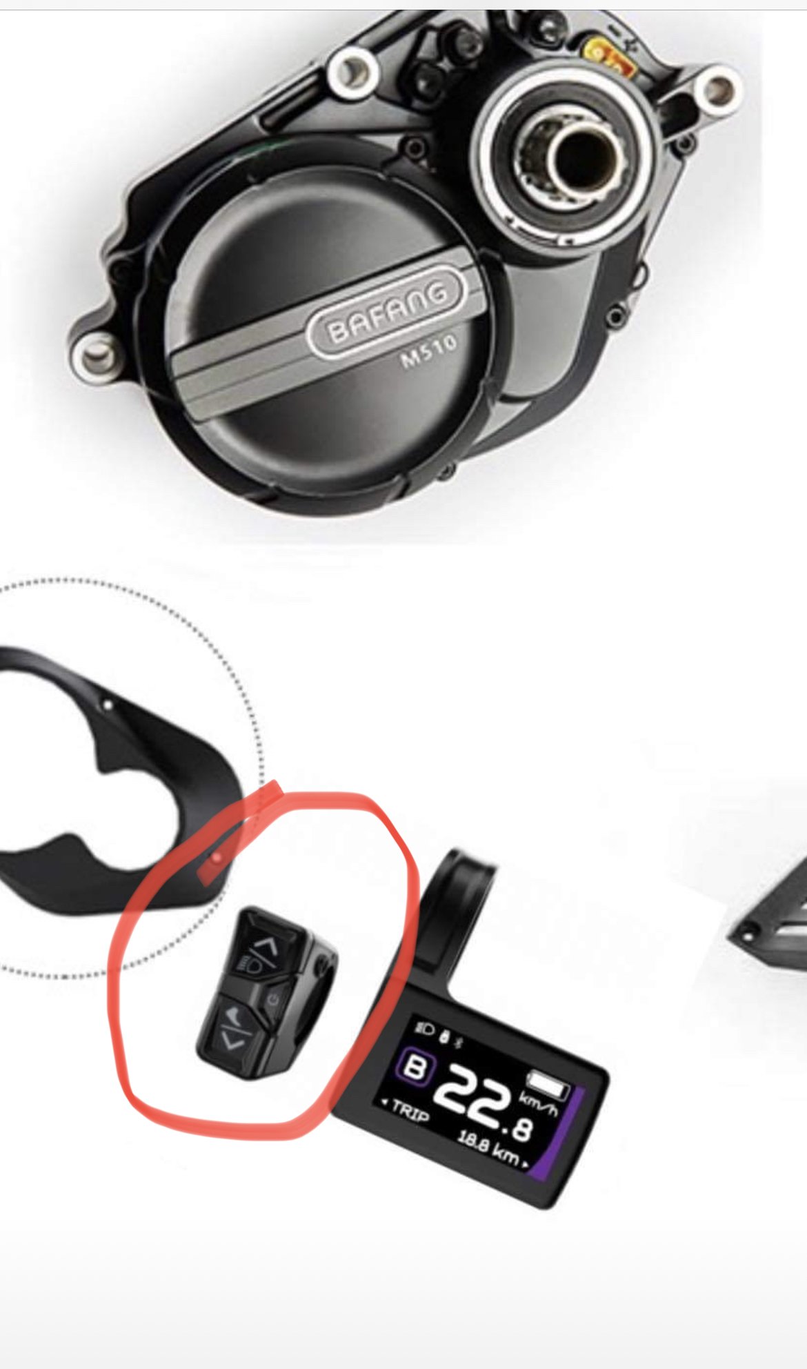

Does anyone, (particularly a Bafang vendor) have any insight from Bafang on the DP-E171.CAN's intended application? Especially without a handlebars remote selector...
The CEF50 salesperson paired this frame integrated Bluetooth HMI design with the standard M820 kit DP-EI81.CAN handlebar remote selector/display . She also said that since they're Bluetooth they could be paired together.
I think she's confused, yet one pic she sent clearly has the integrated frame display. If true, seems redundant and unnecessary (two separate systems) therefore, adding unwanted weight and frame cutout. I definitely don't want an empty hole in top tube for obvious reasons!😁 Unfortunately, it happens with some of the DIY manufacturers!😜
I asked for more clarification, but it's close to early Chinese New Year's celebration (can last 2-3 weeks in my understanding), so I may not hear back from her soon.
Screenshot_20230108-103502.png Screenshot_20221219-082650.png Screenshot_20221216-085220.png
TCFlowClyde
Feb 26, 2022
1,396
916
Mesa, AZ
Does anyone, (especially a Bafang vendor) have any insight from Bafang on the DP-E171.CAN's intended application? Especially without a handlebars remote selector...
View attachment 104245 View attachment 104246 View attachment 104247

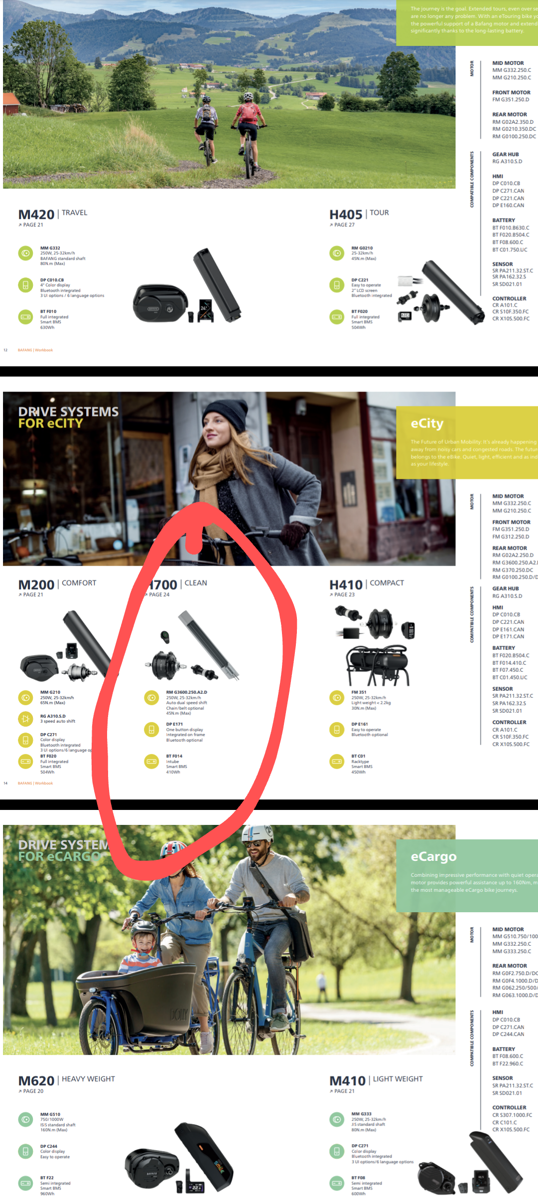

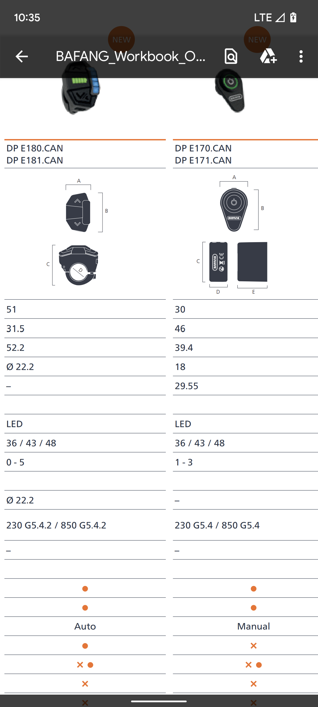

Ah ha! I got it after sleuthing the Bafang Workbook '23 file. The DP-E171.CAN is part of the M700 410Wh hub drive system. So, looks like she was confused. Hopefully, I can catch her in time to avoid the frame cutout process of production!🤯
To be honest, I can see why it's easy to be disoriented with the plethora of offerings/sh$t that Bafang-e puts out...it can a messy maze! Especially using my little smart phone screen!🍻

It’s really funny to see all feasible display and button options combined on that frame. Normally the DP-C245 CAN display (wrongly mounted on the left side of the handlebar) would be combined with the remote on the picture below…..
