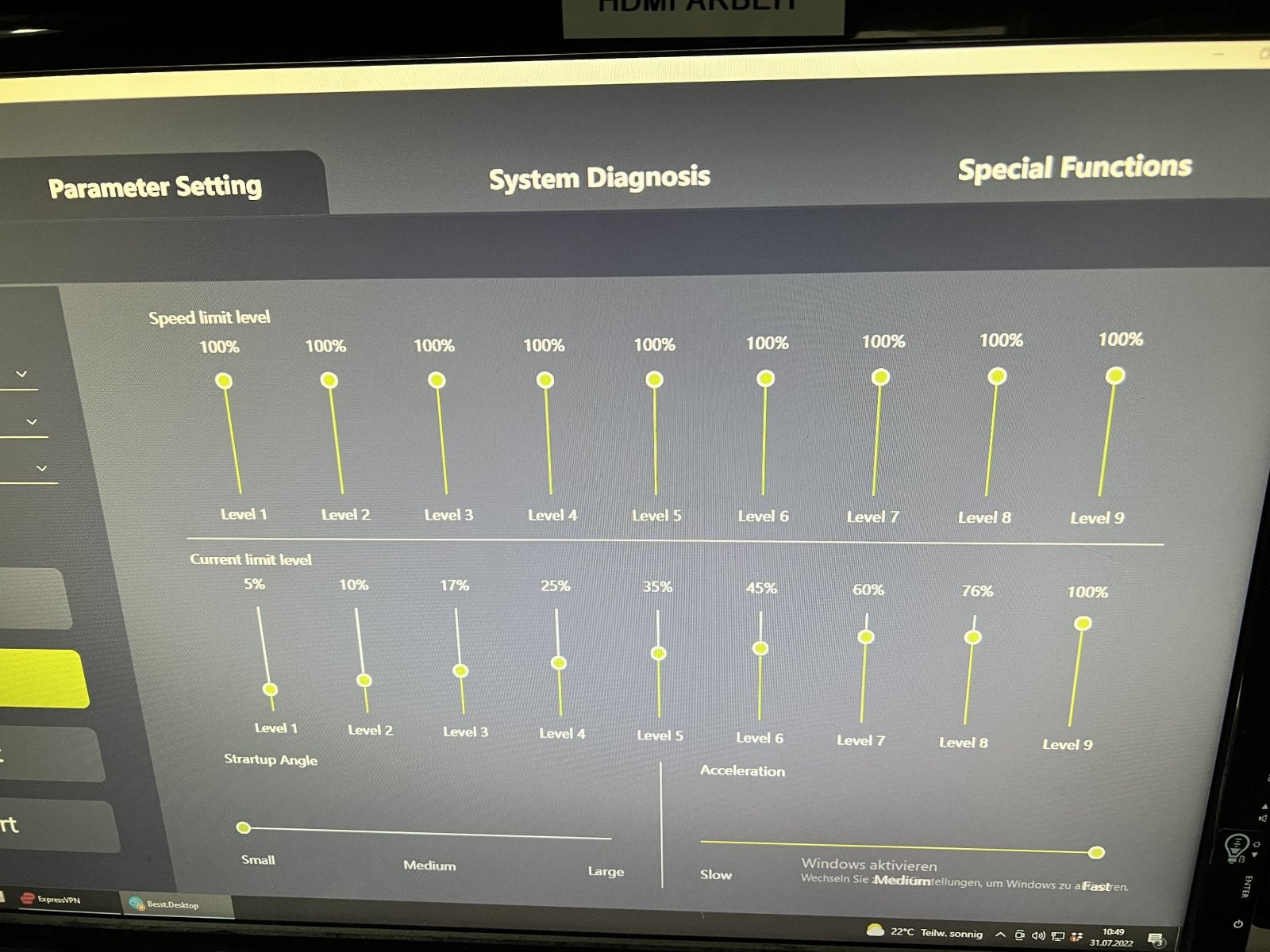

I have tested both
Revision i
Version 3.1 with 48v battery and besst pro. Working fine
Version 3.2 with 52v battery and besst pro. Working fine
but I switched back to 48v because I see no advantage for a 52v battery on a light all mountain bike;)

So if you change the 'current' parameter via besst pro for each pas level does it sort of overwrite the initial setting of a particular firmware? I like the idea of having more tunability instead of just using a particular fw and hoping it will suit well for my needs...

Yes, thats the reason of Besst Pro. Just u set power levels like on other motors.
But, ask yourself. Do u need to fidle with it? You just set it up once and thats it.
Only what is needed to lower Pass 1.

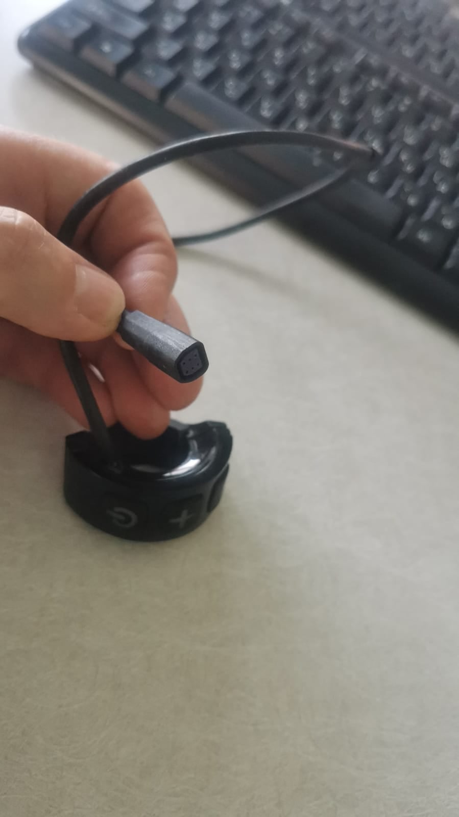

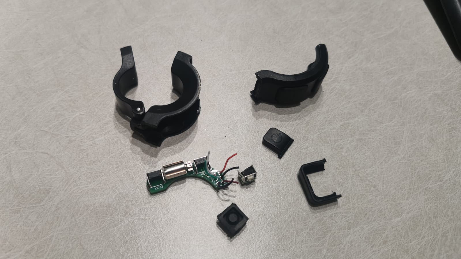

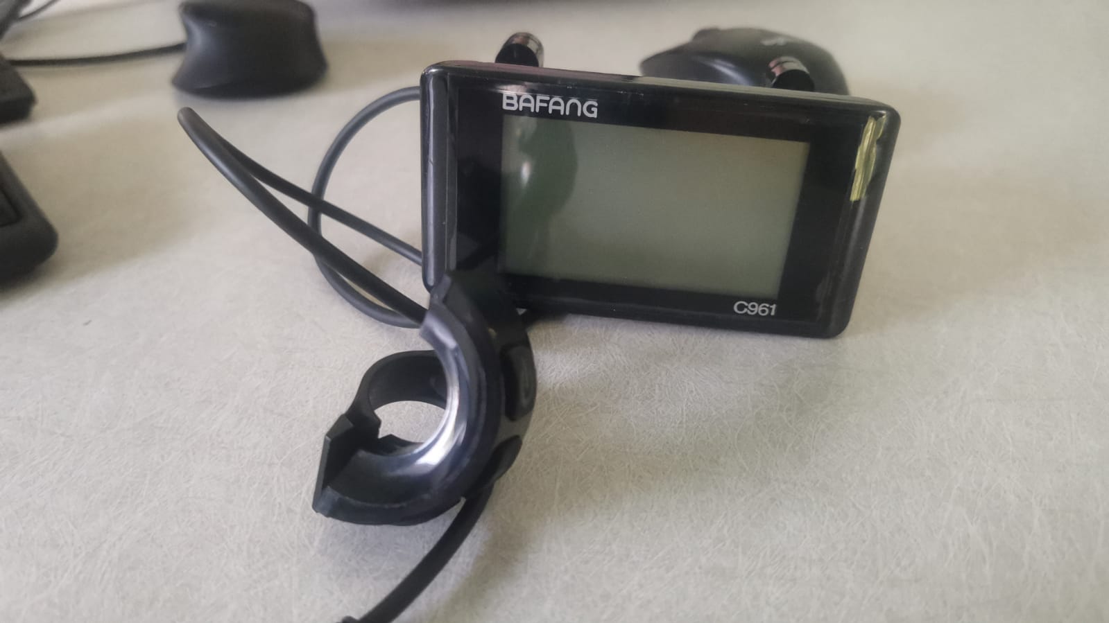

This is an old remote control. I disassembled it and cut off the power button. He's still very fat and big, I don't like it.
Hi lanton. i want to use BBS remotes that i have stored. Could you say me the function of the cables on this explosed remote. when you acting buttons, mode + and Mode - you have continuity between wich cable color ? can you identified on the printed circuit wich cable color is the common of each buttons ? thank you for your help

Patdam, buttons are shorting only to ground, so just measure original buttons, which pin is ground and which pin is shorted when u press button. Or find a scheme of buttons on internet.

Hi Guys, I’m new in this forum and I want to share newest informations with you. Have you already tried the new bafang besst pro? It’s working for me with the 3.2 firmware and I can set all the currents for every pas level. Additionally you can set the acceleration and pas delay.
The right advice. There is a common wire, you need to check each wire to the button and solder it.

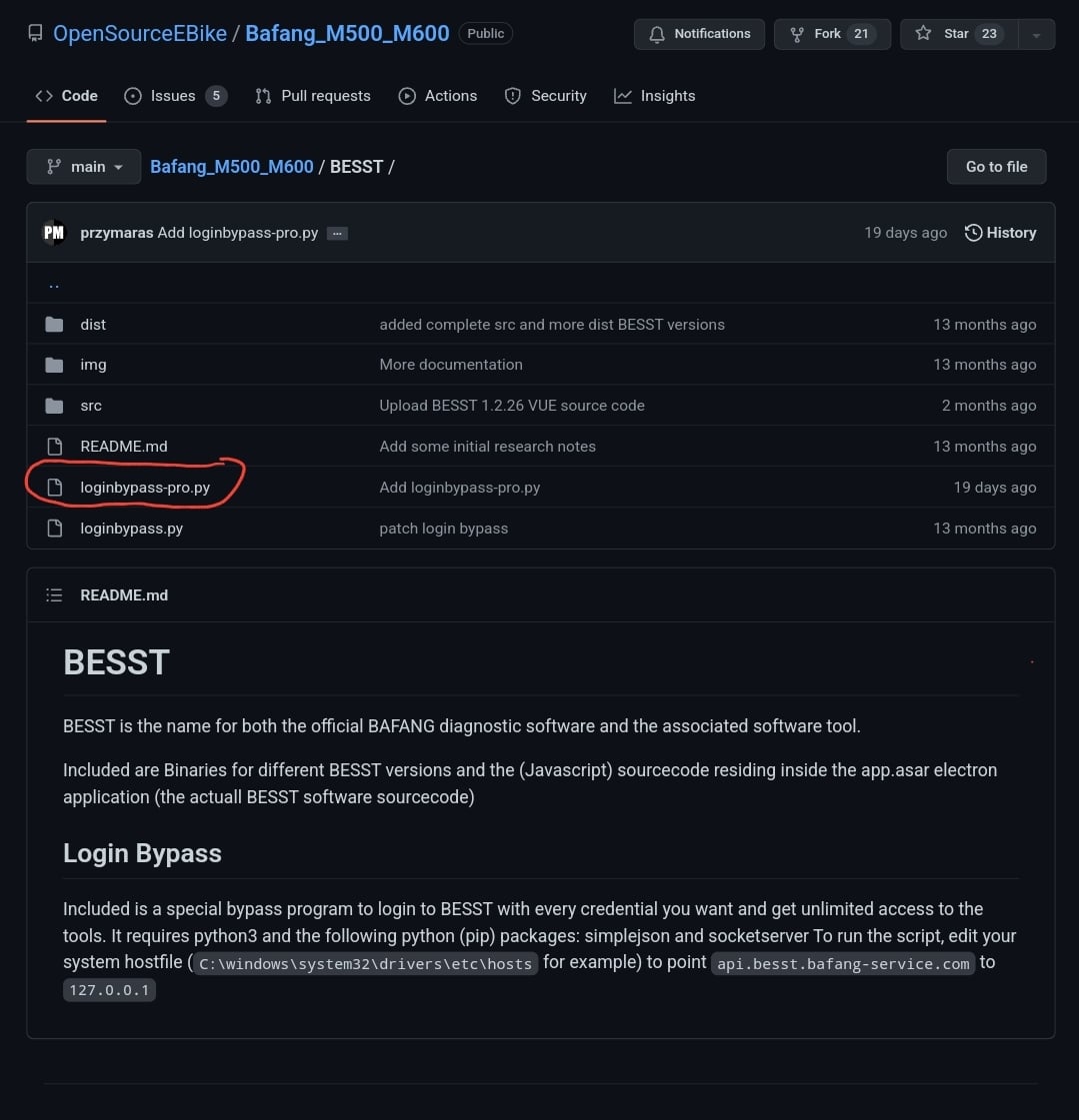

There is a new python script. Download it and BESST Pro will be fully functional.
However, the new feature in the Pro version is that the Firmware can be updated without a username and password.
So no other new features beside that? Then it is better keeping the old Besst Software that works with the loginbypass, cause this for me works well.
