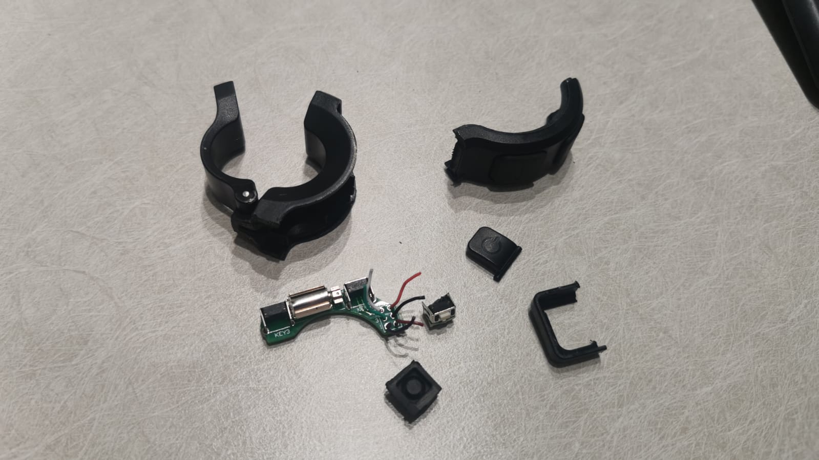

This is an old remote control. I disassembled it and cut off the power button. He's still very fat and big, I don't like it.

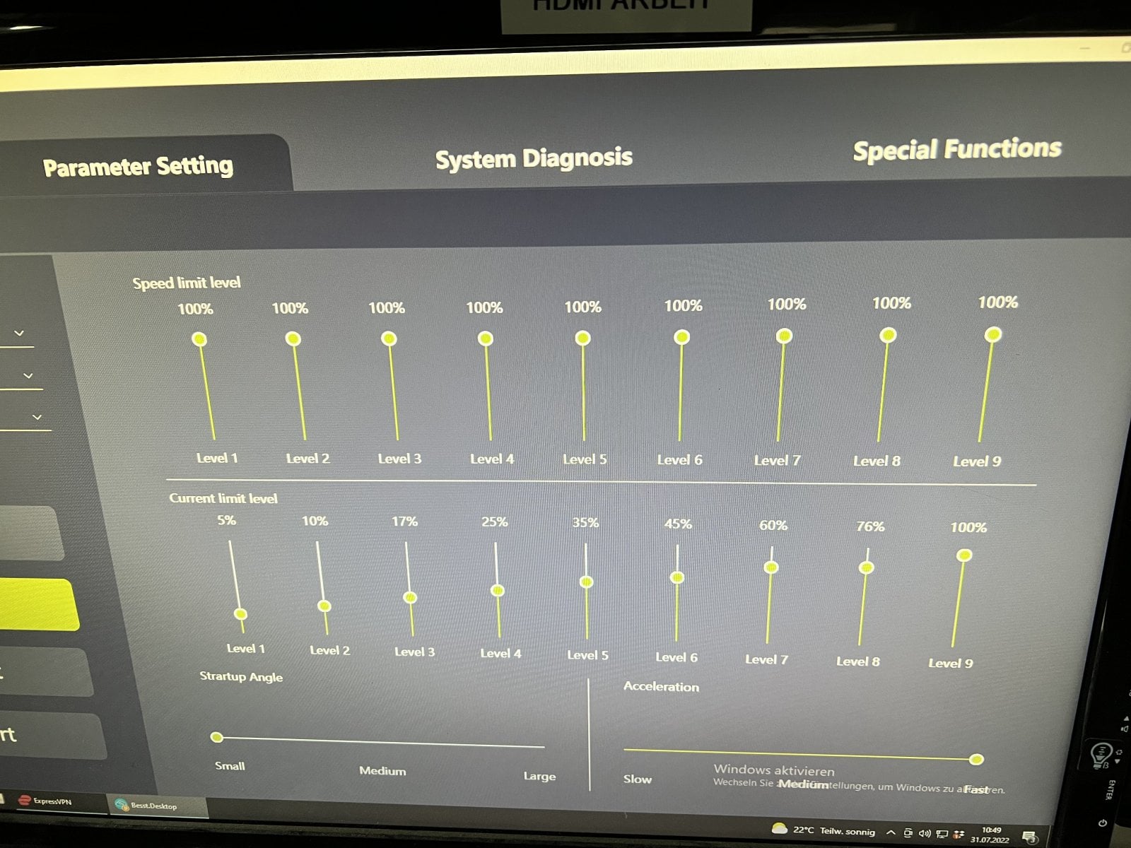

Hi Guys, I’m new in this forum and I want to share newest informations with you. Have you already tried the new bafang besst pro? It’s working for me with the 3.2 firmware and I can set all the currents for every pas level. Additionally you can set the acceleration and pas delay.
It looks great! Do you have a link to download the program and does it need a username and password to log in?
