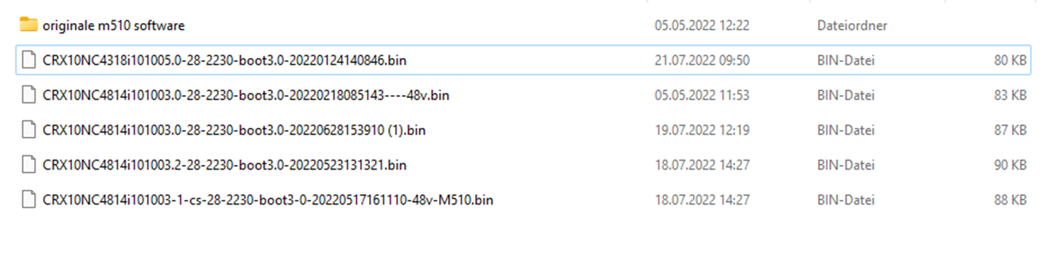

greeting. I use a 14s4p 21700 cells 52v battery. engine m510, I have rev1 and rev2! firmware rev1 48v last shared by @Rob Rides EMTB works fine for me. firmware rev2 "52v" shared by @Rob Rides EMTB doesn't work well for me. @Puschtrale satisfied?
Sorry, still dont get it. To reassume:
My m510 with 48 v battery at delivery had installed this CRX10NC4814i101003 1-28-2230-boot3 0-20220127132519
Then I installed this one CRX10NC4814i101003-1-cs-28-2230-boot3-0-20220517161110-48v-M510 (
Now in my files i do have these firmwares and i just do not understand anymore what the differences are and which one should be the actually best of it 🤷‍♂️ :)
BootsDave
Feb 5, 2021
77
76
Aveyron, France
As far as I’m aware, the only difference between them is that the version with -cs- in the file name doesn’t start to reduce power until the battery percentage is much lower. This was the one supplied to Thaeber by Chili Shen.
see on github there is sorted firmware rev1 and rev2. and for the rest, you'll have to search the forum a bit and evaluate what you need, of course, and try it out. each of us is suited to something different, so I can't say which fw suits you. I ride in pass 1 and 2, pass 3 on a bigger hill, while some guys ride pass 4-5.
The 48v-M510 is the firmware I‘m running. I followed all the discussions here, and if Your engine is running this firmware it‘s probably the best option currently available. The 43V 18A (1st in Your list) may supply more power and even better battery attenuation, but I didn’t want to give it a try yet because I’m traveling to Finale Ligure tonight 😊

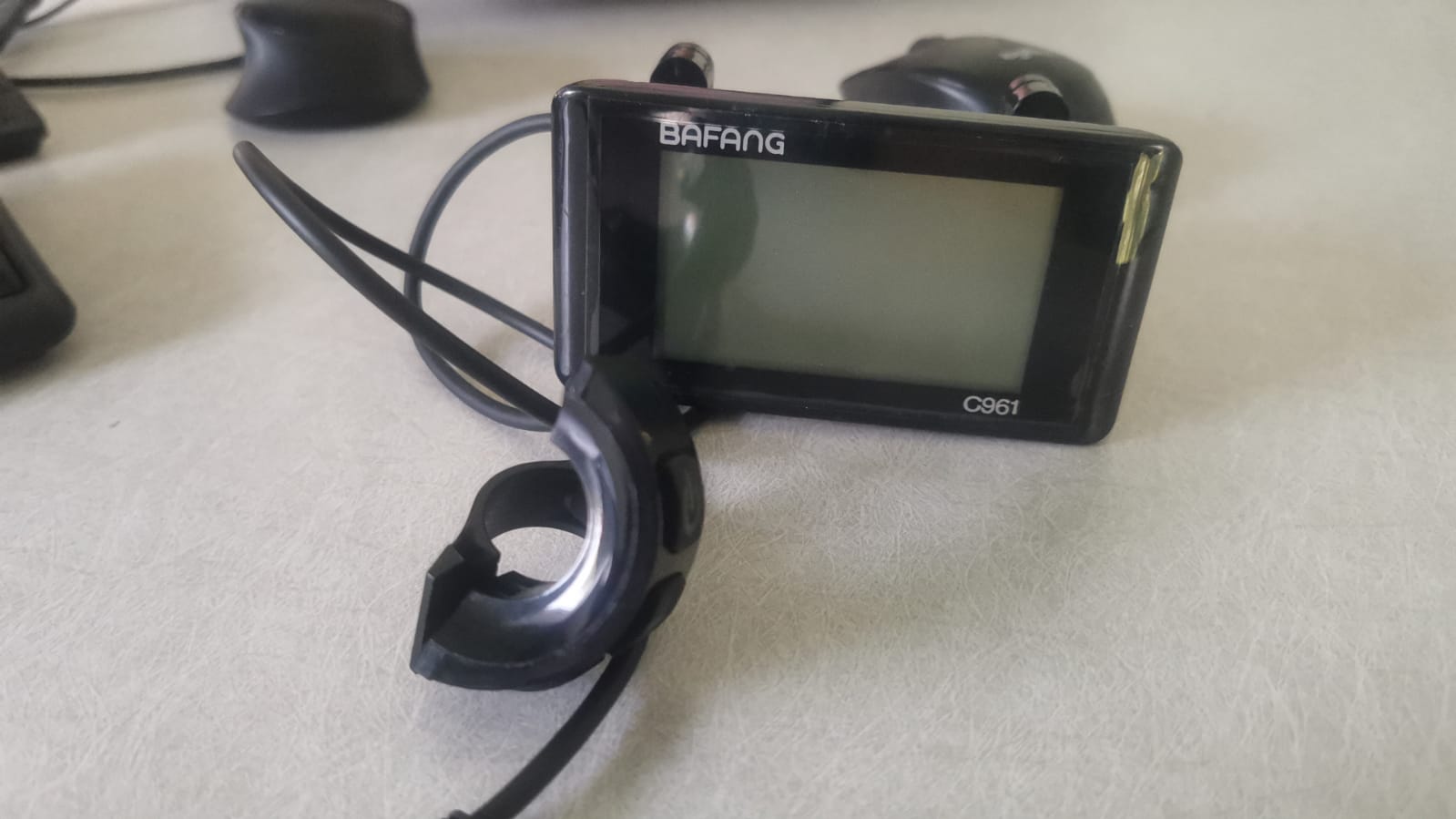

I took a ride on the M510 and I am very happy, it seemed to me that it is more powerful than my very old M600 (500W, more than 4 years ago). There is no time to deal with the firmware yet, we need to travel more time to feel the difference.
LAnton
May 12, 2022
560
468
Russia

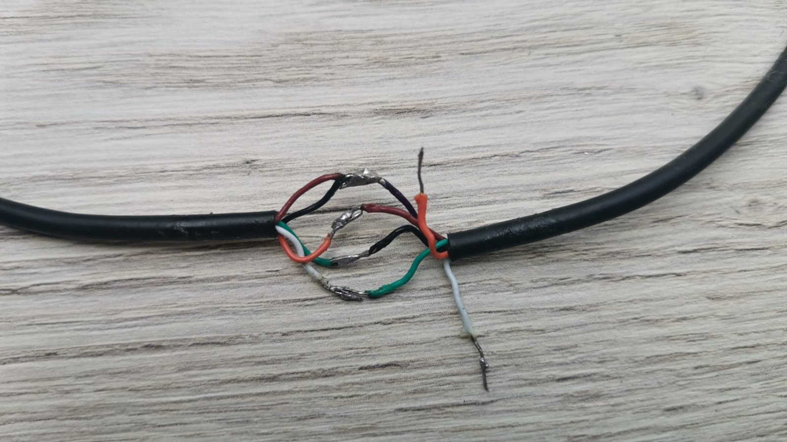

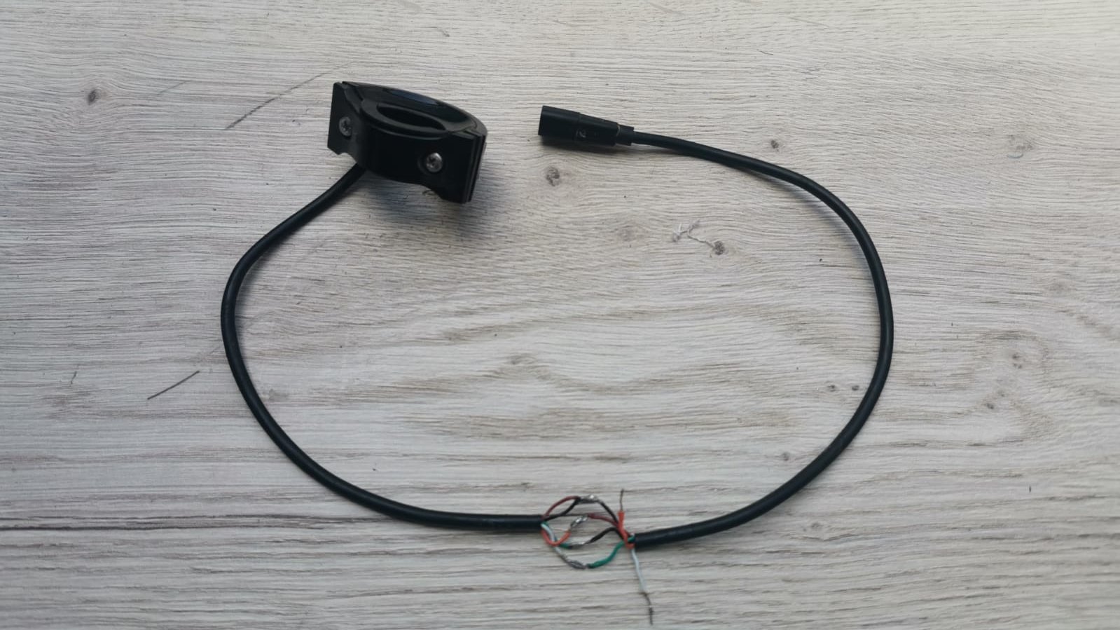

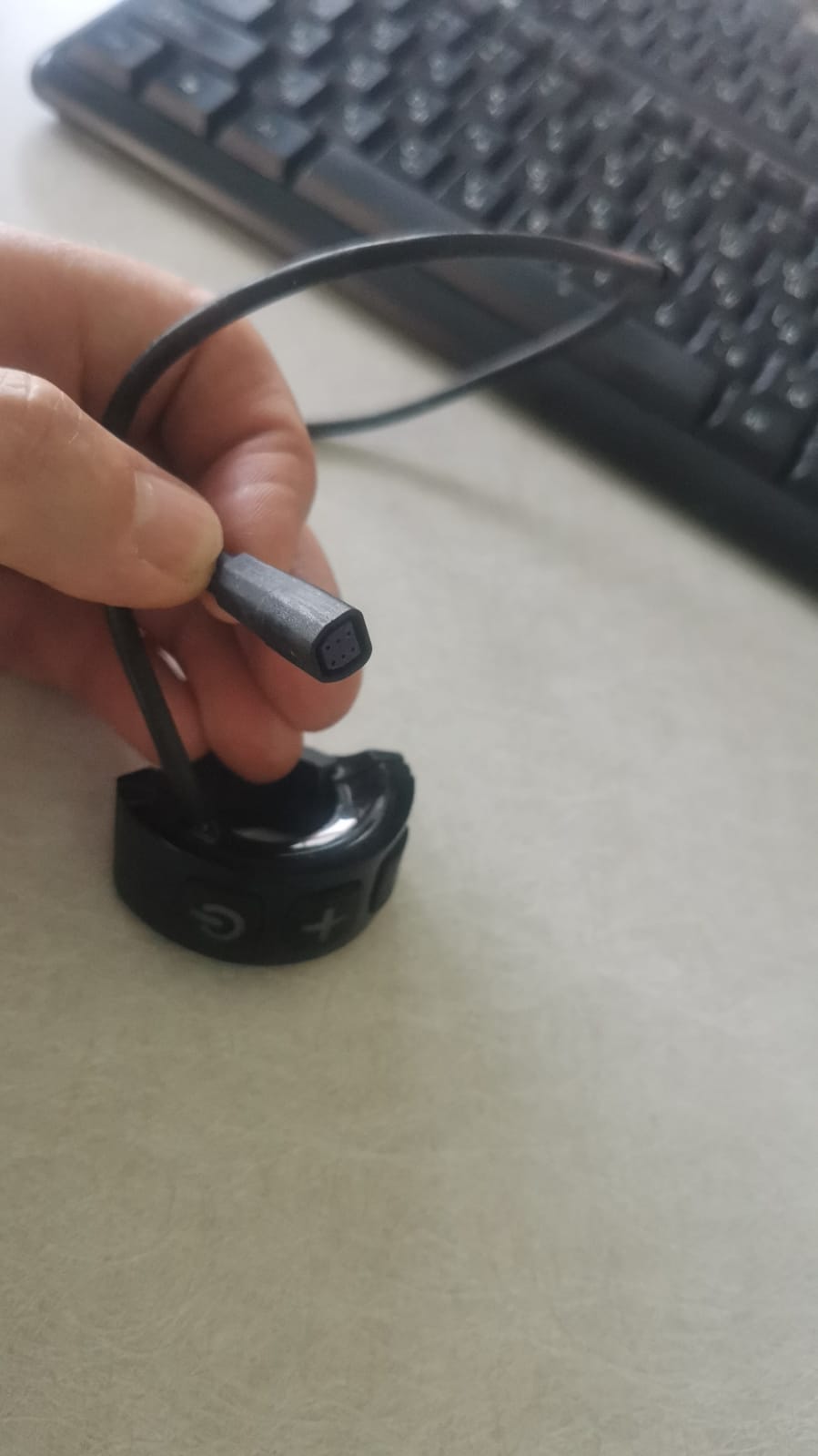

i know, i mean the cable between 2 have the same color wires?
Wires of different colors. The electronic tester helped me. It's not difficult. A little later I will take a photo of the color of all the wires. I think you can connect any buttons to the engine. It is necessary that there are only 3 buttons on the remote. I also liked Levo. Someone had a Levo button on the forum.
wait for your photo, i also have c961 button.

Yes, everything works and boost works. There are three buttons on the new and old remote control. There are two more wires on the old one, it's probably vibration. I have already made a remote control, I will not be able to say for sure about the wires. Use any remote control where there are 3 or more buttons.
