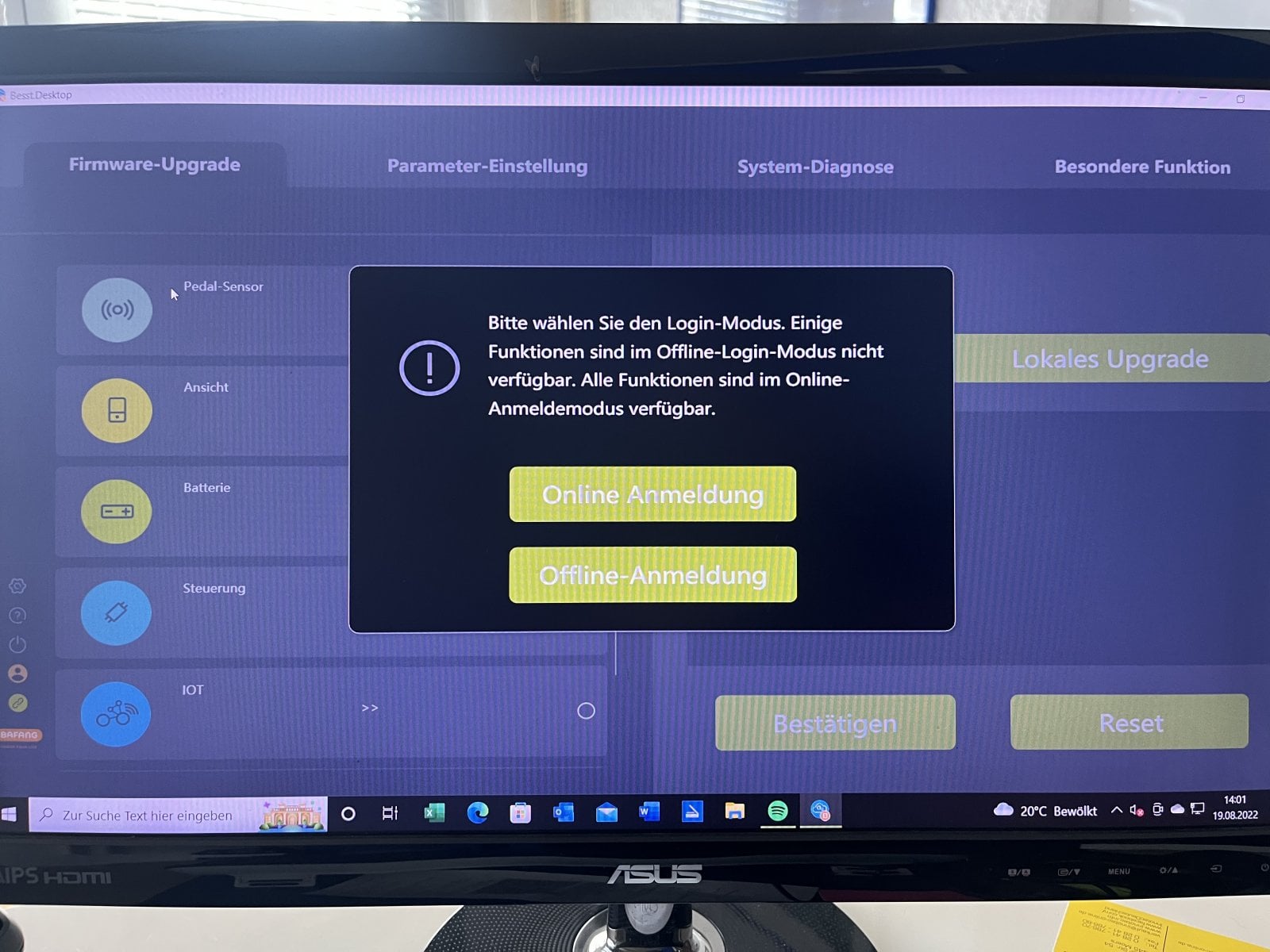

So no other new features beside that? Then it is better keeping the old Besst Software that works with the loginbypass, cause this for me works well.
With the Pro version, you don't need a username and password, not even a loginbypass to update the firmware.
But with username and password or loginbypass you can do the following:
- Set the speed of each level as you like.
- Set the maximum current allowed to be drawn for each level. This means adjusting the power of each level in watts.
- Set startup angel.
- Set acceleration.

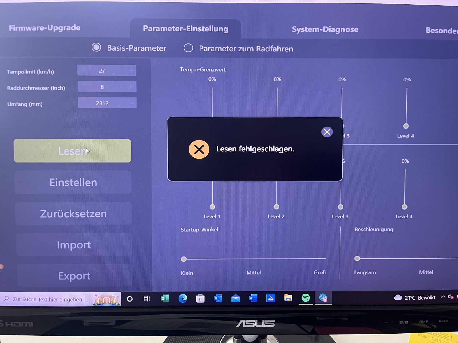

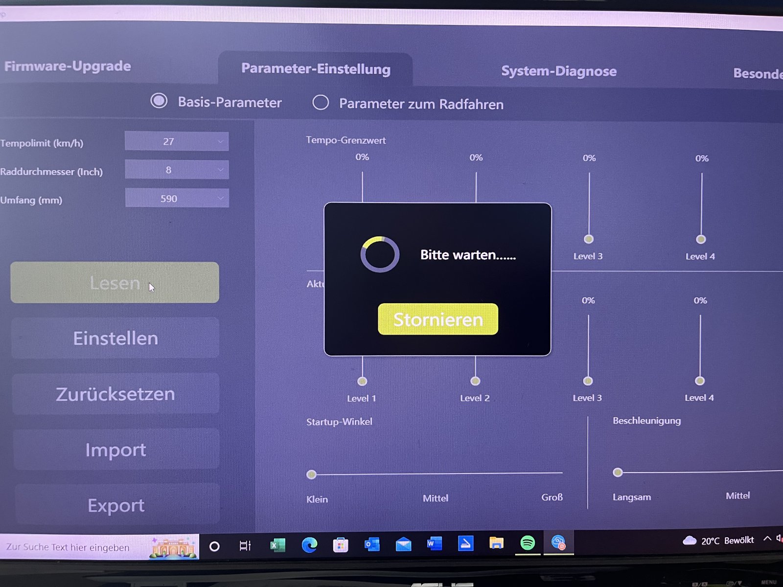

Today I tried to set the basic parameters on my replacement M600 motor with BESST-pro, unfortunately without success. The parameters could not be read. Perhaps this function is only possible with the M510?
In any case, the firmware loaded without any problems.

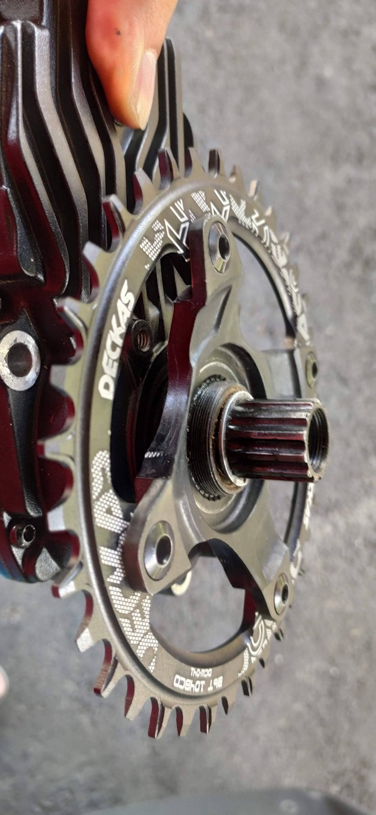

Hi Guys und Girls,
i am looking for a spare part for my M510. Somehow the Nut wich locks the Spider to the Motor got lost. Now i need a new one.
I have absolutely no idea where i can get one fast. Will be happy if one of you can help me out.
Thank you !

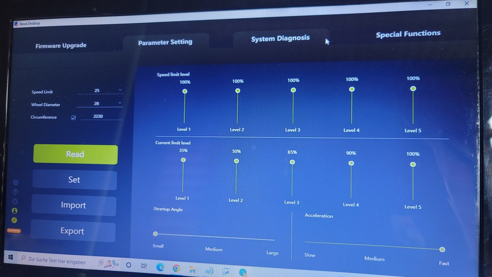

507

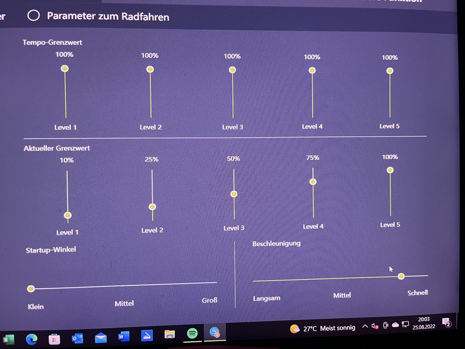

Besst pro worked on the M510, changed the 5 support levels to 10/25/50/75 and 100% and am very satisfied. In level 1 max 80 W power, good for saving battery or training your own fitness. In the 2nd level max 240 watts, in level 3 max 450 watts, ideal to annoy the Shimano EP 8 riders in trail mode 😉, and 670 or 840 watts in levels 4 and 5
