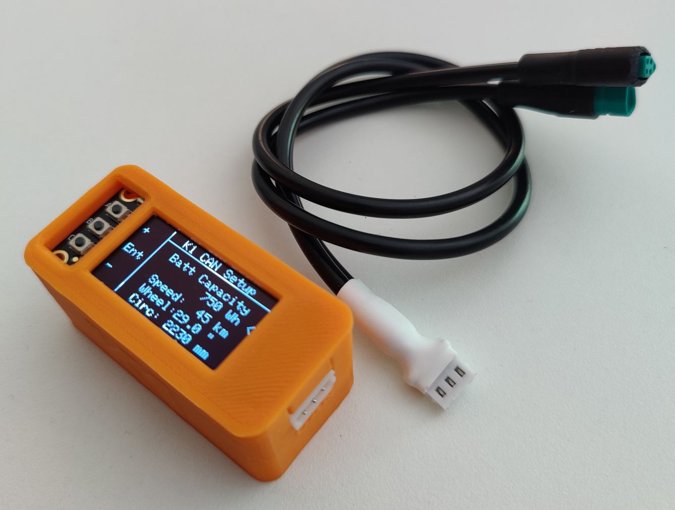

Hello ebikers.
K1 eBikes has designed small, portable and simple K1 CAN Monitor & Speed Unlocker - no need computer or mess with BESST. Works ONLY with Bafang motors with CAN bus (green connector to display with "house" shape 5 pin connector).
For more info check the following link:
https://endless-sphere.com/forums/viewtopic.php?f=31...
How to unlock speed:
https://youtu.be/6z3TzEqNWsQ
If you interested, send an email to [email protected], will answer any questions and will send user manual.
K1 CAN Monitor is determined for testing purpose only and is not waterproof.

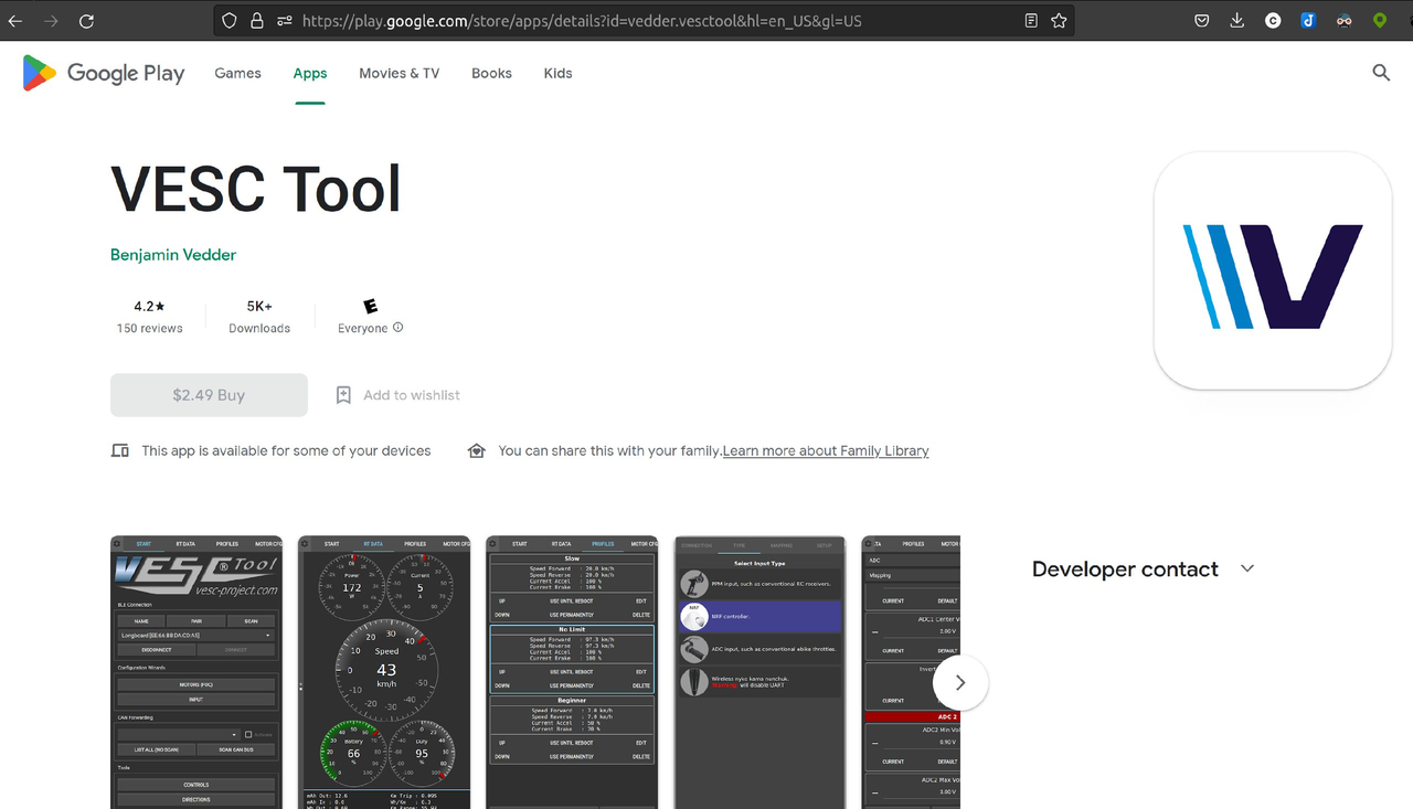

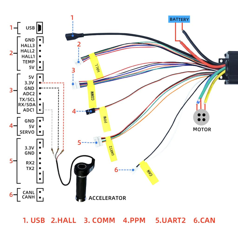

I need a M500 motor for development. Does anyone have a used one to sell?
Since the Bafang is keep launching new motor models and not updating the firmware of previous recent models, like M500 and M600, I really think the best route is to go with VESC and forget about developing firmware for their original motor controllers!! For now I will try to go DIY, using VESC outside of my M500, but later maybe someone want to design, build, test and sell custom motor controllers based on VESC and for this Bafang motors.
Example of VESC EBike motor controller: Flipsky VESC 75100 EBike controller: 100€, 75V 100A, CAN and UART communication.
Advantages:
- BEST motor controller out there, OpenSource, small and powerful
- only 1 minute to make the inital motor auto detection setup, resulting in the best motor performance and silence out there!!
- VESC EBike application can be developed in high level scripting language
- powerful mobile app (also for PC and RaspberryPI), with high level scripting language for custom application
- display available to buy on shops, OpenSource (although for ESkates but easy to adapt for EBikes)
- there are A LOT of experienced users / developers of VESC
- powerful advanced algorithm for sensorless at motor 0 speed meaning no hall sensors needed
- cheaper than a Bafang original motor controller
Disadvantages:
- DIY solution
Video:
I connected an old VESC controller to the 48V TSDZ2 motor (I do not have yet a Bafang motor for development). VESC software were able to detect the motor characteristics:
I was tweaking the sensorless HFI silent mode and it seems to work well. I tried to block with pliers the motor shaft and I could feel the torque, although I did not tested it on the real EBike. I also did not connect the hall sensors as I am only interested on the sensorless mode, as I plan to run the Bafang motor in sensorless mode.
On this short video, you can see the motor running. Note that the motor is very silent but because it was attached on the metal vice, the noise was kind of amplified:
I am thinking in using the VESC only for the motor control. Then, use a custom DIY board where every will be connected: brake sensors; throttle; torque sensor. This board will also connect to VESC using UART_0 and connect to the display using UART_1 (Easy DIY display).
This board will use the NRF52840 microcontroller (the same used on the Easy DIY display) and the firmware will be developed in Pyhton. This board will basically implement the EBike aplication: reading the various sensors and output commands to the motor controller, like setting the motor current and motor speed. It will also send data to the display and receive data for the user configurations done on the display.
This board with the EBike application, will be easy and fast to be reused on other devices like my TSDZ2 EBike motor controllers. I will also use it to my Xiaomi EScooter.
I already bought the Flipsky 75100 VESC motor controller to use on development and to install on the final, on my EBike with M500 and 52V battery. Currently, I have a Flipsky VESC 4.2 but it do not support voltages like 48 or 52V, only lower. I also have the NRF52840 board and I am starting the development of the EBike app in Pyhton.
Mida
Oct 23, 2022
7
ČR
I have this one:
So far, so good, 1.1kW in peak. You only need to swap two wires on connector or make an adapter with plugs.
You may also add one shunt resitor then force M600 18A firmware upload - it also should work.
