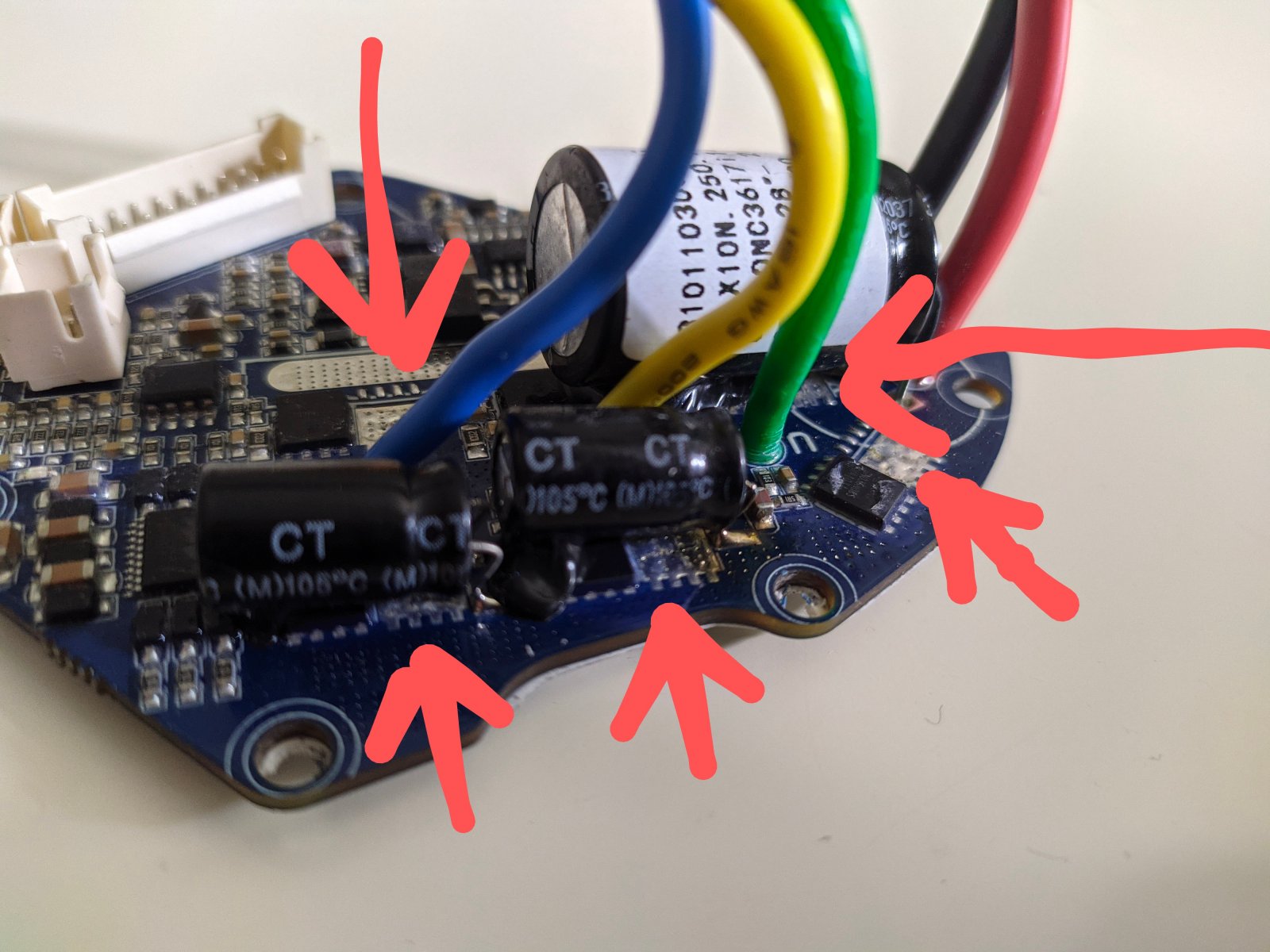

I put m600 controller to m500. 1.1kW peak, still legit, still working in my daily riding.

I have this one:
So far, so good, 1.1kW in peak. You only need to swap two wires on connector or make an adapter with plugs.
You may also add one shunt resitor then force M600 18A firmware upload - it also should work.
[/ЦИТИРОВАТЬ]Thanks, with a shunt resistor is also an interesting idea but I doubt that adding a resistor will allow access to download the m600 firmware, I tried this but the download does not occur.

Shunt resistor will cause the power output will not be halved when you upload M600 firmware, and only you need to do to upload M600 firmware is to change in hex editor the first byte of it, to same as it in M500.
Ok, didn't know about that, thanks again. It will be necessary to take an interest in this topic, it will be a good experience if it works.

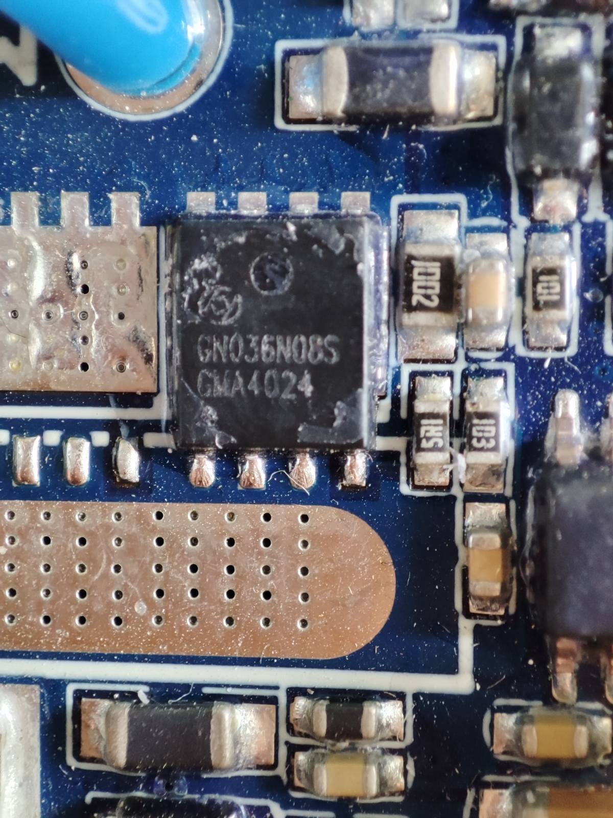

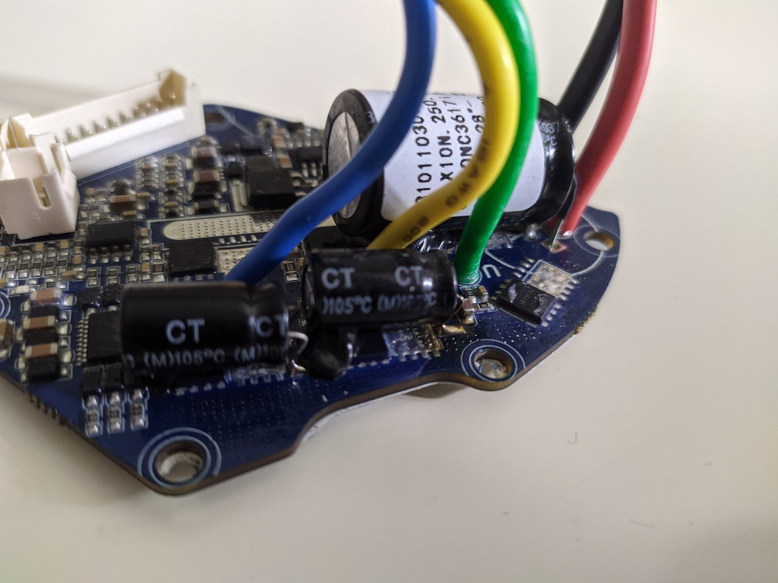

I took off my m500 controller and upon a detailed examination I found that it not only has one resistor less than the m600, but also that there are about 5-6 chips less, who knows what they are responsible for? I also can't find the same ones for sale.

Yes. M500 will handle up to around 1kW of peak power, where M600 can be pushed to around 2kW because have more mosfets.
theorerically, one shunt resistor more added to m500 board will be enough, to run stock m600 firmwares.
Kyoku, every motor can handle 2 times to 4 times more power, question is for how long. I been testing M510 and it wont handle 800W continous. And M600 is getting too hot with 1250W conti. Then you need to be smart and use peak power just in right time and then lower power for certain amount of time to let the motor again to cool down (what I saw temperature was raising 1C in 1sec with 1250W). So I do not recommend to put anything more then 800W (M510) and 1200W (M600), if you want just ride freely without any overheating issues.
You would need to have also temperature display if you wanna abuse the motor with 2kW - as I got already 140C with one M600 firmware and was afraid about demagnetization. Dont know where was temperature control... ou my dear Bafang ;))
