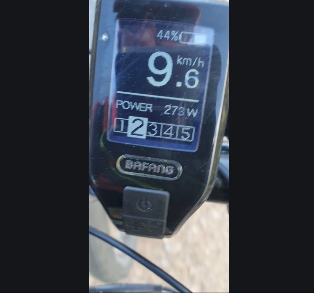

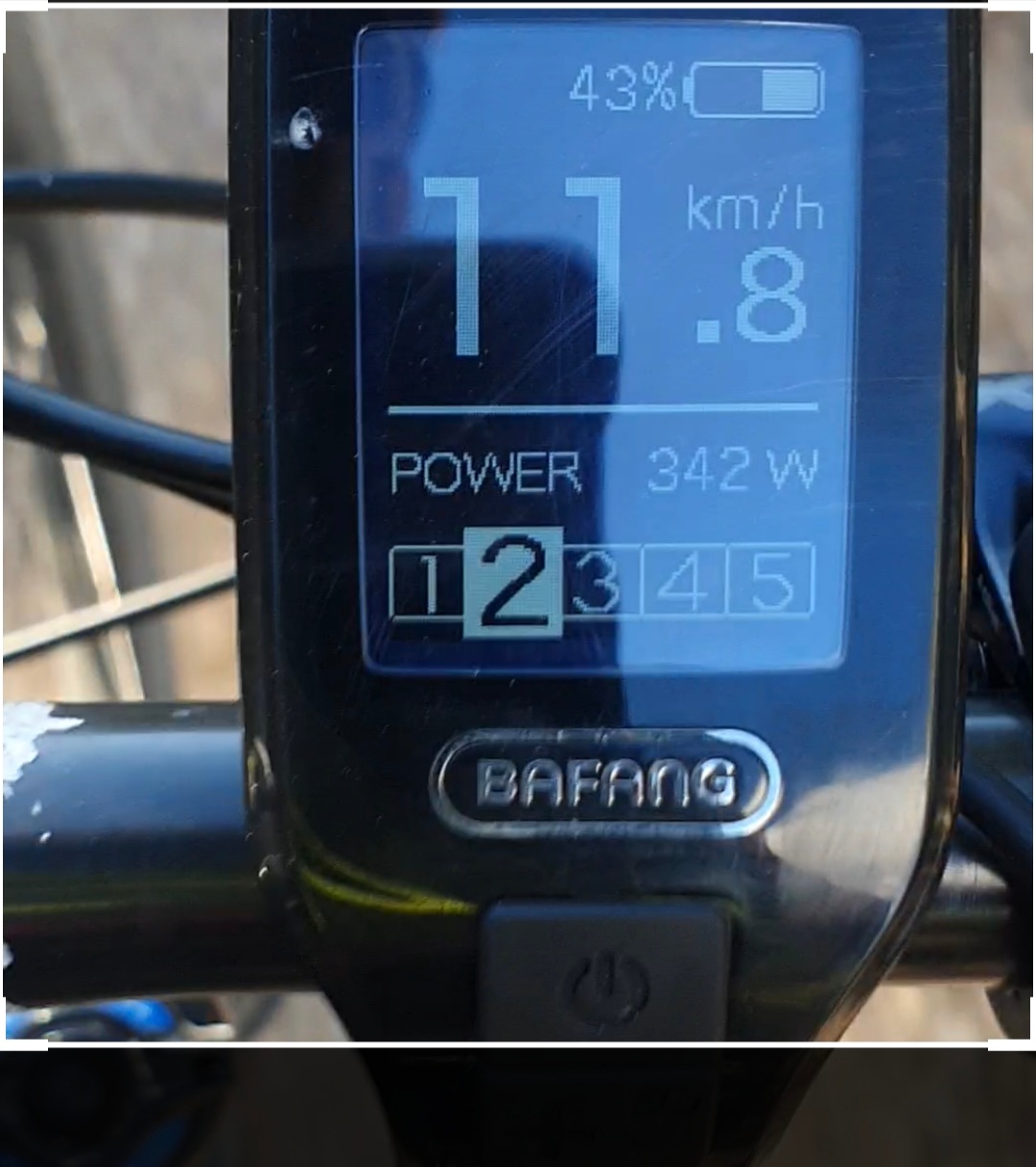

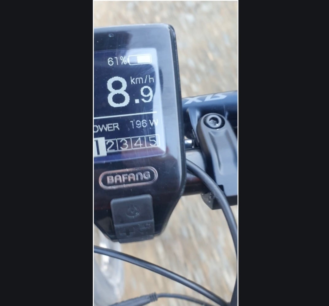

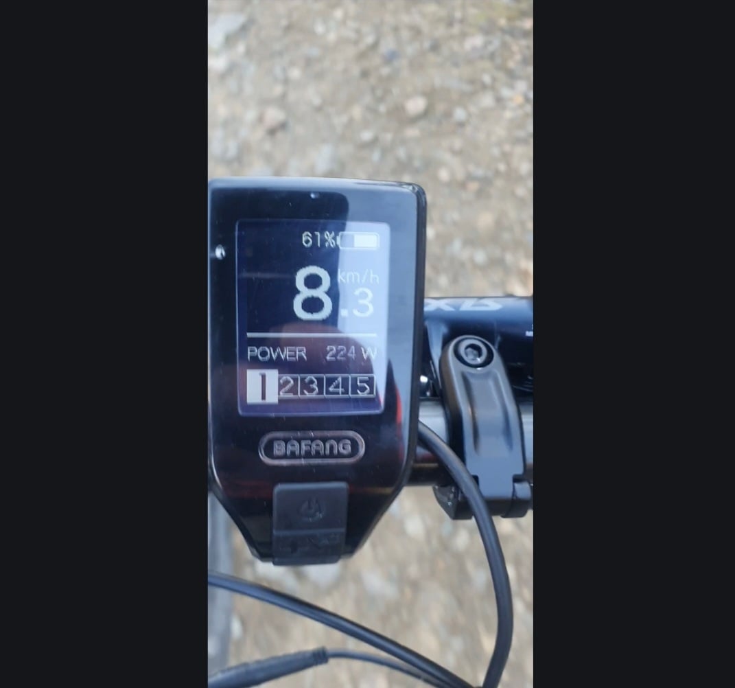

I'm that user.
To be clear guys I do not have problems understanding the cadence issues. ;) I fully understand that the cranks need to spin faster to make power when compared to the Brose. Also I have a deep understanding of EV systems and have built electric motorcycles from scratch and even won land speed record with them at the Bonneville salt flats in 2008. I say that only to remove the belief that I'm somehow "confused".
If I have failed in some manner, it is to explain the issue I'm seeing (which may or may not be related to firmware.)
What I know is this: In VERY steep sections of climb I can't keep up with another rider on a Levo. I am in shape and he is recovering from valve replacement surgery and is 80. I get up the hill fast. Just not as fast as him.
I have found I need to drop down a couple gears from his cadence to dig into the motor's power band (yes by spinning the cranks faster! ;) ) and in doing so I simply end up moving slower up the steep sections and see the motor putting out about 400w. I CAN increase wattage to like 650w by further lowering gears but then I lose more speed.
I would not even think something is wrong except all I hear is "The m600 beats everything all the time" (that's a paraphrase but you catch my meaning) and mine apparently does not.
Yes, I get it... you say "pedal harder" I AM pedaling plenty hard. We all can agree that if someone pedals hard enough they could beat him up the hill, even without a motor. All I'm saying is if beating him requires some peak or even high athletic output then the m600 fails to fit into the "The m600 beats everything all the time" category.
So I started asking you knowledgeable folks if you think something might be broken or set wrong and during that process I learned I have a new' firmware ( I shared on this board the 64.9 bin I managed to get and I trust @Kyokushin will put it up in the git for all to use ). Part of that process showed that my DPC18 display is capped (only visually) at 750w and for others it goes up to 1500w. I'm NOT saying the display limits the wattage - I'm only saying it looks different.
I will test the hill again with the weak-hearted octogenarian on a Levo with 2 changes,
a) 64.7 firmware
b) a throttle to artificially boost watts and just see what happens ( I have never ridden with the throttle)
A quick test on the flats left me feeling no obvious difference between 64.7 and 64.9. And to be clear I would not be surprised if firmware ends up being NOT the issue. For all I know there could easily be another problem.
Sorry for the TL : DR - my goal is only to help us M600 owners enjoy our builds more.

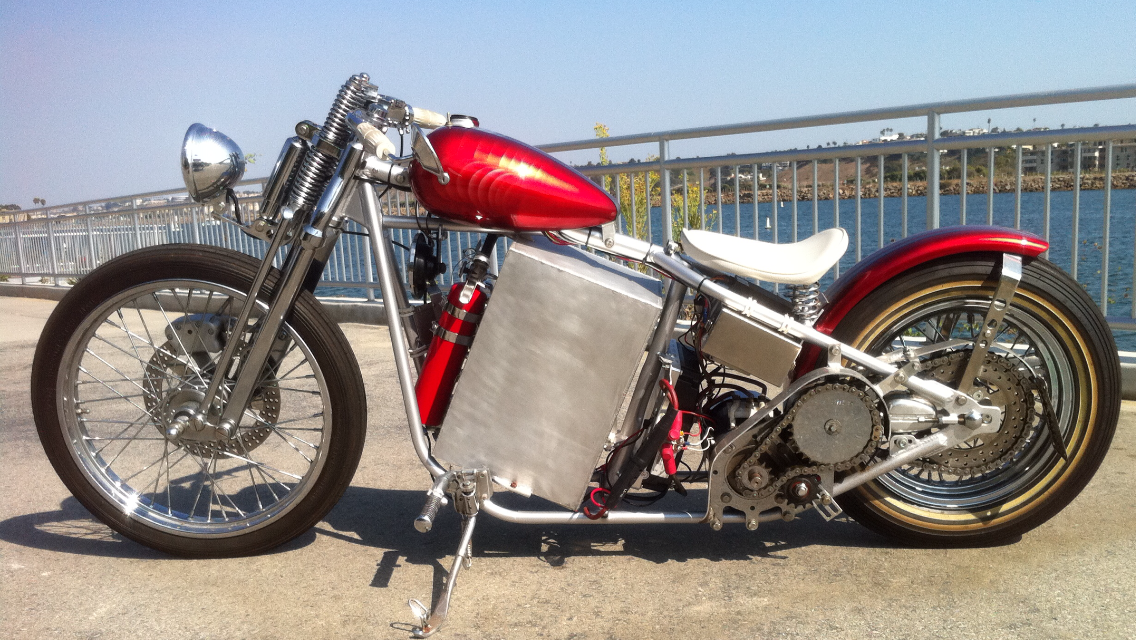

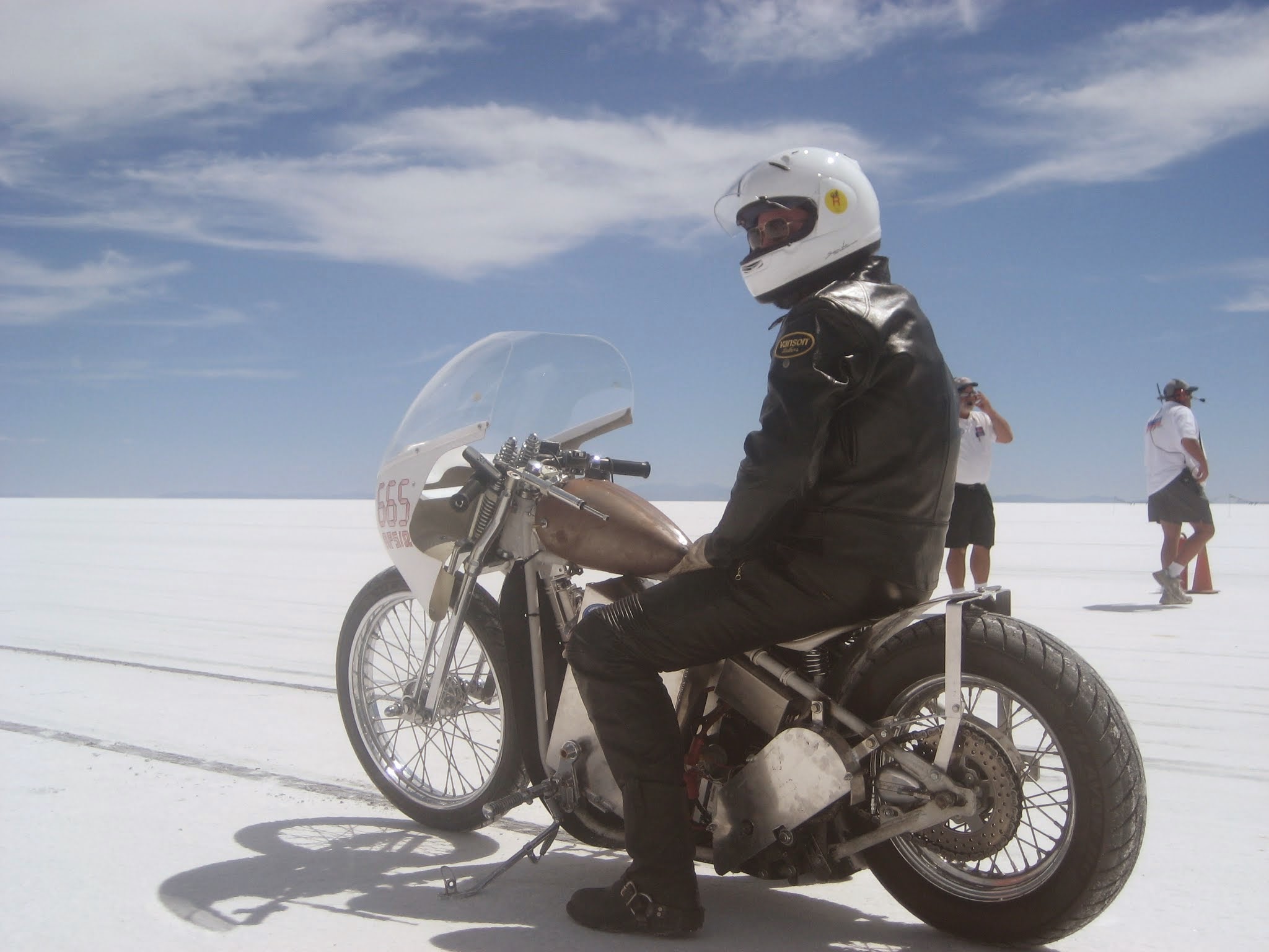

Yes the 30% "slop" or "play" is present in the throttle in the 64.9. If you ask me it's there for safety so that the bike does not jump at the slightest touch.
My motorcycle had zero play in the throttle and it was kind of dangerous because people would grab the bike and not know, nudge it and it could move (fast) if it was on.
This is the "bike" on the salt.
And then after paint - when I used it on the street for a while. And @Waynemarlow note the gears ;). it's a fast swap single reduction jack shaft for changing gearing between runs on the salt.

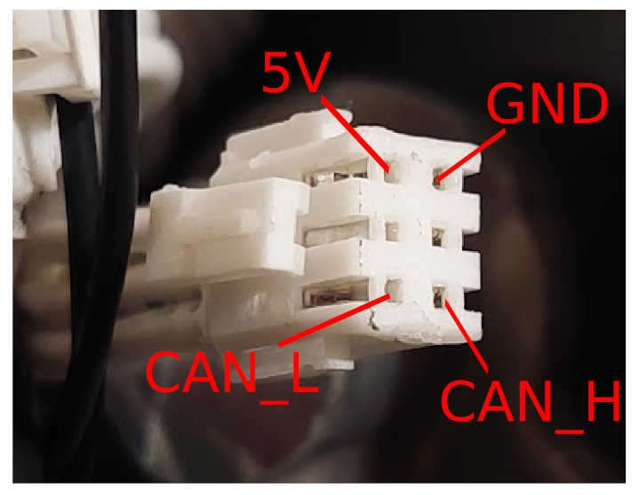

I just installed the EBike board on the Bafang M500 motor, but for now, only on the desk and not yet on my EBike -- soon I will :D
Here is a picture, note the EBike board powered on with his LEDs. All that wires/cables are final, and I put a 4 wires connector to the VESC UART and 5V and GND wires, this way I can quickly disconnect the VESC from the EBike board, to make easy for final installation:
Here is a video:
And here are screenshots from my phone, accessing wireless to the EBike board, I can edit here the firmware, save it and it will run:
And here the firmware outputting the torque sensor torque raw value, the calculated weight kgs and the cadence. Interestingly, when the motor runs as seen on the video, there is cadence value:
And here is the EBike board, with short wires and carefully soldered. On this side, we see the ESP32-S3 board:
On this side, we see the MCP2515 CAN module board that let us read the torque sensor values:
So, for now, the EBike board reads the torque sensor and control the motor by sending commands to VESC. What is missing? is missing the brake sensors connection; wheel speed sensor connection and display connection.
Wheel speed is not a priority, I will leave for the end of the project. Display, it is not a priority for now as I can see the EBike data sent wireless to my phone, that is enough for now. To have my EBike working, I just need to "plug" to torque sensor value to the VESC motor current - and I also need the brake sensor working, this is a must!!
