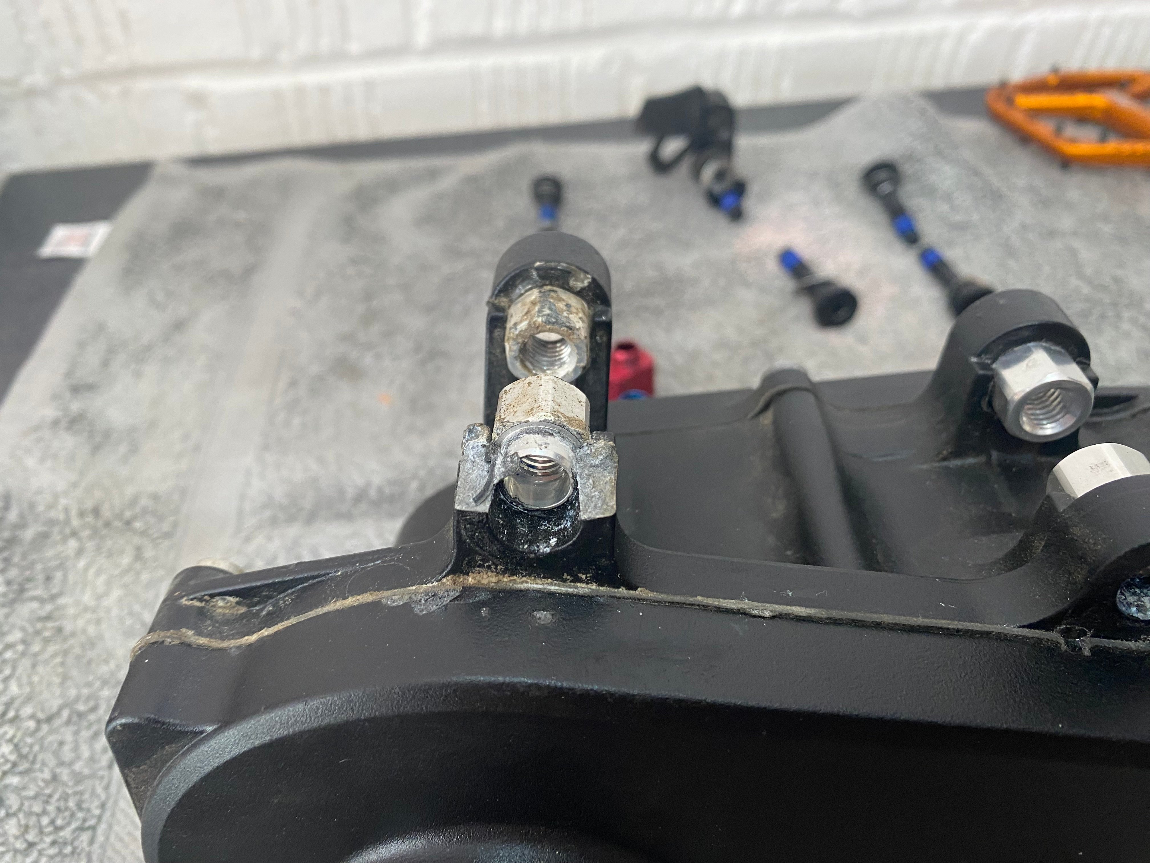

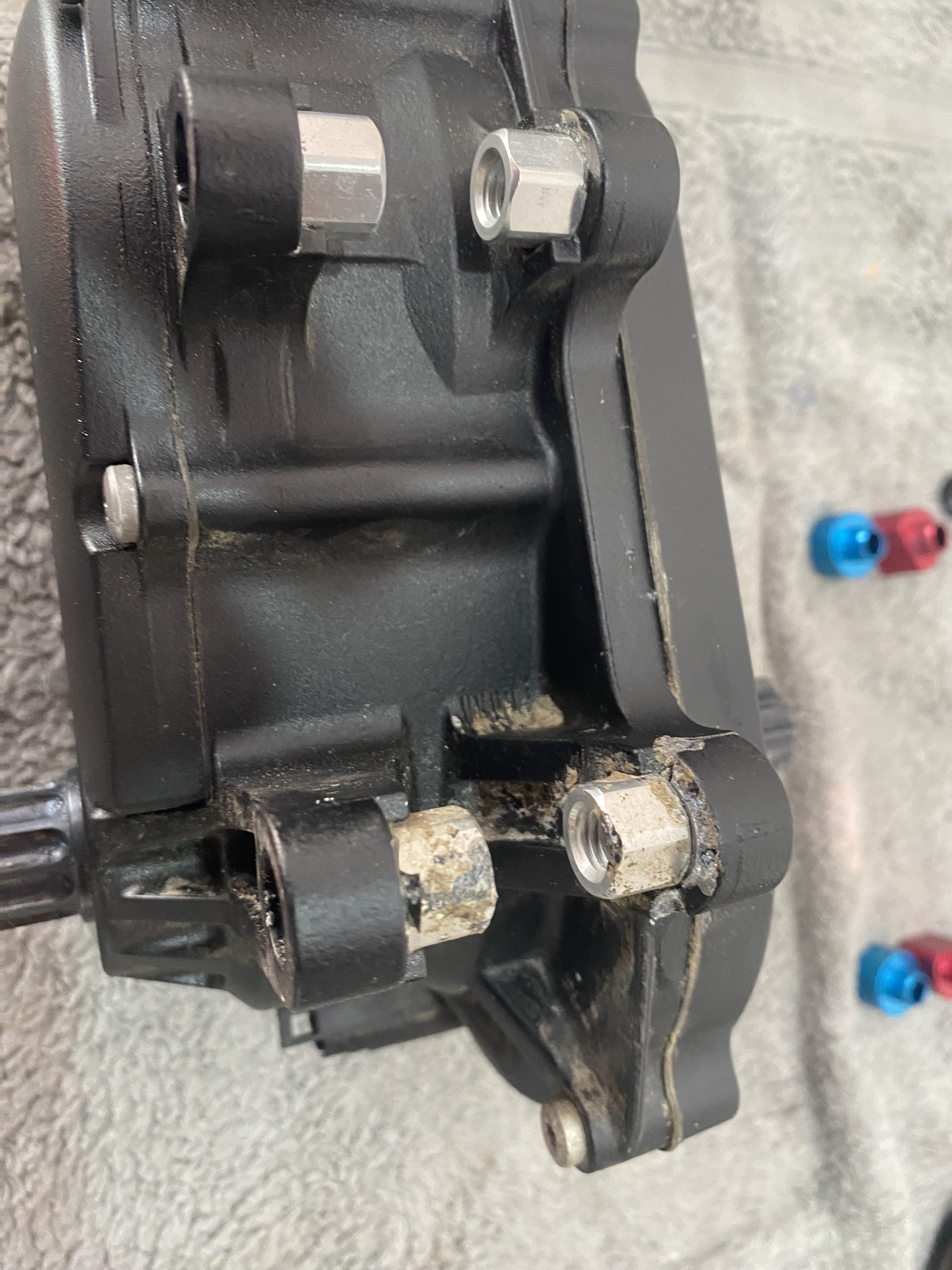

No plastic casing damage these are the rear most motor mounts so shielded from potential, tucked behind chain ring and chainstay
On the other side, there’s a hairline fracture on one side
I could categorically rule out loose bolts & overtorque

Well I’ve plagued this thread for long enough in search, now I’ve found…
An unusual failure and cause of my cracking/creaking under load from previous pages
View attachment 115775 View attachment 115776
This usually happens if one of the motors mounting bolts are tightened to full torque before the others are nipped up. It can also happen if the other three mounting bolts loosen over time, while one remains tight.
This is a fixable problem, but unfortunately not as straight forward as it looks. The motor body contains the planetary gear and electric motor assembly, and this is pressed together in a way that is extremely difficult to remove. The problem being that the three phase electric motor has an angle magnet mounted on the end of the armature that is calibrated to the ECU (the motors brain). This means that you can't just change the motor body for a new one as the motor angle will be wrong, causing noise, lack of power or overheating. Being magnesium, the case is also virtually impossible to weld.
We have designed and made a very expensive 10 tonne hydraulic hand puller to remove the internal components and press them into a new case. This way we can keep the original ECU and drive train.

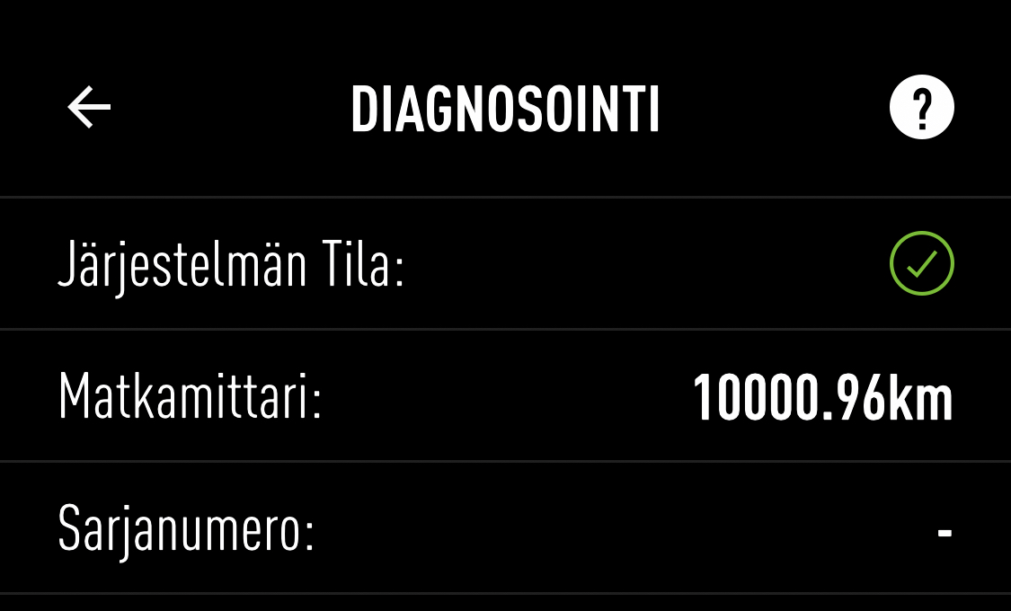

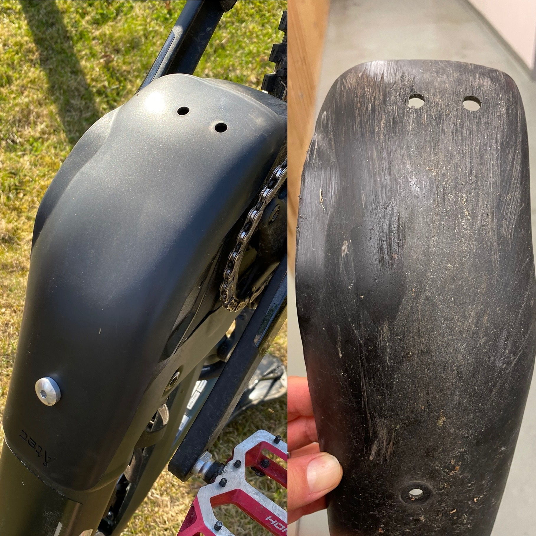

I'm little confused about all these broken motors.
I rode year around in Finland. Sometimes it's -30celsius, sometimes +30 celsius. Rain, snow, mud. About 80% of time i use turbo, all out and no mercy. One broken aftermarket motor guard, so there's been lots of hits also.
In winter time bike is outside 8 hours per day, five days per week.
I don't remove battery at all. So it is sometimes 8 hours at -30 celsius.
9500 km now and original motor. Battery health 100% 🤷
