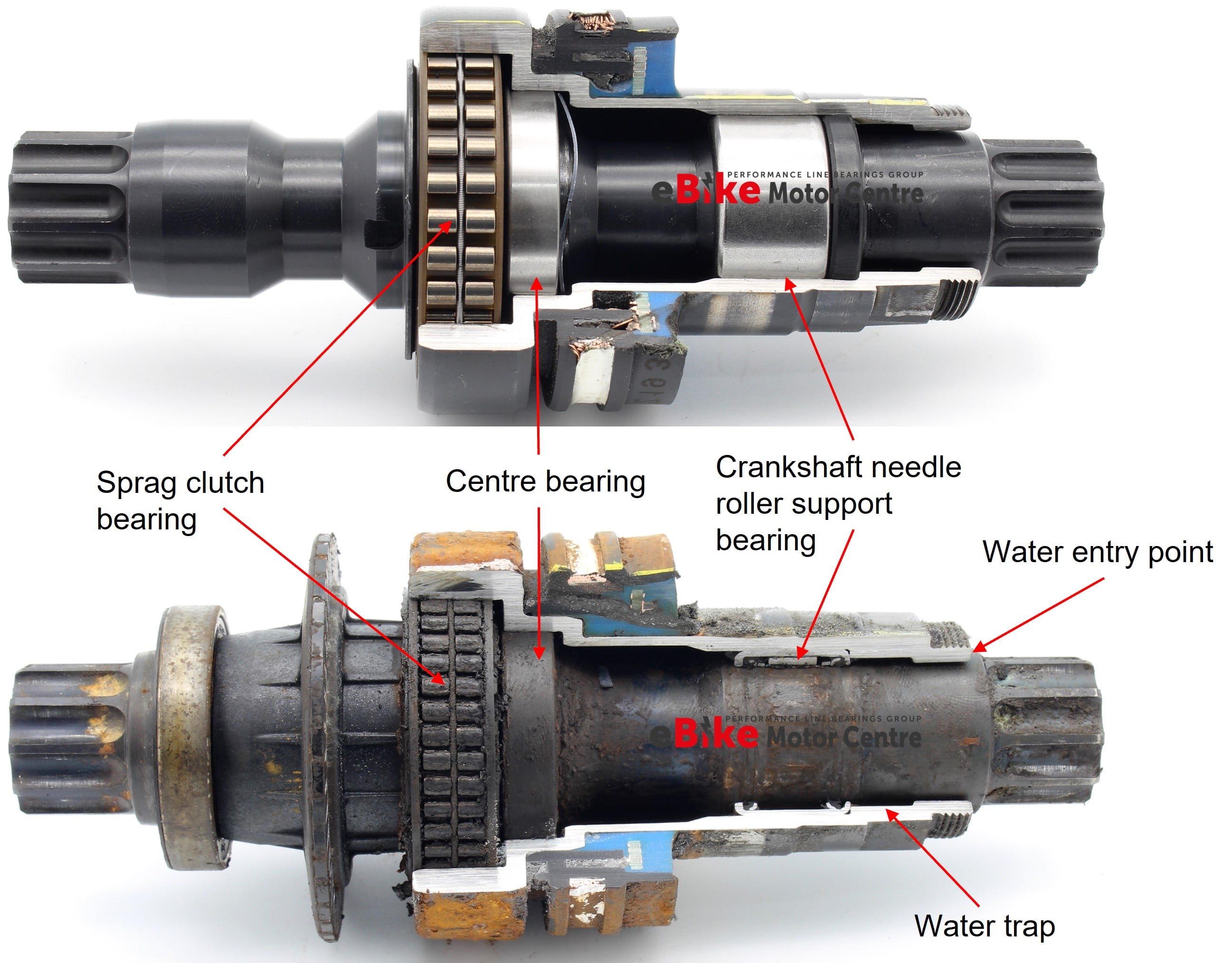

I’m not sure on failure type for each motor and haven’t kept any records, typically i think they have all ended the same way with grinding noise and what feels like the belt slipping, although i have read that this slipping feeling isn’t the belt but symptom of something else!
This is the perfect example of what we see with most of the motors. A small amount of water gets into the outer crankshaft bearings, predominantly the right hand side needle roller bearing. As these bearings begin to wear they do it very quietly because they are also supported by the centre crankshaft bearing which takes some of the load. By the time you hear the grinding these bearings have let enough water through to work its way along the crankshaft to corrode and damage the crankshafts sprag clutch bearing. When this starts to slip is when people stop to take a close look at their motor.
You can see how this happens in the picture below.
Two years and soon 9000km behind with my Levo. Water, dirt, cold weather. No problems.
I live in Finland, i ride all year round. -25celsius to +30 celsius. Lots of wet conditions.
