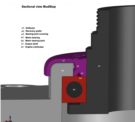

It would be extremely interesting to know what factors contribute. No doubt about one major contributor - riding in the wet is undeniably one of those factors. I'd be impressed if Spesh would take the simple step of providing solutions for water ingress around the crankshaft bearings.
I know Spesh are stumping up for the problems, but it's not their motor so not really their responsibility. That's why people like us are on the case.

Also for owners of bikes still under warranty, I’d argue it’s still Specialized’s responsibility - also Brose’s - to provide what seems like a reasonably straight forward fix - the Brose MudStop.
Very nice work on the Bosch MudStop BTW
