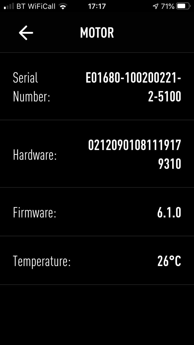

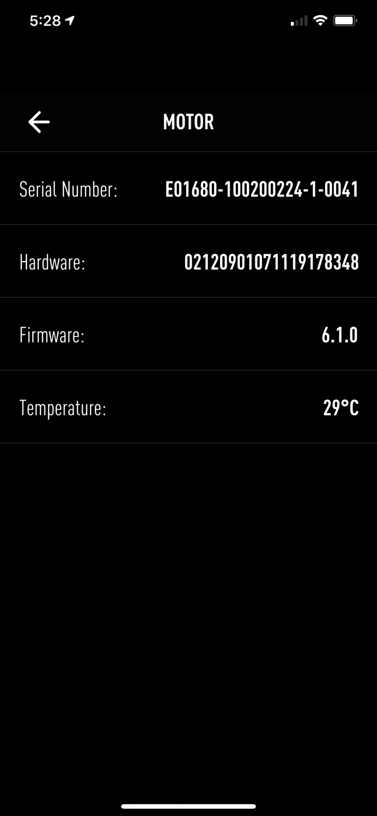

Does this make my manufacture date Jan 10, 2020? Replaced in May at 1100 miles.
