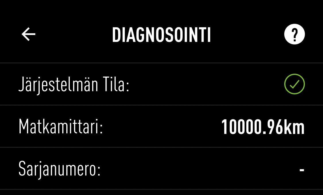

I'm little confused about all these broken motors.
I rode year around in Finland. Sometimes it's -30celsius, sometimes +30 celsius. Rain, snow, mud. About 80% of time i use turbo, all out and no mercy. One broken aftermarket motor guard, so there's been lots of hits also.
In winter time bike is outside 8 hours per day, five days per week.
I don't remove battery at all. So it is sometimes 8 hours at -30 celsius.
9500 km now and original motor. Battery health 100% 🤷
I rode year around in Finland. Sometimes it's -30celsius, sometimes +30 celsius. Rain, snow, mud. About 80% of time i use turbo, all out and no mercy. One broken motor guard, so there's been lots of hits also.
I don't remove battery at all. So it is sometimes 8 hours -30 celsius.
That's not an ebike, that's a Unicorn!

Brose or Specialized will probably buy that motor back from you its definitely a collectors item.
My Levo has been so good partner that when time comes i will sent motor for repairing.
I don't see any reason to even look new bike.
Maybe 2024 Levo someday, when we see what Spesh has to offer then.
