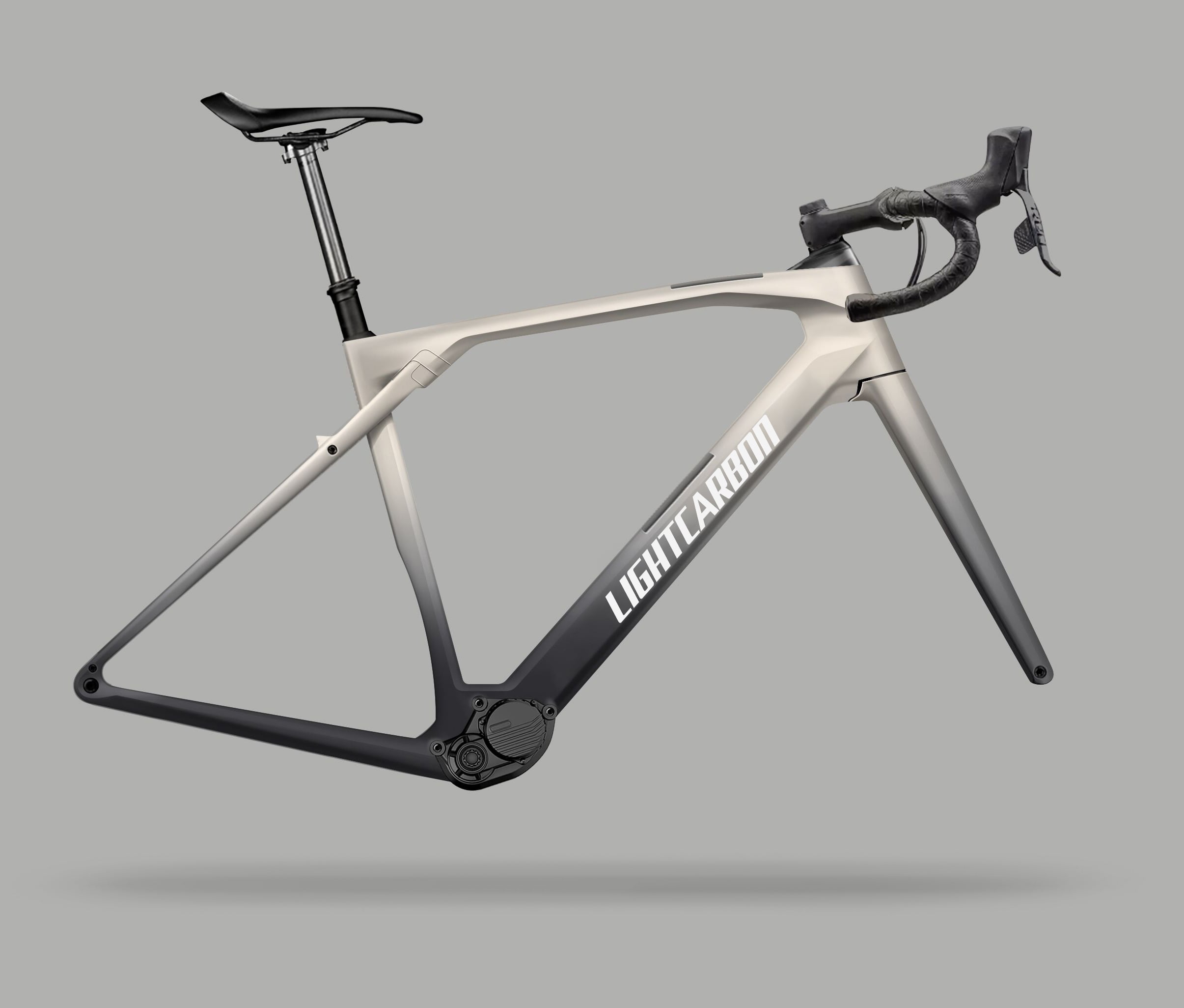

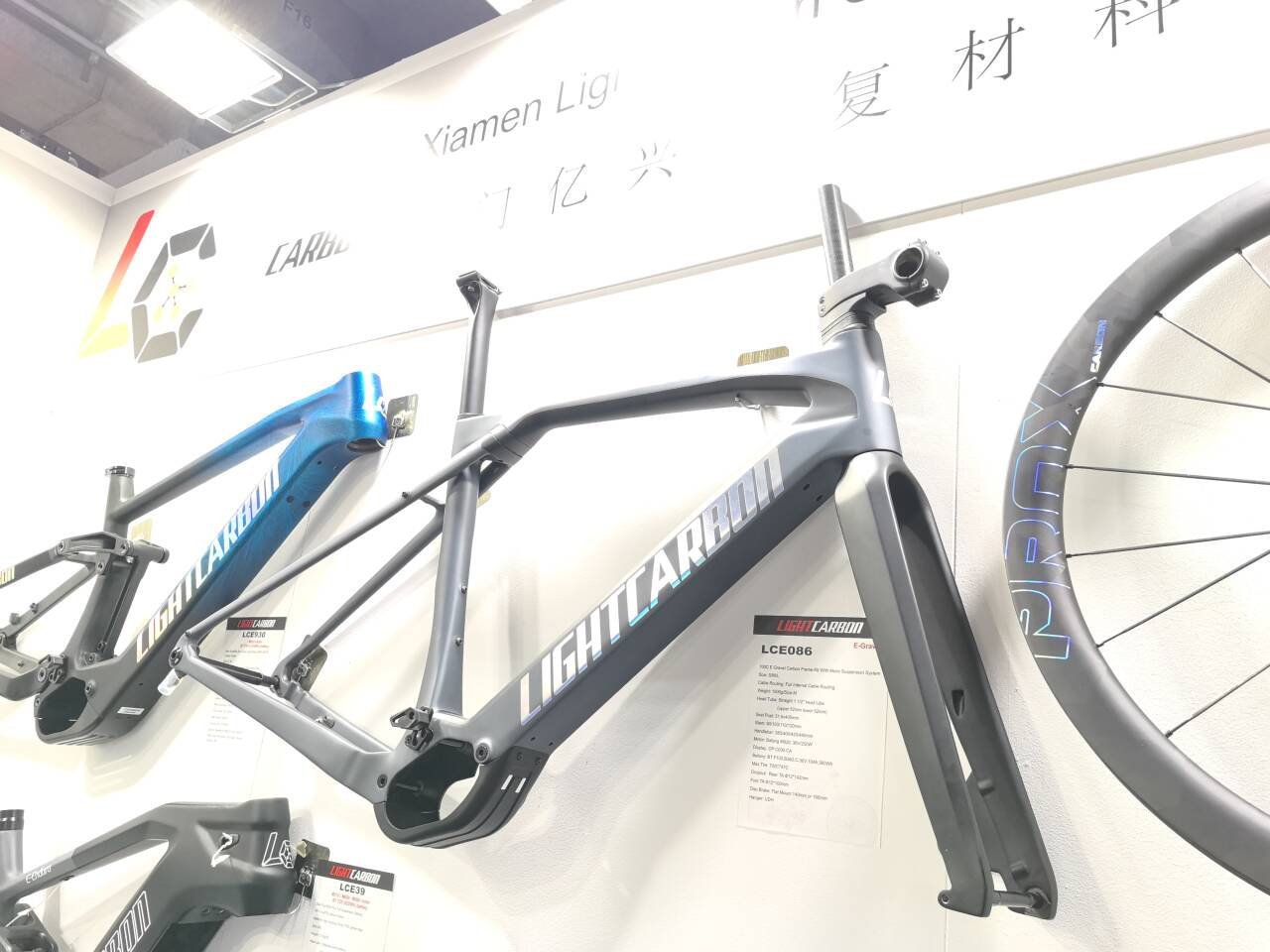

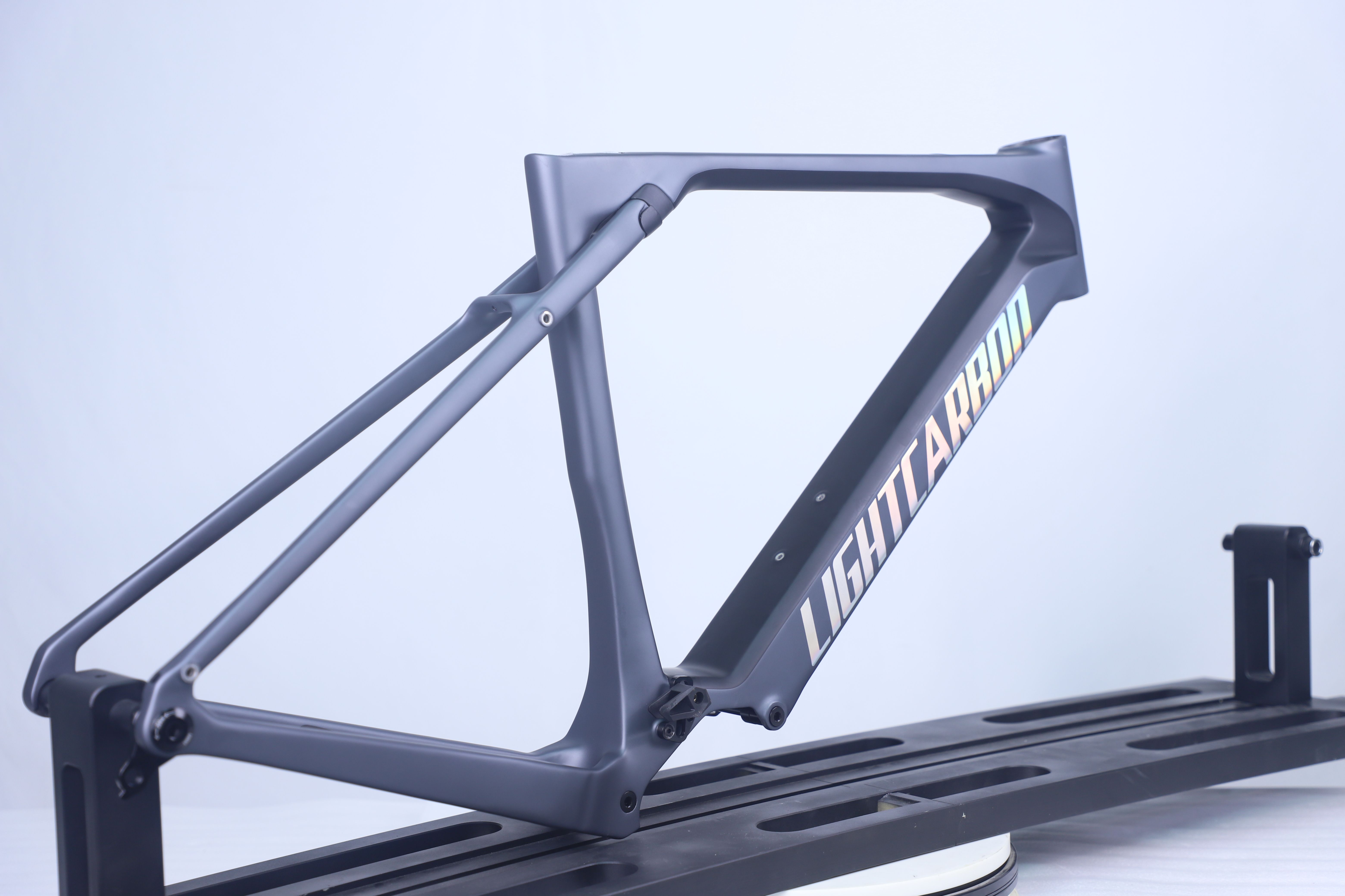

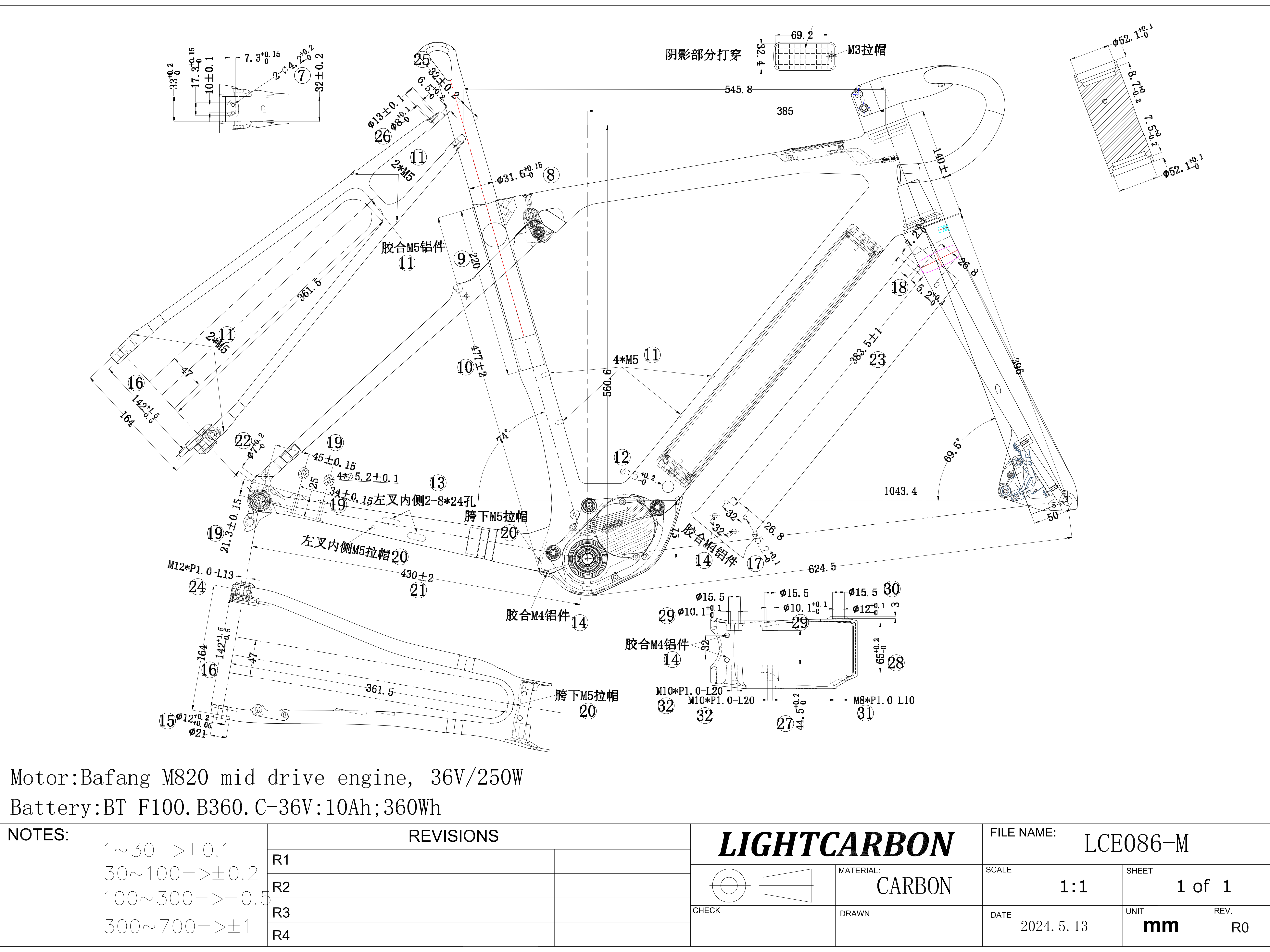

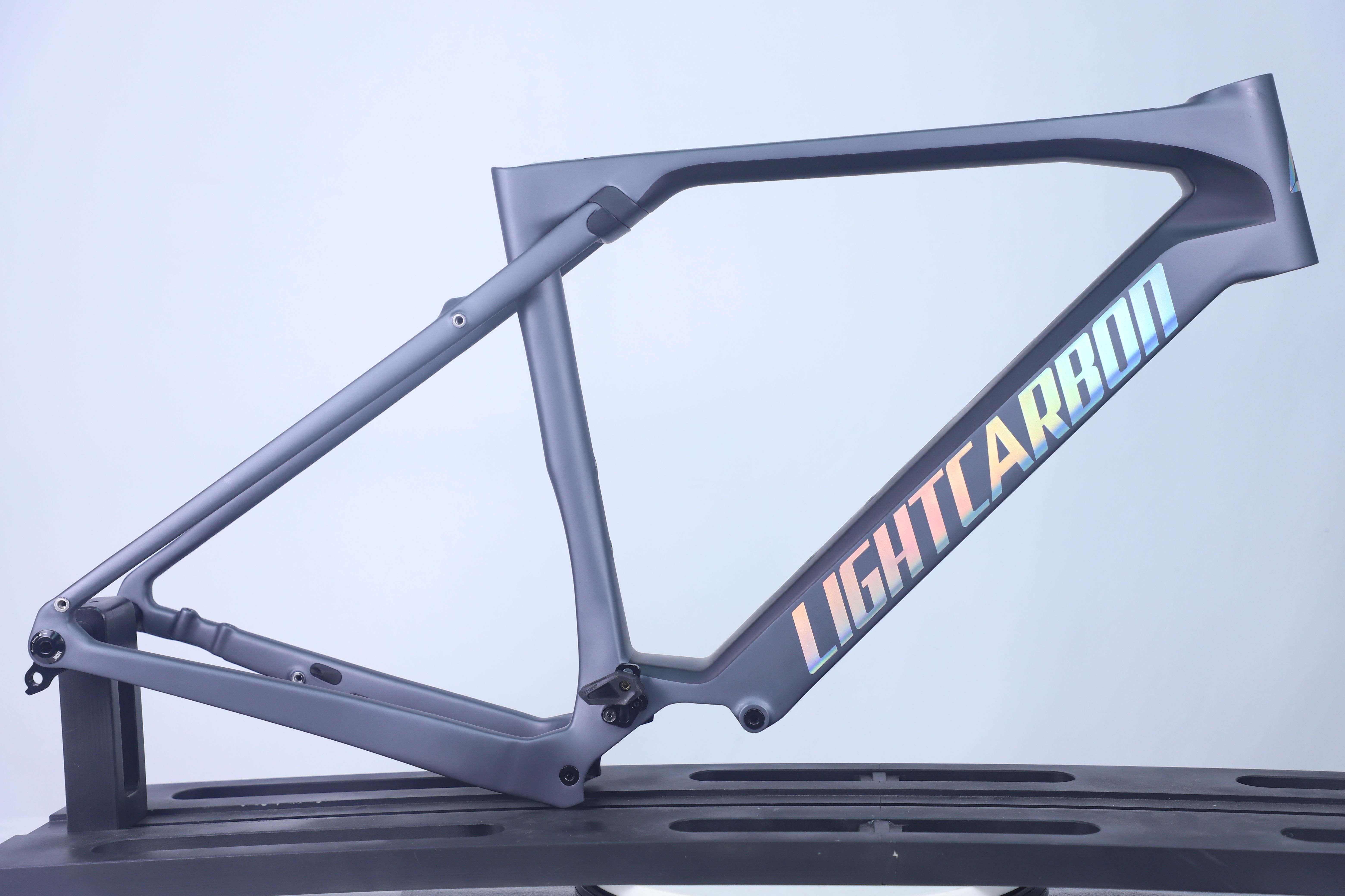

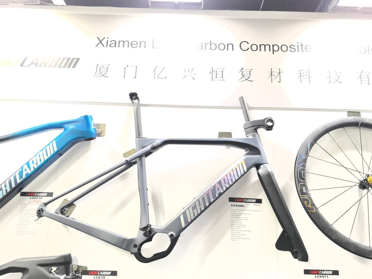

At Eurobike 2024, we launched a new E-gravel frame that fits the M820 36V motor and 360wh battery.
Experts are welcome to give their opinions and suggestions!
If there are bulk customers interested, we can design and produce similar frames fit for other brand motors for you. We also have contact information for mid-drive motor versions of Mahle motors.

No expert, but please make speedsensor with magnet attached to brake disc instead of spoke. Same goes for all the other frames as well of course.
You are talking about two different speed sensors.
To install it on disc, it usually requires enough space at the end of the frame, which is generally not done on road frames.

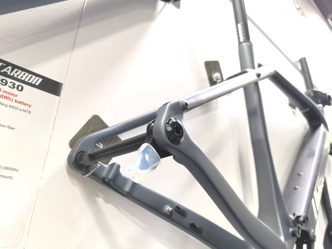

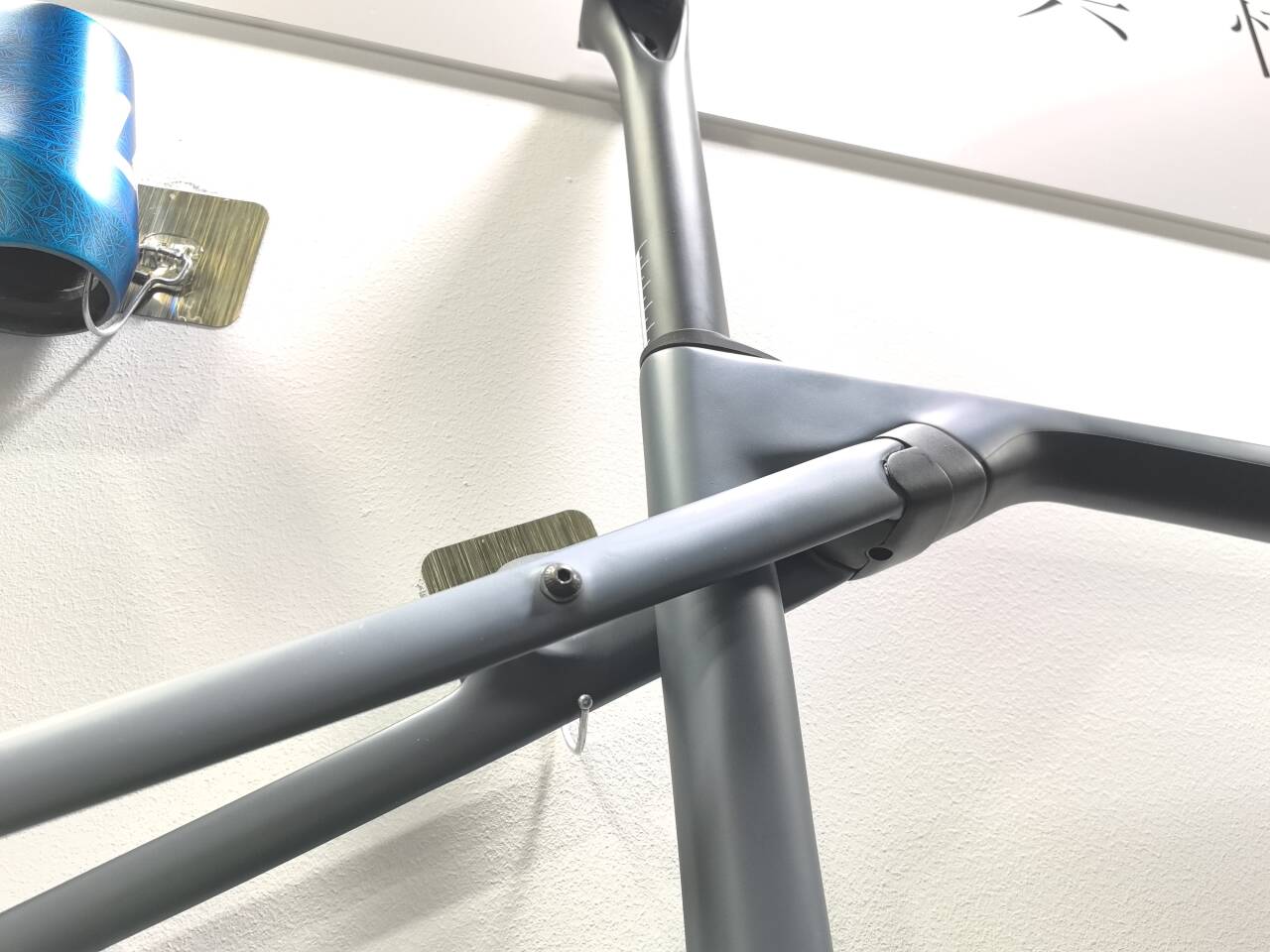

I don't know the efficiency but congratulations for the innovation on suspension stays.
Thanks!
We have tried this micro suspension system on non-electric gravel frames and the customer feedback was very good; so we continued it on the new E-gravel frame.

Can M820 and this frame have a front dérailleur?
Currently I ride Fazua bike with double chainring.
Looks comfortable frame for flat bar commuter bike.
It is not recommended to install a front derailleur, as it may cause the shift to be too far apart to be effective. Ebikes usually don’t need a front derailleur

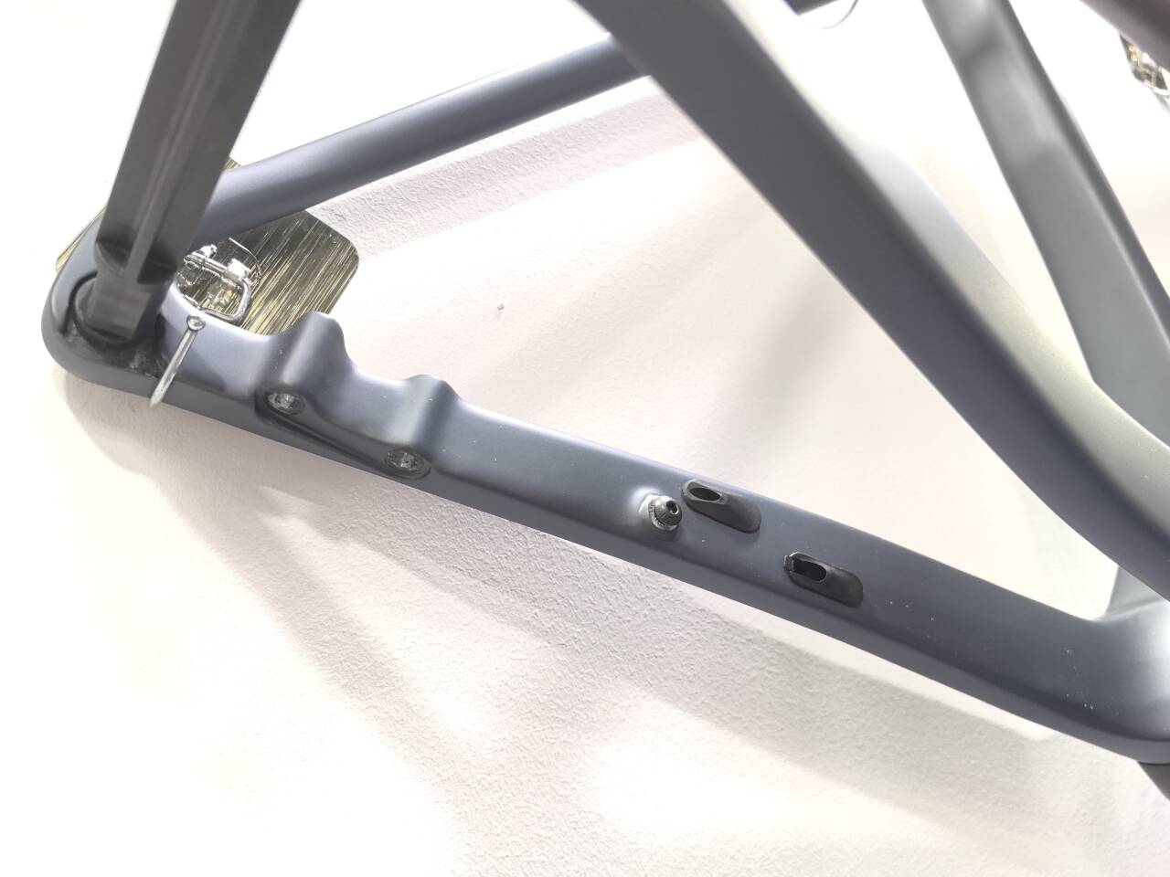

Thanks for posting this here. The frame certainly has a great design, congratulations for that. Is it possible to mount a fender and/or rack, considering the rear suspension?
El Topo
Jul 23, 2022
139
53
Germany, Bavaria
Great
yes, mounts for fender and shelves
Great, thanks for posting. What is the max. load, that I am allowed to put on the fender?
Am I right to assume, that I can't use the fender mounts above the axle, the fender mounts close to the saddle, and the fender mounts close to the BB for a single fender rack/rack combo - considering how the suspension works?
I would like to mount such a fender/rack combo to the bike, is that possible, or would that lock the suspension from moving freely?
Also, is there a chance to get another fork, with gussets for bike packing?
