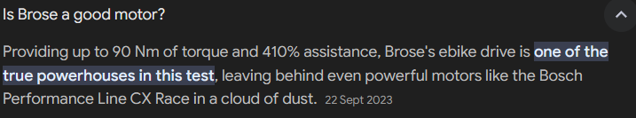

Excellent performance and fully repairable to boot. I foresee mass defections ;)

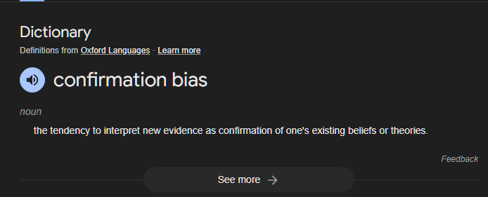

The question you asked google or whatever is pure confirmation biased
you get results that favour your outcome, it's not proof of anything
It's also why search engines are bad, most people probably don't even realise and live in tunnel vision echo chamber land.
You are mistaken. "Excellent performance" is from a review/test and "fully repairable" is from Bearing Man AKA Ebike Motor Centre - www.ebikemotorcentre.com who repair them. You would realise this if you had read the above posts.
