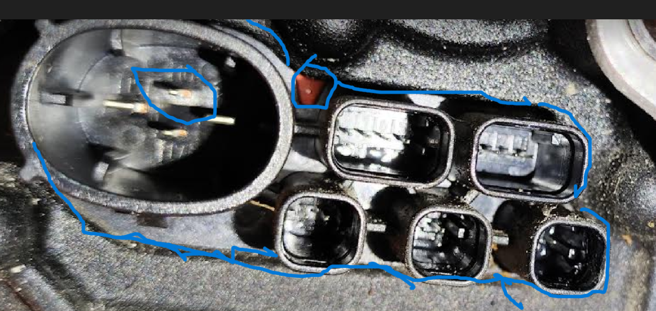

Bosch Gen4 Speed motor also broke today😭... now the water appears to be coming through the motor/print plate seal again
(same as my bosch gen 2)
so not via the bearing seal!
so not via the bearing seal! View attachment 142173
If water gets into these female connectors it’s possibly game over. If enough water passes into the motor through these connectors …it’s definitely game over.
As a preventative measure I apply a very small amount of dielectric grease around the seals of each male connector to improve the seal (rubber ribs only). I don’t slop the grease into the female portion …that makes an unnecessary mess.
Does that prevent water ingress in this area? Seems to. That’s one less thing I have to worry about. A Bearing seal kit and Bosch grease on a regular basis helps also.

for me the water comes in via the packaging between the aluminum motor part, the plastic part with the plugs.. with the Bosch 2 it also went through a plug (correctly) not through the silicone sealing but through the space between the wires (although this was a plug from a speedbox set)
if you look at the photos in this link you can clearly see where the water enters... at the screw next to the red gasket (sealing aluminum/plastic part with plugs on the other side of the print, see also the water damage
This does happen, because Bosch decided to move the plugs from the dry protected environment at the top of the motor (as on the Gen 2), to the wet mud packed underbelly at the bottom of the motor. However, this only tends to cause corrosion damage to the pins, and does not usually physically enter the motor through the gasket or plug pins (unless you try and blast the mud from your belly pan with a hose/pressure washer).
