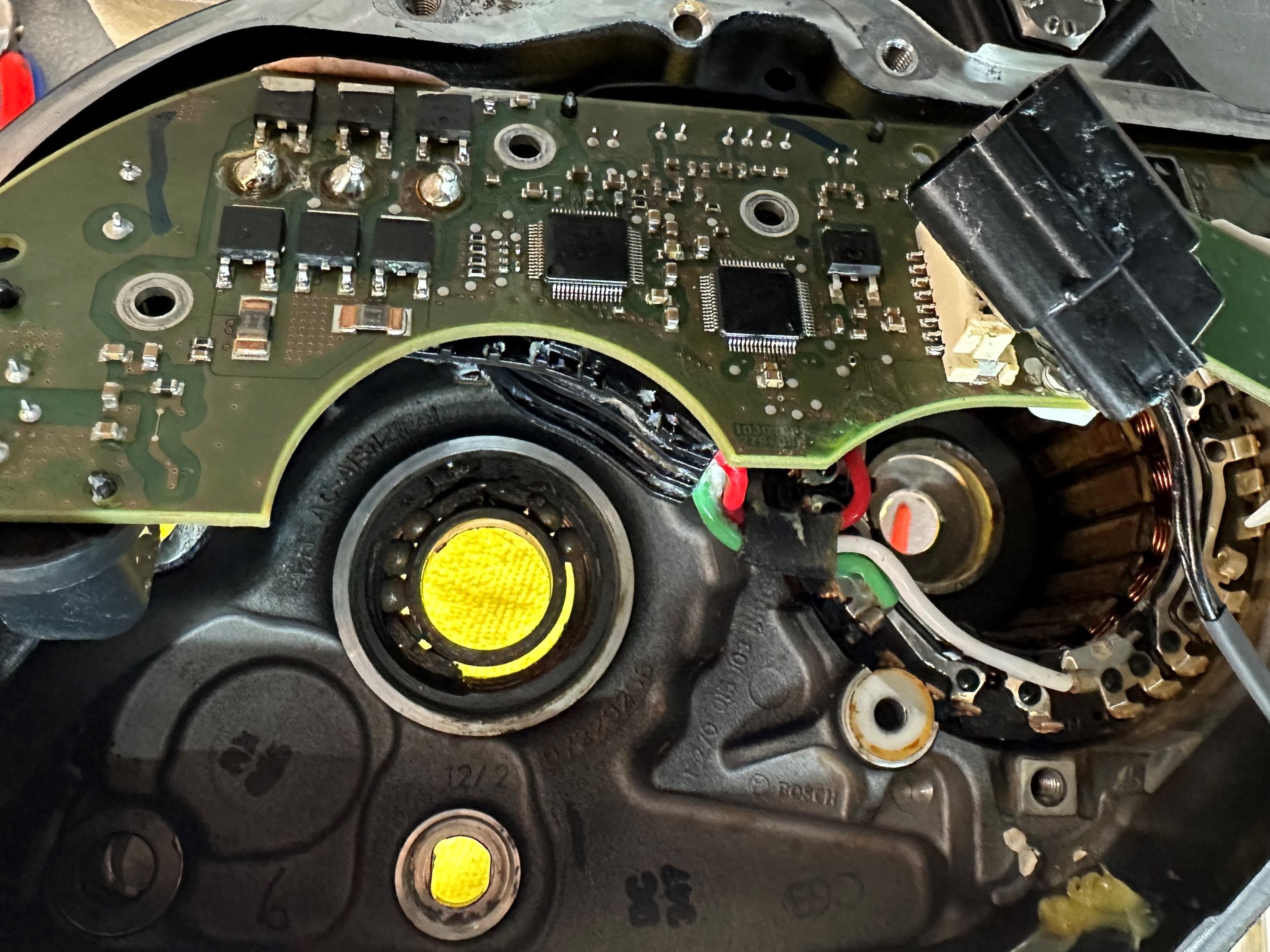

The printed circuit board (PCB) that sits around the crankshaft shows water damage and dirt/mud spots on it. This damage has come from the water and dirt dripping from the crankshaft ingress again. Once cleaned, dried and treated, this PCB actually still worked but was about as close as they come to killing the motor completely.
Does the PCB have any conformal coating at all? Even thought I'd expect something way thicker than conformal coating here.
No real conformal coating. But don't forget, manufacturers say that the motor is sealed, so wouldn't need a coating :rolleyes:

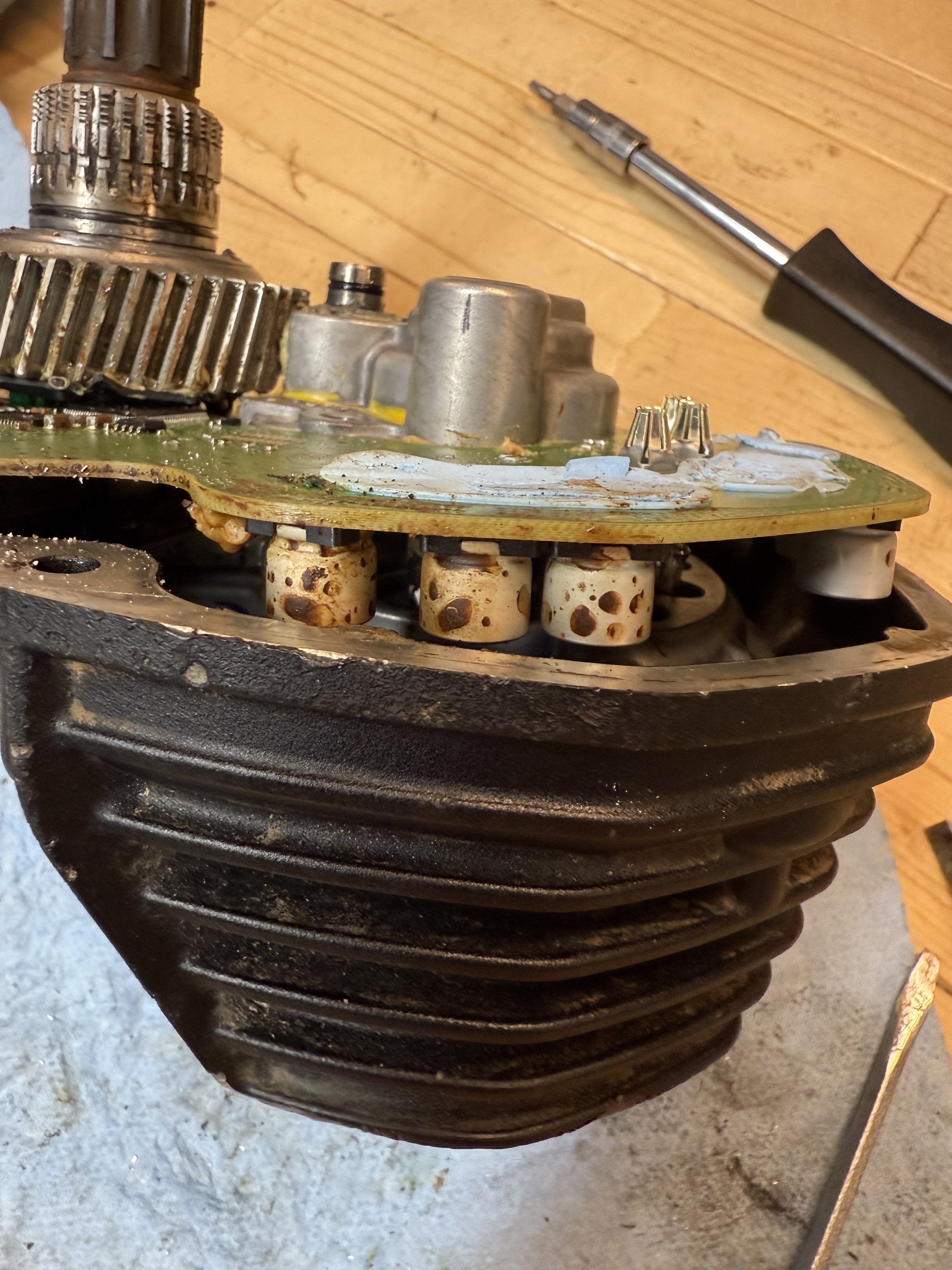

Here's something to consider: Most motors failures are bearing related, if you catch this early, your motor can be repaired by just changing one or two bearings and water should not get into your motor. Therefore, no worry about the PCB. However, If you don't bother, or just keep riding regardless of the horrendous noise and rough feeling through your feet, a repair is going to be very expensive or impossible anyway.
Imagine the crankshaft in place and see if you can spot the issue in the picture below... It's a genuine mystery to some how water ever got into their motor 🤔

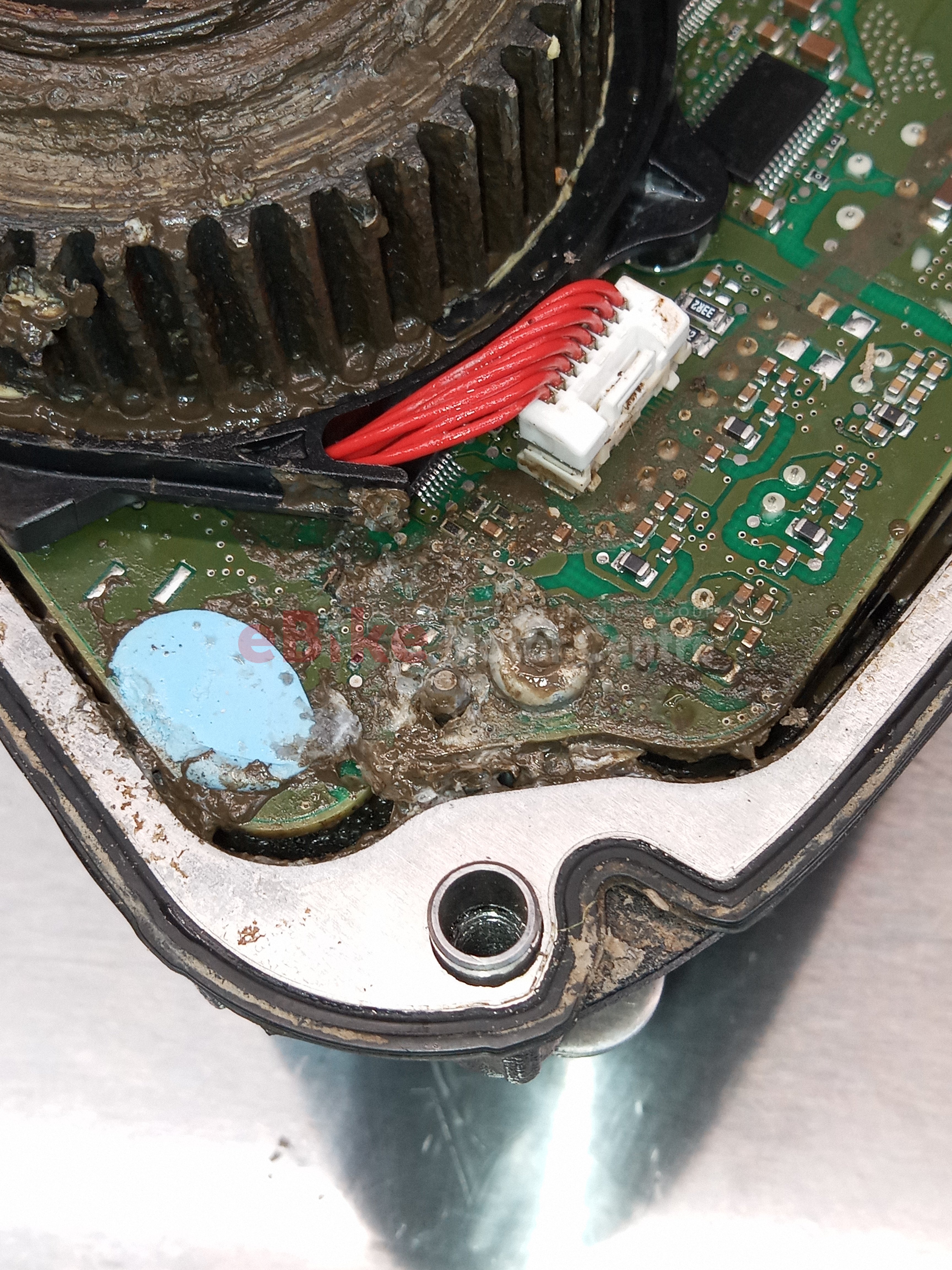

We have reverse engineered several PCB's from different motors and can/do change certain board components.
PCB's in ebikes are killed primarily by water (see Gen 4 bellow), followed by component failure and finally connections.
