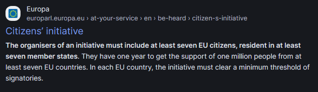

"Citizens themselves, following a successful European Citizens’ Initiative" There must be many members of this forum who reside in the EU so maybe some of them could table citizen's initiatives for including ebikes in the Right to Repair Legislation"
1 million signatures is a high bar!

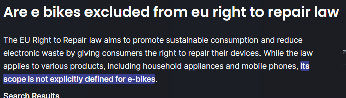

And the article that AF1 has linked to suggests that ‘right to repair’ is on its way. Though of course, thanks to the gift that keeps on giving, it may not apply in the UK. But it does looks like things may improve given time– fingers crossed.(y)

Bosch are massive, so I’m surprised they spend so little on lobbying in the EU.
It should apply to us as we adopt the EU laws.

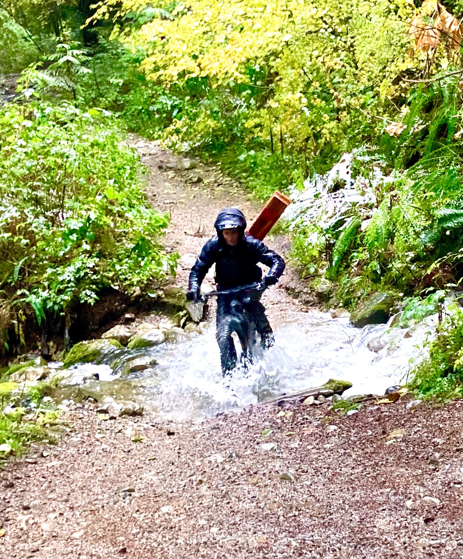

  • Who amongst us has not had to cross a stream or deep puddle or deep water filled rut when riding the trails in a country as wet or wetter than the UK? It is not possible to know the depth of the water until you are committed.

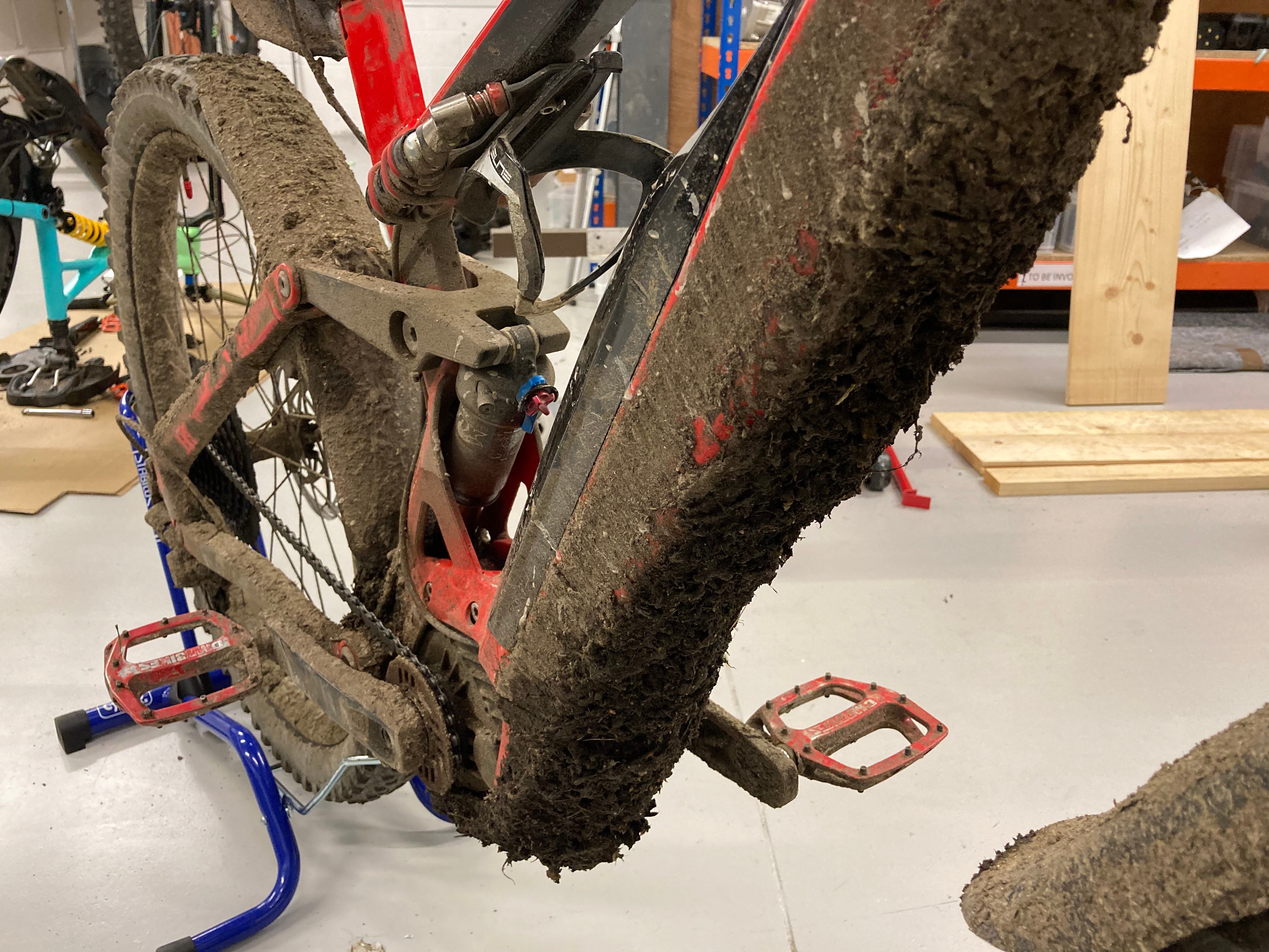

  • Who knew we should only clean our motor casing with a damp cloth – really?
  • No, not really. It is perfectly safe to spray with some sort of Muck-Off, wash with a soft brush and sprinkle with the hose.
  • If you took that attitude with a motorbike, car, lorry etc. you would also stand the chance of wrecking the motor.

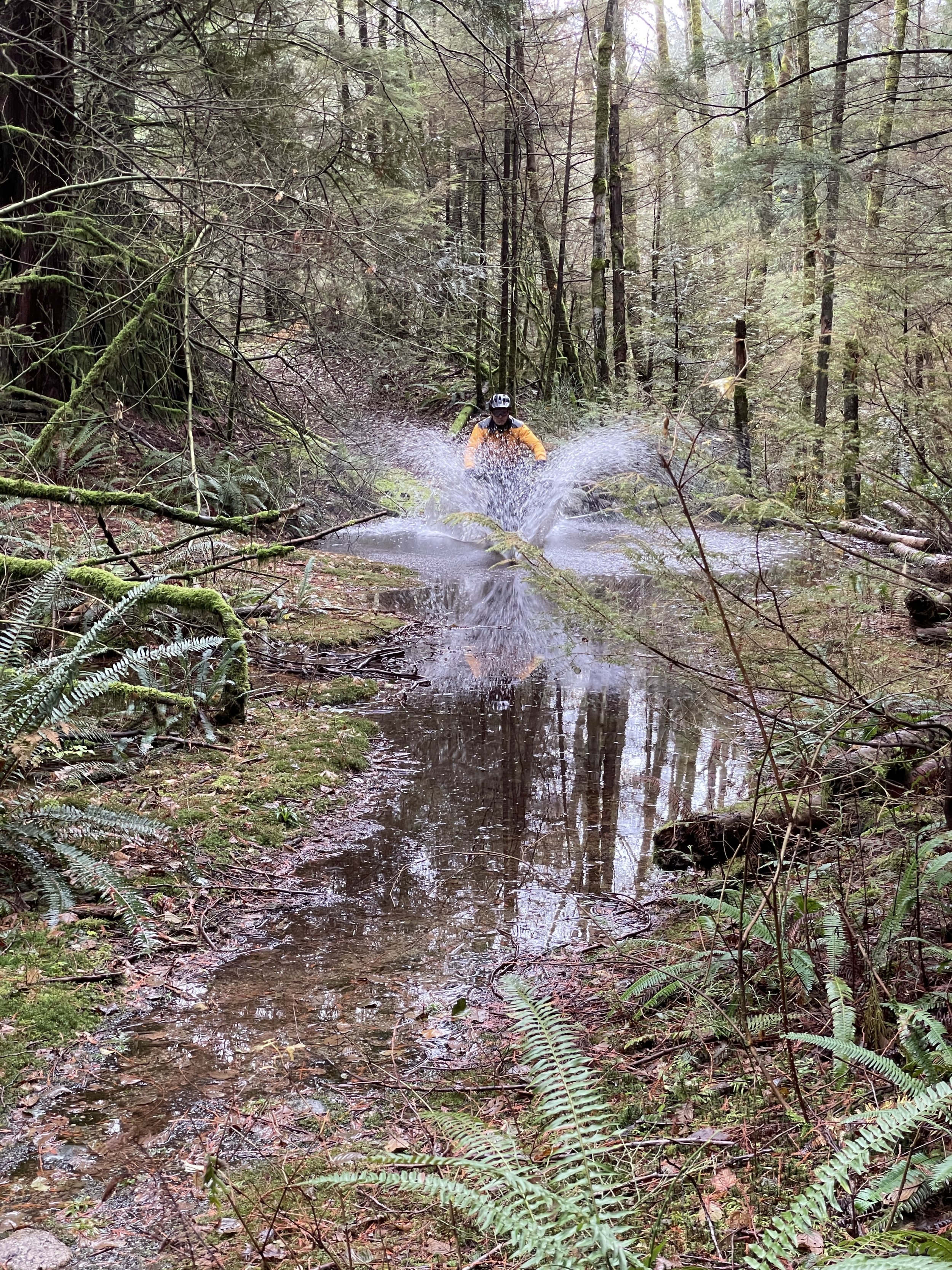

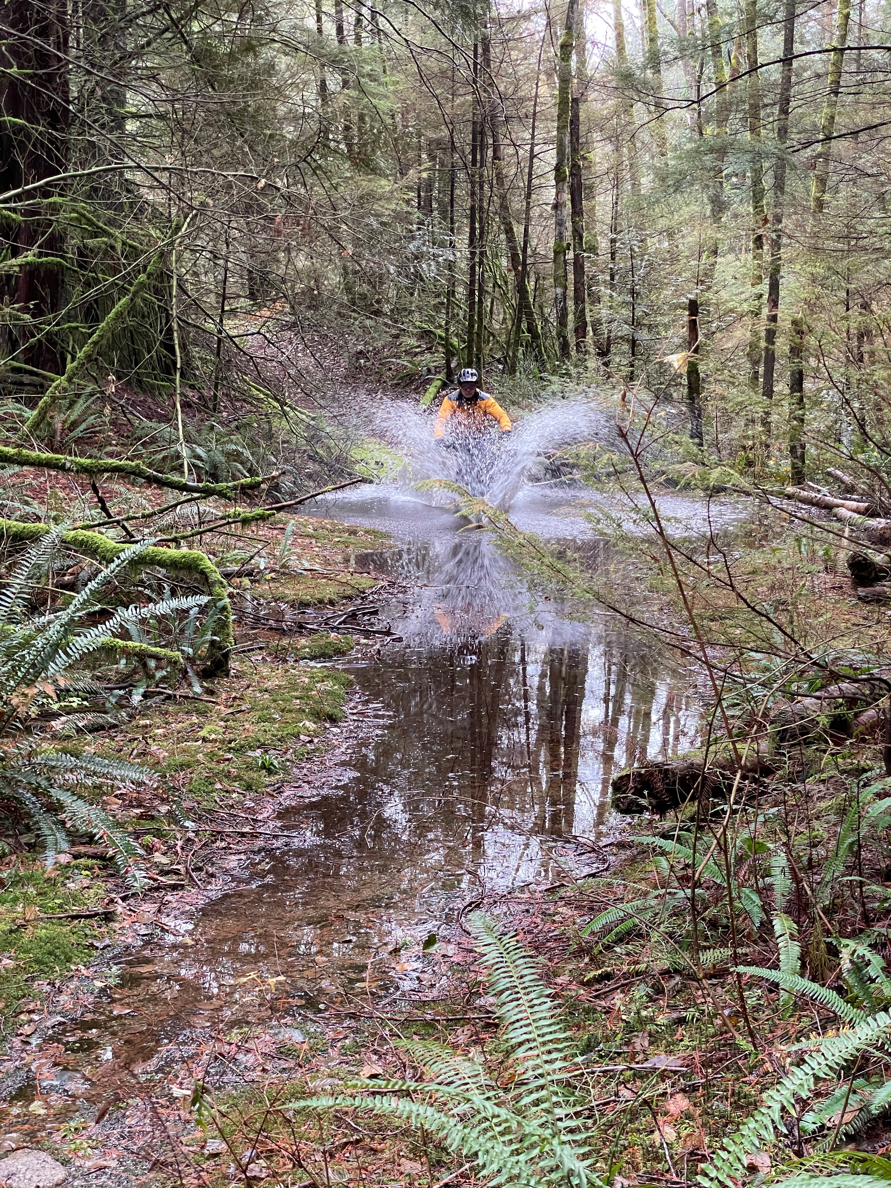

I don't own a car and I ride my bike to work and back every day, off road and out in the bogs and the streams at the weekends. Granted, it's only about a mile each way to my house, but it's unbelievably wet and muddy and that's what does the damage, not the miles.
I ride a Specialized Turbo Levo with a Brose 2.1 motor and decided to do a little experiment. I fitted a new motor just to see how long it lasted without washing it. Part of my journey floods across the path in the winter for about 500 or 600 metres, and generally to a depth just below the crankshaft, the rest is large puddles and gravelly mud.
After 2 years, the motor is still quiet and smooth. If the forums were right, I should have had 4 or 5 motors during this time.
