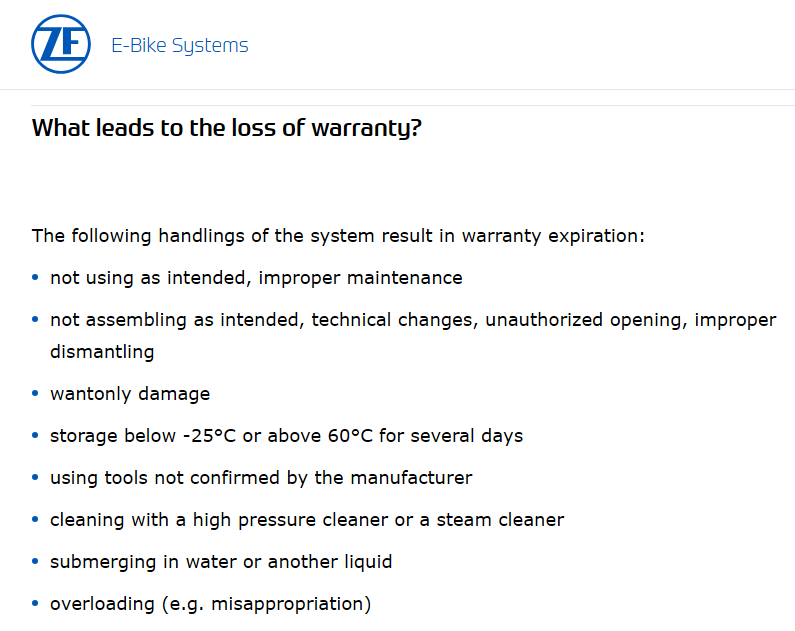

The devil IS in the detail especially:
  • submerging in water or another liquid

I know there seems to be a view from some that it's only emtbs that have motor/electric problems, but it's not always plain sailing... with other implementations.
Theres also an interesting part about pursuing warranty claims against European manufacturers post Brexit

Don't submerge them and don't aim a jet wash or hose at them....apart from that you should be OK. I have done thousands of miles on emtbs ...both Brose and Bosch since 2019 including 5 very wet uk winters....no motors problems.
Do you have a choice when riding a trail which becomes deeply rutted. You don't know the depth of the water and most of us cannot carry their ebikes to keep them dry!

Then the more waterproof the motors are made, the deeper water everyone will ride through, so then the electronics, plugs, gaskets and batteries would all need redesigning!
As I said, it is coming, manufacturers have made some mistakes, but things are definitely changing, they are listening, it will be fixed and these issues will go away. It just takes time.
Yes, I know we should not be the Guinea pigs, and the design should have been right in the first place. This is also a subject I have written extensively about, but sadly do not have time to repeat this today.
I'm different to some i think, i bought mine accepting that the motor is likely scrap either during or after the warranty and will need replacing before the bike does. It potentially means a cost of £500-1000 but lets be fair here, that's not a completely insane amount after 2 years of ownership, if it was a car and needed a new clutch at £500 you'd be OK with that, or an air-con condenser you'd accept that too. So I don't see why people think a motor should last forever.
Just accept it's broken, replace it, get a new 2 year warranty and start again :)
