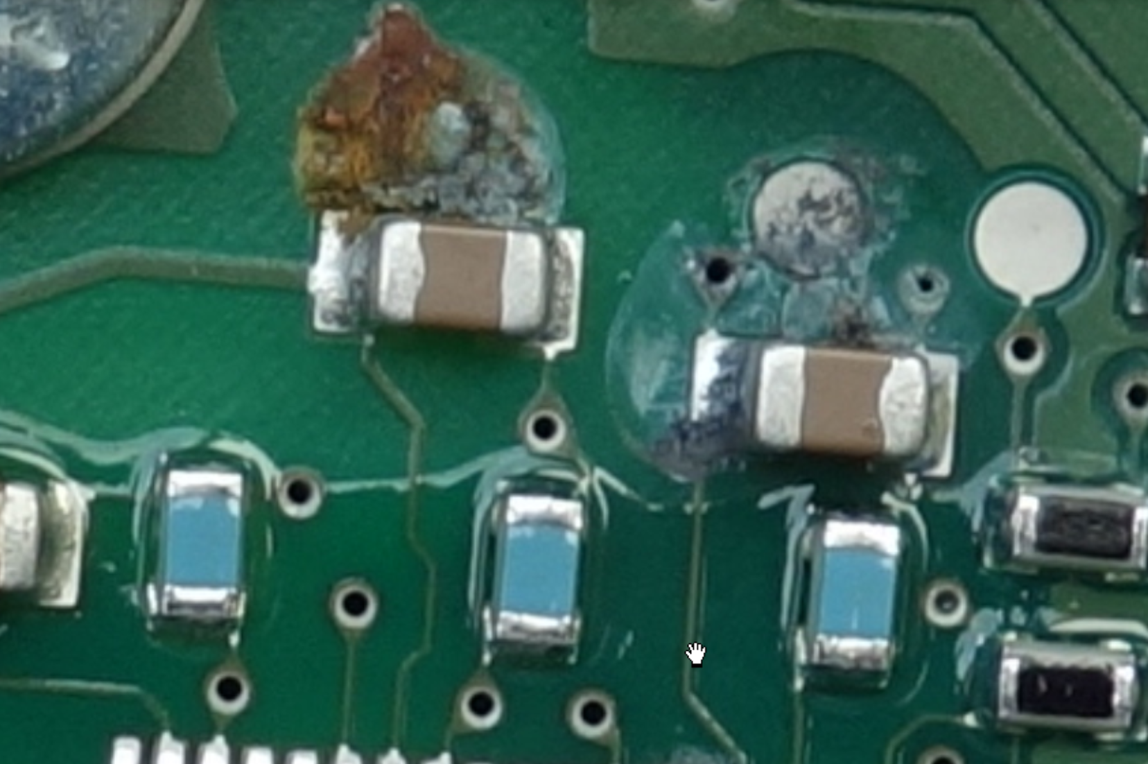

I have a simple solution to this.. .if you are mechanically savy... you can always open up the motor and use dye electric grease on the electrical components.. this is just my hypothesis but it should technically keep moisture and water out from critical electrical components causing them to not short or rust out..
Im wondering if anyone has already tried this???
need a better PCB coating that will rule out closure
I also have a photo of my Bosch 2 engine
Here you can see that everything under the clear lacquer remains intact and where no lacquer closure occurs
Schermafbeelding 2024-07-02 152200.png Schermafbeelding 2024-06-15 213904.png
Yes it's very simple, Bosch could just make the PCB 'potted' or coat the whole thing with resin like the blue fluid in your pic.
Alternatively, (a radical thought I know) they could avoid having to pot anything and just make sure that any shaft open to the elements is sealed properly just like the gazillions of crankshafts/output shafts etc on engines all over the world.
It's almost like Bosch haven't heard of 4x4 off roaders that manage to plough through sloppy mud up to their windscreens without any engine/gearbox/diff ingress via rotatey, spinny bits.
View attachment 143148 View attachment 143149
aww so this is a better solution than dye electric grease.... Im not a electrical engineer or anything... but my guess was that since dye electric grease is hydrophobic and non- conductive... it would be great way to protect PCB boards without shorting them out.. since factory solution does not provide a "better PCB coating" I was wondering if this would be an adequate work around...
and also.. may i ask what that clear lacquer and blue substance is?

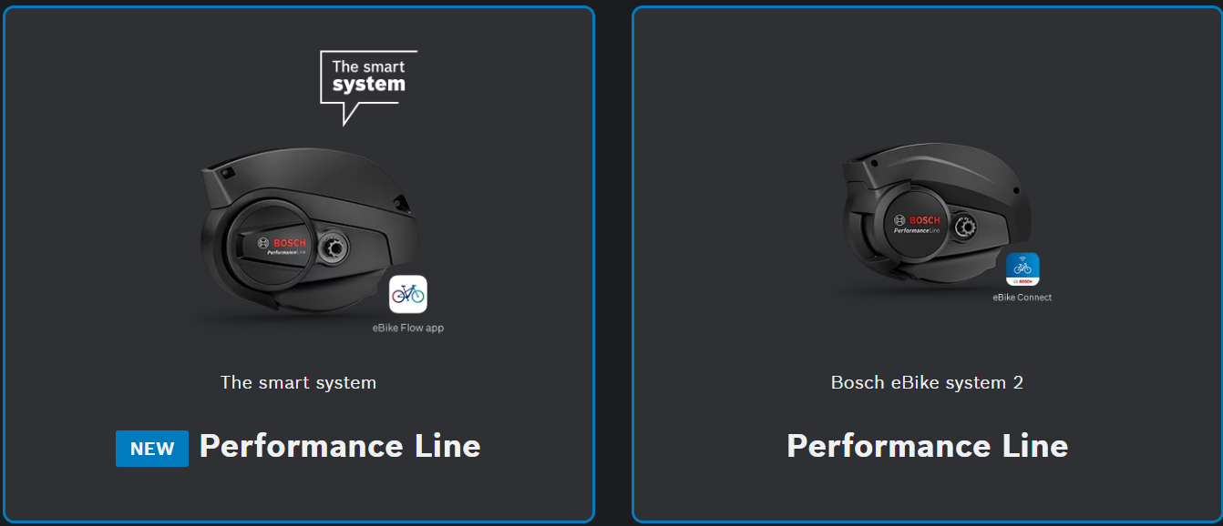

The "non CX Performance Line" was discontinued in 2018, but was made very different from the Gen 4 CX. There are not so many "non CX" Performance Lines around these days so you will hear less about them, but they failed all the same. There is no difference in build quality. When "nonCX" turned into CX it was only a software change, then the Gen 2 CX was discontinued in 2020 in favour of the new Gen 4 Performance Line CX. This is a completely redesigned motor, but has similar failure rates, just different failures.
Are you talking about this performance line in the picture or was there another one? I have the non smart one in a 2020 Cube emtb and they're still in the cheapest cube reaction performance 2024.
OK, so this is the Performance Line Gen 3 and is made very different to the Performance Line CX Gen 4. The Gen 3 was primarily designed as a road bike motor, and does not have the strength, power or sealing that you would find on the Gen 4. The low power of the Gen 3 meant great battery range though.
All EMTB's used the Gen 2 CX until 2020 when they all went over to the Gen 4 CX. One manufacturer that I know of in 2020 put them in their "gravel" bikes and this was Cube. Since then, others have tried this too, even putting the Gen 3 in their low end mountain bikes because of the cost saving to the manufacturer. Sadly, the Gen 3's don't do well in water at all. And the reason you don't hear about it, is because 99% of these motors are fitted in road bikes which don't tend to fail like the offroad bikes.
This being said, the Gen 3 Performance Line is the strongest of the gen 3's and ha a large steel drive gear instead of the plastic one fitted to the Active Line and Active Line Plus. This allows the Performance Line to take bigger pedal strikes and hits better. And, if you stick to the gravel, it will do the job.
Nice, I've done 30,000 km, with some heavy days in rain too, this should mean that 4th gen Cx should hold up well for similar conditions.

@Bearing Man did you have a chance to look at the new Bosch motor at EuroBike? I’ve seen a few videos and it’s already on a lot of new bikes. The next bike I was looking at is Bosch powered (Crestline), wondering if I should wait on the gen 5 motor before buying anything Bosch powered.
