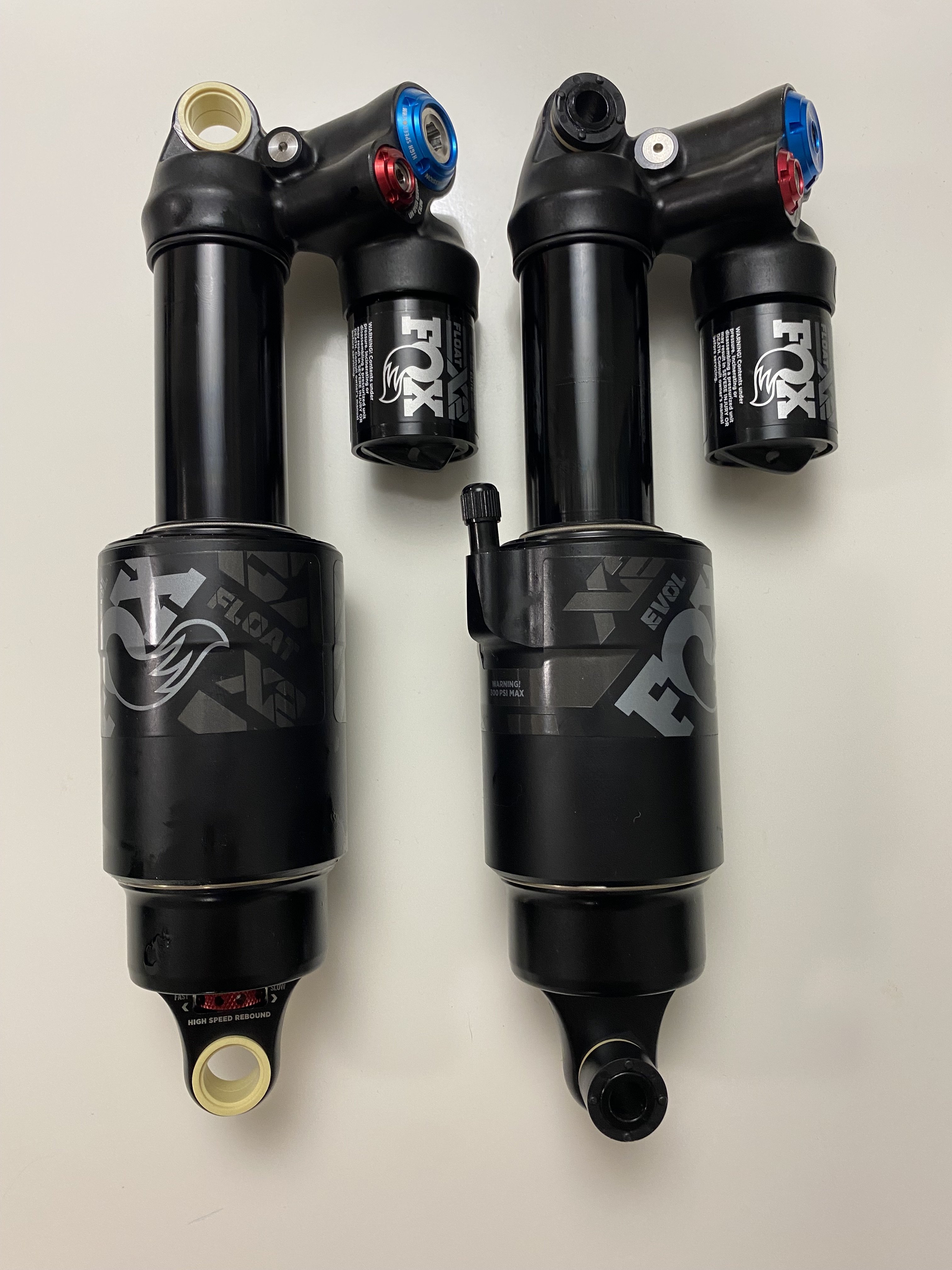

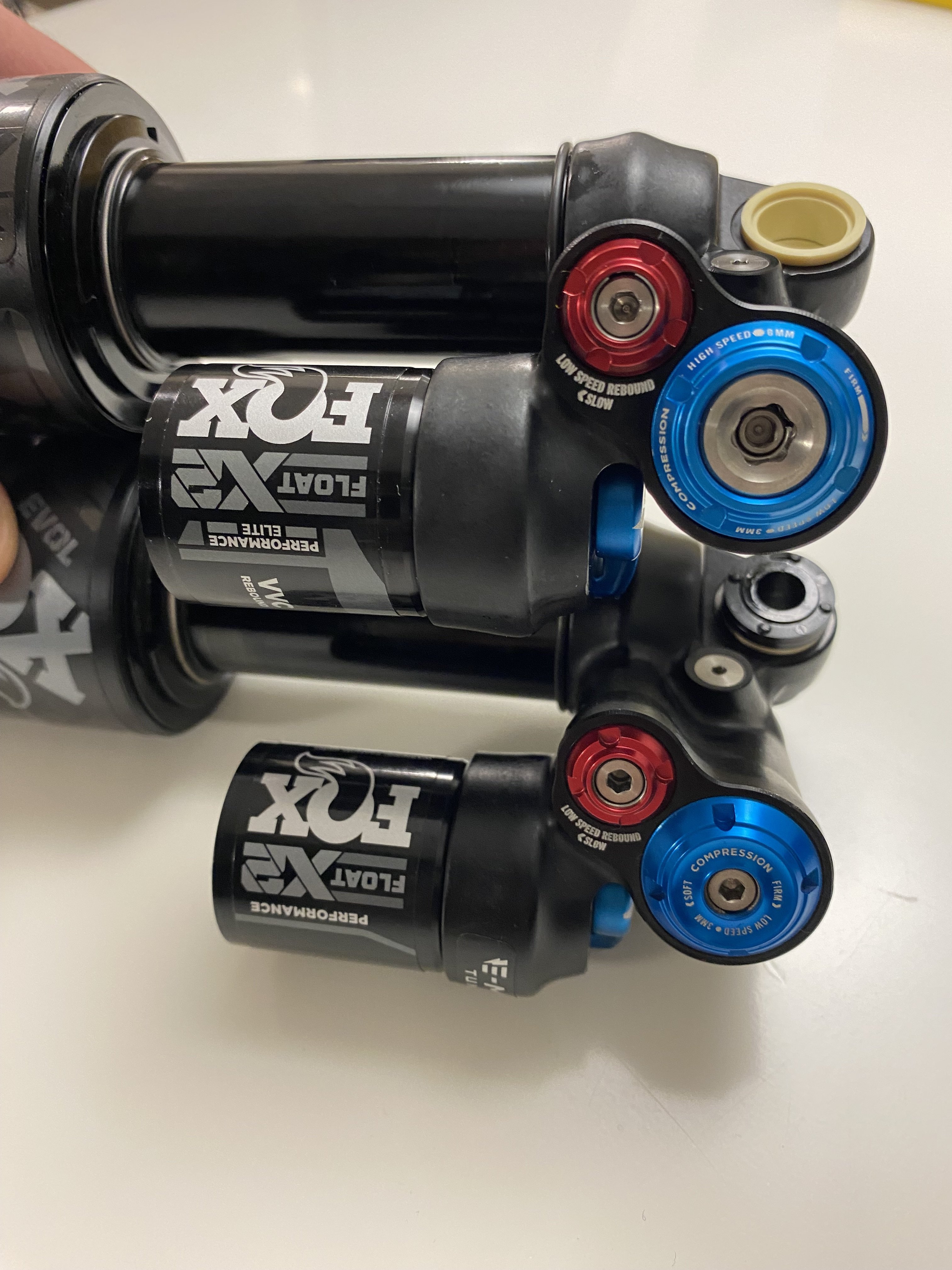

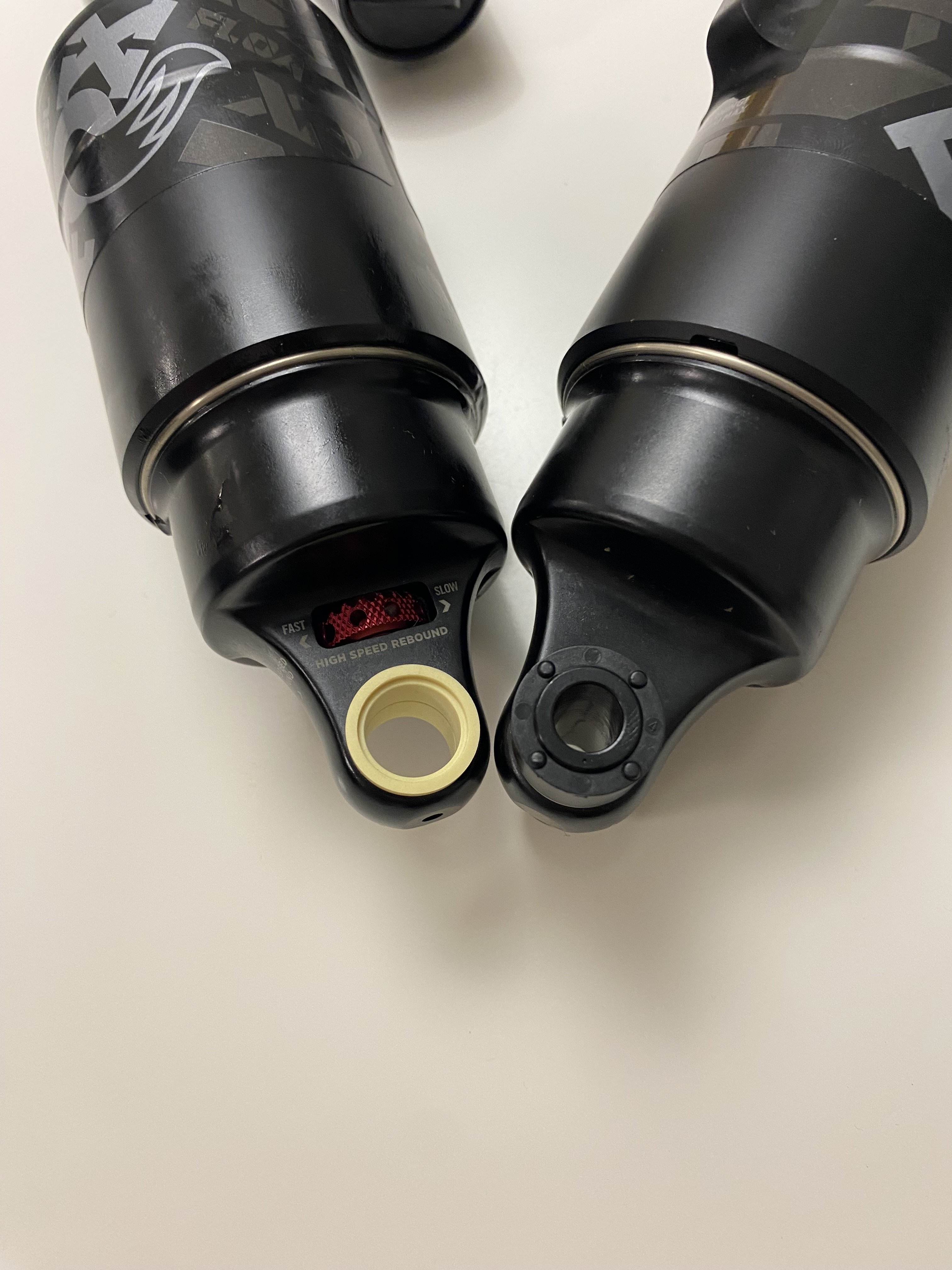

I had problems with my X2 right from day one; rebound not functioning correctly (too fast and adjusters made little difference) and sank into its sag way too easily which meant I was having to use way higher pressures to get correct sag. Contacted Silverfish and they said there’s been a bad batch from the US and mine sounds like one of those and that I should send it to them straight away under warranty and they will upgrade the internals to the 2024 spec.
It seems there’s kind of an unofficial recall on the X2 from 2021 - 2023 models and they swap out the internals for 2024 spec with no hassle. Apparently these fix all the know issues. I also asked them to fit the high speed circuit which they did at a cost of £99 so I’ve now got what is considered a factory spec model (complete with kashima shaft and factory decals). I know some people have had a direct swap out for a factory model with no cost, but it’s luck of the draw with what they have in stock. Regardless I was happy to pay the £99 for the ‘upgrade’. I’ve not ridden it on the trails yet but the setup in the garage feels like the prior issues are gone - time will tell.
Seems that there is couple others who have been struggling with same problem than me with Strive:ON CFR rear suspension.
Bike Strive:ON CFR in Size L
Rider 190cm and 88-90kg+3-5kg gear
Fork Fox 38 Performance Elite (same adjustments as Factory)
Shock Fox Float X2 Performance (lacks HSR and HSC asjustments that Performance Elite and Factory has)
I have very similar experiences that front feels almost spot on with suggested 99-102psi pressure but rear end with suggested pressures 199-210psi feels soft, loose and saggy. Rear shock needs like 230psi to be supportive enough but higher spring pressure requires more rebound damping. Seems that X2 Performance lacks HSR adjustment and shimming for rebound is not enough for those higher pressures.
Contacted Canyon local product support and they adviced to bring shock to local Fox dealer. Fox dealer told that problem is that shock is working as Canyon have specced (for lighter riders) and this isn’t warranty case. After that contacted to Canyon customer service and they told that they don’t take any responsibility of this issue and shock works as it should. 😁
Local Fox service was very helpful and they suggested to shim shock with new custom ”Factory Tune” when servicing shock. Price for service and Factory tune was 130€ which is reasonable.
I also asked price for upgrade from Performance to Performance Elite (=Factory without Kashima) with added HSR and HSC adjustments but price was around 300€.
I also check how many tokens front fork and rear shock has. Front fork has 2pcs tokens and rear shock has no tokens from factory.
2022 Performance Elite Series 38 FLOAT 29 170 Grip
Serial number: 1071603-0203-T
Part number: 910-35-744
Description: 2023_22, 38, A, FLOAT, 29in, P-SE, 170, Grip 2, HSC, LSC, HSR, LSR, Matte Blk, Std/Matte Blk Logo, Kabolt-X 110, BLK, 1.5 T, 58HT, 44mm Rake, OE
2pcs 10cc Tokens from factory
2023 Series FLOAT X2 2pos-Adj
Serial number: 1062029-0032-T
Part number: 979-00-692
Description: 2023, FLOAT X2, P-S, A, 2pos-Adj, Canyon, M158 - Strive On, 230, 65, CL001, RM, Rezi BV3, Standard, Neutral Logo
No tokens from factory
Seems that those codes means something like below but if there is any suspension gurus please fill list.
P-S=Performance Series
A=Anodised black
2-pos Adj=
230mm=distance C-C of eyelets
65mm=shock travel
CL001=Compression Light 001
RM=Rebound Medium
Rezi BV3=?

Modification from Fox Float X2 Performance to Performance Elite was as expensive as price of new Fox Float X2 Performance Elite shock so ended up ordering new shock. There is only a little difference in valving of new shock so need to find out how new shock will act. After test ride with new shock I will decide how to modificate shocks stock shimming or is it even needed with HSC and HSR adjustments.
2023 Series FLOAT X2 2pos-Adj​
Serial number: 1023974-0005-T
Part number: 979-00-868
Description: 2023, FLOAT X2, P-Se, A, 2pos-Adj, YT, Capra 29, 230, 65, CL, RM, Rezi CM, Standard, Neutral Logo
P-Se=Performance Series Elite
A=Anodised black
2-pos Adj=2-position lever (open/firm)
65mm=shock travel
CL=Compression Light
RM=Rebound Medium
Rezi CM=?(Rezi?, Compression Medium?)

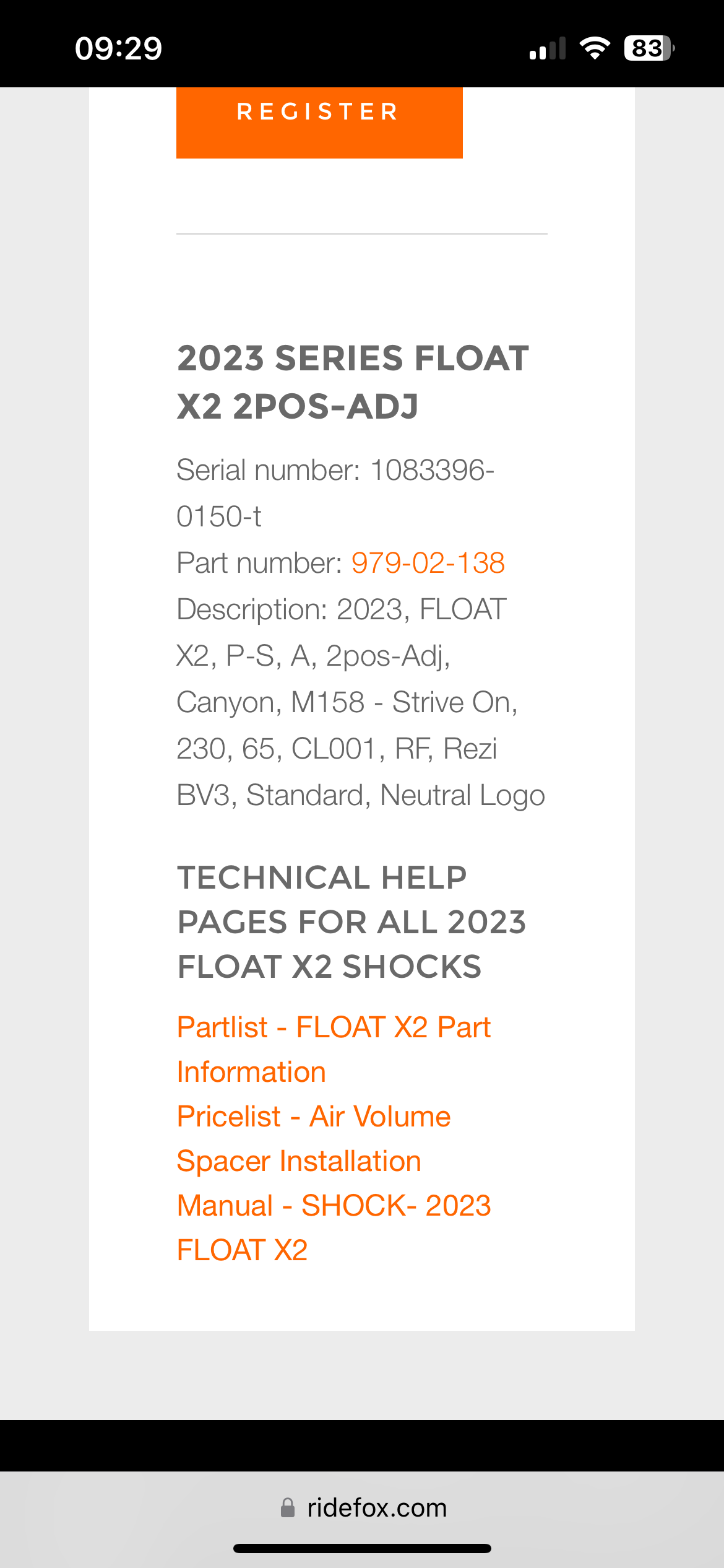

Not sure which shock you got but my 2023 X2 Perf that came with he CFR is RF or Rebound Firm
I have Strive:ON CFR in size large and it is delivered in mid June. What size frame you have? How it rides and what is your weight?
Could you share shock specs from Fox database and/or serial number? 🤔
Intresting if Canyon has different valving in different shocks but that could be reason why some of riders have been hard times adjusting rear suapension and others don’t.

Mine was delivered a week ago. large CFR with 725wh battery. Attached is screenshot I took of specs
@jxrx Strive:ON CFR (750wh or 625wh?) size L delivered 10/23​
Serial number: 1083396-0150-T
Part number: 979-02-138
Description: 2023, FLOAT X2, P-S, A, 2pos-Adj, Canyon, M158 - Strive On, 230, 65, CL001, RF, Rezi BV3, Standard, Neutral Logo
@ArtturiM Strive:ON CFR 750wh size L delivered 6/23​
I’m 96kg + riding gear so have set it to 225psi gives me about 30% sag. See how I go. Thanks for your info, I’ll keep an eye on it.
I think that RF=Rebound Firm can handle +200psi pressures and bigger rebound forces better than RM=Rebound Medium.
Intresting if Canyon has find out that rebound shimming is off and dialled rebound tune from Medium to Firm during these months.

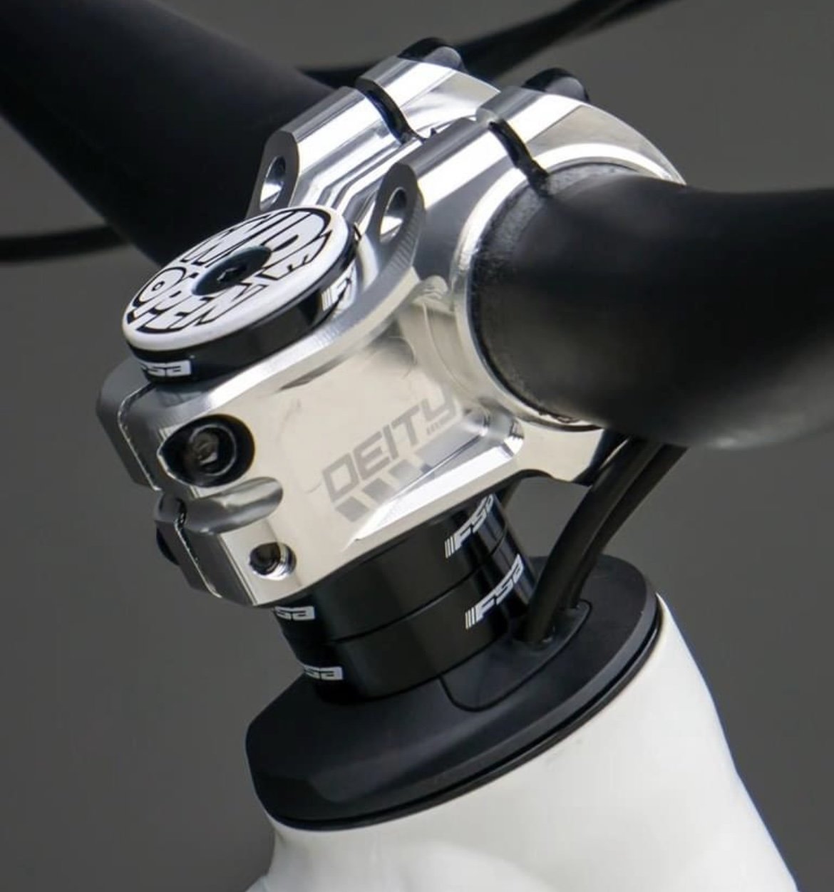

Another question. I saw a Deity post on IG and wondered if we would use round headset spacers on Strive would it look like this? More the first round spacer on top of the headset cover.

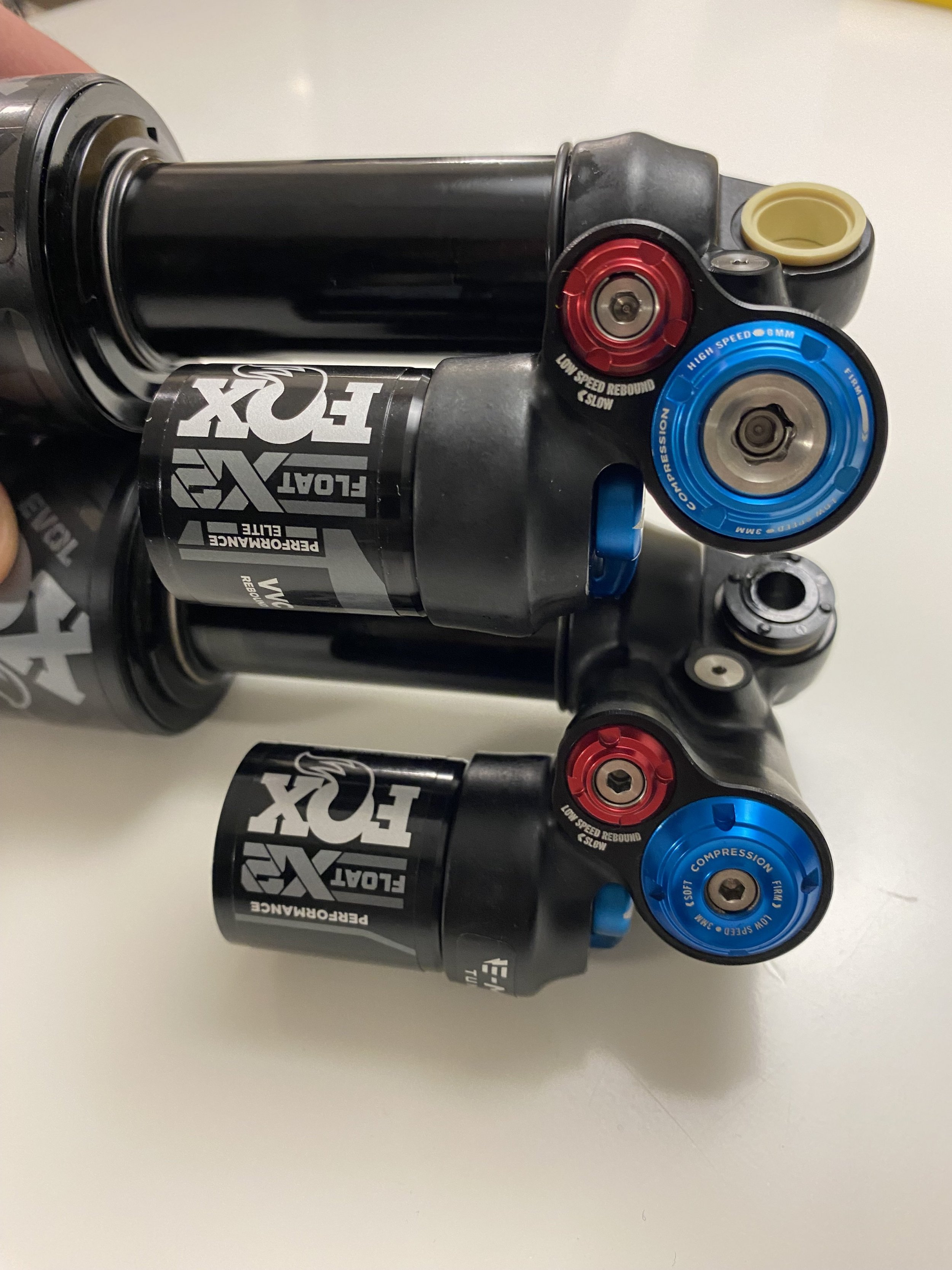

A=Anodised black
65mm=shock travel
RM=Rebound Medium
It looks like the CL001 is the same stack as the CL but with the smallest diameter shim changed to be a larger OD, which should stiffen the stack, how much I have no idea, Less than a CM.
New Fox Float X2 Performance Elite is here.
I will try it as it is with little different valving compared to stock shock and let’s see is shimming needed.

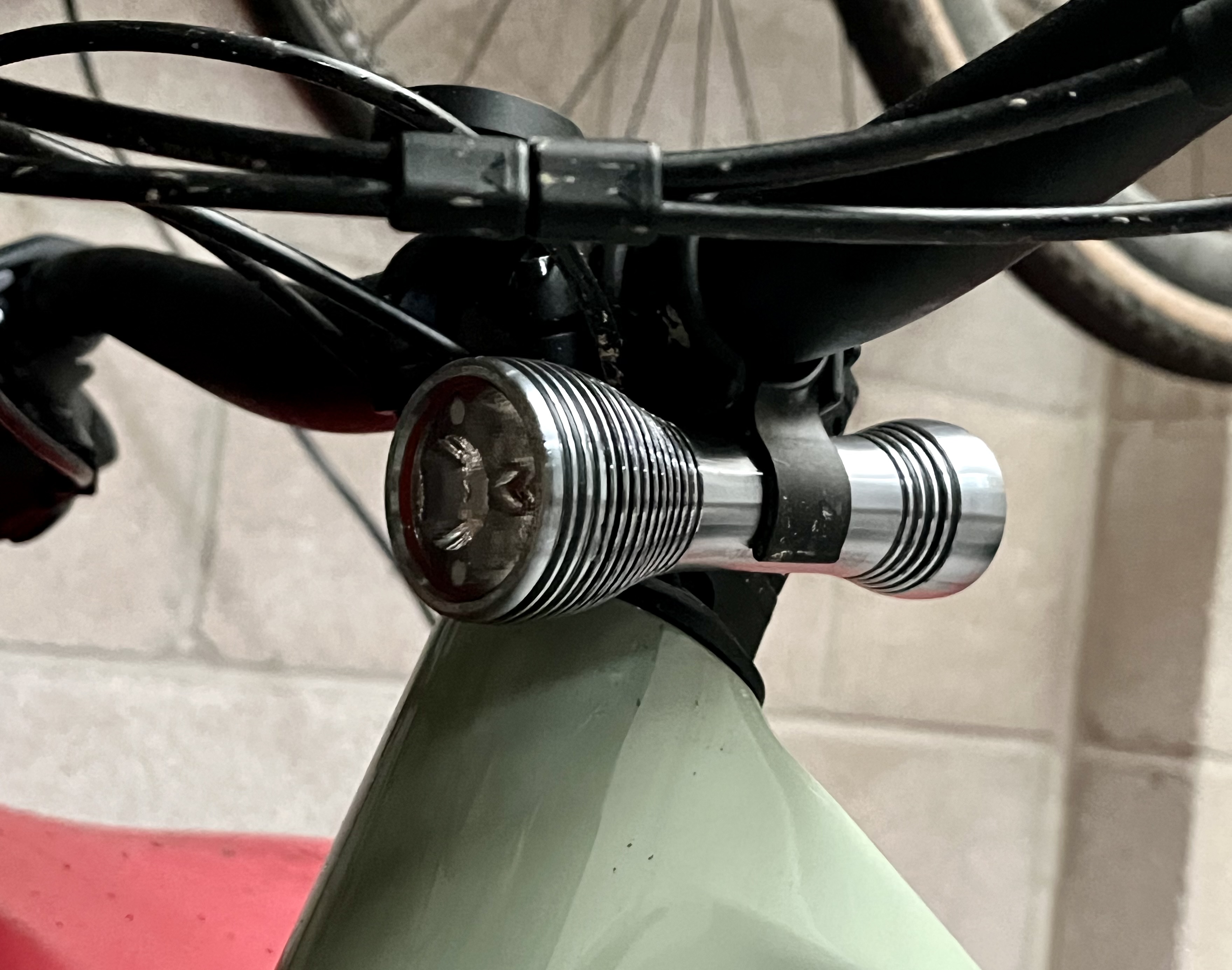

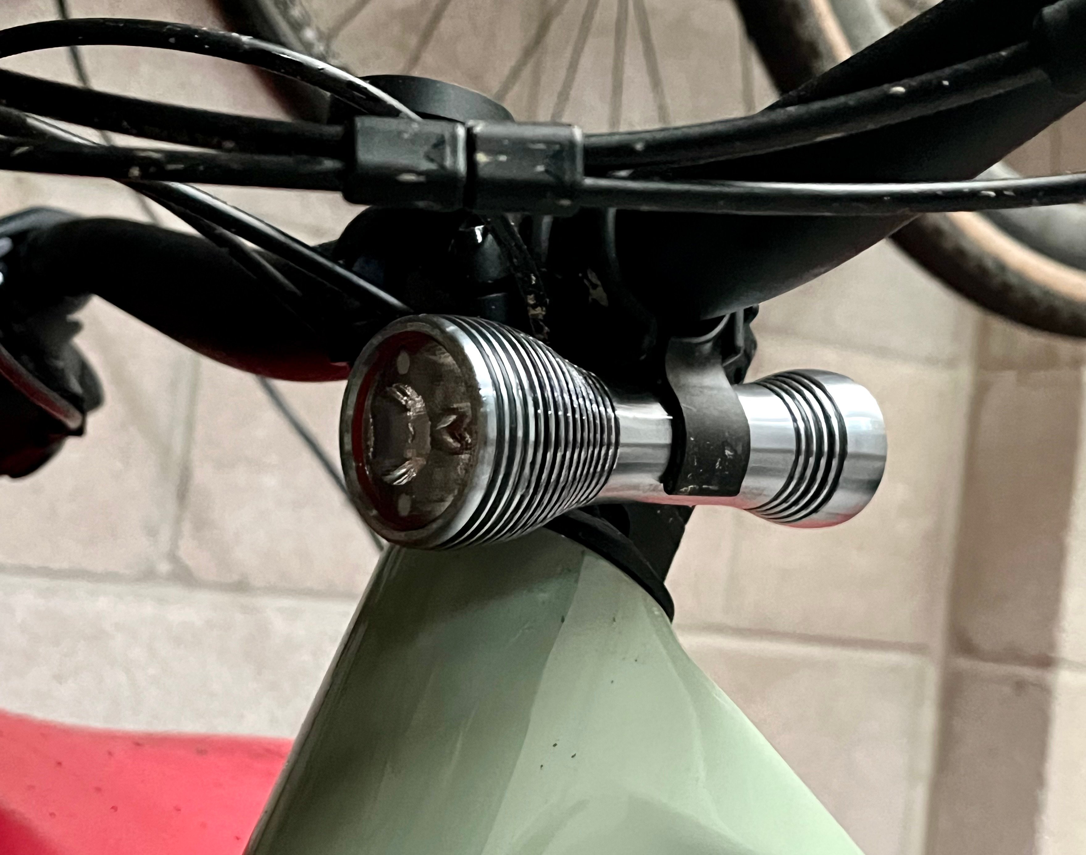

Finally got myself a decent front light setup! I can finally get out on a night ride. Been wanting to do this for a while now. Interested to see if helmet or bike mounting is best. Currently setup below the bars but likely move it to the top as not sure if the clearance is great in the event of an off. Can’t wait to get out on a night ride!
View attachment 129287 View attachment 129288
I Love night riding. Typically have a bar mounted light of 1500 lumens and a helmet light of 1000 lumens. More on the bars could be nicer but this works very well. Have fun!!
Edit: Oh bar light has a wider light throw/spread to light the general trail. Helmet light is more spot to see where you look. Hence both. Check out Light and Motion lights for a light weight 1000 lumen helmet light without cables.
One thing I did wonder is if canyon could’ve put a usb port to allow lights and Garmin etc. to be charged or powered as we use them
