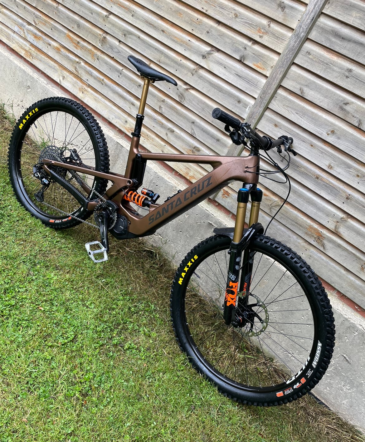

Few more upgrades for my Bullit. 2022 Fox Factory 38s, Factory Transfer post and a Factory DHX2 with SLS spring.
Also fitted new XTR brakes, a Burgtec MK3 stem and MK5 pedals and Santa Cruz Di2 bars. Just waiting for XTR gears to come back into stock then I think i’m done!

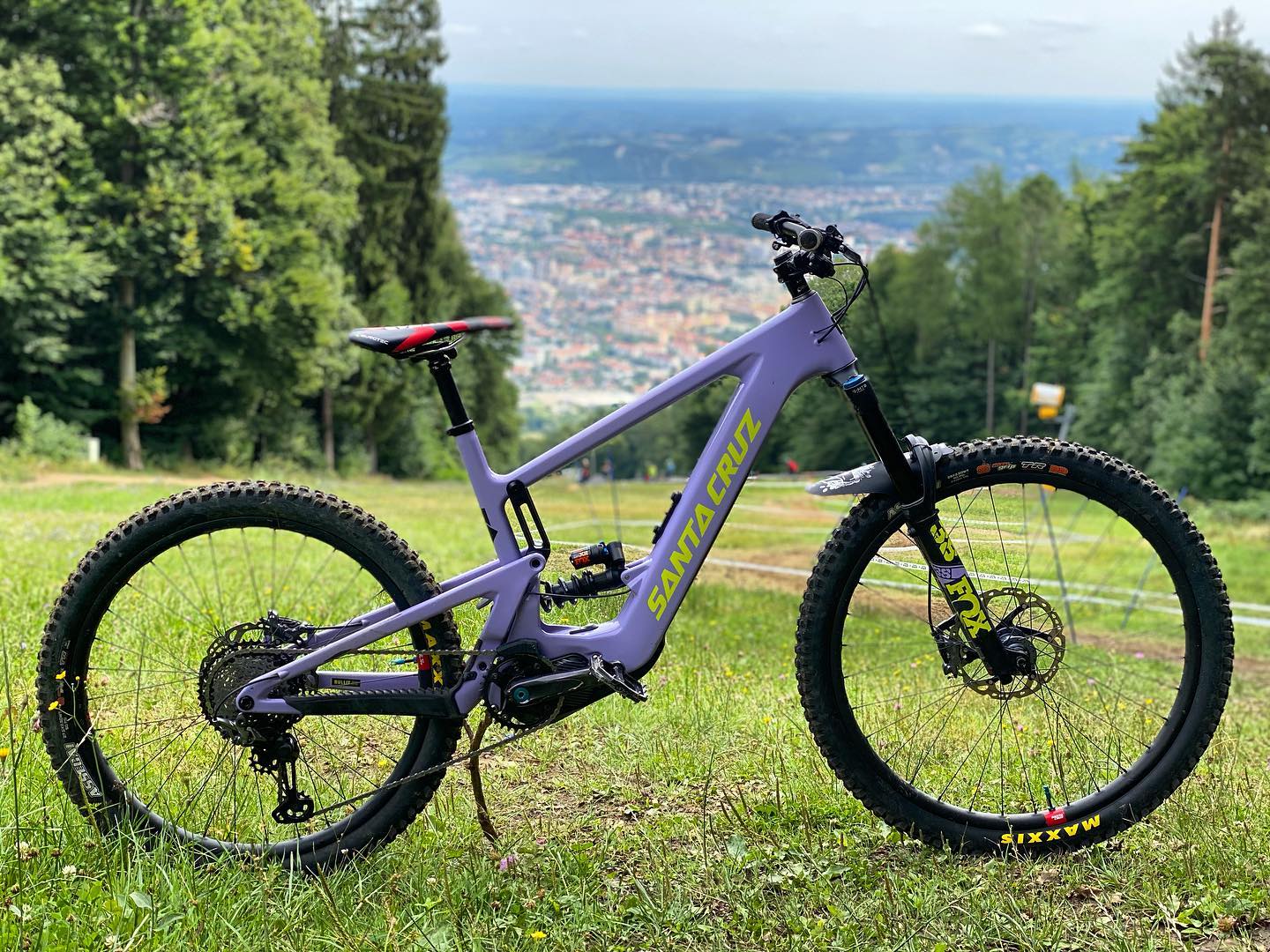

Steve Peat's Bullit at Maribor. I kind of start to wish that Bullit came with Fox DHX2 from factory to match the Fox 38. Also, I think Fox SLS spring would be quite a bit lighter than the one that comes with Super Deluxe Coil.

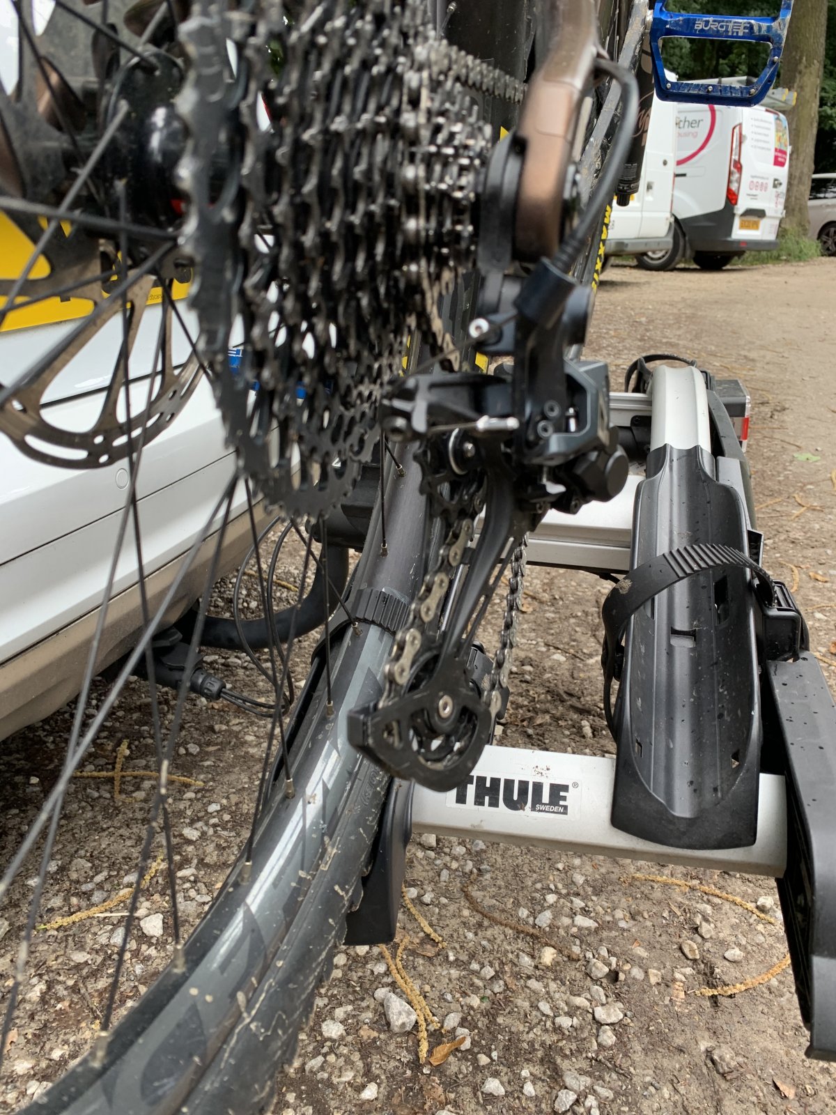

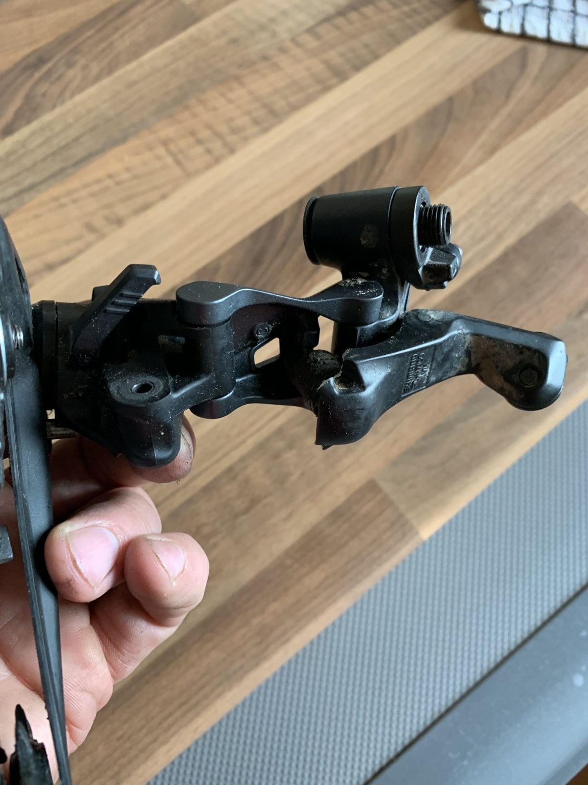

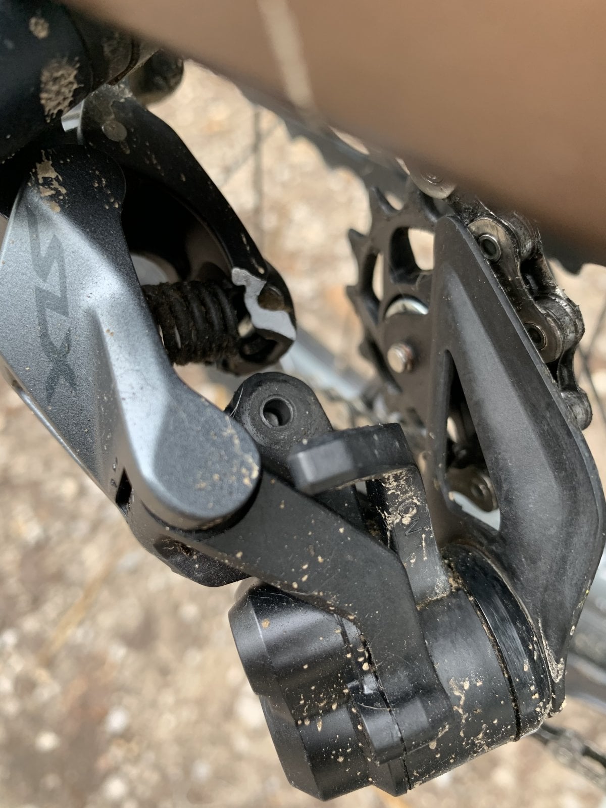

Went to Wharny today to give mine a test ride & another disaster ? got 500 yards out of the car park went to pedal & crunch, mech has destroyed itself snapping the body. No rocks or branches to hit it just flat fire road, didn’t change gear so god knows what caused it. Never seen a mech fail like that.

Sorry to hear about your motor problem, haven’t had mine back into shop yet was going to see how it went today. Will put the Sram mech back on that came with the bike and try again.
Never heard of that… You must be so p****d ?

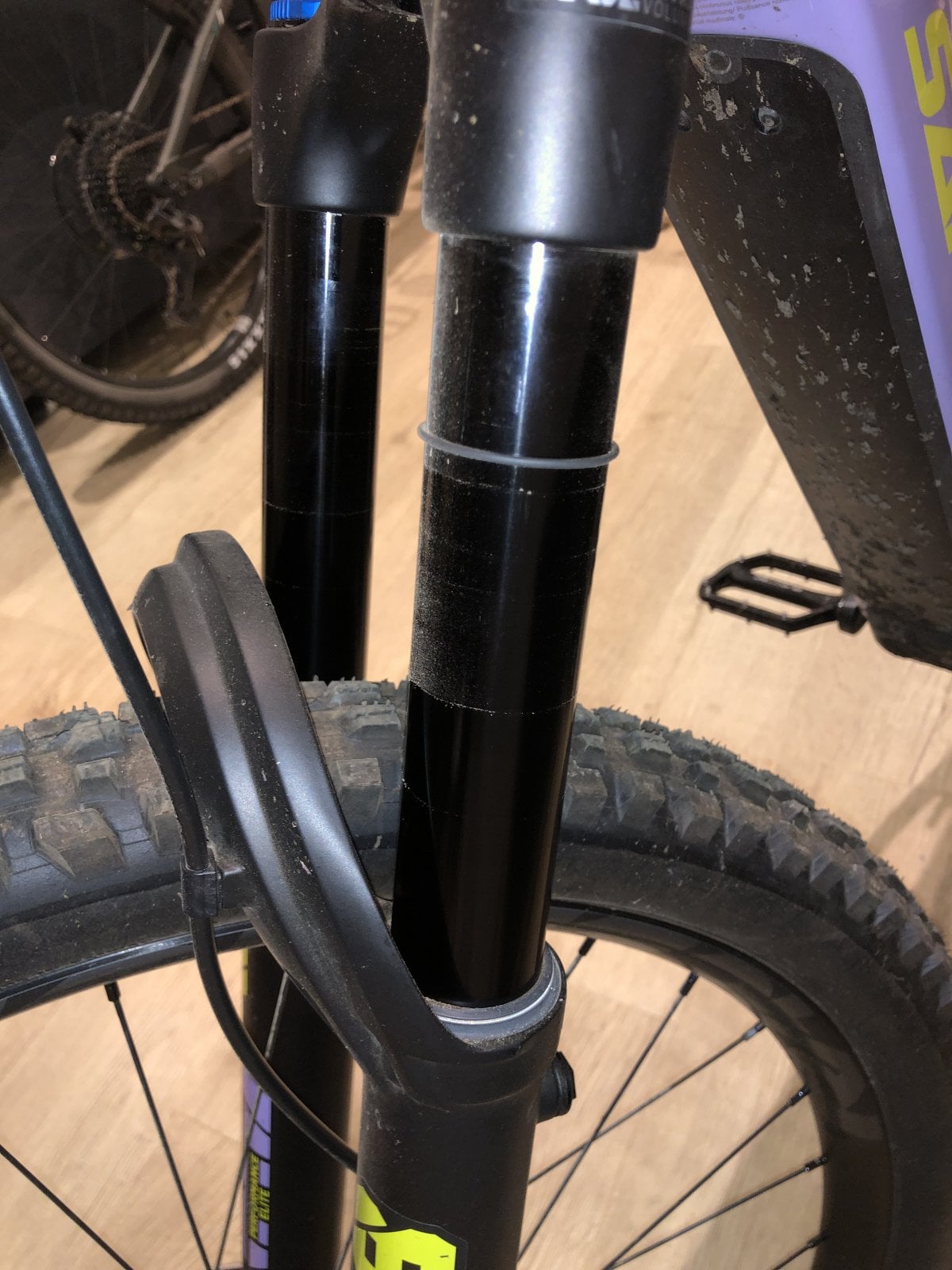

hey guys !
stoked new Bullit owner here !
after riding my local trials etc I find I could do with the forks being a little plusher if I’m honest , set the sat stood up in attack position at 51mm (30% of 170) and I’ve got a fair bit of travel left…. What’s the best setting for a plush feel and to use more travel ? Anyone tried playing with the tokens ?
Any help would be mega ⚡
jbrown15
May 27, 2020
812
681
Chilliwack, Canada
hey guys !
If you set the sag correctly and have that much unused travel try removing all of your tokens.

hey guys !
I'd remove both tokens and aim for no more than 25% sag. At 30%, you're going to be sat in mid travel and it will feel worse .
