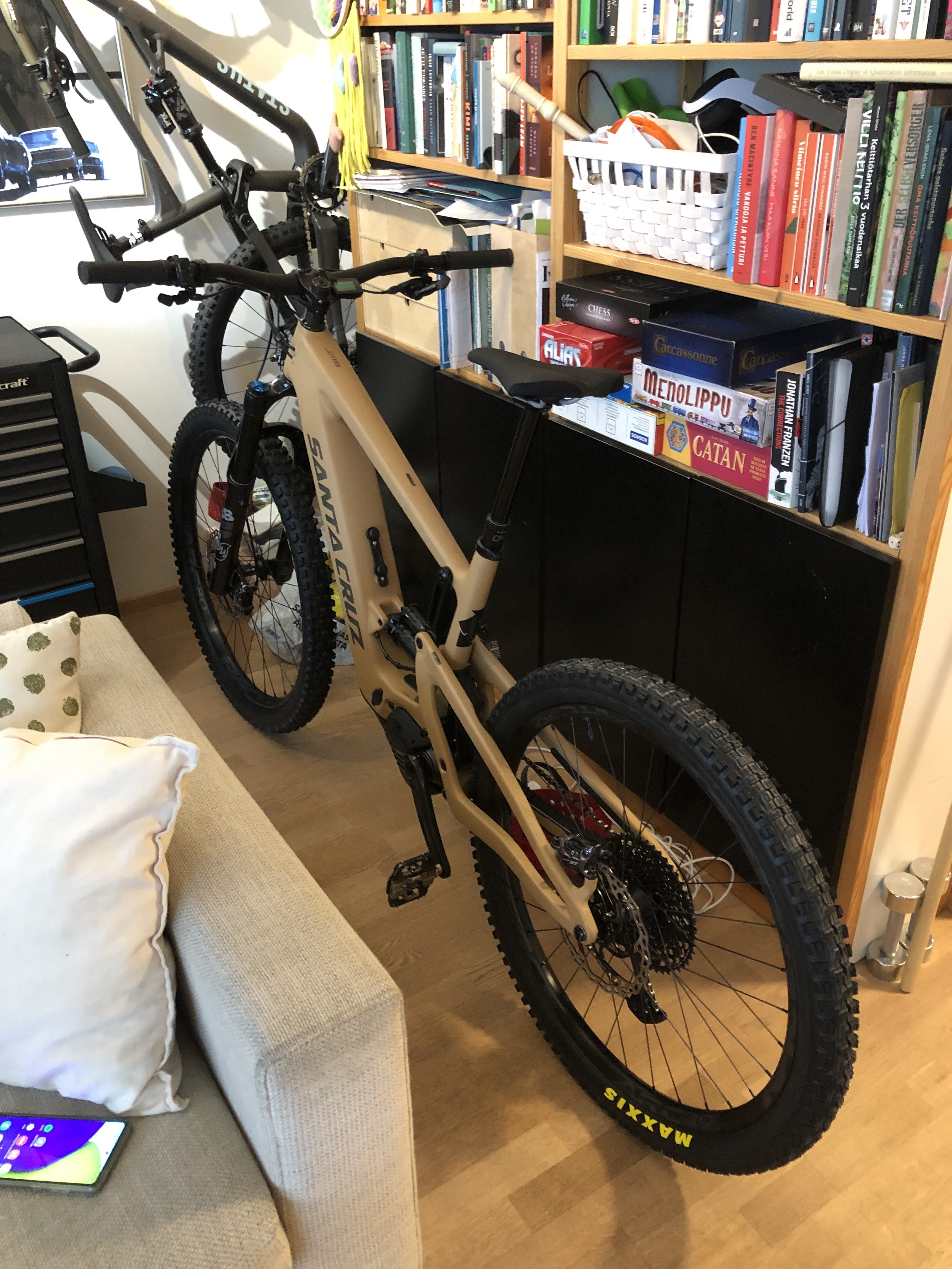

Got my Bullit finished today. Picked it up from LSB on thursday after toooooo long wait because of harbour strikes here in Finland. First bike I build from the box, nice way to spend weekend 😀. Totally stock S-model, only mods are brakes because I don`t like Codes and they don`t like me. And some dyedbro protection. I think otherwise the spec is perfect for me. Wasn`t sure about the colour but after watching it whole weekend I like it. I sold my Levo already few weeks ago and can`t wait to ride this but weather is really shit now, maybe for whole week, so we`ll see when that happens.

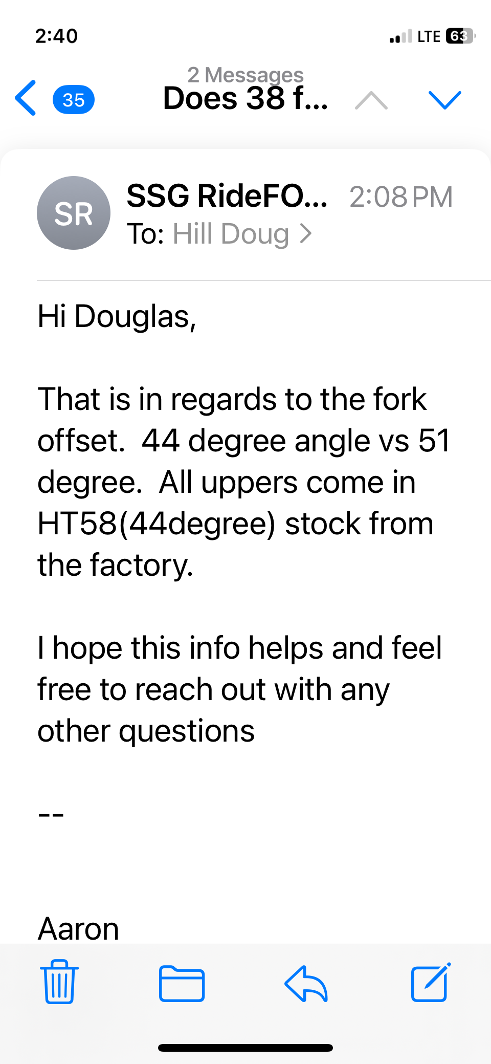

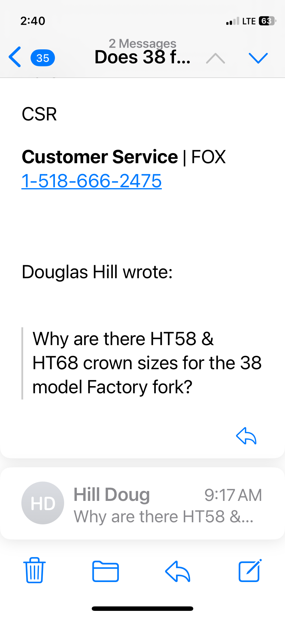

Hello everyone!
I would like to buy a Fox 38 fork for a Bullit (currently a different fork installed): There is the 38 with two different crowns, one "normal size" HT 58 and one for e-bikes (with a thick head tube) HT 68. Anyone can say or measure which crown is installed as standard? The e-bike crown HT 68 should survive a bit?
Thank you and best regards

Hello everyone!
Philip
As far as I know Philip Fox only supplies one version now and also did away with their original “e-tune” of the damper as well.
Right, the e-tune ended, but there are two different crown-diameters, HT58 (58mm) or the bigger HT68 (68mm). Witch one is the Bullit-standart?
Mine is a 2022, had the larger one (updated now to 2025 internals)… I wonder if Fox has incorporated that into all forks? I suppose one could go to LBS and measure 38’s on a new model, non ebike?

Dies ist die Antwort von Fox auf die Frage, siehe Anhang:
[Anhängen]151729[/Anhängen] [Anhängen]151730[/Anhängen]
This is what an employee of Santa Cruz Sales Germany told me:
"I have received feedback from production and it is indeed the case that, according to the current production status, we are installing the HT68 variant in the Bullit."

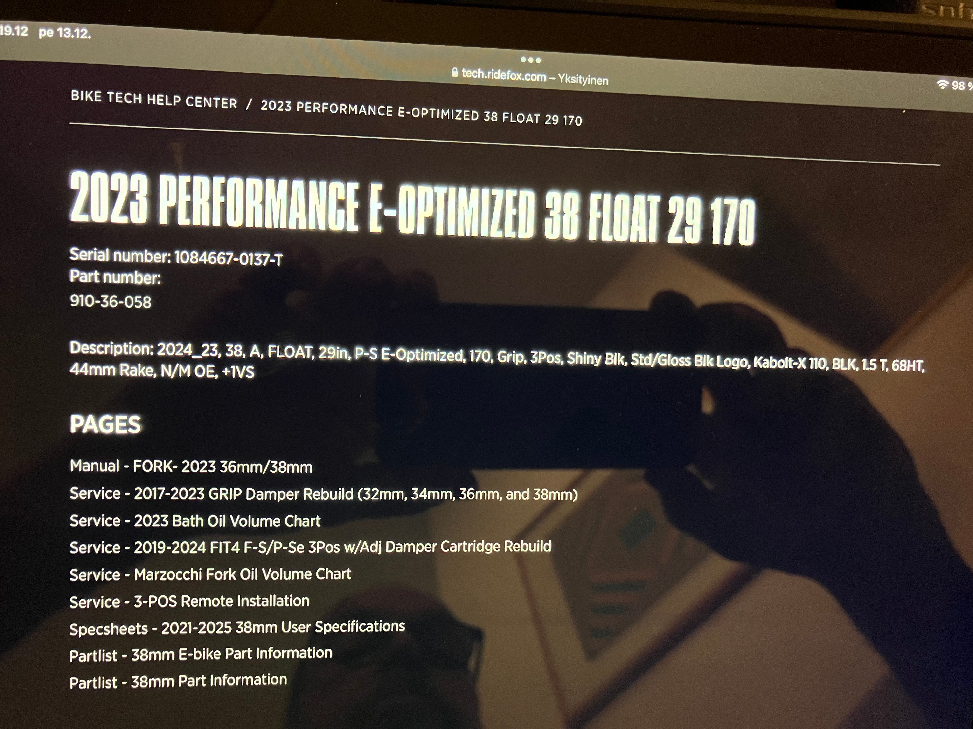

I think it's weird that they are installing forks with more rake for Bullit because it makes steering faster.... Also bit weird that rake measure is dependent of crown measure...anyway, maybe I check my fork when I have time. I know that SC has different token specs on Bullit forks than standard. I wanted to take some tokens off because as light guy, I couldn't use all the travel. I checked from fox page that in e-tune fork there's 3 tokens as standard. It was suprise that there was 4, no wonder I couldn't use all the travel :p
This is my Bullit fork, so HT68 and 44 rake. What ever you buy, buy it with 44 rake 😀

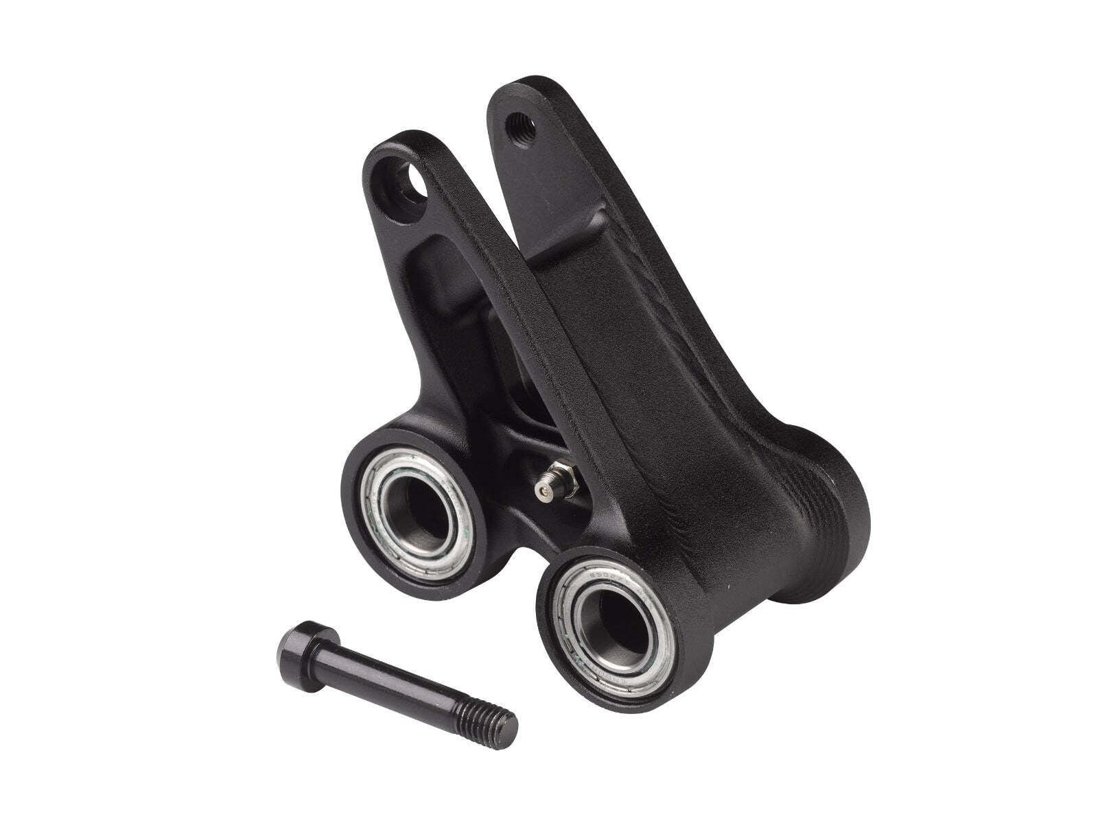

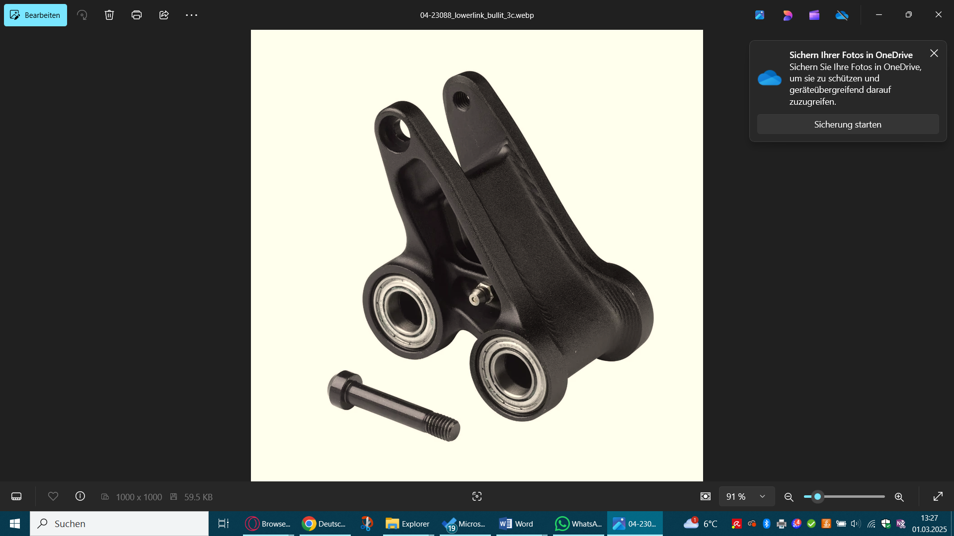

Hi,
I look for a Santa Bullit Lower Link, anyone would sell one (used or new)? I am also interested in the Cascade Link - Version...

Hi,
I look for a Santa Bullit Lower Link, anyone would sell one (used oer new)? I am also interested in the Cascade Link - Version...
They deliver to EU.
