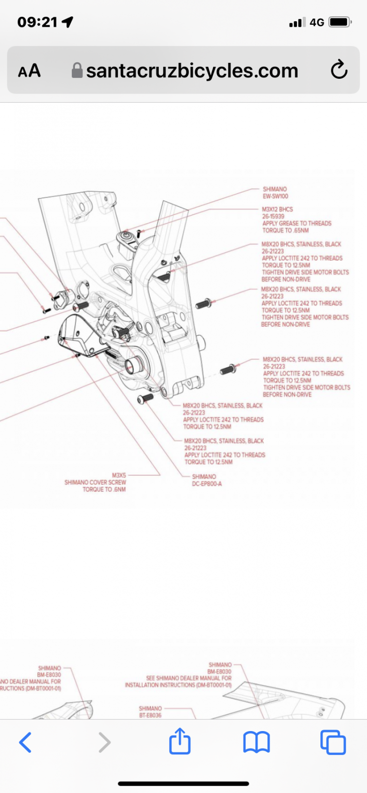

Does anyone know if EP8 Dealer Manual torque spec (10-12.5NM) for motor bolts apply to Bullit or if Santa Cruz has specified something else?

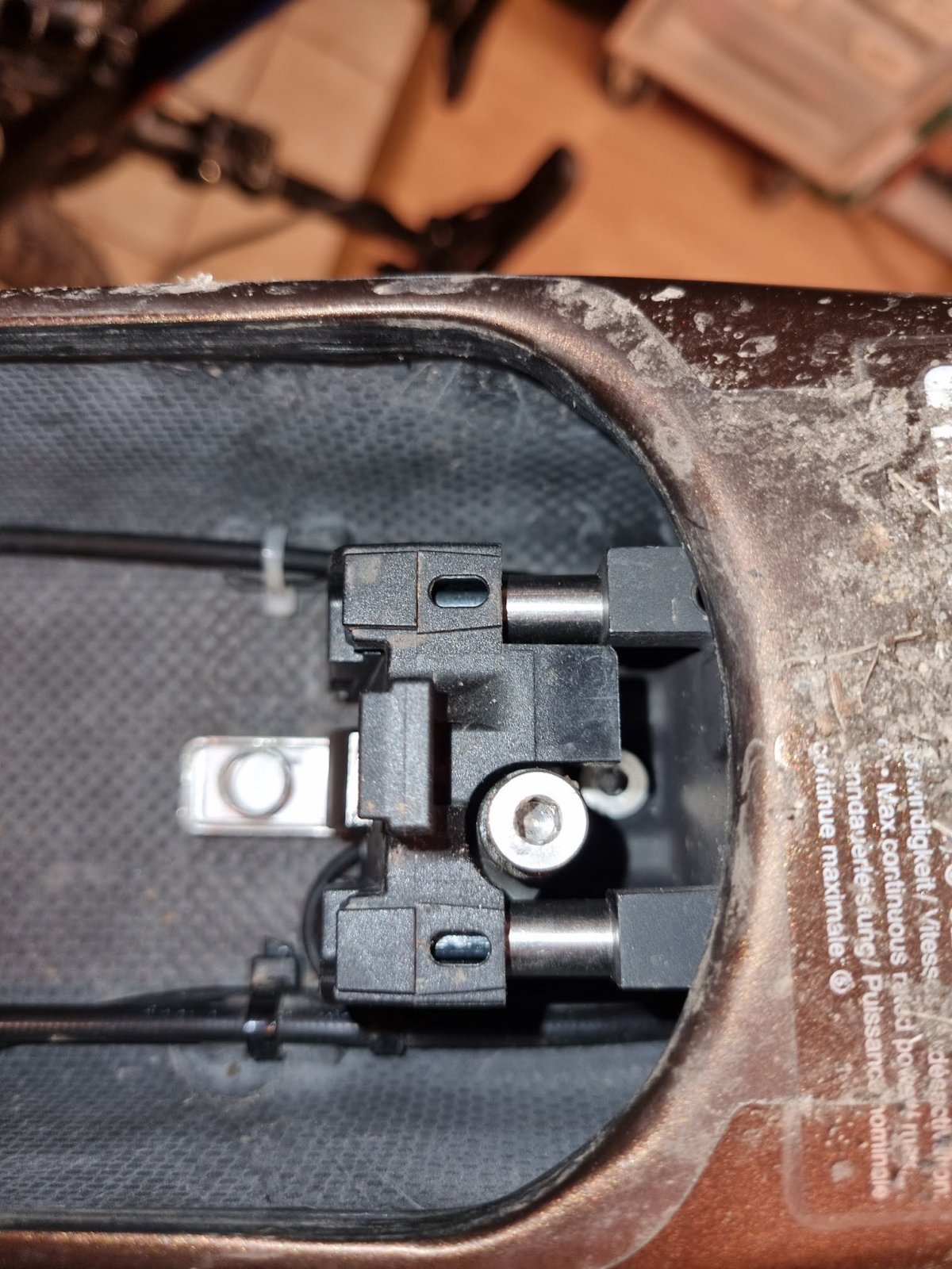

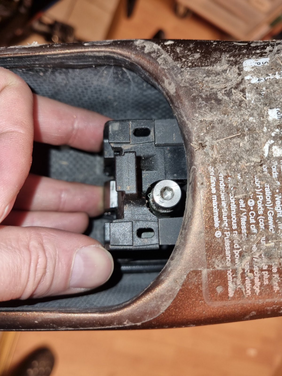

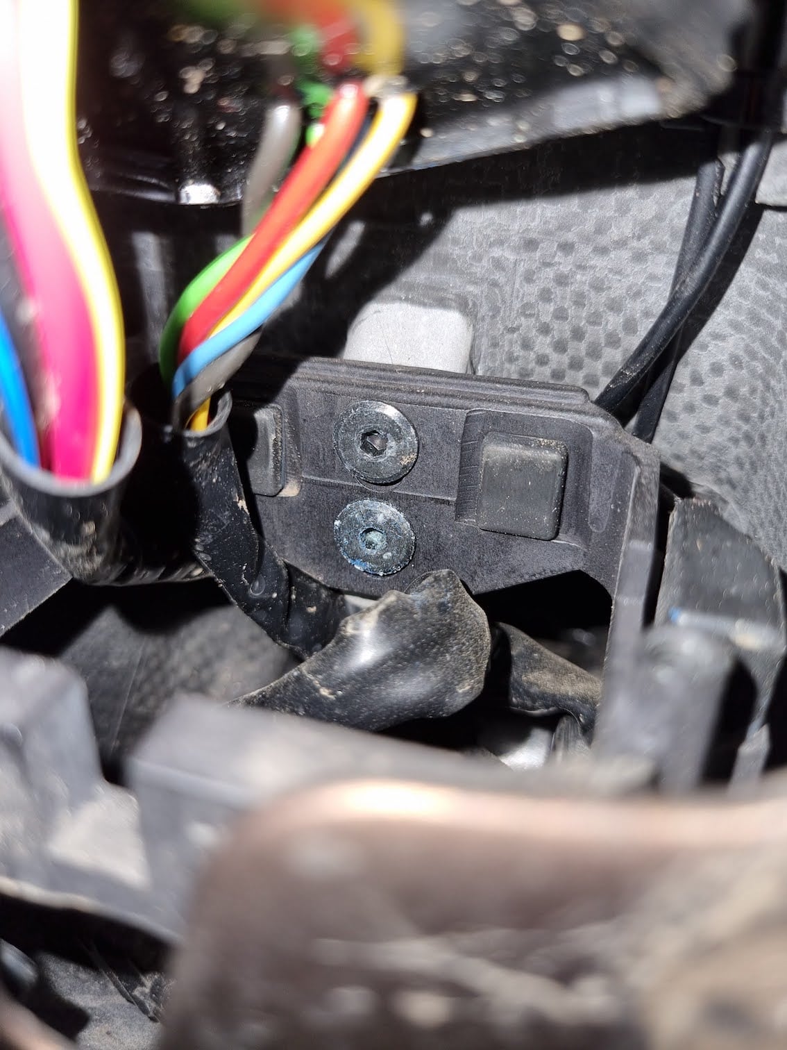

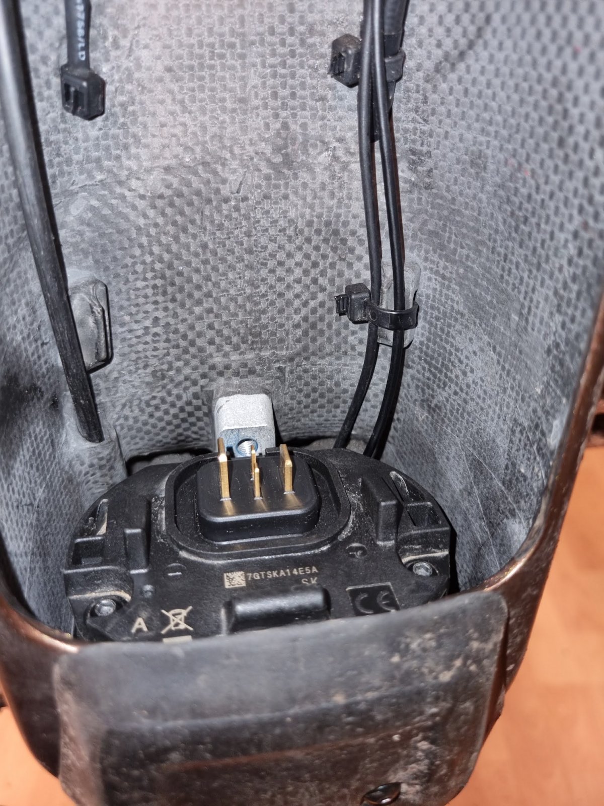

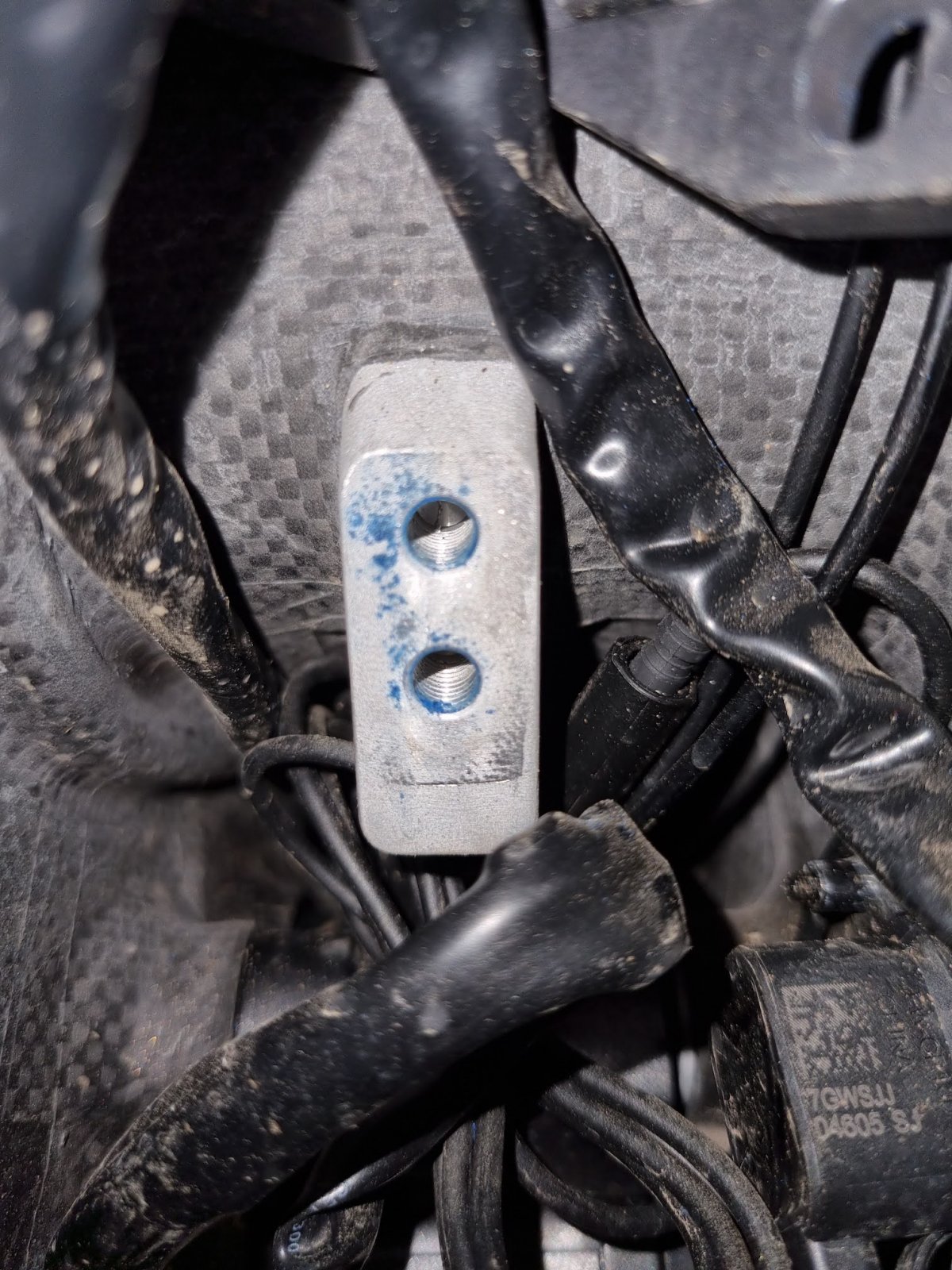

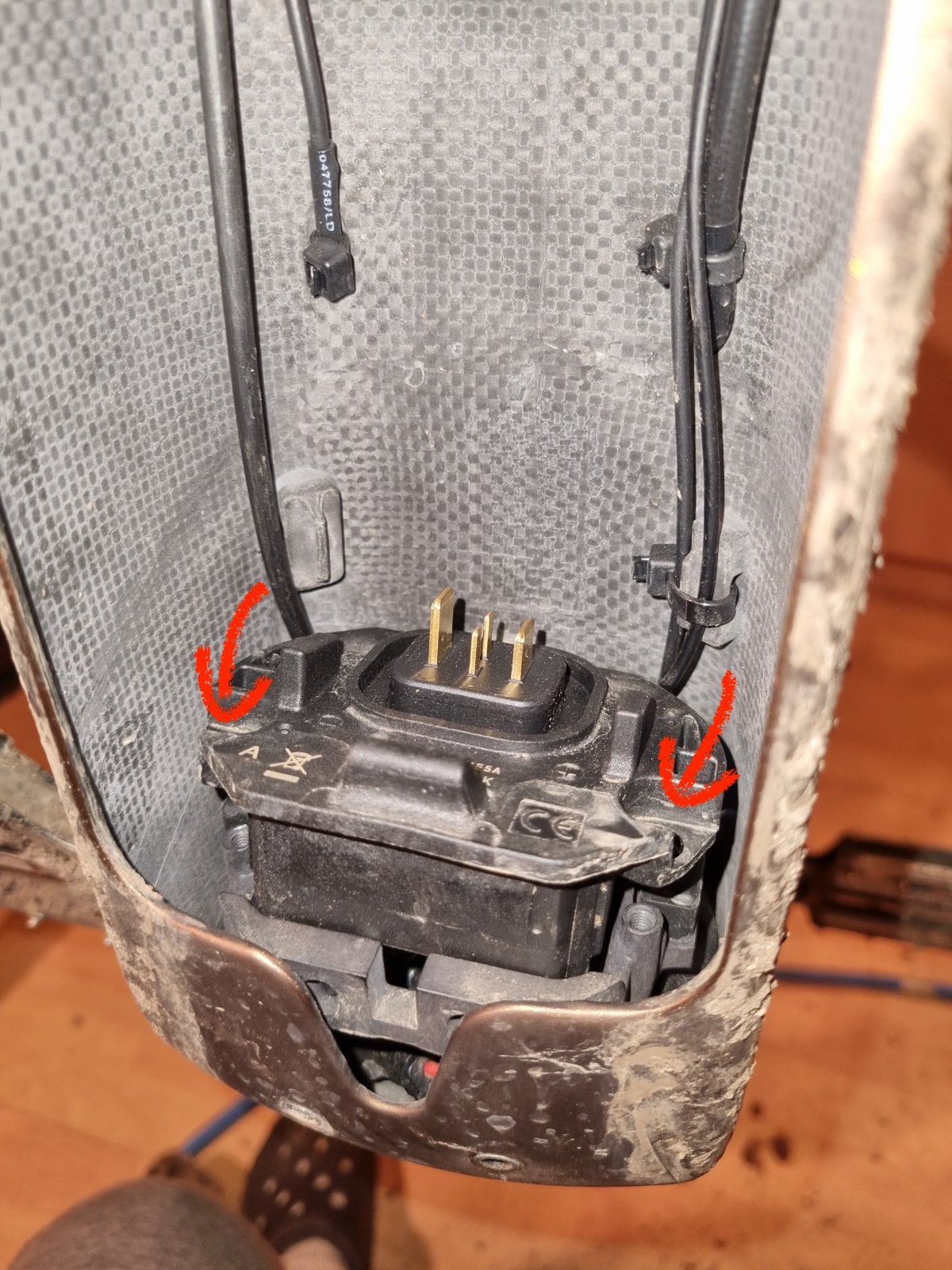

Hello folks

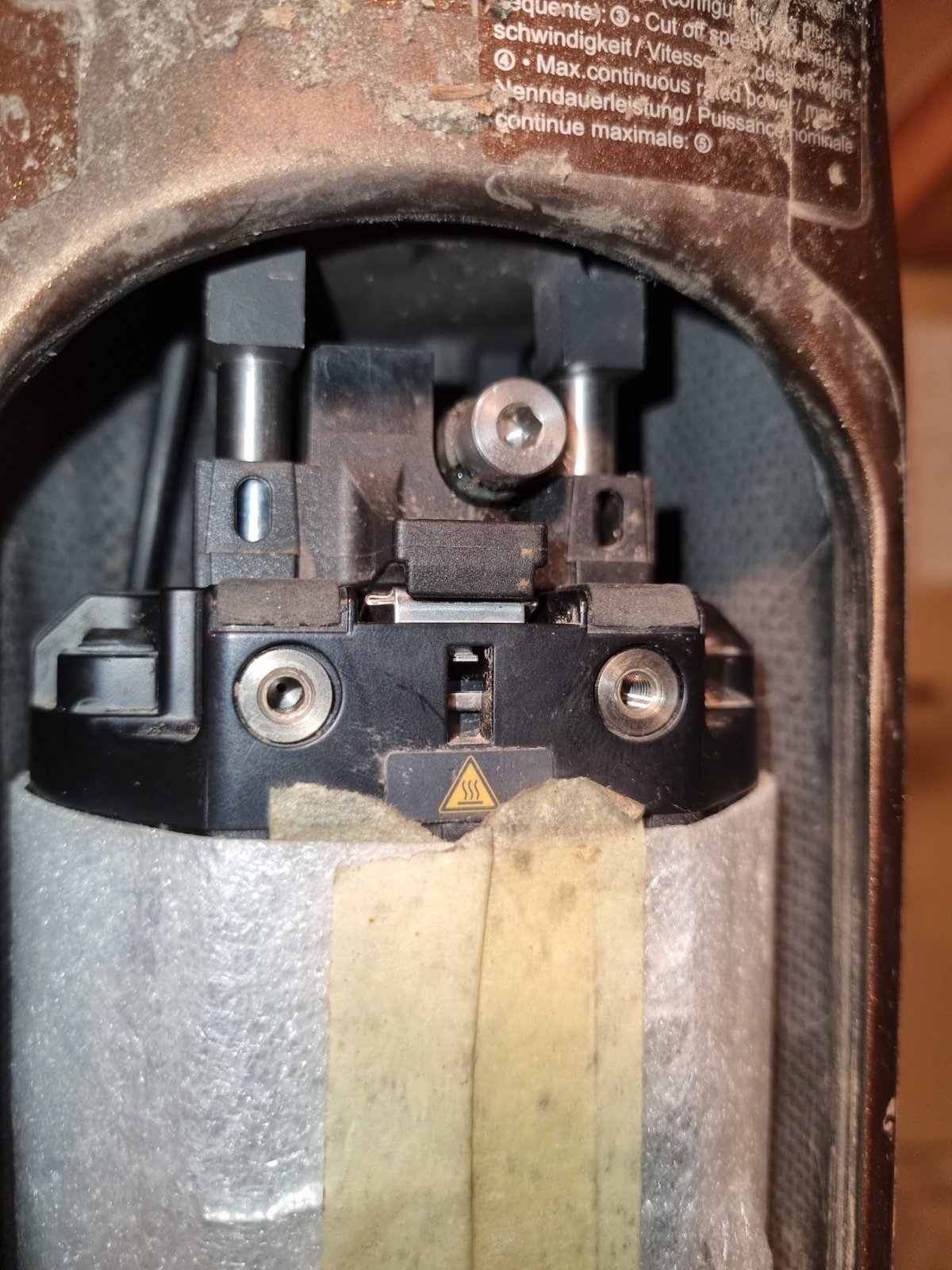

After separating the battery cover from the battery (which works perfect since day one without any hassle), I'd had the idea to move the battery's position a little bit more down in the frame, as I saw some unexplainable space below the battery.

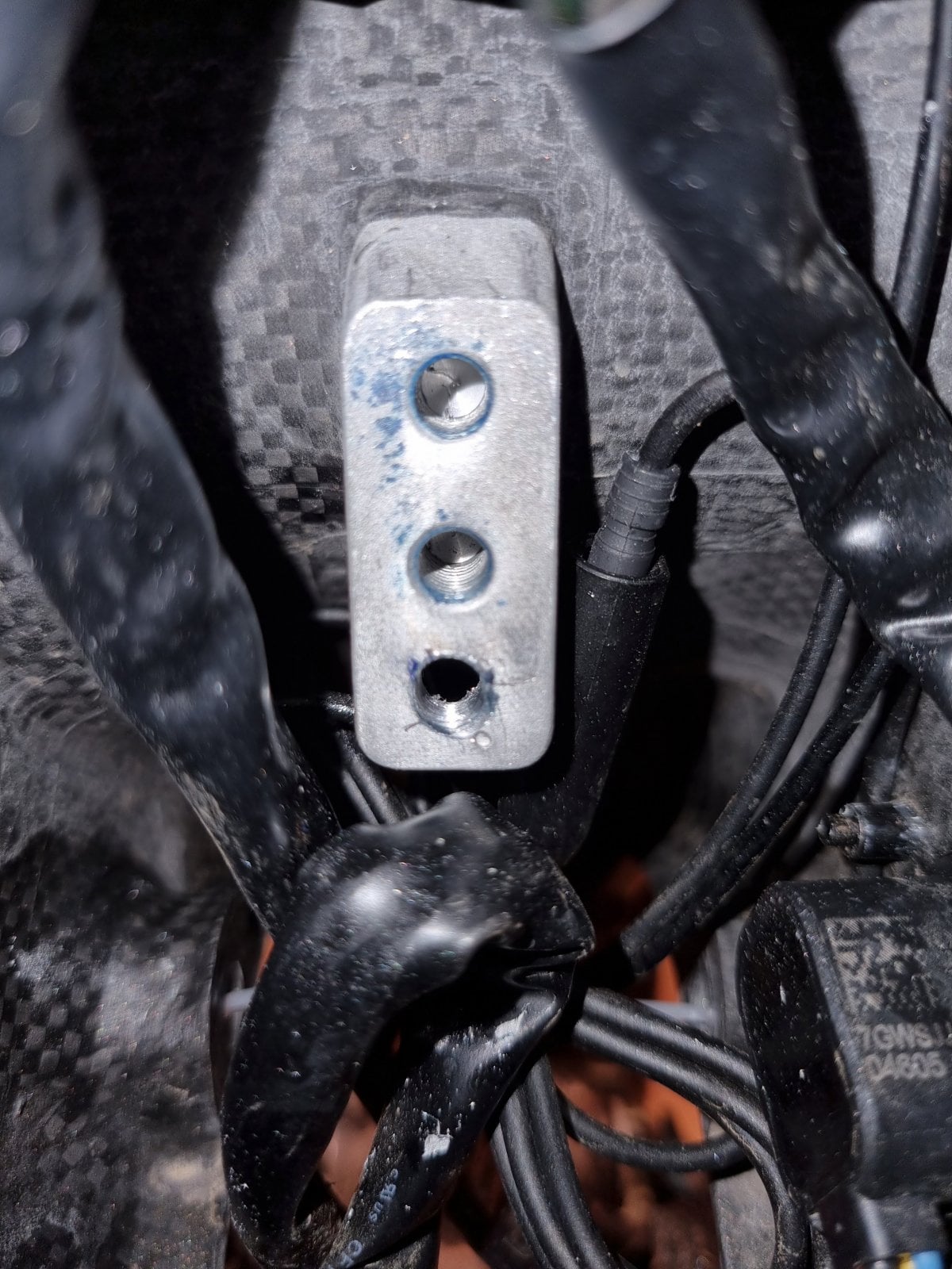

After disassembling the battery and loosen the two bolts of the battery "base plug", you can see the fixation of the battery carrier. It's a small aluminium frame screwed to a aluminium piece, that is laminated into the frame.
Than you can drill a third M6 hole. Unfortunately mine is a little bit to high, but anyways.
Now you can screw the carrier around 12mm below the original position. Together with some bushings and longer screws on the top, the whole battery sits now 12mm lower in the frame.
First test drive shows, that you can feel a little bit more agility. Even if I subtract a little bit imagination from my impressions, it's still significant. 12mm lower center of gravity of a 3,6kg block should make some (small) difference.
This is an advanced hack with chipremoving processing. So everything on your own risk.
