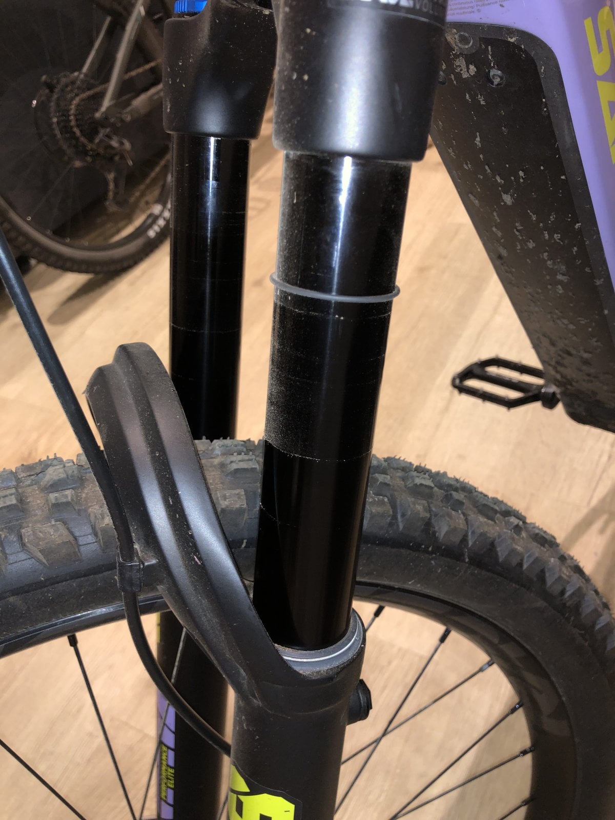

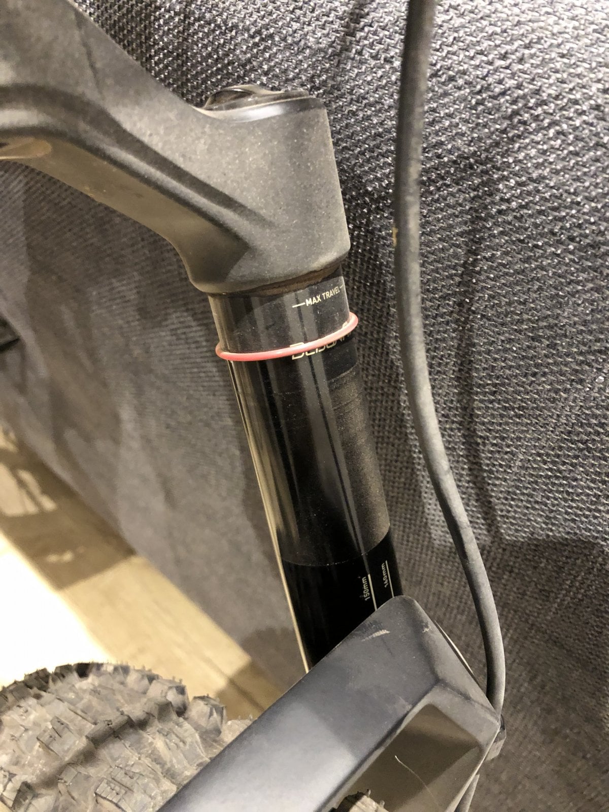

I did question if I should be using more travel on such a rad bike on my local easy trails / jumps and shoots …. So I’m 80kgs in riding kit, I’ve dropped to 1 token and I think pressure is about 85psi to get me at 20% sag …whats best and what is the benefit to running no tokens ? Will it make the fork plusher with out any ?
this is where they ended up after my first hours riding with STD settings …. They just felt a tad harsh up the higher end of the travel where I had pushed them to.
regarding rebound . You said there super slow so would that not mean you need less rebound to speed up the return of more rebound to slow the return to match the slow down stroke ? …. Sorry if I sound dumb lol

Thanks so much for the insight !!
Sorry for not saying before, but I for one have never got the marker up there with my setup that’s quite close to Fox’s advice — well, except that time I completely f***** up a massive compression into a bomb hole thing at 35kph. Now, I don’t jump 10m gaps (????) or drop 3m to flat (more ???). So, yes, my Bullit is more bike than I’ll ever need. But that’s not my point. You using that much travel on the trails you describe is genuinely hard for me at least to understand if everything is as you’ve described… maybe something isn’t working? I’m no specialist, maybe somebody can help diagnose what’s going on… Also, have you carefully followed all the advice starting at the first post in this thread from @Gary which is getting mention a bit just now Suspension set-up guides and info - EMTB Forums ?
