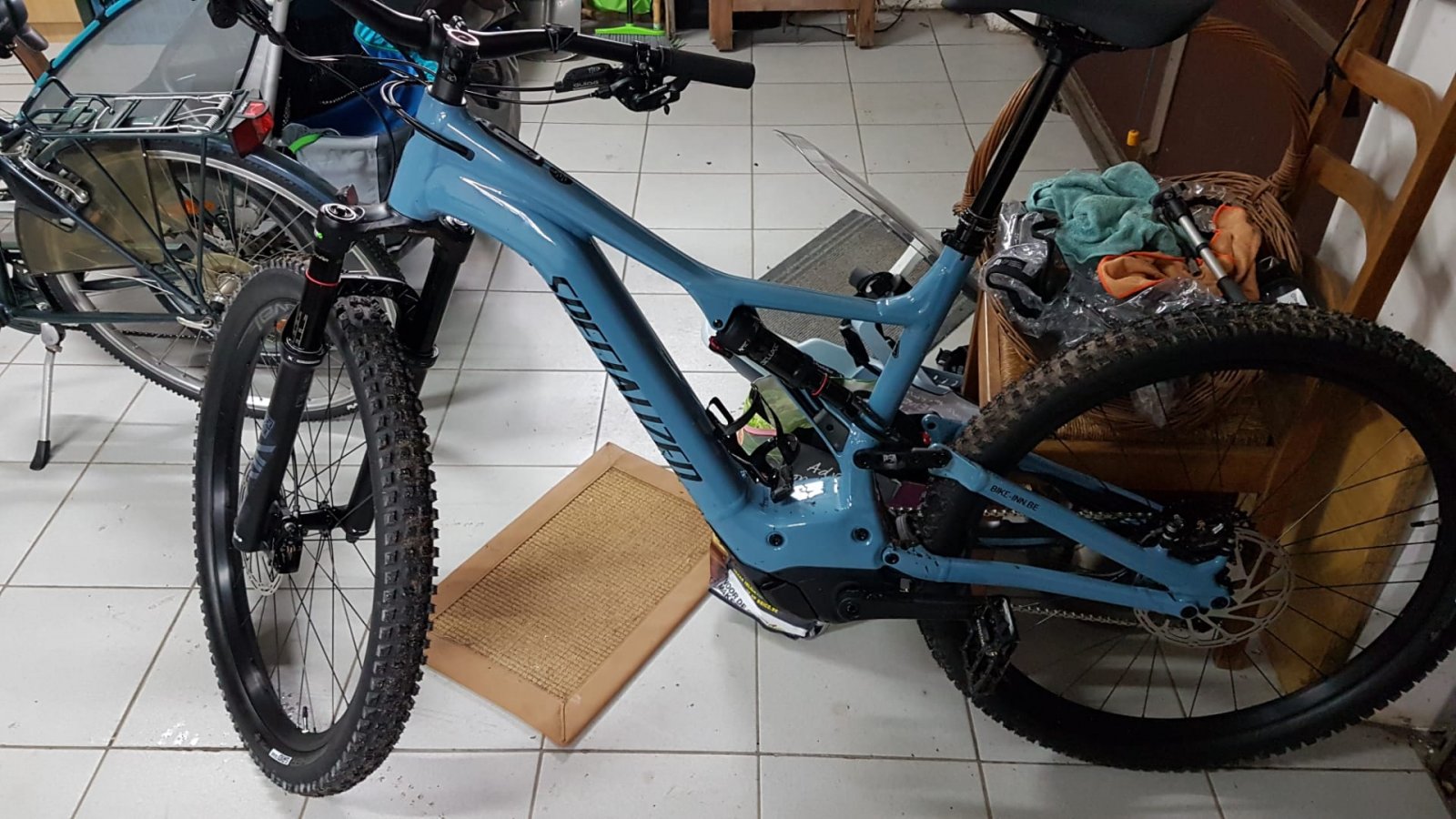

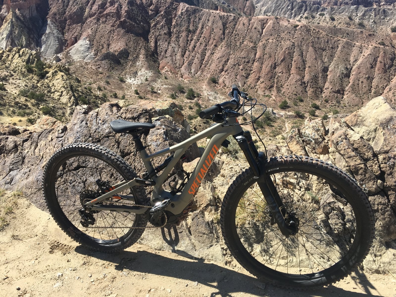

Yes I finally got mine!!! Sorry for the messy pic, but it was dark, rainy and late :)
It's a storm grey XL. So far I only changed the stock pedals to better ones.
I'm a superheavy bloke and I will be pushing the suspension to the max. The fork I got OK for my weight but for the rear suspension I'm a bit struggling. Am I right that the sticker on the rear suspension says 325 PSI max? This really means that with my hand pump I can put 325PSI in the suspension, right? I'm heavy but also strong and by no means I can push my pump to 325 PSI, I'm stuck at 260; which gives me a sag of 45%. I reckon when I'm at 325 sag will be somewhere between 30-40.
My Questions:
- Can I really have 325 in my rear suspension
-Is it physically possible or do I need an electric pump? (I reckon my dealer has one, but he's 50kms away)
-If physically possible, could it be due to my handpump, should I look for another one?
Anyone who has some experience in this and wants to share - I'd appreciate it.

You need to buy a shock pump, no way you can put in 325psi with ordinary pump ;)
Haedesz
Sep 20, 2019
51
80
Belgium
It is a shock pump, I didn't explicitly mention it :)
IMHO a MAX rating should never be reached, it will get the shock a lot hotter quicker, and have shorter service times.
the real question here is; are you bottoming out too quickly or are you using a good amount of travel when riding? if its fine, I wouldnt worry too much about stationary sag (since you're a heavy bloke).
IF it's a problem; call your LBS and see if they have an idea to fix it. If they can't: I know some heavy riders who use metal spring shocks (= coil shock) instead of air. You buy the spring seperately, which are rated for different rider weights and are then finetuned when installed. They also make heavy duty (higher weight) springs.
Probably not the answer you were looking for when you just bought a new bike, but tbh the LBS should've setup your suspension from the get go.
Hope this helps!

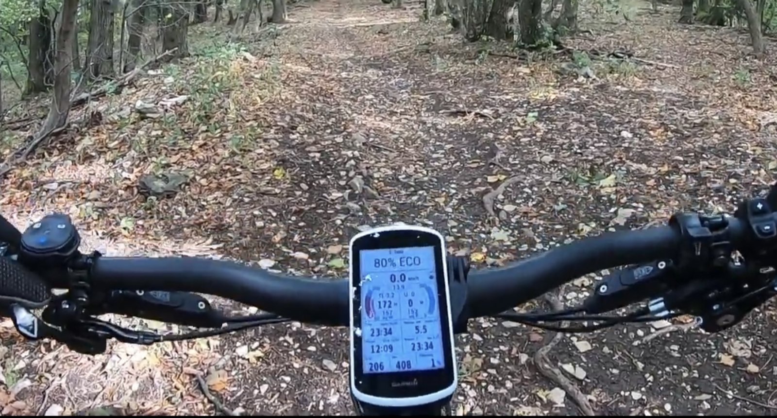

What computer do you use? Do you recommend it? I have tried the Specialized TCD and I'm not convinced it's the right computer for me; it keeps dropping my HR monitor - I guess it could be the HR monitor problem too.
I use the Lezyne Mega XL. Works very well.
McInner1
Jun 8, 2019
229
174
Austria
I love my Garmin Edge 1030. If one likes a smaller device more go for Edge 830 or 530.
They all are fully compatible with Spesh-TCU ANT+ sensor informations.

I am using my Edge 520, I can only get battery level and cadence to display, no power data shows.
Also every couple of minutes it auto pauses and immediately restarts.
Any suggestions ?
grantini
May 7, 2019
611
539
Delaware
McInner1
Jun 8, 2019
229
174
Austria
Any suggestions ?
Don‘t use Spesh-datafield or Garmin‘s Ebike field!
Simply connect your Levo as power-sensor and speed-sensor. Now you‘ll get Speed, Power and Cadence.
To get Levo‘s battery level and assist-mode install IQ-Ebike field by Jan Capek.
